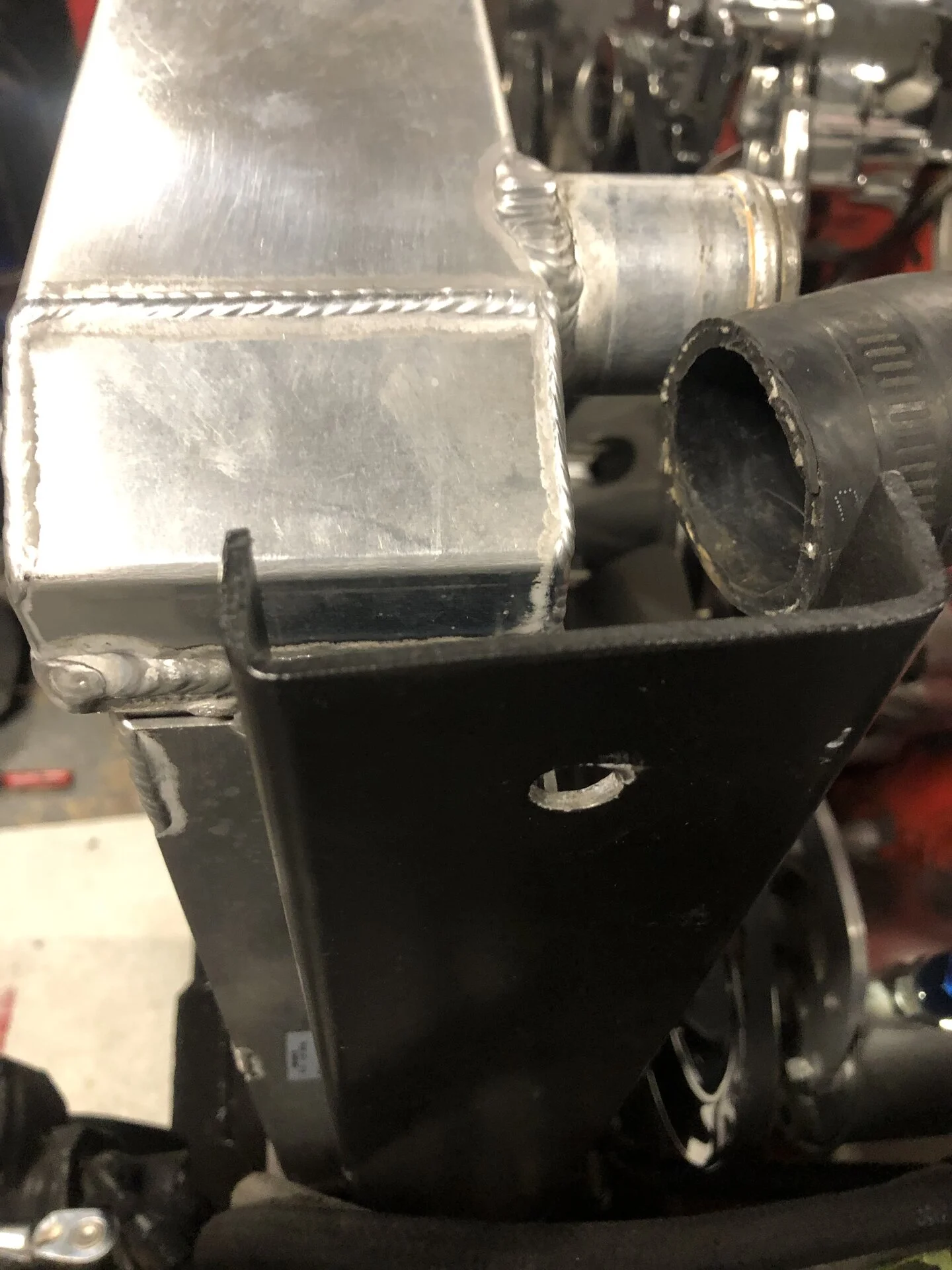

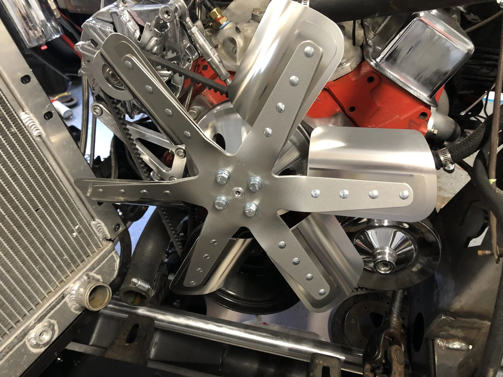

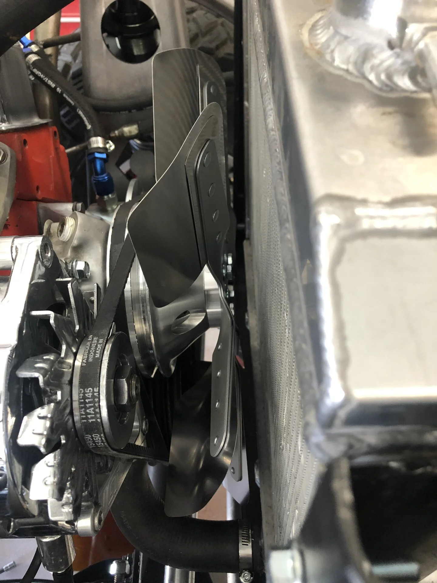

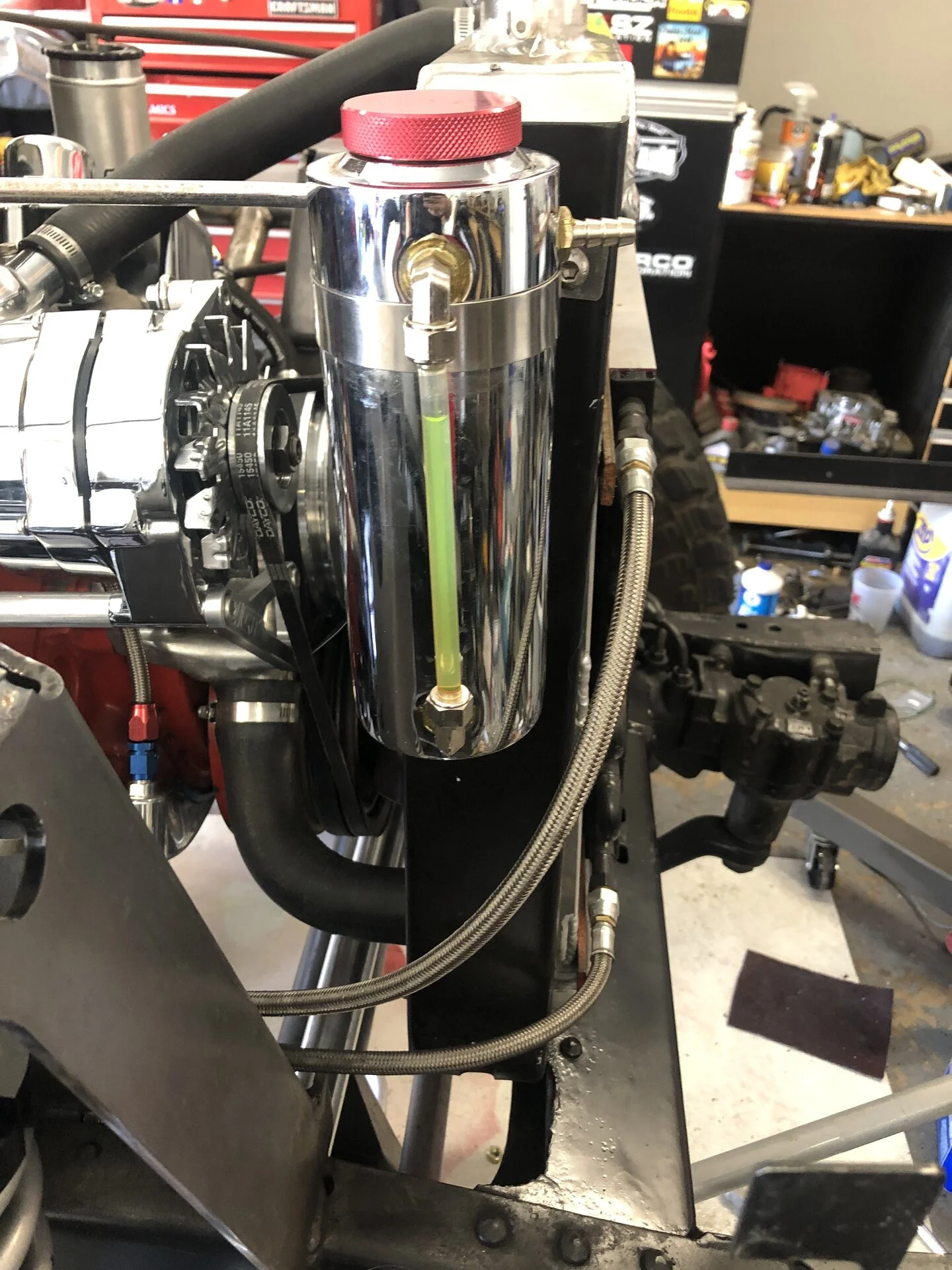

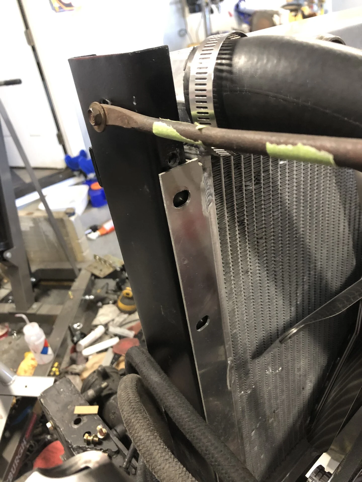

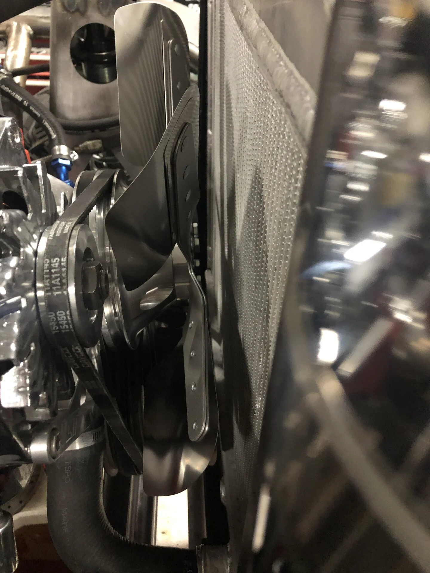

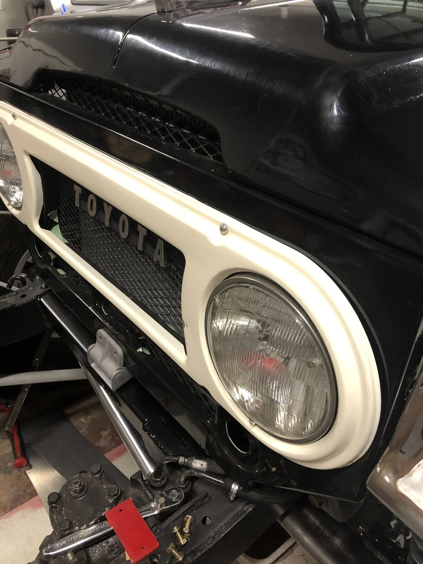

Back at it 🤔. So it was tight before. And now I had to add a 1/2 spacer so the fan clears the alt Just barely does 🙄. But now I need to find that lost 1/2 of space and make it 3/4 🤦🏻‍♂️
I do have a extra Rad support and I think I can cut out a notch on the bottom of it so it can come forward another 3/4 of a inch. 🤔. Most likely will have to relocate the trans cooler. But I can get one of those little coolers that have there own fan and mount it somewhere 🤷‍♂️
I had similar issues with my v8 swap. I ended up slipping the radiator INTO the radiator support and then putting in spacers to move it closer to the bezel. It was a little bit of a trick to make it all fit but it should net you the .5” you’re looking for.
I was able to put the radiator flange inside the radiator support and push the radiator forward. 👍 this has given me the room I needed . I will need to relocate the trans cooler but that is ok .
A little bit of a pain but not the end of the world. Everything fits and works. 😃. And still able to use the oe Rad support .

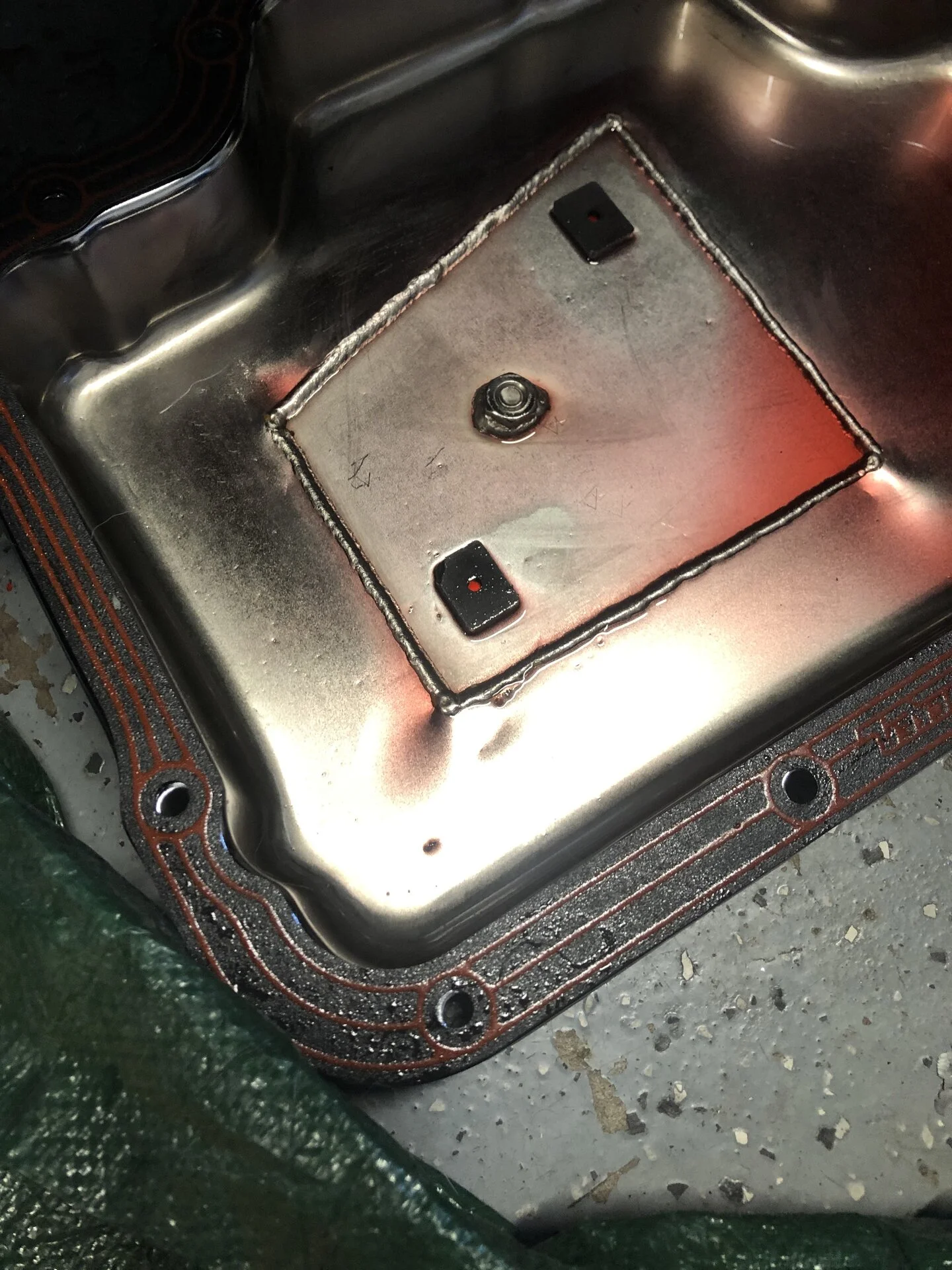

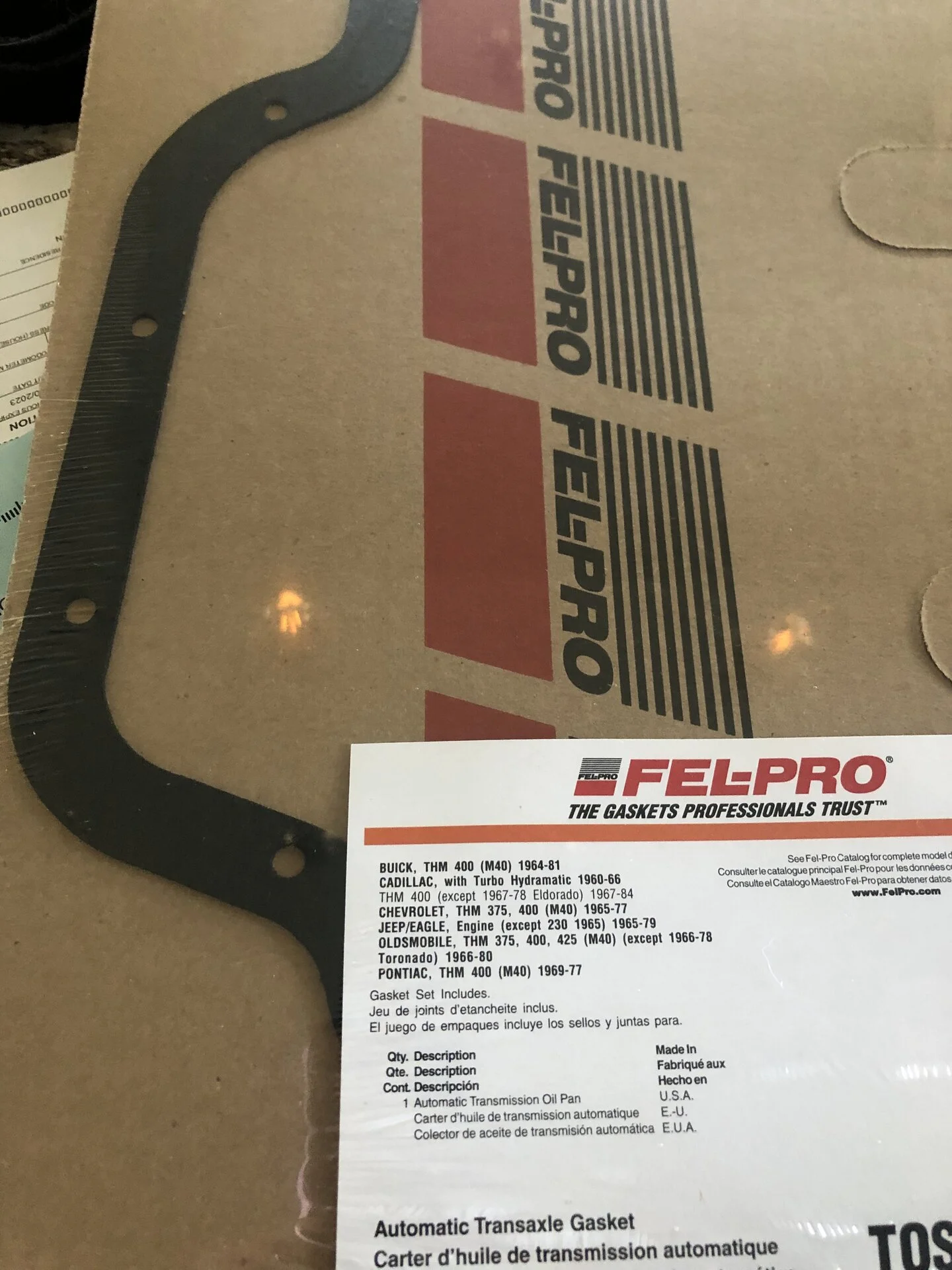

So I had a very minor leak from my trans pan 🤦🏻‍♂️ It’s brand new . So I pulled it and noticed it has the ribs going up 🤔. Poor design 🙄. So I got some sealant and a new gasket. If this don’t work I will just undercoat everything with FlexSeal 🙄. Sick of doing things 2 -3-4 times on this thing . Would not hurt my feelings at all if it went to Craigslist this week 🤨. But I think this will be good this time

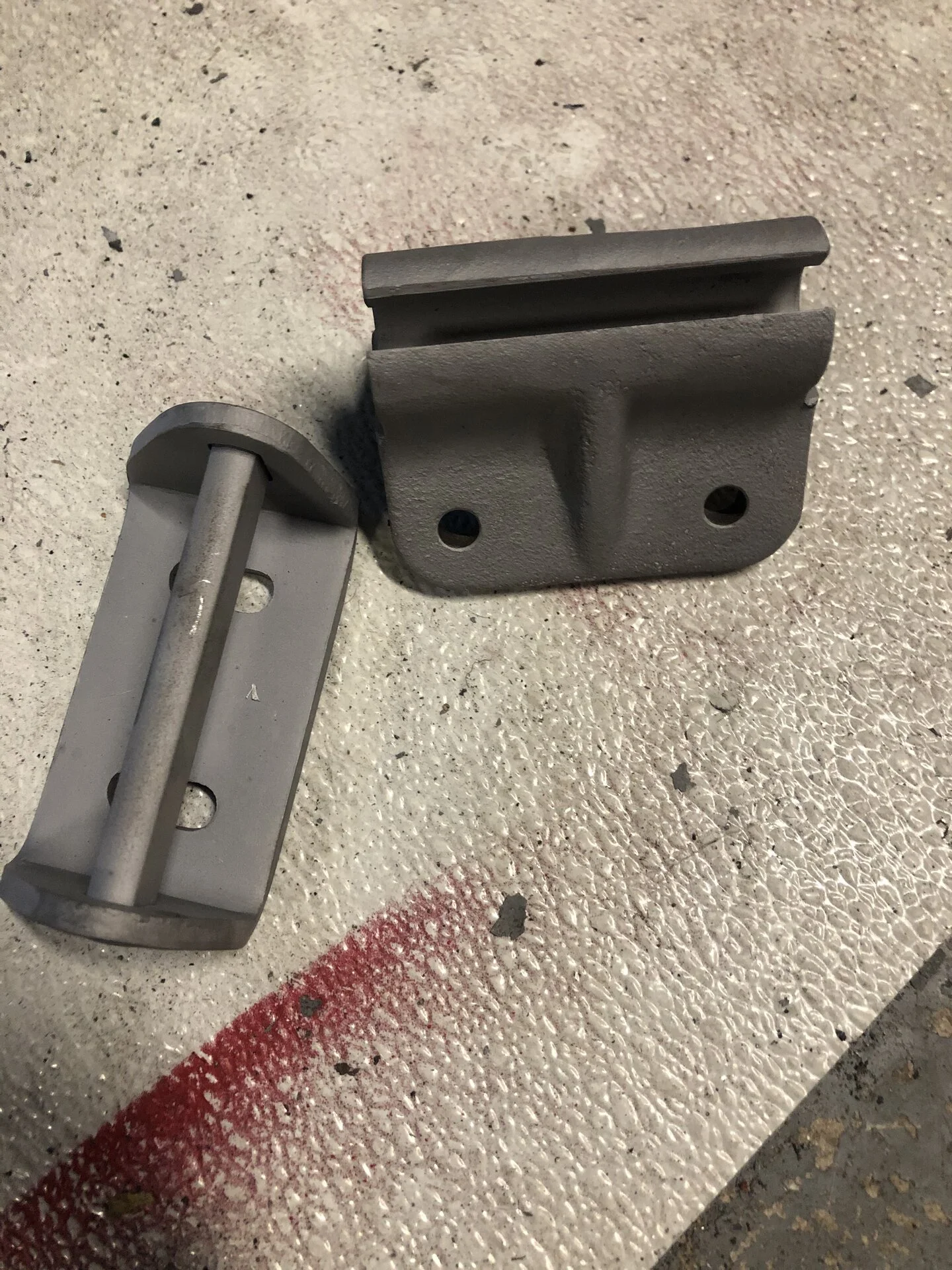

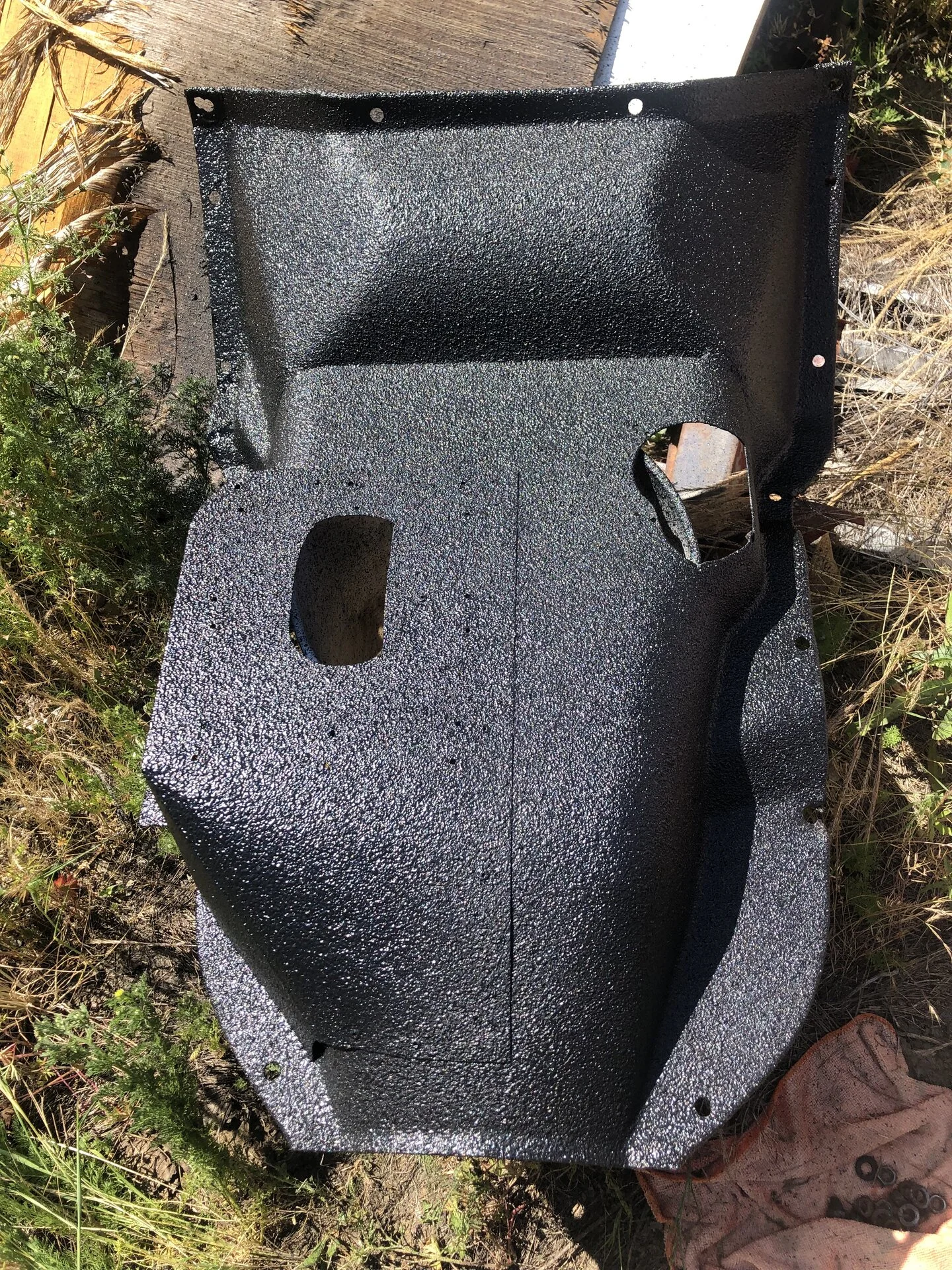

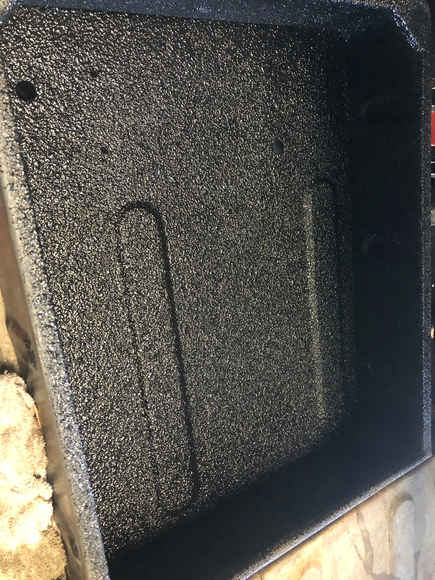

I figured I better get busy since the clock never stops 🥺. So I finished up the twin stick 👍. Then sprayed the trans cover 👍. And had some left so I sprayed the inside of the tool box . I got the tool box lid powder coated so it should look good . I did silver to match the seat frames

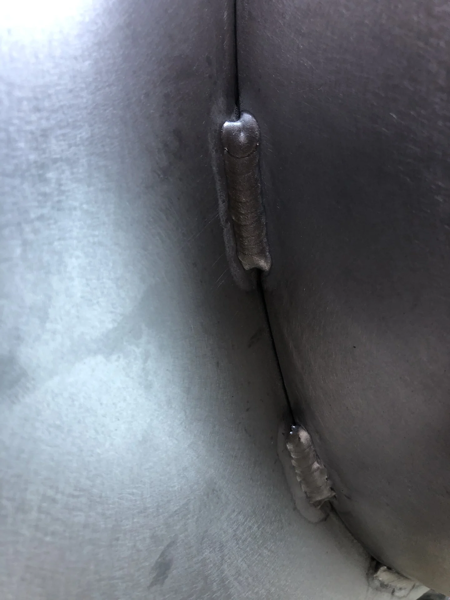

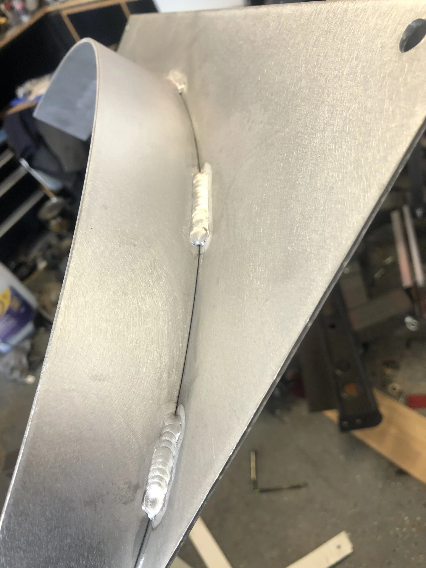

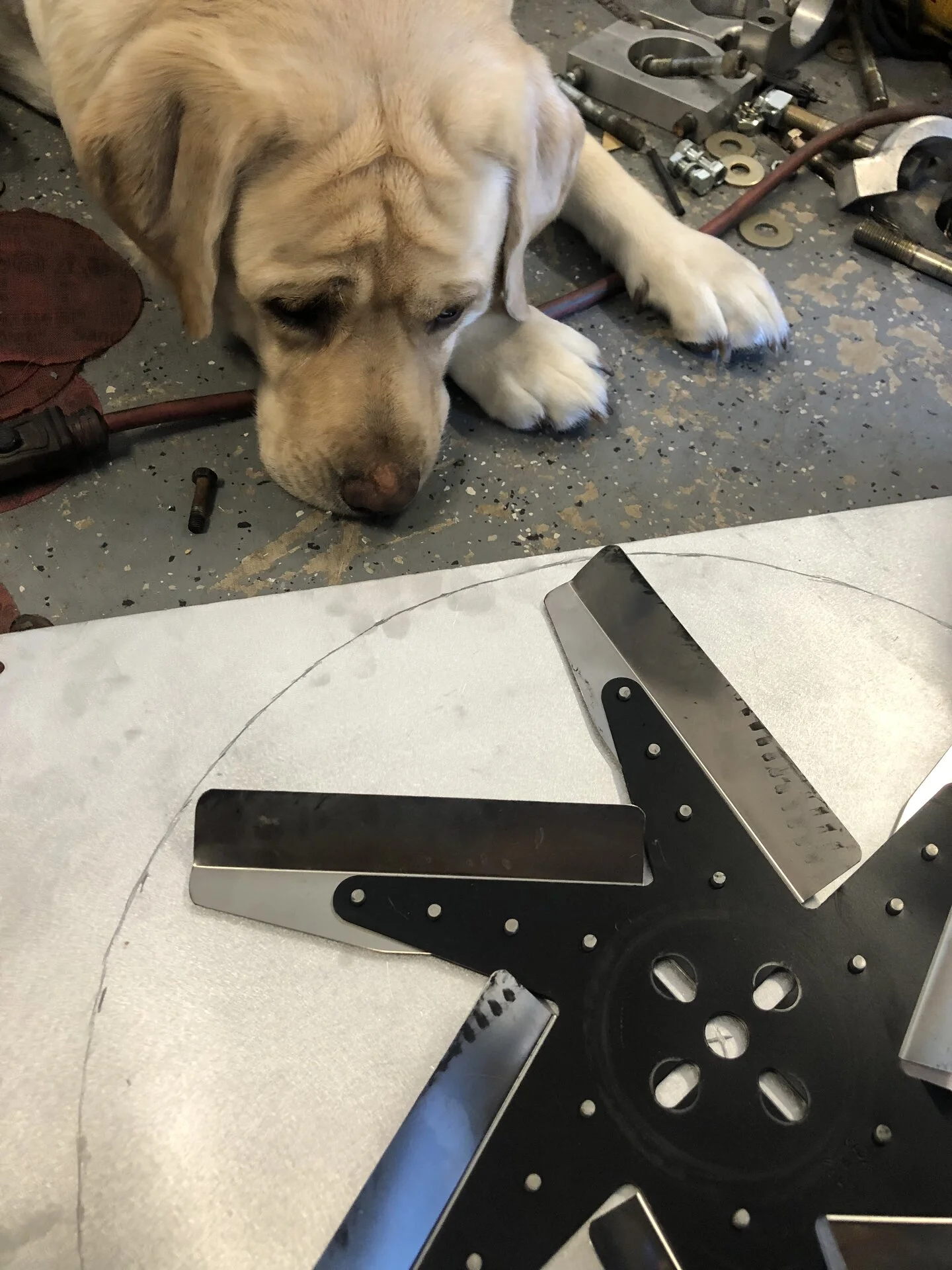

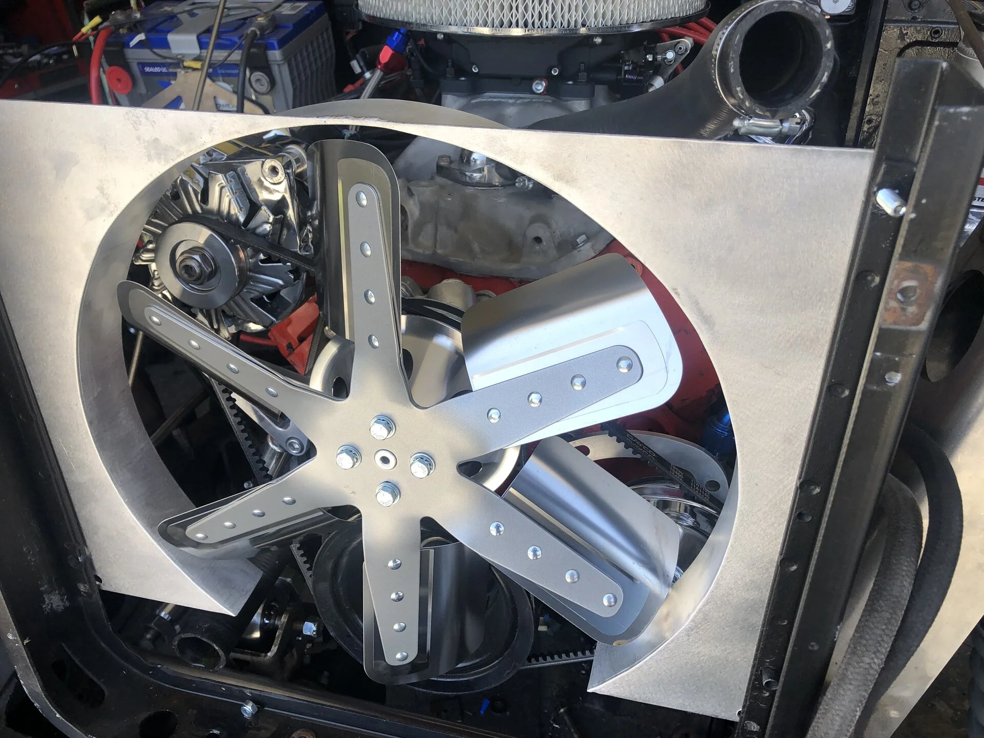

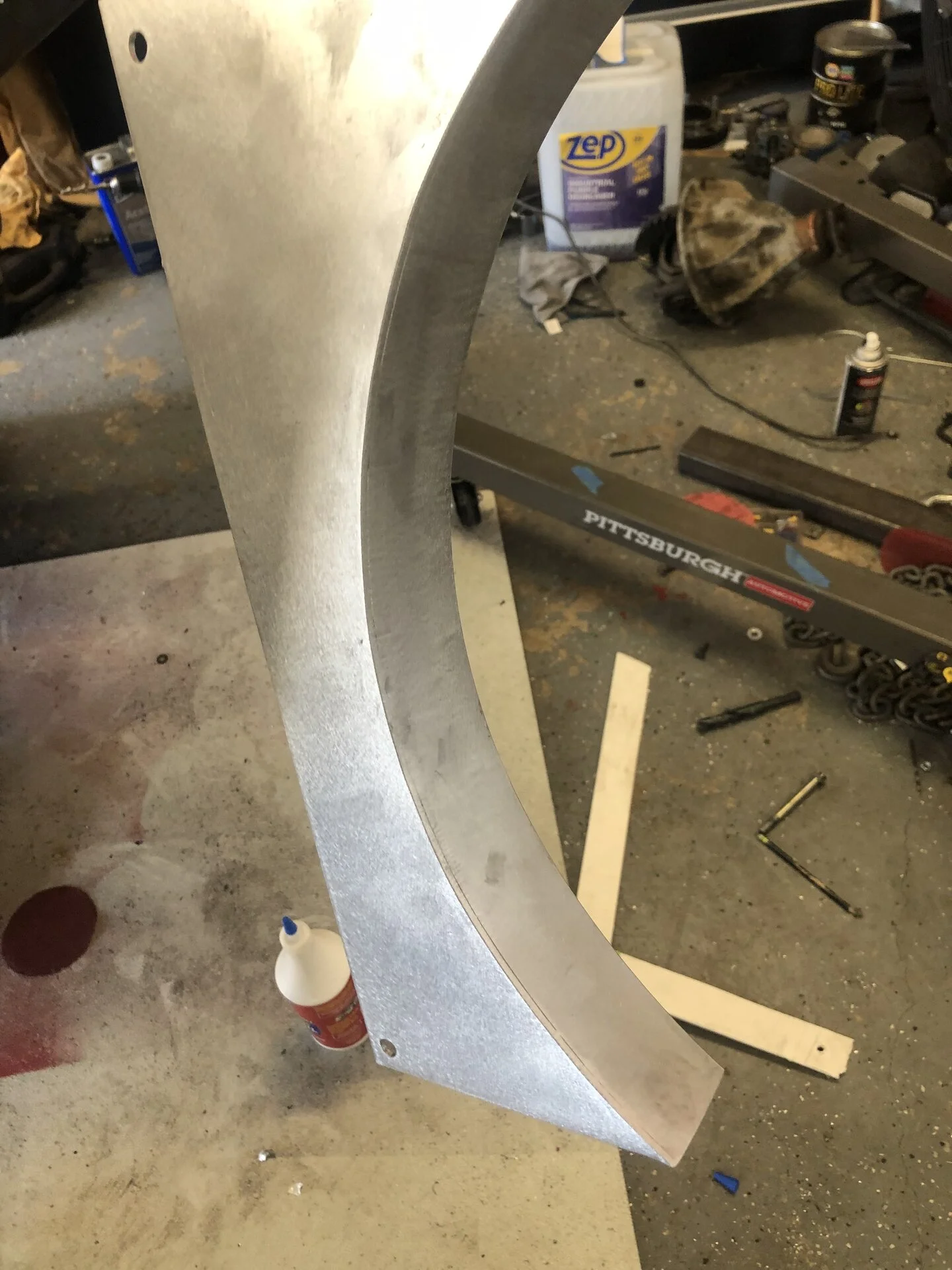

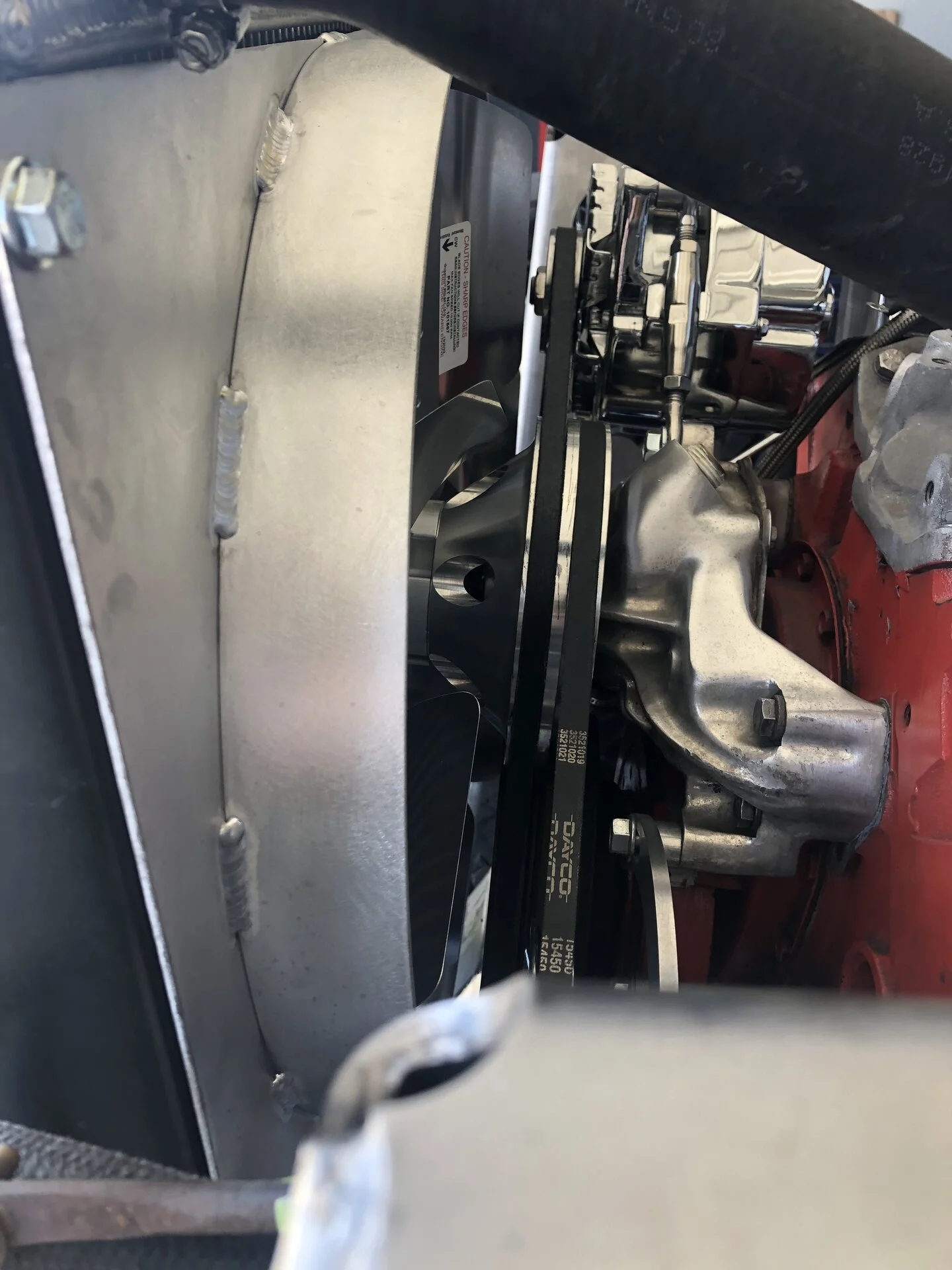

I think you'll have good success with the shroud. Fab looks great.
