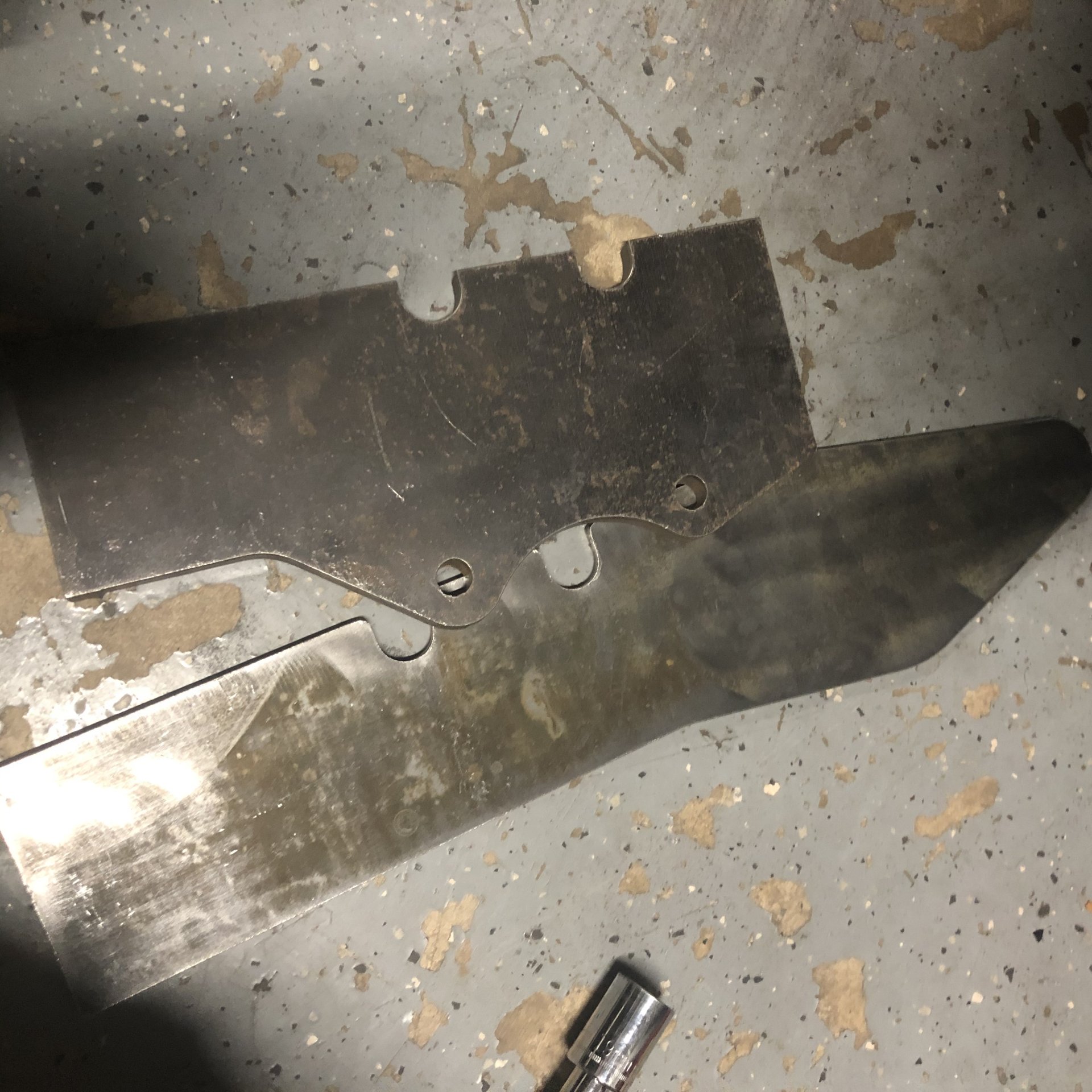

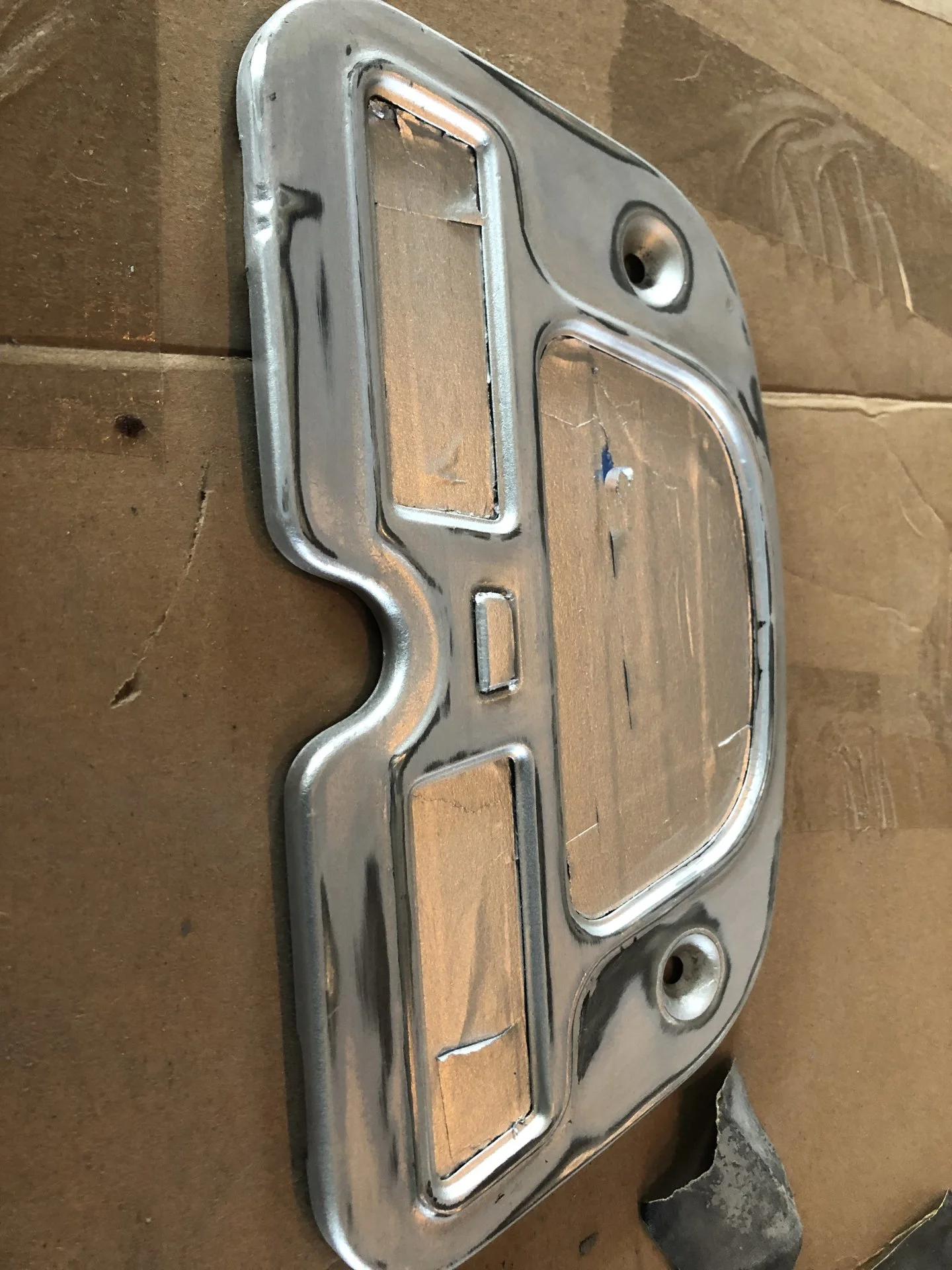

I need to cut that little square spacer off 😃
Well since we are grinding why stop now
It’s not bad. But not bad is not good so let’s fix this

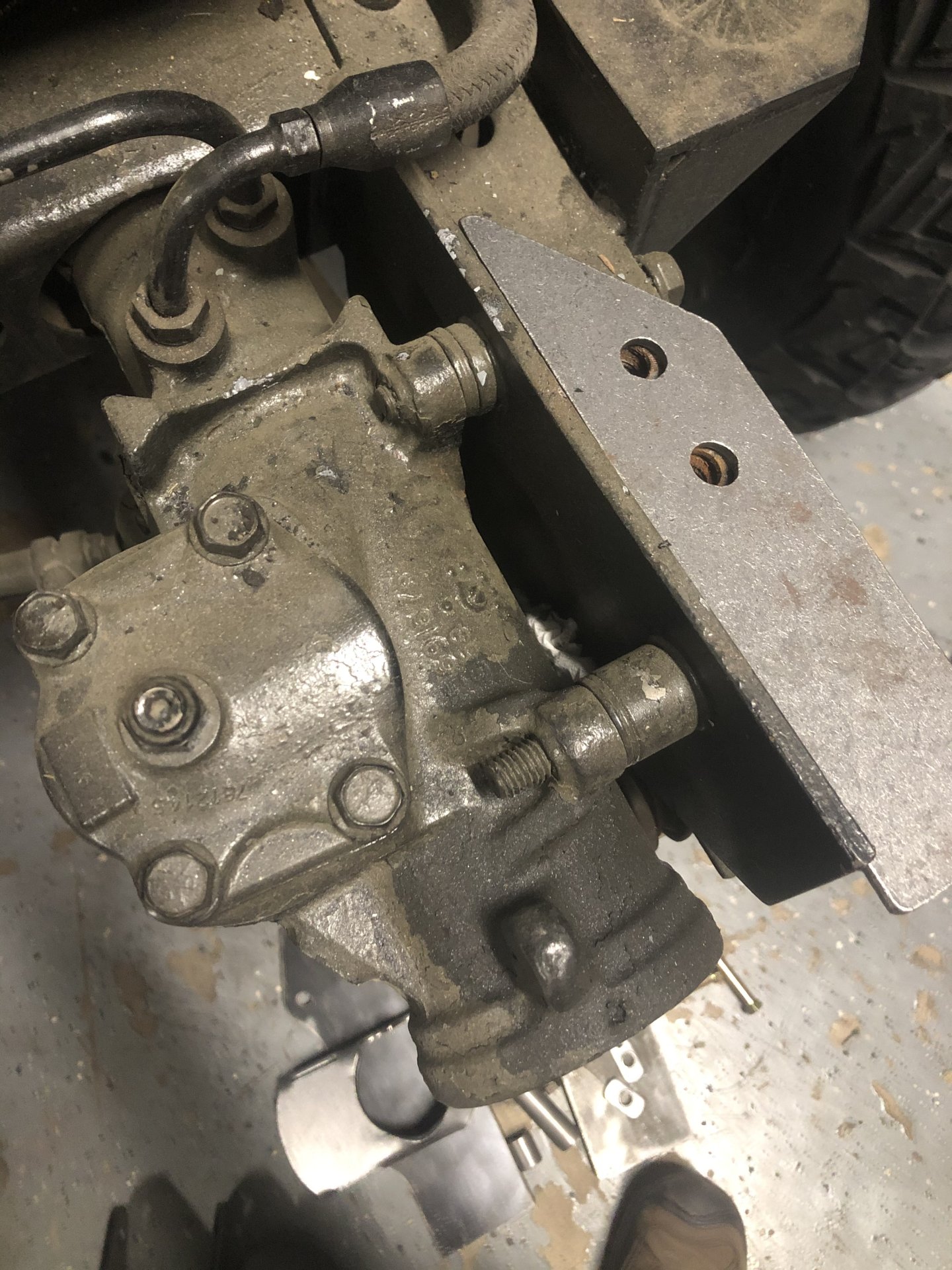

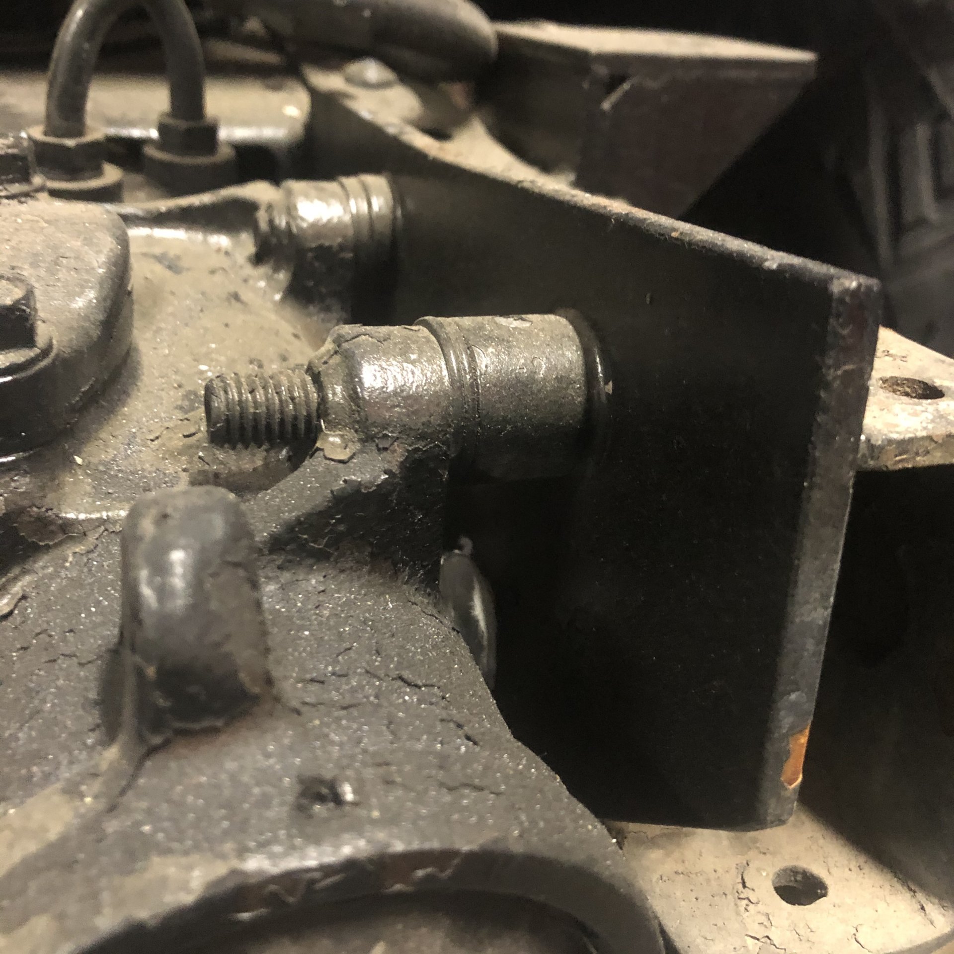

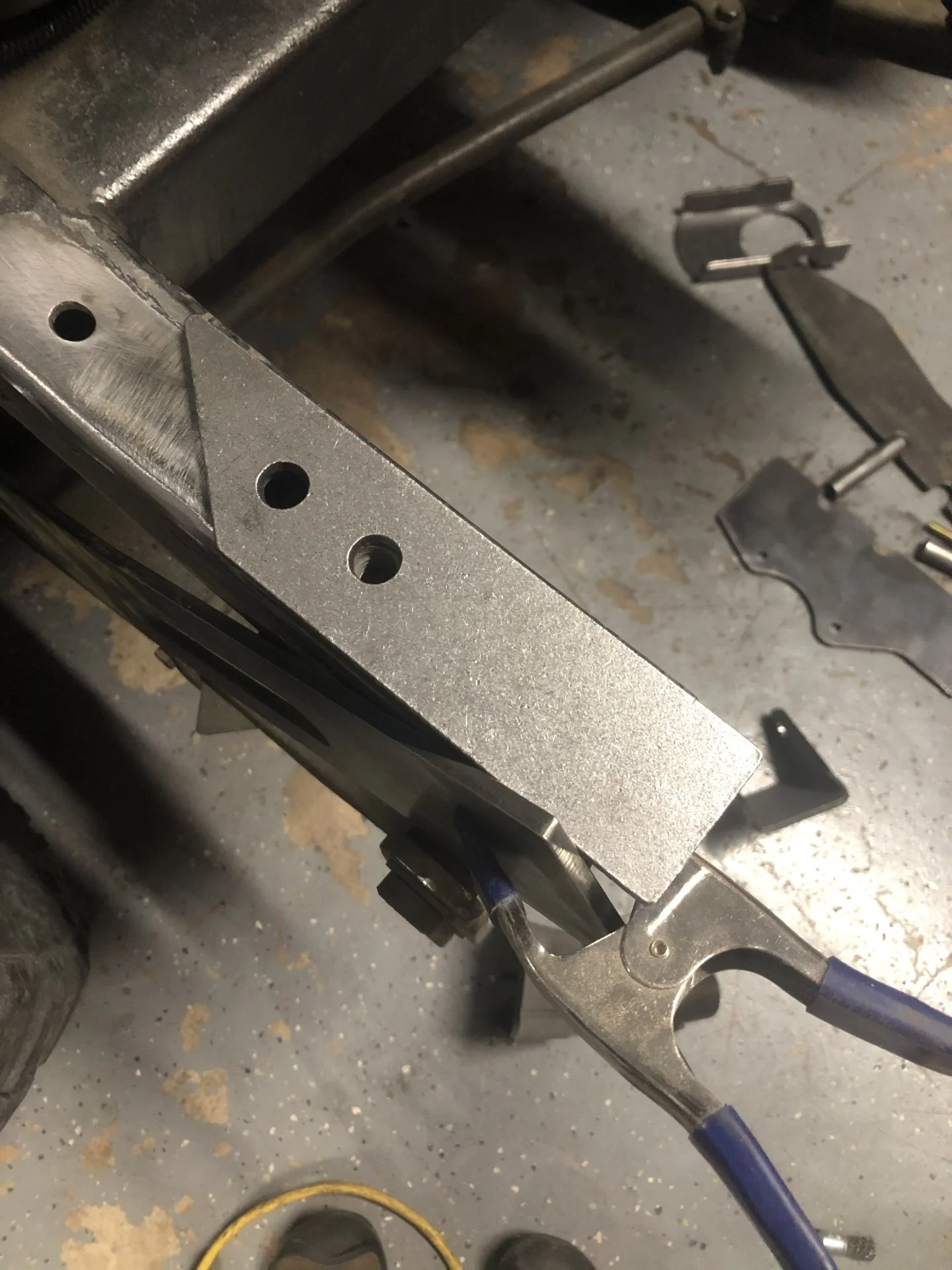

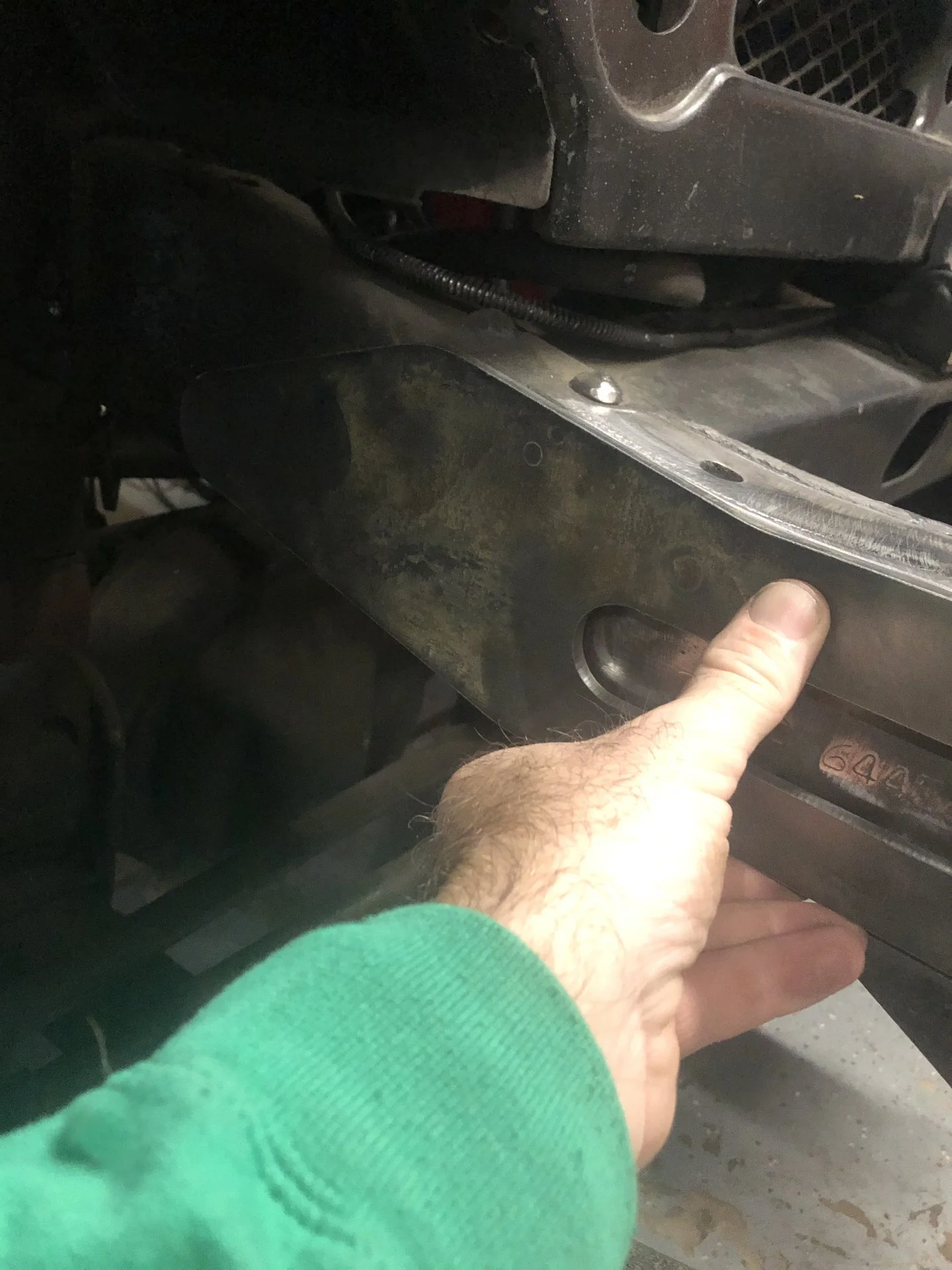

I did not plan on reworking the steering box but after looking at it it’s just not right so I got the 4x4 labs mount. I will cut all the stuff off and get it set properly

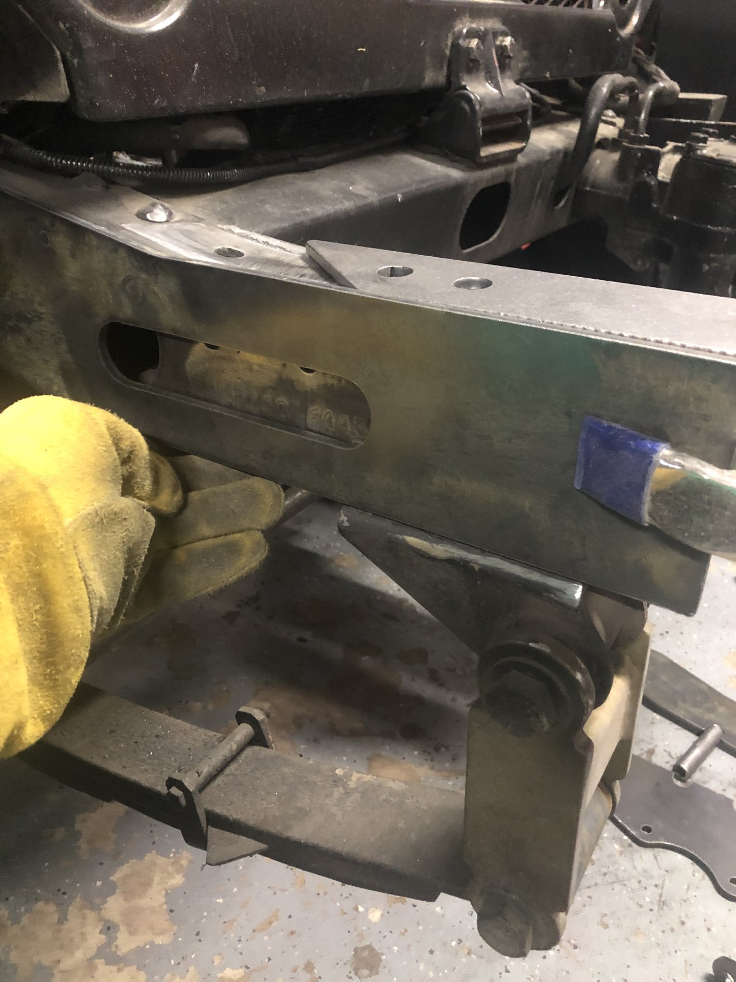

And just like any project i hit a snag :( So i had bought the 4x4 labs mounts for my Red 40 that is a 71 . I forgot that the 69 has a different frame. The front crossmember is angled on the 69 . ugg So i will order the correct parts tomorrow . I could cut these to fit i think but i will check with 4x4 labs first if i can just get new inner plates . I am very close to saying F it and building the Red 40 and not worry about all the backlash from the Purists :steer:. But lets see if i can get this project back on track first
I'm no purist by any means, but please keep the 71 stock, especially when you have a perfect builder rig. They are getting so much harder to find in any form of stock condition, especially in that quality.

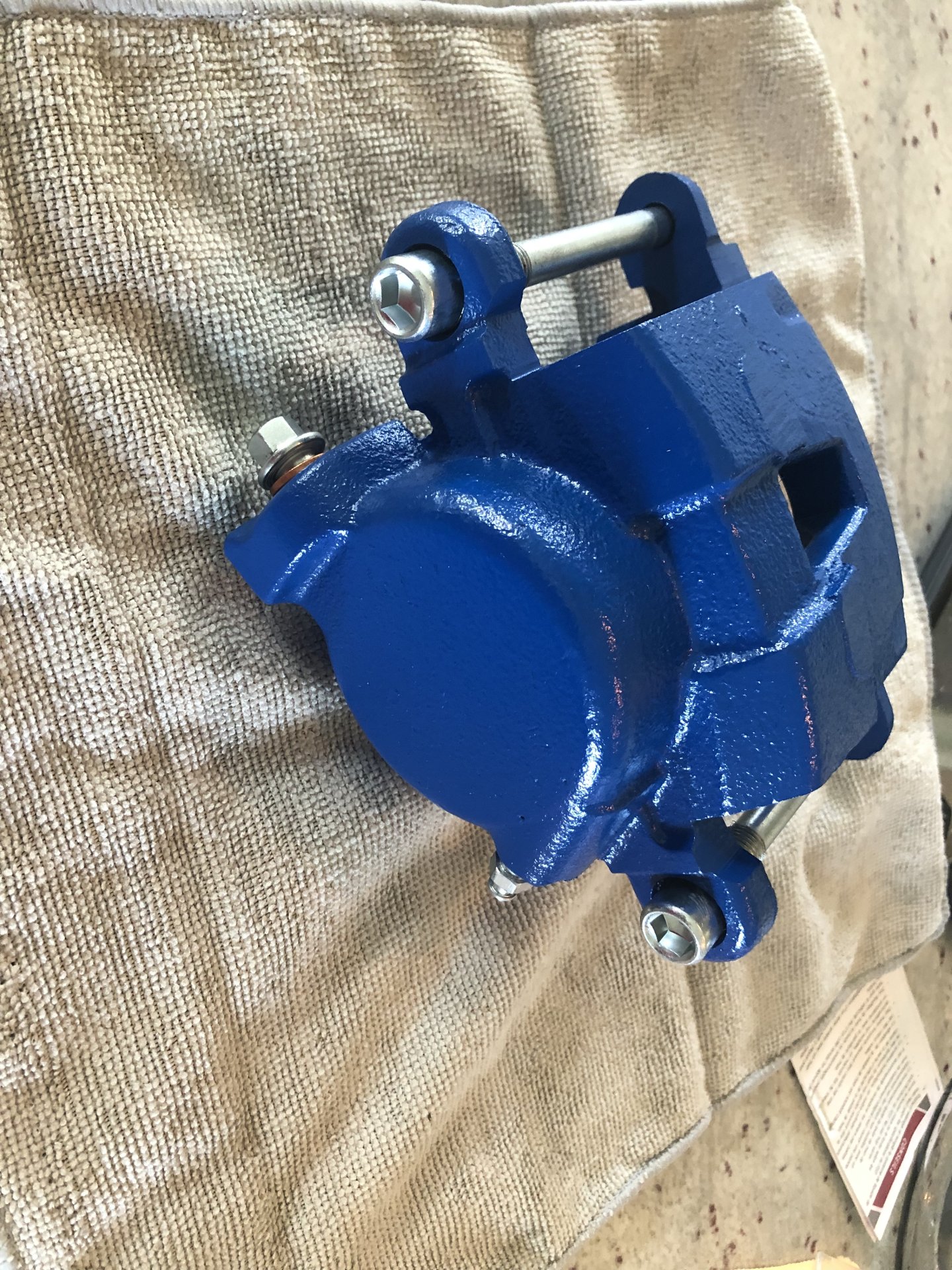

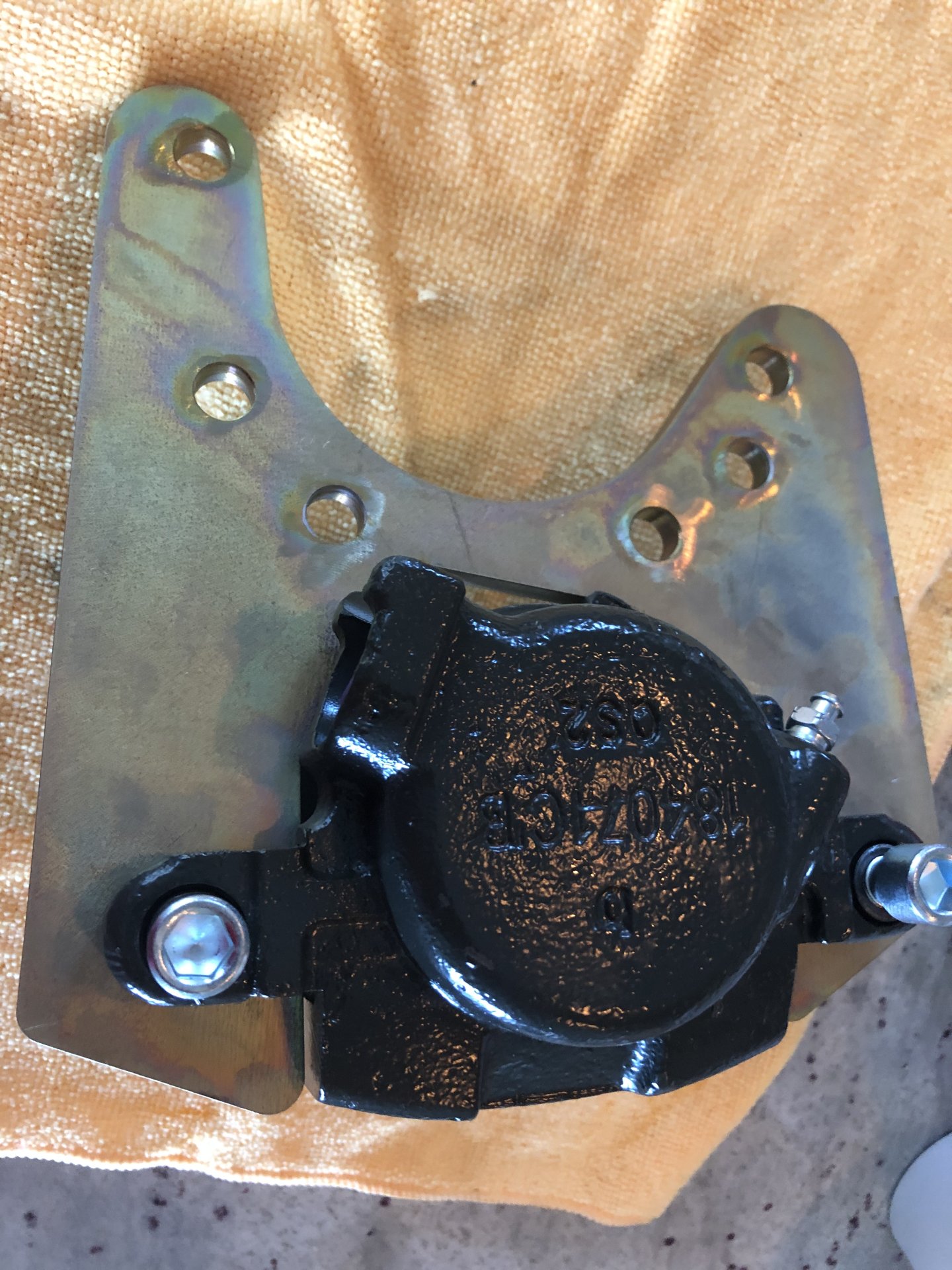

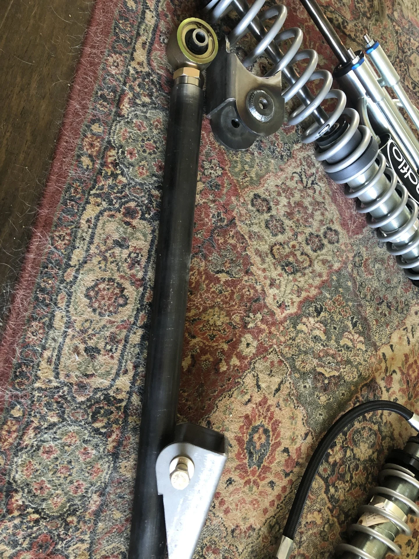

Got the rear disk brake brackets
Well it’s not very hardcore. But it’s about as extreme as I can get right now 😃. At least it is giving me something I can do

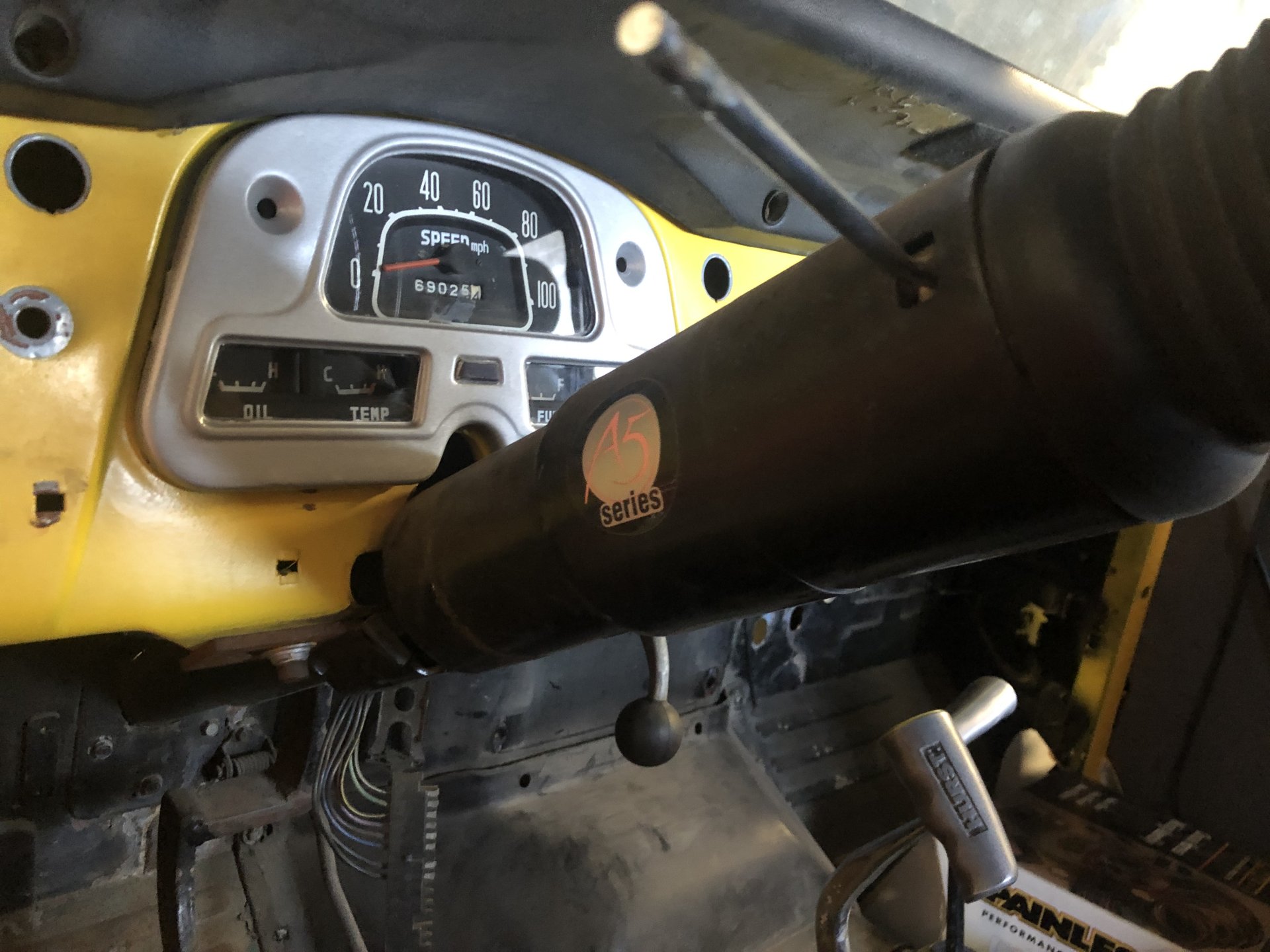

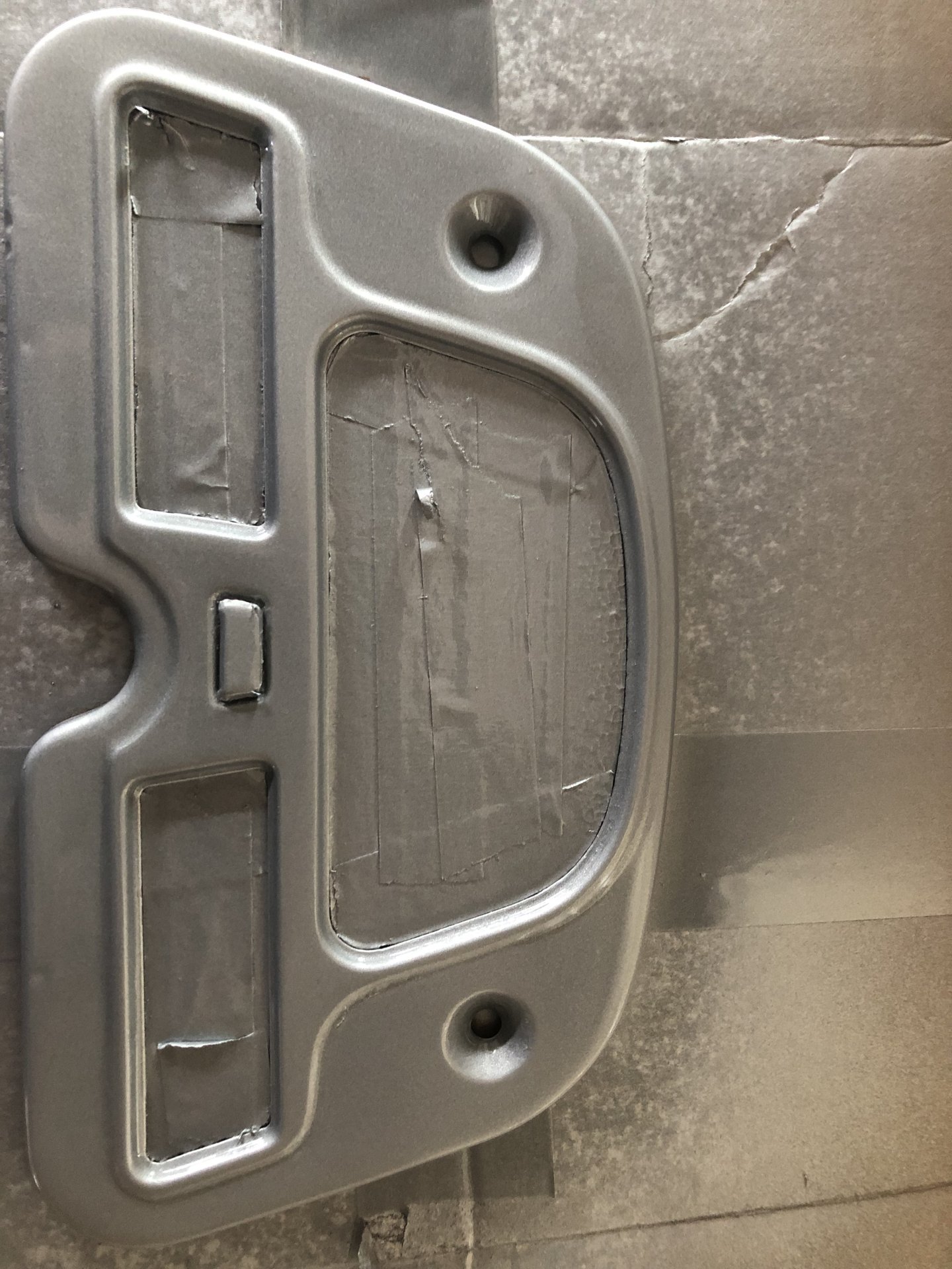

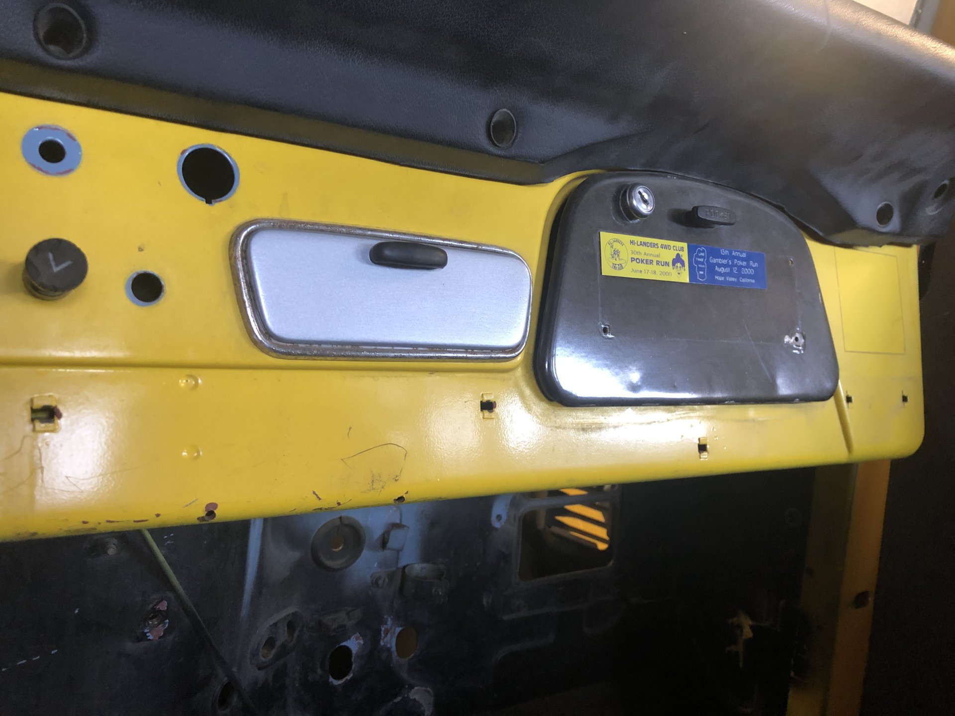

Starting to look decent again . Next up the glove box 👍
Details
