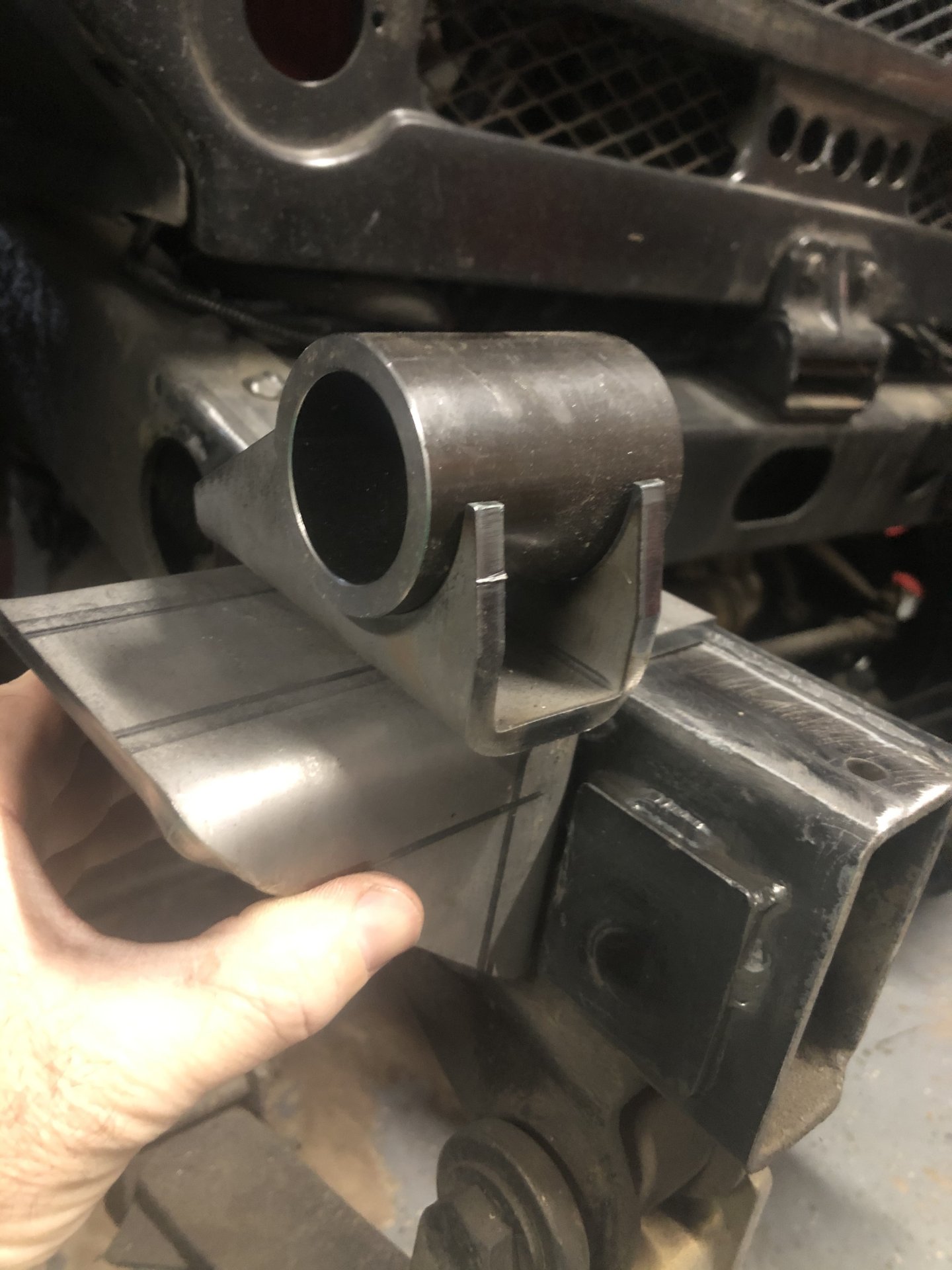

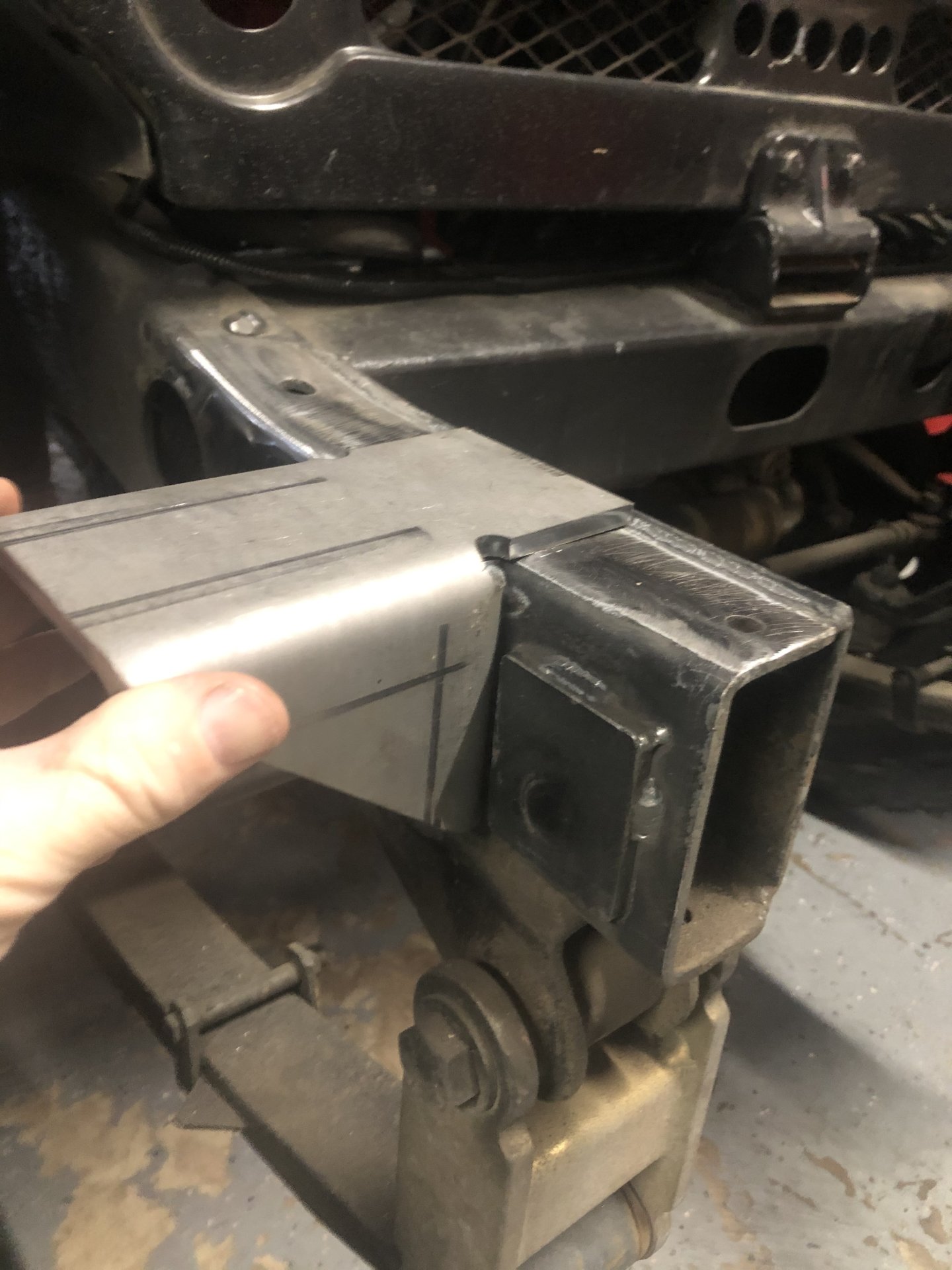

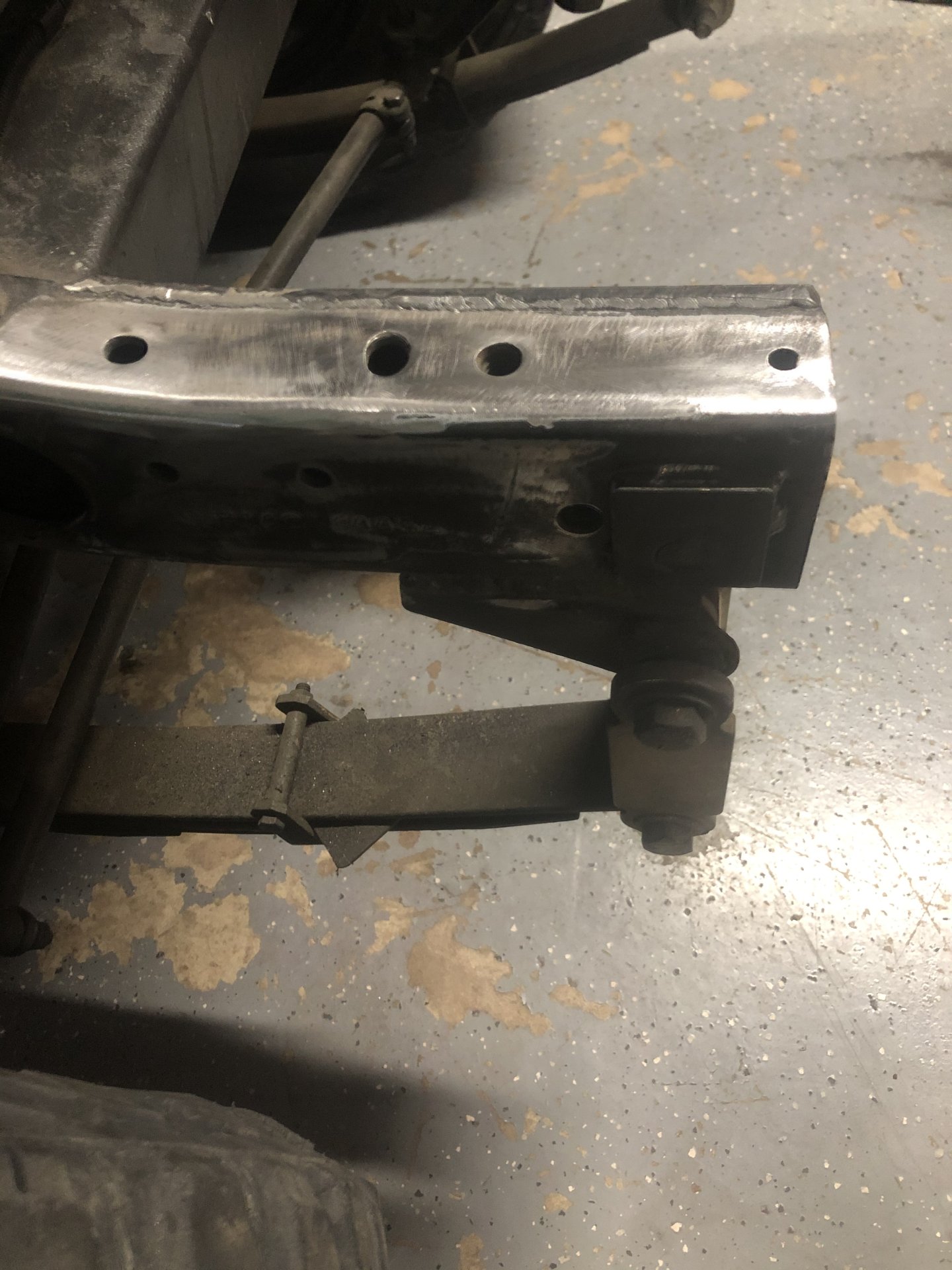

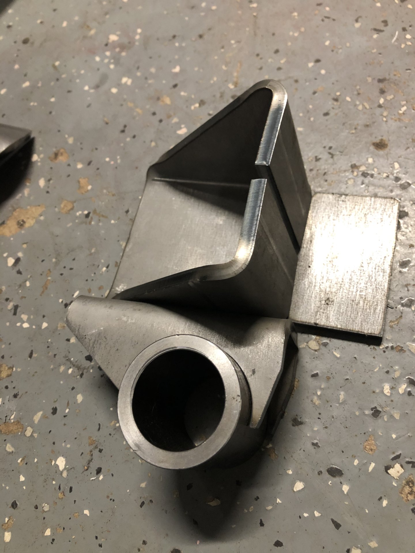

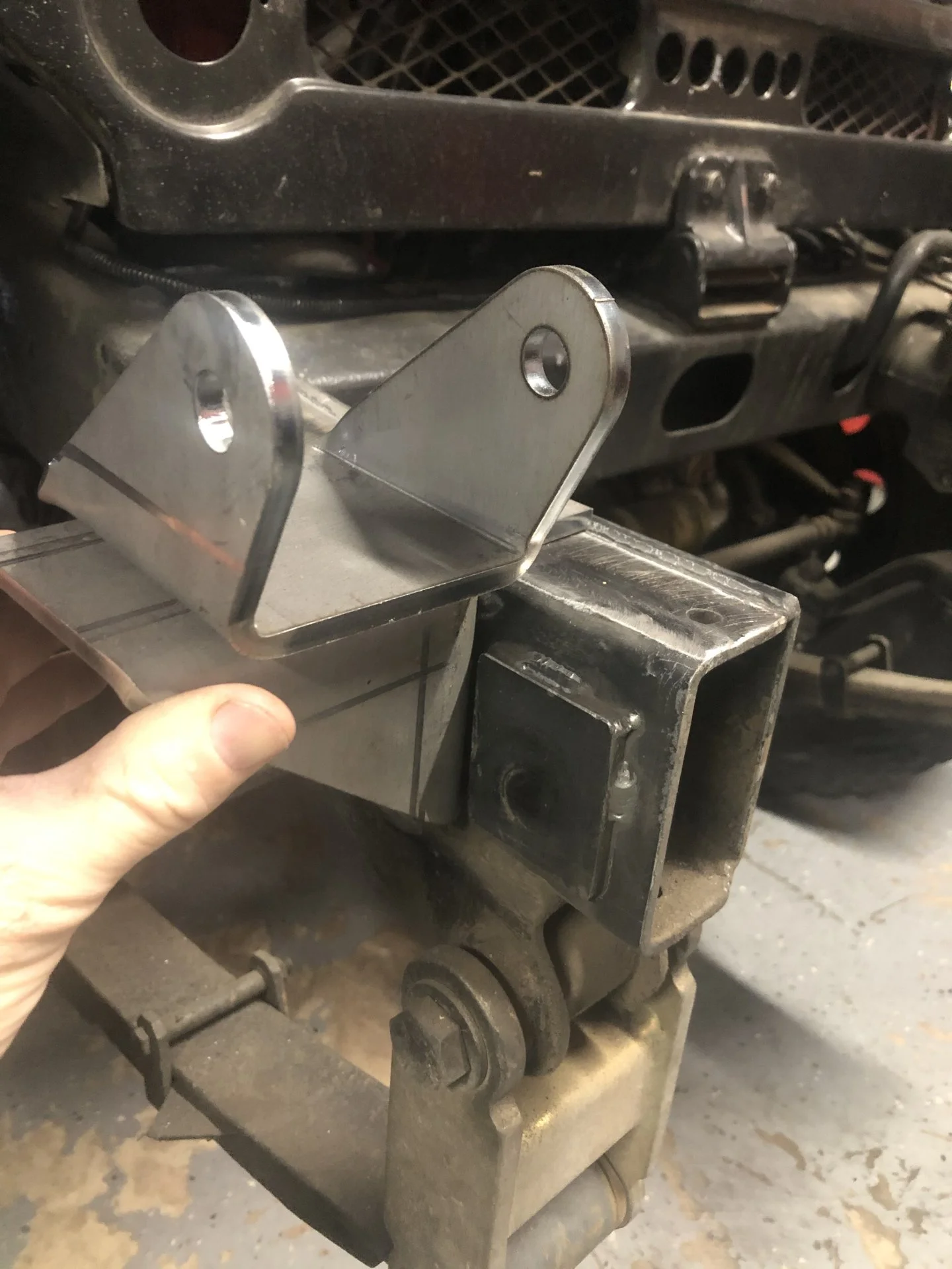

I’ve never seen them installed this way. Your very first picture looks more accurate though I can’t tell if that is the front or rear.

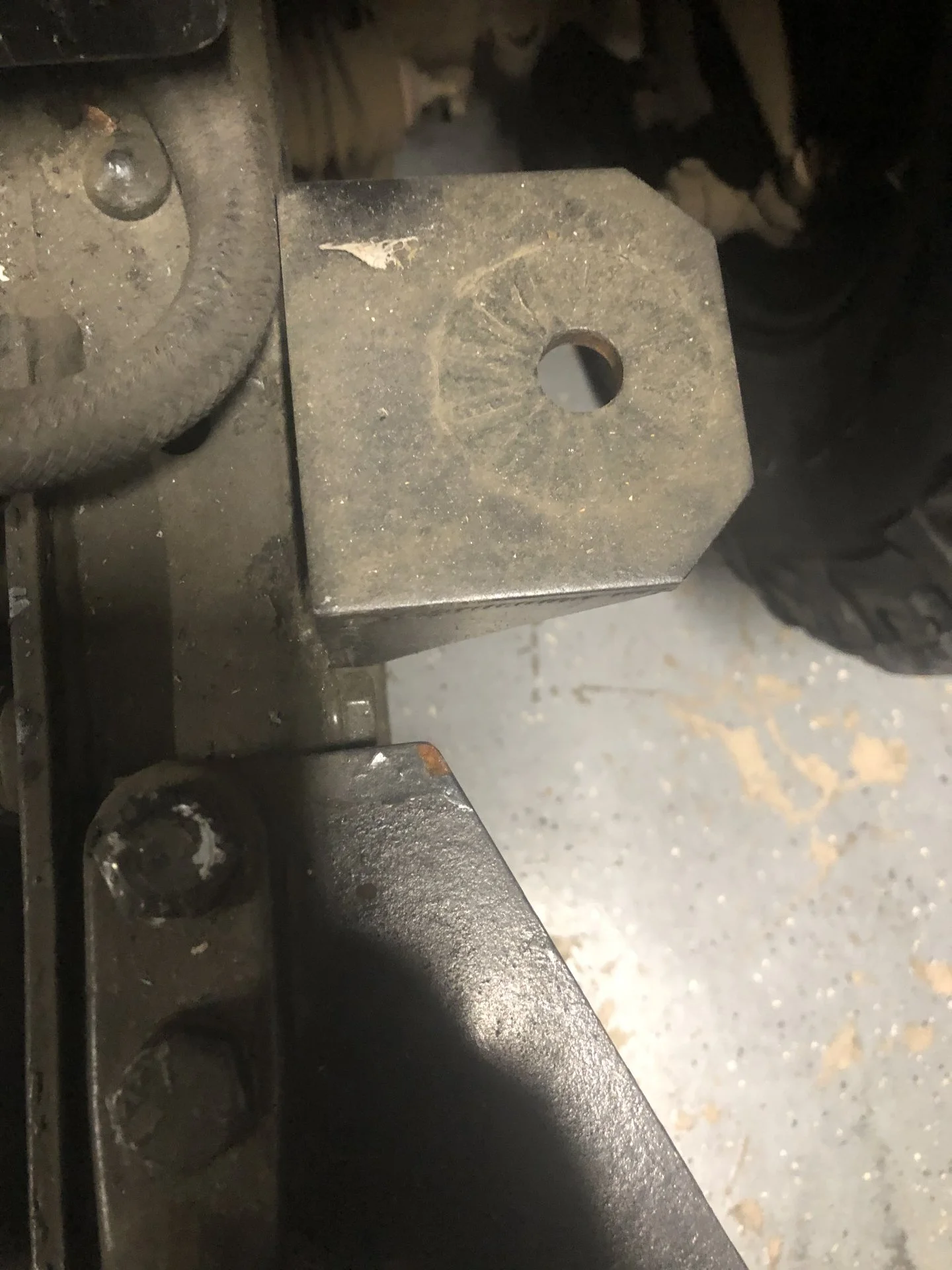

The mounts would be for the front . They just stick out really far . I think what i will do is once i get them tacked in and everything is were i want it i will mark them and cut off anything that is sticking out past what is needed . I wish i could just see a pic of someones but have been unable to find any . As far as the springs i would be interested but do not see myself driving to CO to pick up . I was looking the other night at the front end and if i linked it . The only issue i am seeing is the exhaust runs down the drivers side inside the frame right where the upper link mount needs to be . hmmm.
Here is a link that I have saved of the outrigger installed. I saved this when I was considering this setup. I don’t have any other references. After I installed my Alcans I satisfied my needs for stability. Had I done this setup again I would have used the outriggers.

Thank you yes the rear is easy to figure out the front mont is a little more of a grey area . but i think i have it. Started cutting extra stuff off and getting to we’re we can start figuring this thing out . So yes I have it upside down but you get the idea. If I leave the shackles up front it goes one way and if I do a reverse then I use the other mount
