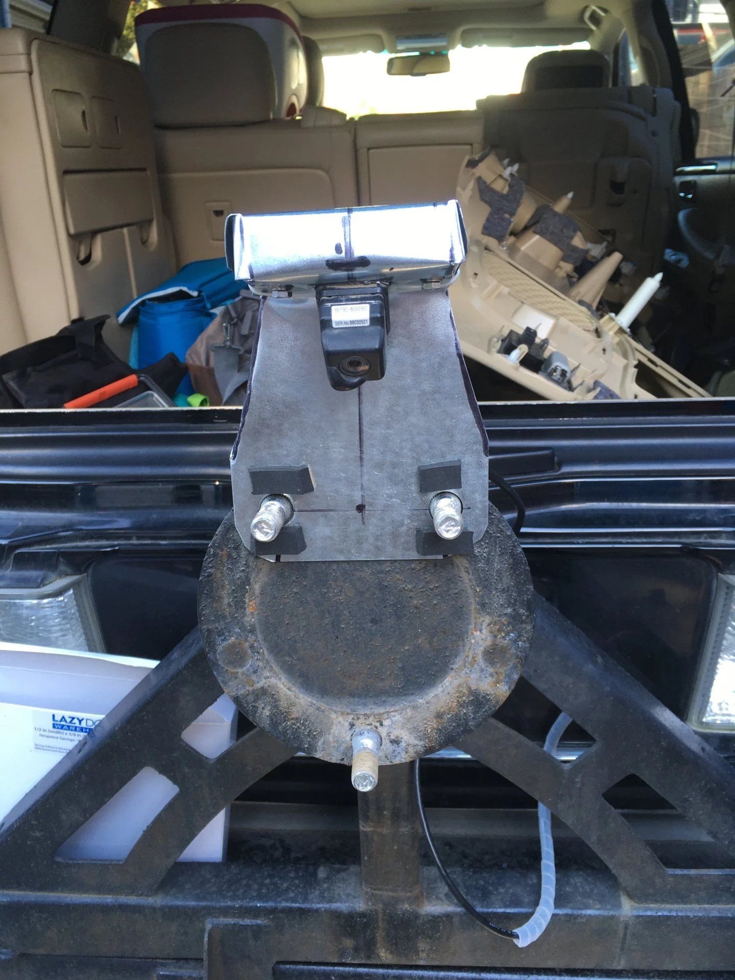

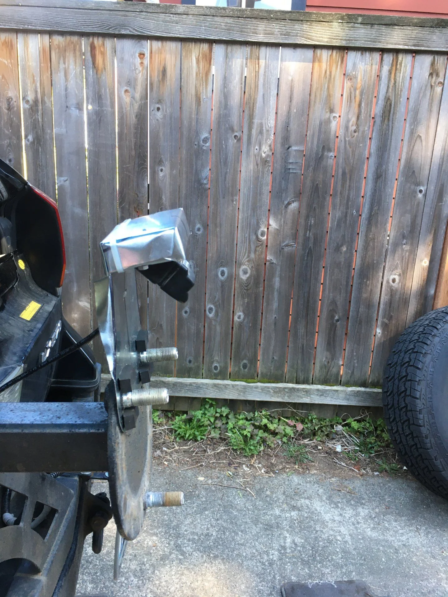

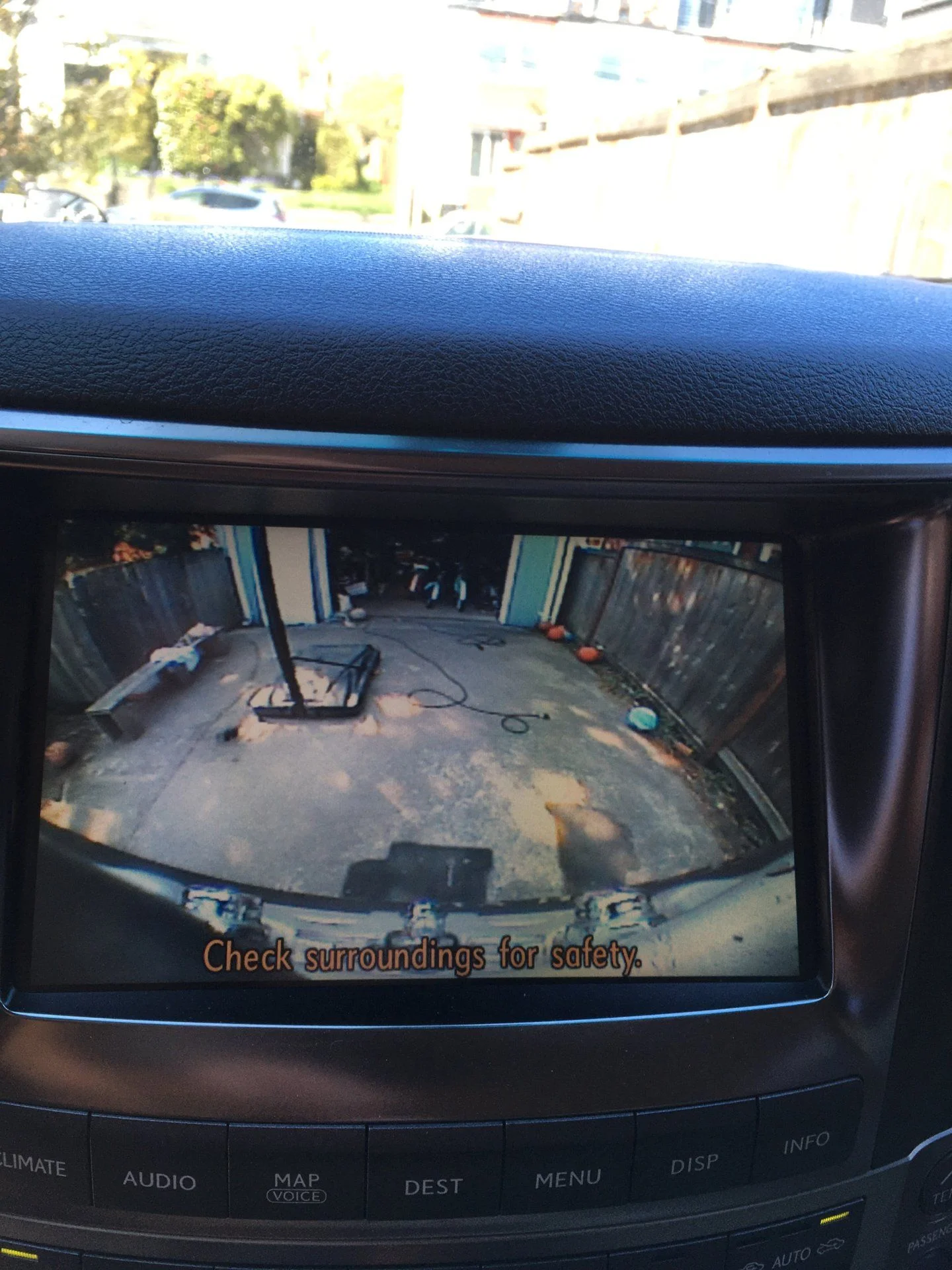

Finished up the rear camera relocate to the RLC bumper swingarm. It was time consuming, but I'm pretty happy with the results.
If I want I can bend it down a little and see the tips of the lug nuts as well as have good view 20 feet back or so.

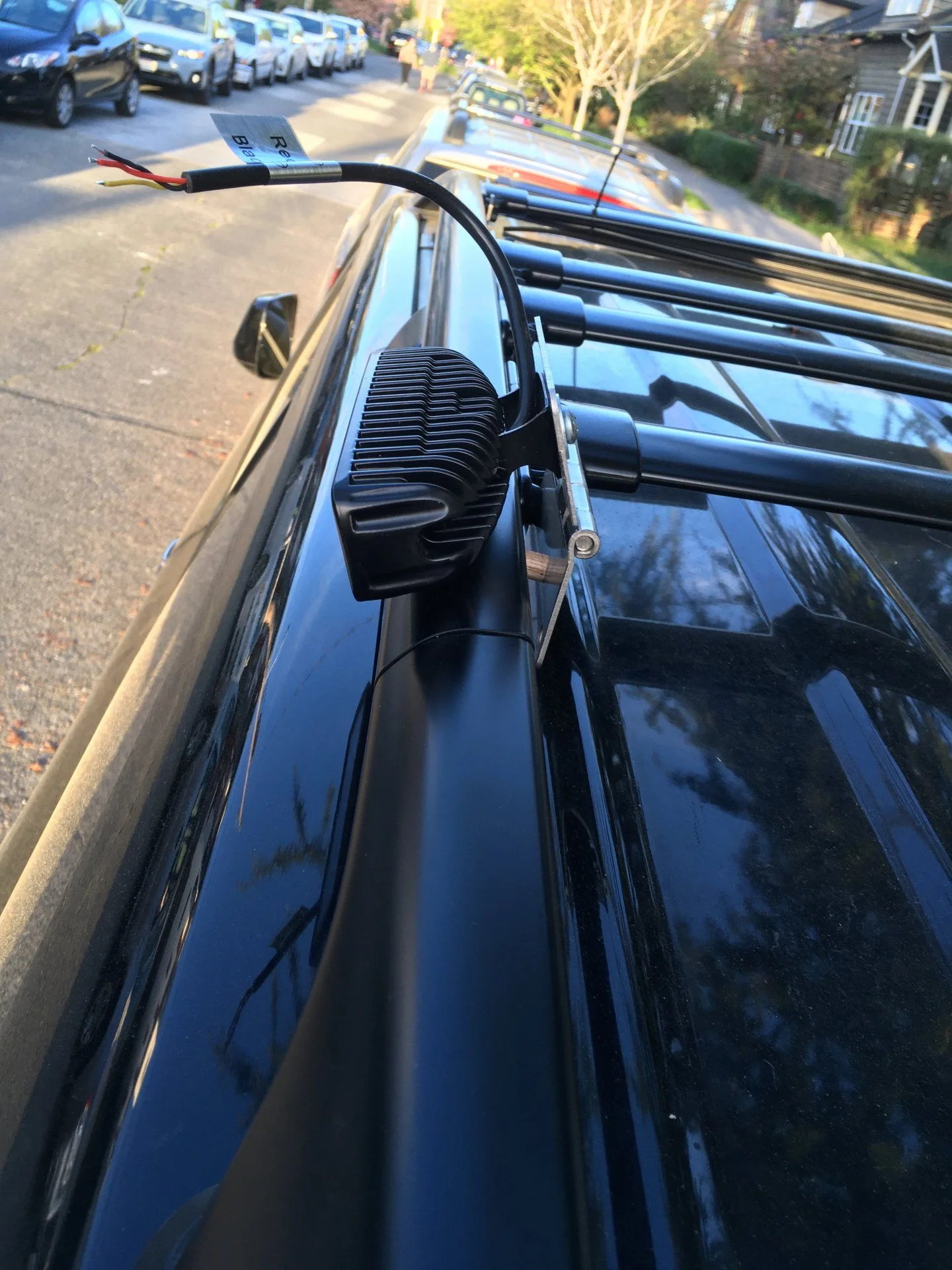

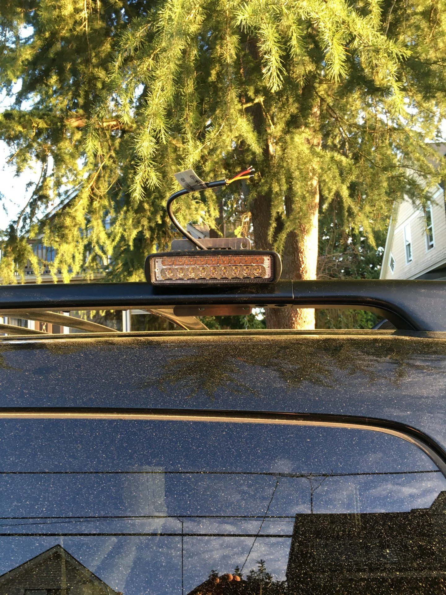

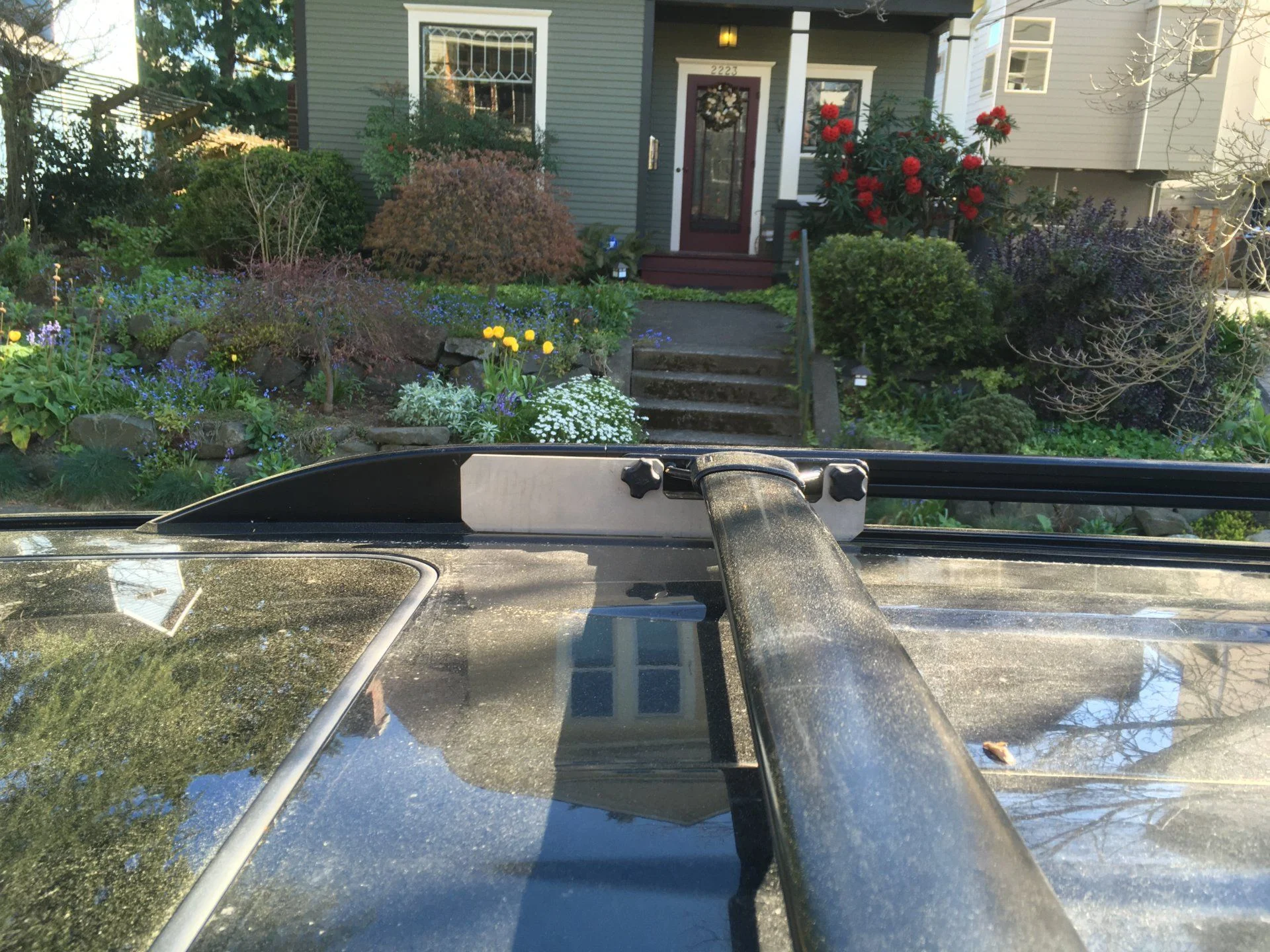

Working on the roof mounted front light. Clearly a lot of opinions on if this is the best place for a light. I absolutely see the logic of having the light lower, in the front fascia somewhere. However Santa didn't bring me a front bumper this year, so in a weak moment when I was flush with success from getting the TLC rack on, I ordered a set of the stainless brackets for the TLC roof rack . . . and then a generic 42" lightbar to drop in them.
It's a (let me read this again) Rigidhorse. I absolutely need to consult with China on naming, I have some rechargeable batteries called Arupoo. Some stuff just doesn't translate. Anyhow:
Amazon product ASIN B07MCNYV6P
No power up there yet to test with, but it looks like it will make light. There are some more expensive brands that have fancier optics (I guess) and throw better light (probably), but I'm pretty confident this will be fine. WIll report on actual performance when I see it.
As for mounting the brackets are tricker than trick. A few min on the drill press to drill the necessary holes.
The light required four padding washers (4mm, 3/16") to bolt up, so nearly an exact fit for width. Bolt up a true PITA, as I did it with the cross bar on the car.
Looks great, and that price is nice.
Wildyoats brackets are awesome, and I highly recommend them. Saves a a lot of fabrication and screwing about.
I went with the Black Oak, but probably should have done what you did. The lightbar is way more light than I need, especially given the rare use it will see.
The only thing I've found as a tradeoff is a bit more wind noise, but with the sunroof liner closed it is hardly noticeable.

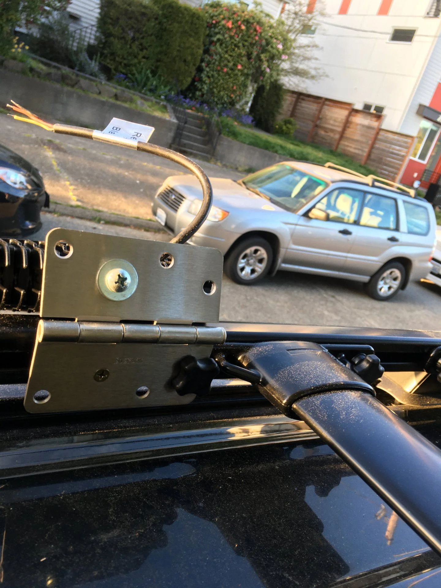

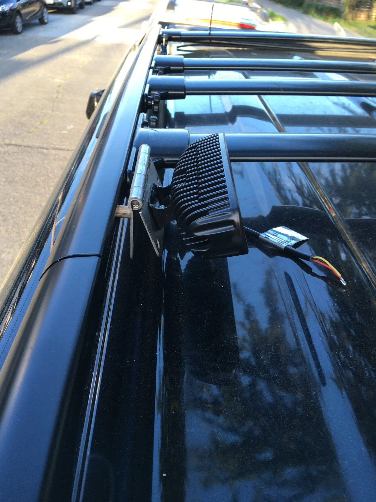

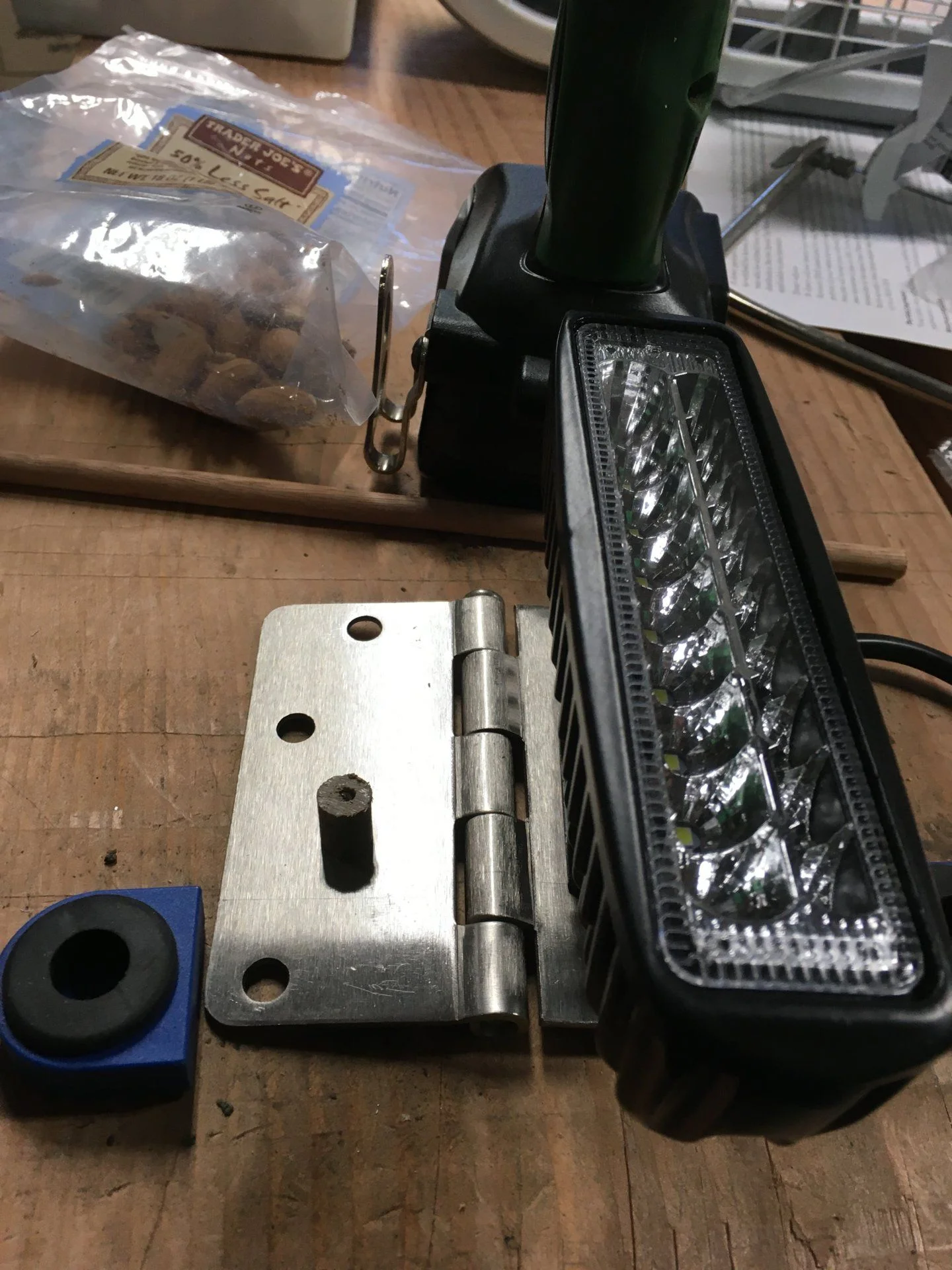

Proof of concept on a flip design for my scene lights. Using a random hinge. Have lots of improvements to go, but the basic answer is: Yes.

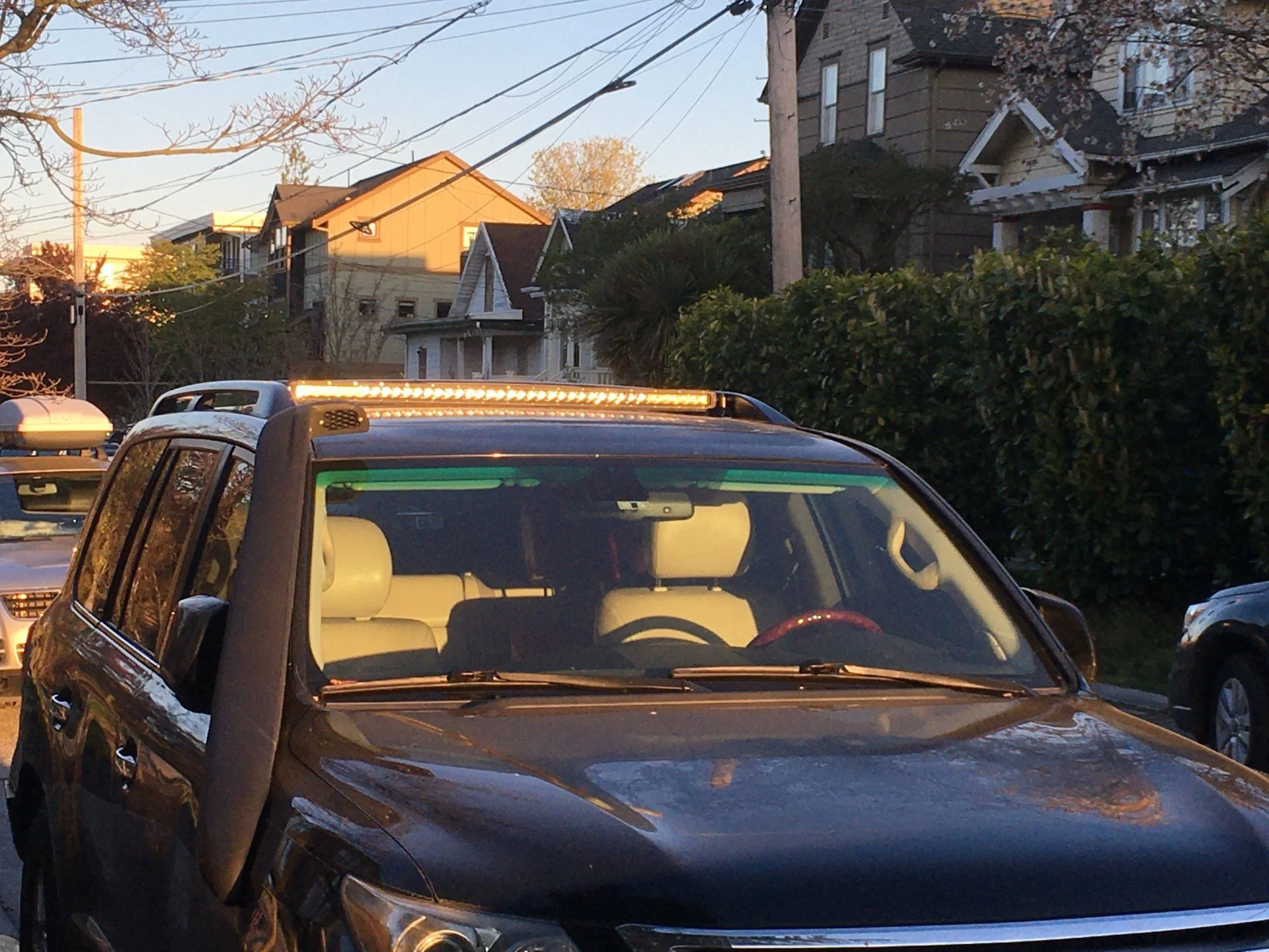

Let us know how that lightbar holds up through weather, etc!
Will do! So far all sunny days since I put it up there. I'll have it down a couple more times as I wire and paint. The weatherstrip I put on the bottom (it contacts the roof for six inches or so) that isn't actually in contact with the roof is already peeling in the heat . . . have to figure something else out.
I went with roof contact as I thought it might minimize whistle and I wanted it as low as possible. Right now only a few mm taller than a roof bar.

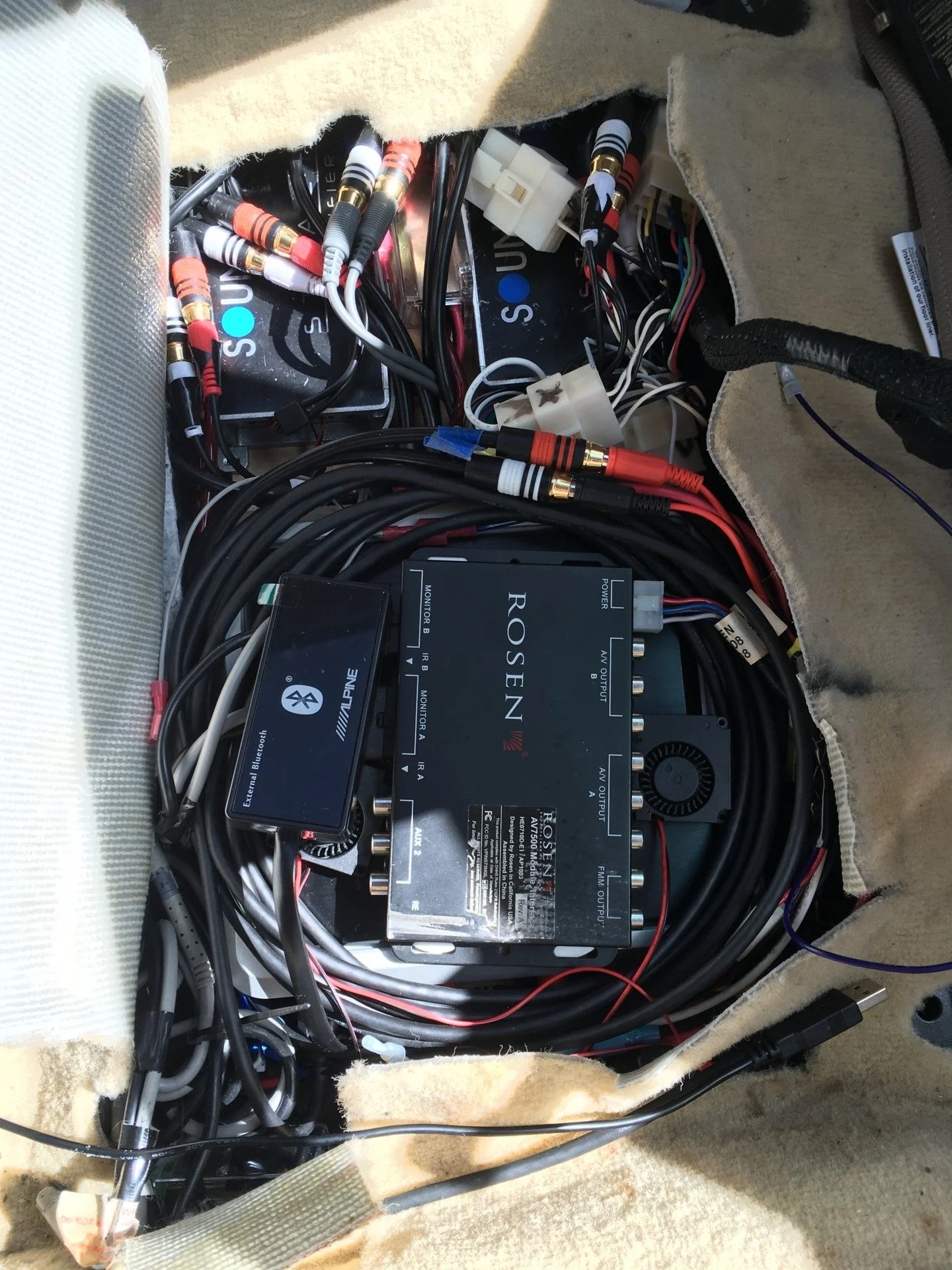

Definitely fits two amps and the dsp and the RSE. RSE turns out to be the source of a pretty strong ozone smell that I was having after about 90 min of driving; odd as it's been in since 2010. I wish now that my positive wire was about 16" longer, but you can't have everything.
Unlike the last configuration, I should be able to get to the amp gains (still have to pull the seat but not disconnect everything). This may or may not be useful.

Here are the amps buttoned up and with the space hog rse. I rolled the dice and left the spidf connected. It has a shield ground on it that isn’t at the same potential as the other grounds I think I can put a cap on it, or maybe just orphan the hurl and use the digital signal only With th other ground. Sometimes it buzzes very slightly sometimes not. No alternator whine now, so that is good.
it was some work to get the controller into the ashtray, but it is friction fit and folds away hidden Now. Very clean. So close to just dropping in, maybe a 1/16 or 1/8 “. I removed the controller casing and it fit.
