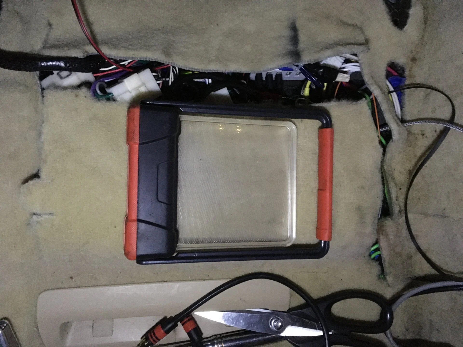

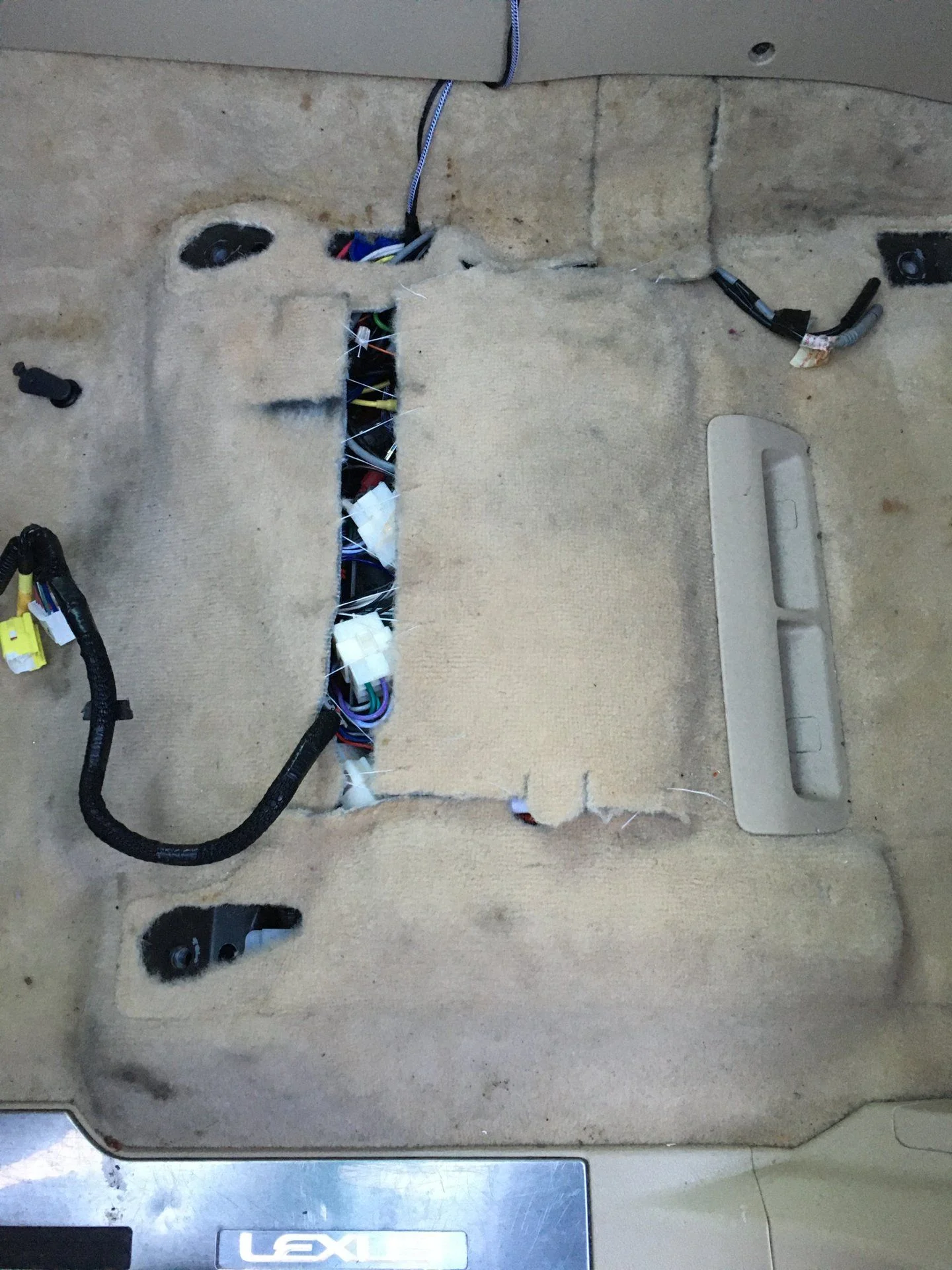

Power routed to under seat

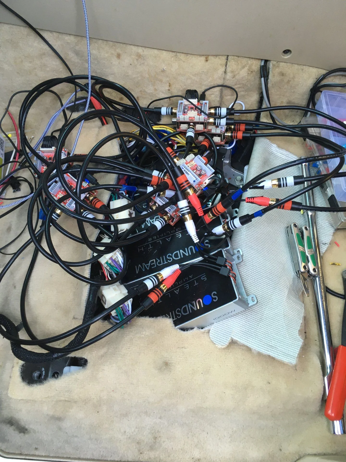

In a big push to wrap it up I got the amps wired, the usb x6, and ran all the RCAs. The amps come up, and DSP 5 (the first in the chain) is working. It got dark and I didn't get to trouble shooting, shouldn't be too much to fix, probably just reversed a connection from 5 to 1 and 3.
After the dry run I still have final wire ties and tidying up; am still optimistic it will fit.

I have the amps and cabling all wire tire and I’m trying to puzzle out how to fit the dsp and bulky cables into the remaining space.

pic is dry run before amps and speaker wires cleaned up.

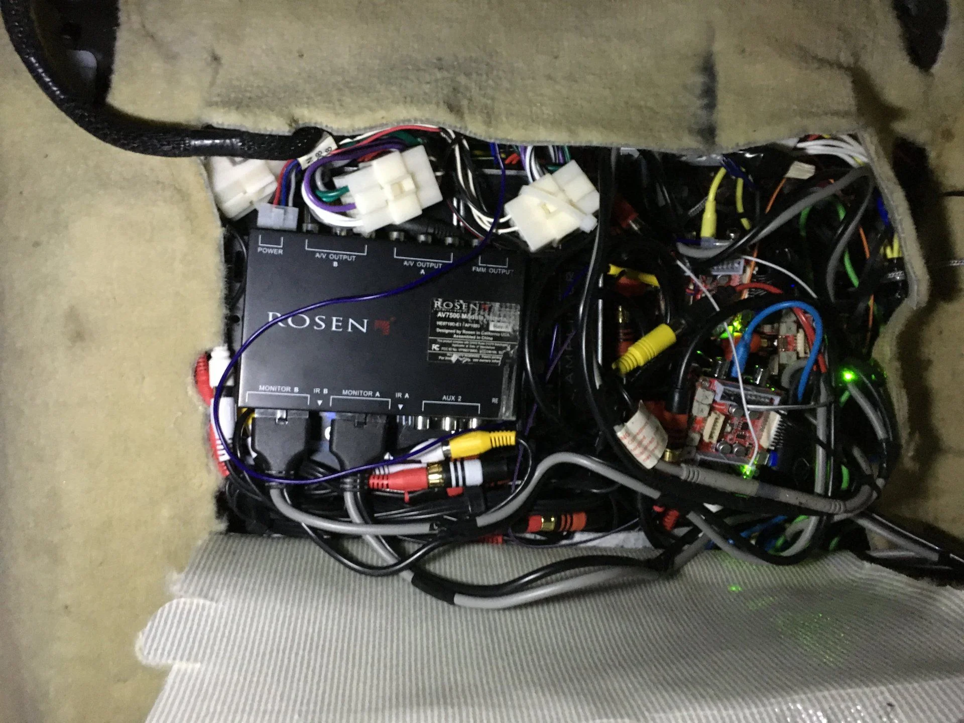

Mostly stuffed in the hole. Broke two usb power ports on two boards.had to solder the usb direct to the header.
No place for the Rse, it will have to go on the seat somewhere.

Is that all under the seat?
That’s the idea. I’m about 1” taller than stock with all those heavy rcas. Considering a different dsp waterfall and using some jumpers to get the fourth dsp channel that will reduce rcas by 1/3 and dsp by two. Right now it is too stuffed in and breaking things on the circuit boards just from trying to get to fit.

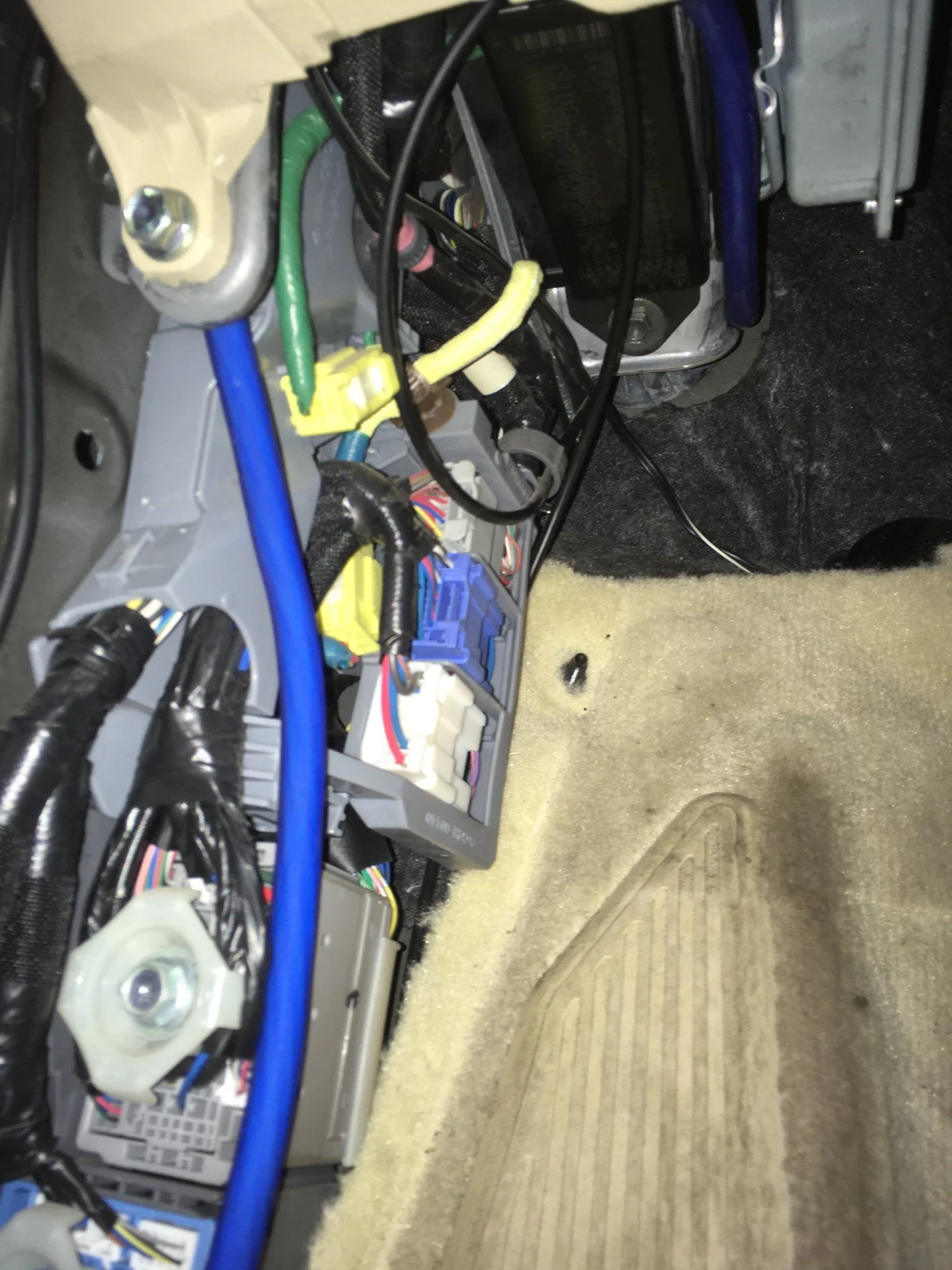

So on to the BOM for replacing the amplifier. Quick summary you need 12 channels of power, and the head unit feeds L and R with an available remote/acc wire too. There is two 12v and two G in the stock harness, 12 gauge I think. These are on a 30 amp fuse labeled amplifier in the engine bay. The space under the seat is about 8 wide, 18 long and 3 deep (inches) . If you reuse the stock mounts there is around 2” useable dept. There is more space toward the door, but it is not readily accessible.

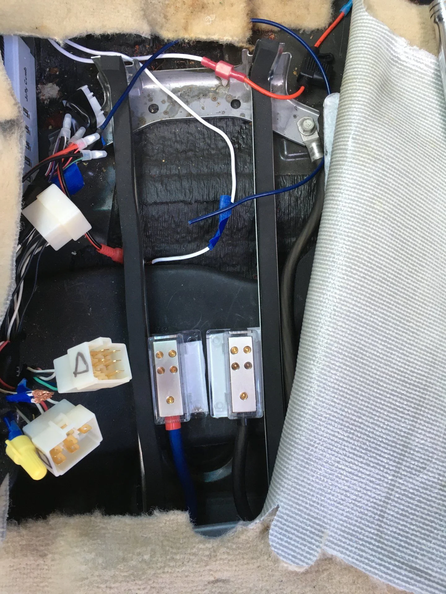

power - if you are going with a two or three amp solution, you’ll need to run a larger gauge from the battery. i used 4 gauge to provide head room for a Fridge and other possible accessories down the road, and left a space in the distribution blocks for this. I chose a 100 amp fuse, and have 3 30 amp class d amplifiers on it. I used the mplifier circuit to run the power for the dsps and rear seat entertainment, and put a 5 amp fuse in place of the 30. I see a 1 to four distribution block 4 gauge to 10. I fused the usb power separately, and used a relay on the acc so that the house power is running the accessories and not the acc line, that is used only for switching remote wires. To proactively manage potential grounding issues, I tied one of the two amplifier grounds to the house ground, and the other to the ground block / chassis. The usb and dsps were all grounded to house, as that is what the signal input is grounded too. Further the dsps were all grounded to each other with jumper wires.
Power section
15 feet 4 gauge used about 10
5 feet 4 gauge used about 3
100 amp fuse and holder
two 4 gauge tinned crimp lugs 3/8
two 1 to 4, 4 to 10 gauge distribution blocks
six feet of 10 gauge for amplifier lead extensions
various connectors for the extensions
six feet of 14 gauge for remote extensions
1 12v usb six plug
1 12v relay
even more wire connectors

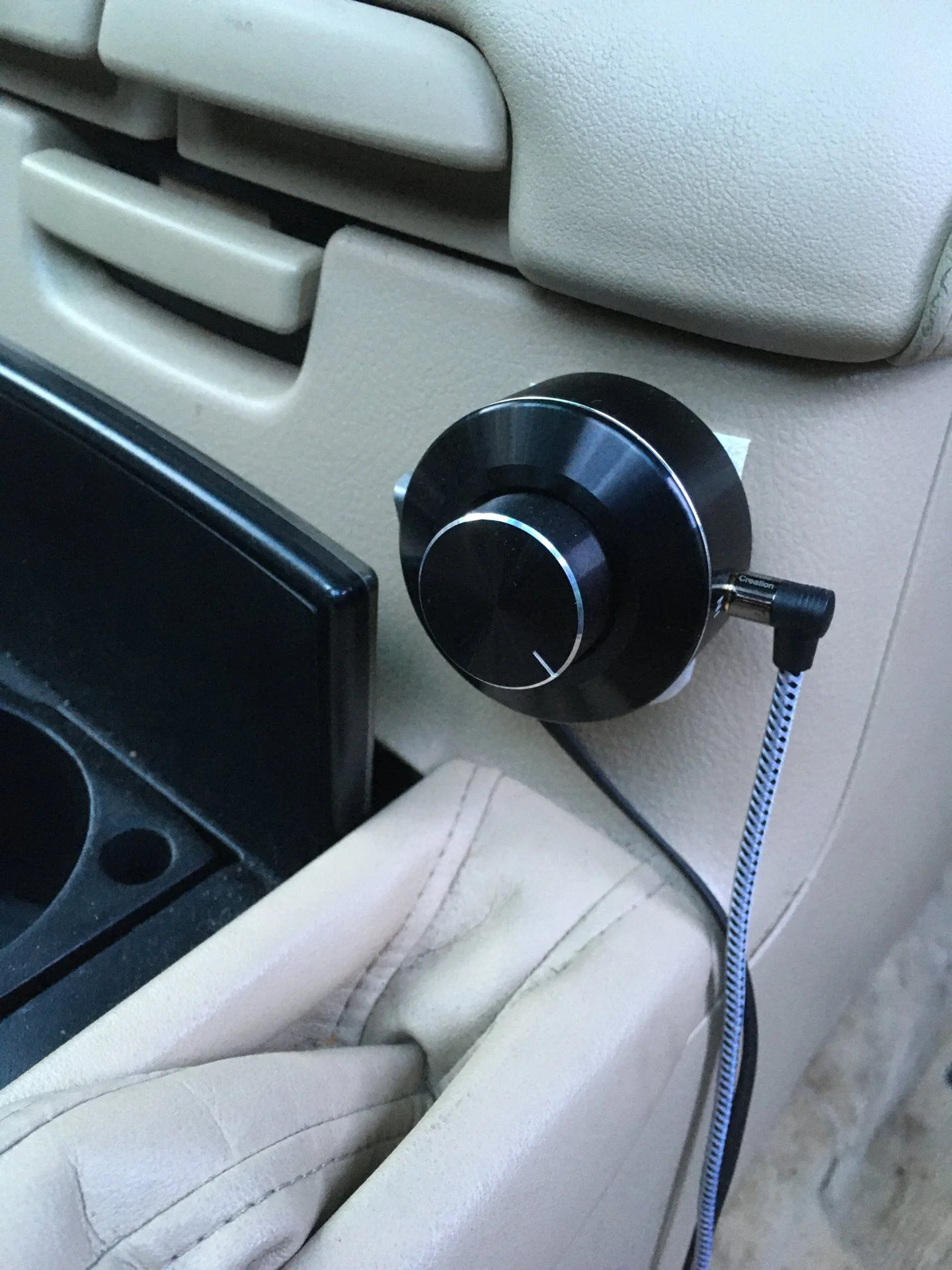

1 volume pot. I used a little bear with two,inputs and mute. It broke. Im now on a nice aluminum alloy pot only. I also bought an electronic vol with remote that I may mount in the ashtray sometime, but that requires some fab and I don’t have time right now.

and the volume pot. Using command tape while I decide if I like the location.

seat position is high. I usually have it high so no biggee. Might be an issue for a taller person.
