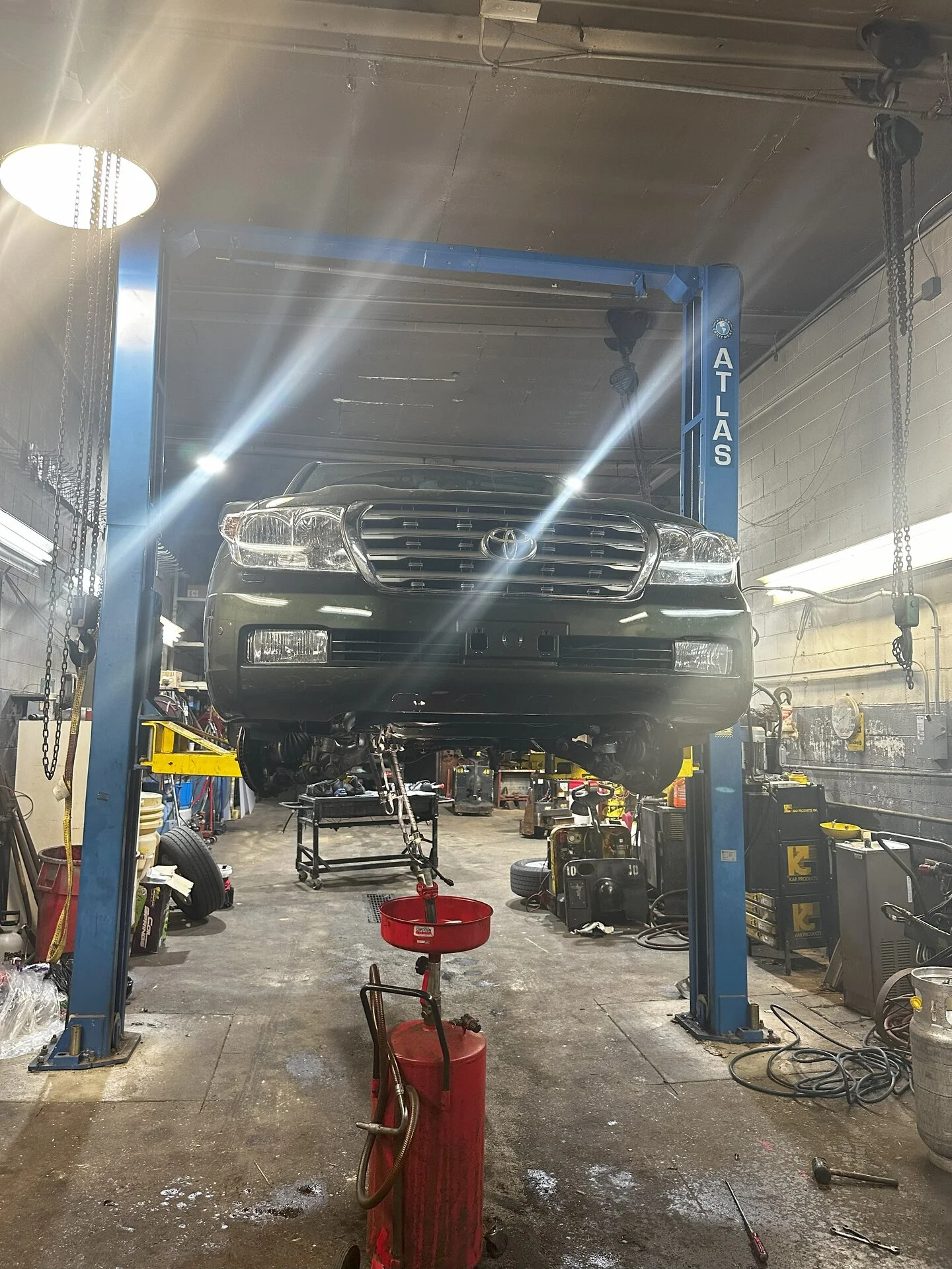

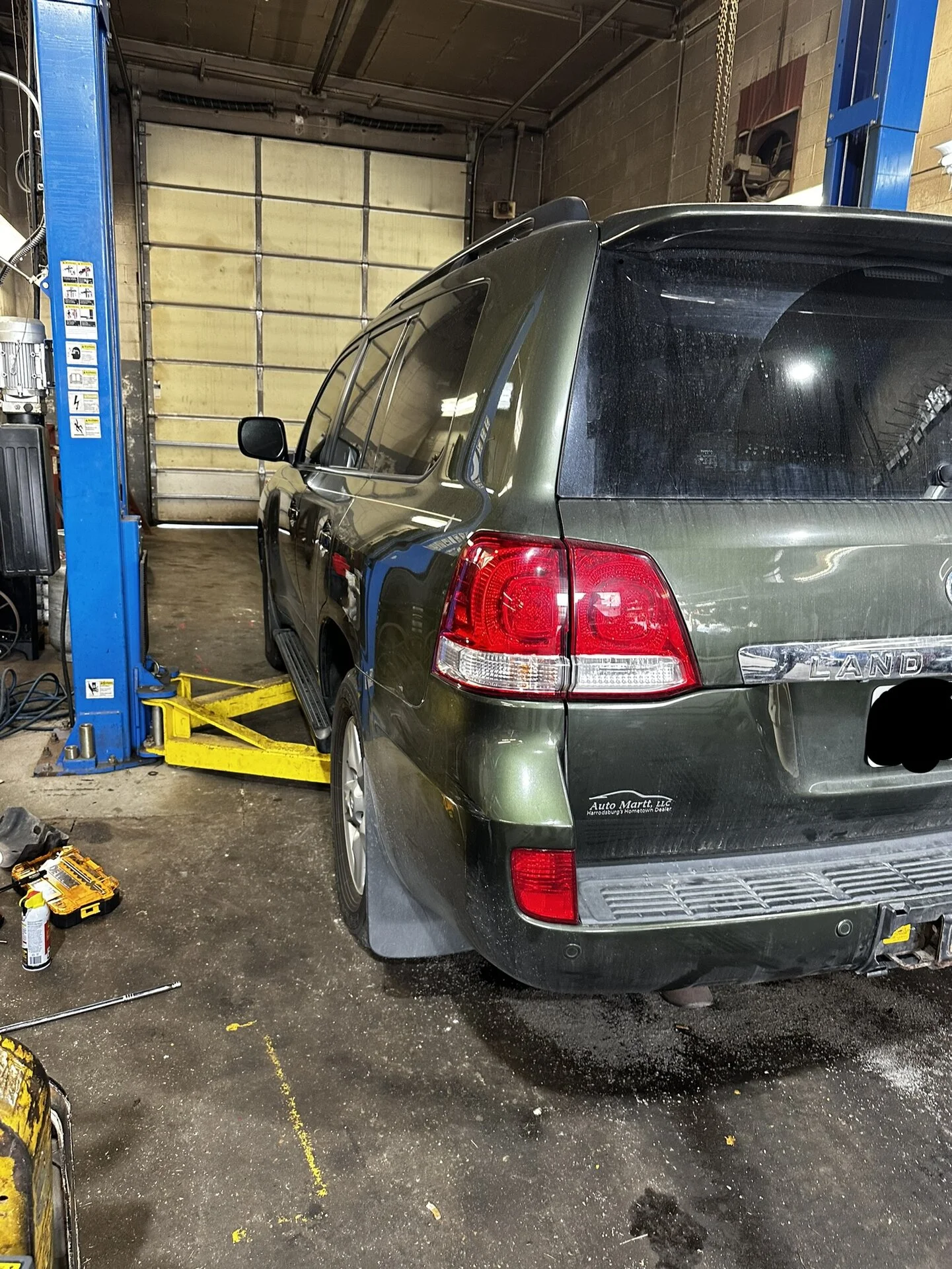

Within 3 weeks of owning it, I started noticing some issues. Oil on the garage floor, the power steering fluid starting to get a little lower, a little coolant leak, and a rattle noise when I would cold start. Then I thought, oh crap what have I done. This LC200 is supposed to last forever, they shouldn't have these issues. I put it up on our car lift and got to looking and noticed the oil was coming out of the pan seal. That's no problem just need to take it off and clean out the silicone, change out the old gasket, and reseal it, easy job.

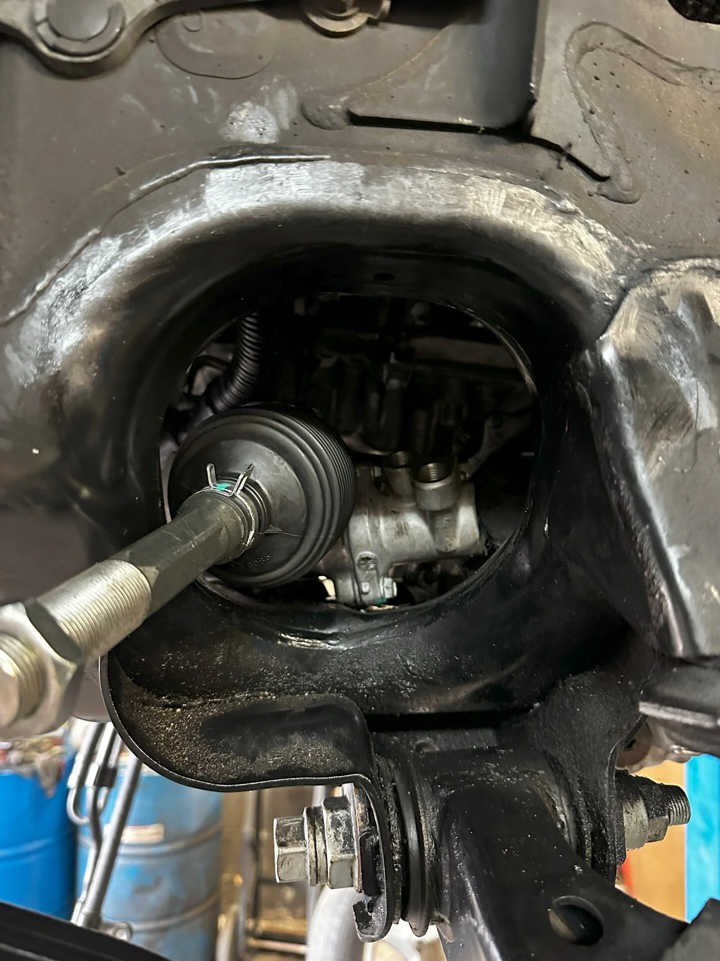

I started doing research on the power steering system and where to look for the leak. Then I found it, the steering rack had a busted seal and needed to be replaced. I'm pretty handy and love working on cars and trucks but this one I knew was going to be rough.

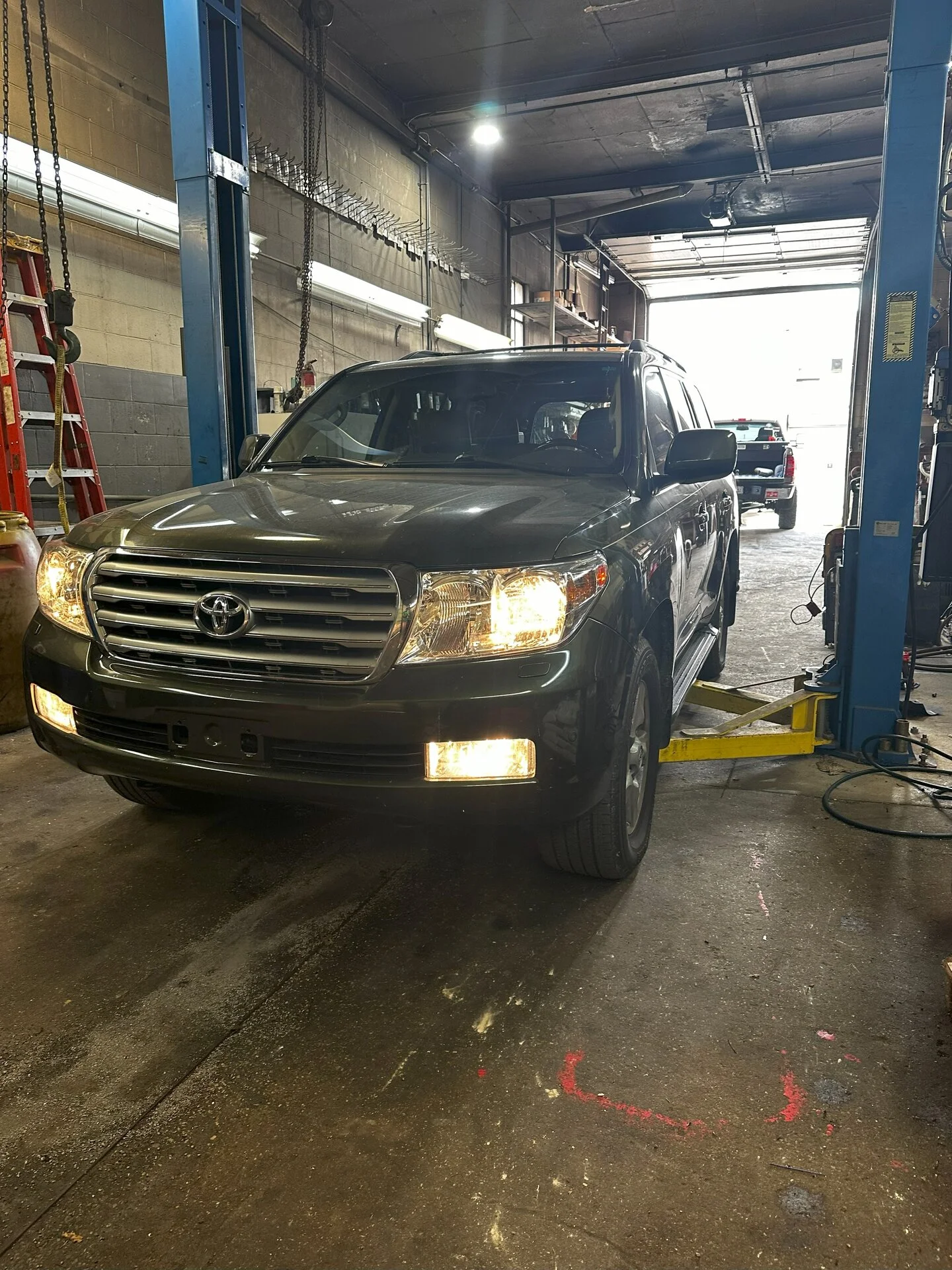

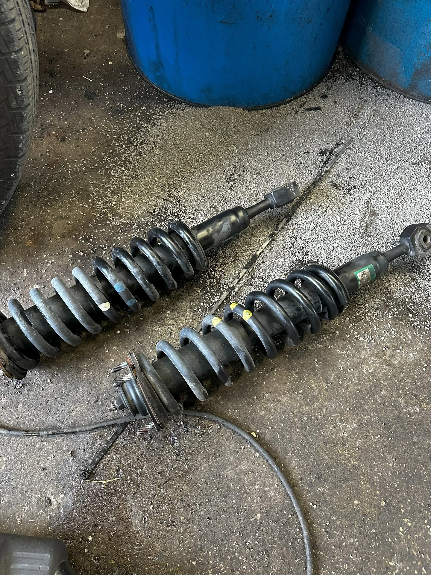

I took it to a local shop to have them look at it and confirm my suspicions and sure enough it needed to be replaced. They also diagnosed the rattle had to do with the timing chain. One of the tensioners had either failed or broken. I got the quotes and had them do the timing chain and I said I would tackle the steering rack. We also determined the rear shocks were shot, so logically I needed an all-new suspension system.

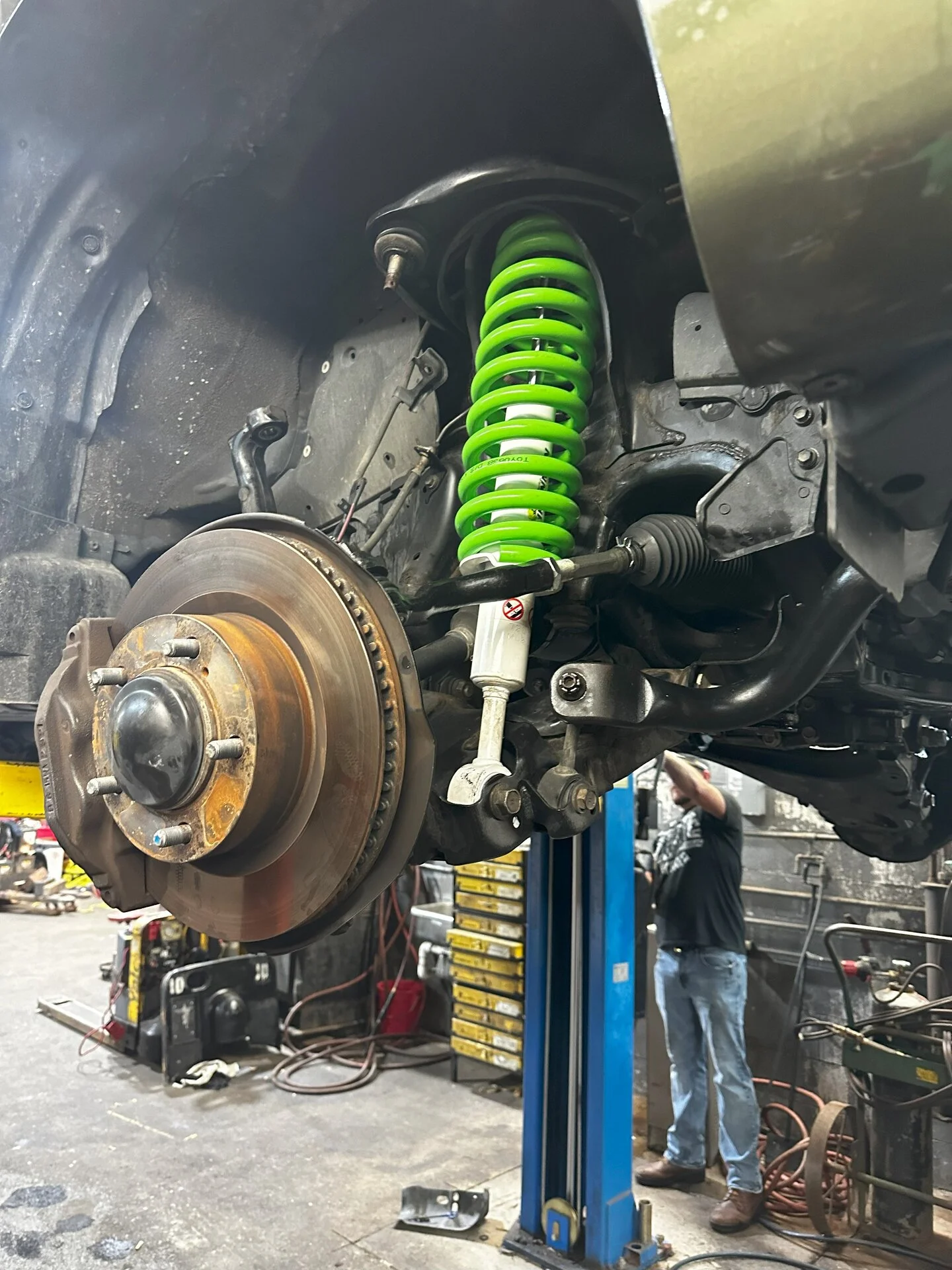

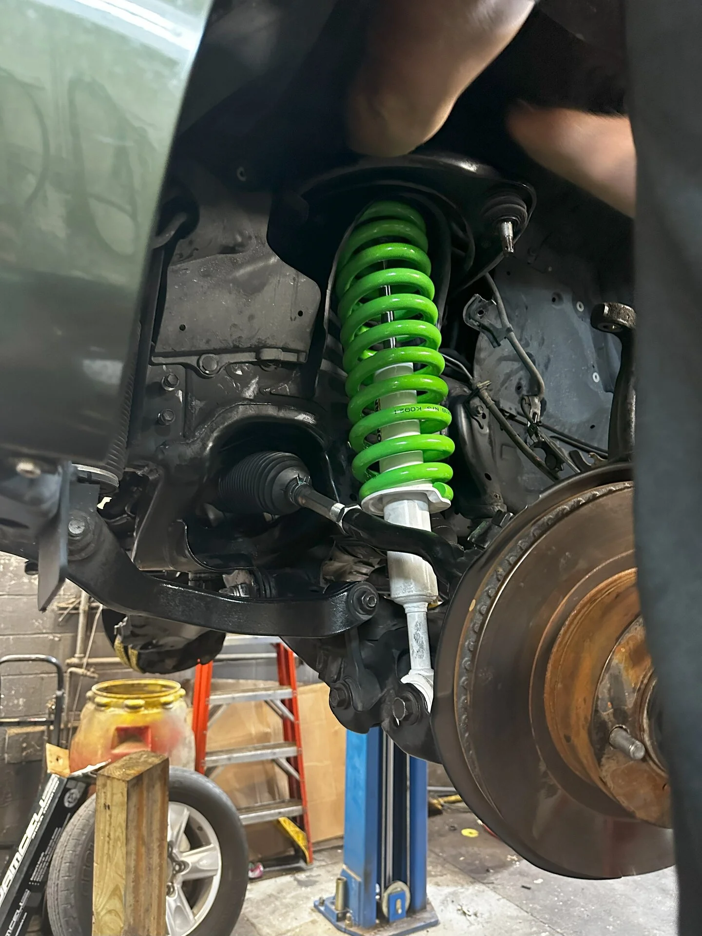

I really don't know what I'll do with the Land Cruiser as far as off-roading goes. I felt that buying a $4k off-road suspension system that I may or may not take off-road would be overkill to start with. I ended up choosing the Ironman 4x4 stage 1 Nitro Gas Suspension kit. I got the medium load for the front and the Medium plus for the rear. After getting all the parts in I had the garage do the timing chain and started researching how to do the steering rack. 2 weeks later the shop finished the timing chain and I got it back and went to work on it later that week.
We started on Thursday at 3:00 and worked on getting the old steering rack out. We finally managed to get the old one out by 9:00 that night, and it is not for the faint of heart. Some notes for the next person. Take the sway bar off (we did that the next day), remove the oil filter housing unit (we did that the next day), also if you are doing front suspension at the same time, you can gain a lot of room by removing the front coil overs (we also did this the next day).
The next day we removed everything that would have been in the way and got the new rack mounted with fewer problems. It wasn't easy but we managed to get everything secured, got the hoses and steering link attached, and everything we took off back on. We started this at 12:00pm and finished it by 7:00pm. We then did the front and rear suspension, topped off the fluid, bled the power steering and took it on a test drive. We finished the project at 12:30 am

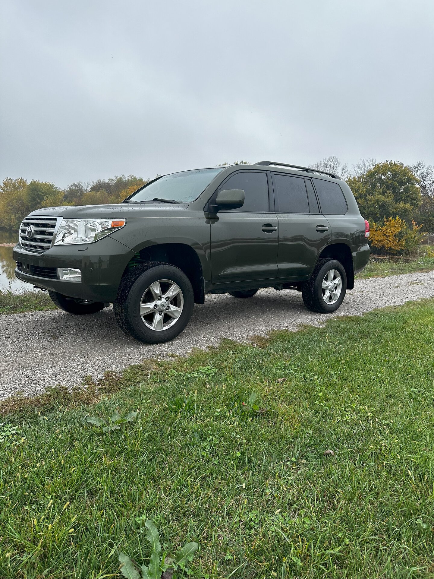

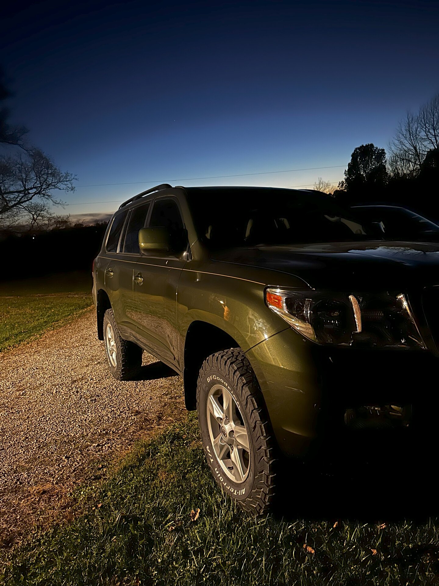

The next morning, I checked everything over, put the stock skid plate on, took off the OEM Running Boards, and went to the car wash. I love the way it turned out and am super proud to have completed a job like this. Now it's off to the shop to get aligned!

KO2's are on and they look and feel incredible. There's a little rubbing on the right front mud flap. I do want to get these flush with the wheel well before I get to trimming.
