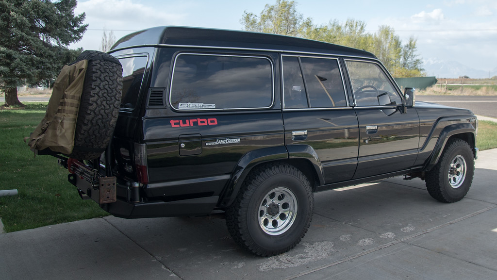

So today I got the rest of the bumper installed. Yesterday I picked up the bumper from the powder coater and installed it. Today I got the spare and high lift mounted up. I couldn't be happier with this bumper! Jason from Trail Tailor is great to work with and builds a rock solid product. I can't wait to get the sliders from him and see what he comes up with on the wife's 70! Here are a few pics:
Whoo yea, that is nice.
Thanks guys! It's getting there. I think next is the lift and front axle rebuild (knuckle rebuild, new axle shafts and birfs, nerw TRE's, etc....). After that I will be working with Jason again to get a front bumper to match the front! Beyond that we will see what else the wife will let me do! Lol

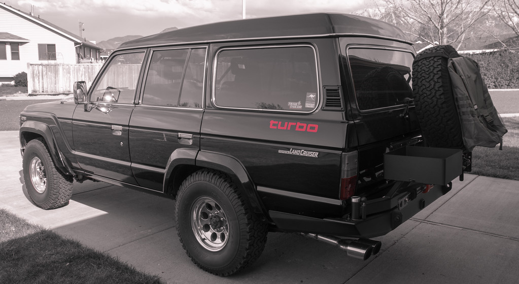

Today the wife and I cruised up to Wyoming to meet with Jason again. We had the sliders/steps welded up to Stoffel and dropped off her BJ71 for Jason to mock up some bumpers on. The sliders turned out great! Jason does some awesome work and I couldn't be happier!
Those sliders are awesome! @reevesci Great idea with the perforated metal for the steps. Did you go paint or PC? (I'm guessing some VHT paint).
Just in love with the high roof. Are you planning on blacking it all out? Think Mr. Tibbs would look insanely good (I know there are two definite camps on Chrome/vs black out).
