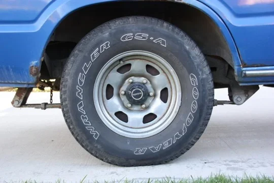

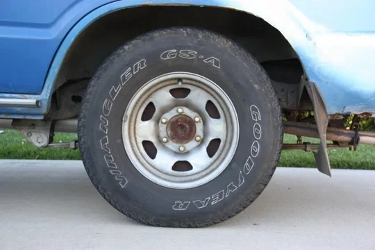

Finally got out and took a trip off the pavement up Mount Palomar via the Nate Harrison Grade Trail for those that are familiar with the area. A few of the bumps taken along the way has me wondering if the ass end of the truck needs a little suspension TLC.
The leaf springs are pretty flat as you can tell...
I'm assuming it needs work (new springs, re-work old ones, or maybe a AAL) but are shocks part of the deal as well or is there some other way to tell when those things go?
Those rears have negative arc....they're toast. An AAL is just going to do all the work in those packs and wear out pretty quickly. You could make them last longer by re-arching the stock springs...if you have a place in your area that does that. My rig has re-arched OEM springs and long add-a-leafs and it's been holding about 2.5" of lift for a couple years. Or you could just drop the coin now on a lift...good deals on here from many vendors.

Time for a suspension kits w/shocks. Those things look beat!
My front springs were getting close to that so I put extendable shackles in there :D the rears should look like a half moon.
Ha. Yes indeed they do. So new ones will be placed on order; thankfully the first mod I put on old Blue was a credit card reader making it far easier to dump money into it... dang it!

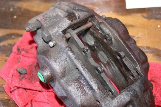

So the suspension was the closest alligator to the boat until I happen to have the window down and heard the terrible sound that was my front brakes.
No problemo, swap the pads right? Well I can't get one of the damn pins out. Tried a gallon of WD-40 and using a punch (that's what it took to get the other pins out) but one pin just isn't moving. Any harder and I'm probably going to mushroom the back of the pin..
Any ideas short of replacing the caliper? If I replace one, must the other be replaced as well?
Calipers can be independent replace but if you can get the pin out then I would get a rebuild kit from Toyota and call it good. Try some penetrating lube like PBBlaster, remember WD-40 is not a lube, only a Water Dispersement.....
While I did go out and buy some PB Blaster for the next time, no amount of canned product can undo the magic that was me, my hammer, and my center punch on Wednesday night. Ha!
Note the mushroomed caliper pin that is still stuck in the caliper and take a look at the fine job I did replacing the pads before they wore down. :doh:
The caliper didn't come off as easy as I would have hoped but a bit of PB Blaster mixed with a 3 foot breaker bar had the old 17mm caliper bolts off in no time. The new one went on with ease and had me wishing that I just replaced both calipers instead of fighting the stuck pins. My time is worth more than the $40 I paid for the new one at NAPA.
