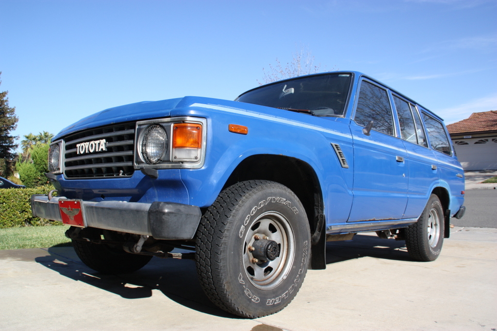

A pic or two...
Wish me luck.... I have no idea what I'm doing.
Welcome to MUD :flipoff2: <----- Official IH8MUD Welcome
You're gonna learn real quick if you love that thing like all of us do. Looks like a great starting point. Thanks for saving a classic :)

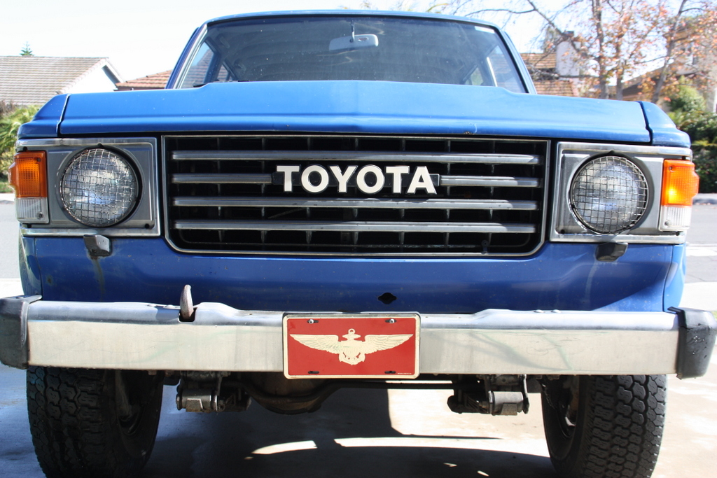

That color looks familiar!? Lol. SOA sounds a little crazy adventurous to me but if you can do it that would be cool. Oh yeah your first mod should be a driverside mirror, lol. Nice ride. Good luck with the build!

Nice rig!! Love the blue..
Keep it SUA if only need/want to run 33's, it will keep things simple.

Nice looking rig, where about in SoCal are you? I'm in San Diego (Clairemont) and if I ever get my new to me door mirrors swapped you're welcome to my old ones. They ain't pretty, but will save you a ticket! :flipoff: welcome to Mud!
See this is what I'm talking about. Tips-o-plenty. Engine and 37's? Damn. SOA is f-in' out. SUA, you're back f-in' in. Boom.
Yeah, smart glamor shoot angle on the new ride. Old Blue has got this real hard to find, custom mod that a special gravity based mounting system of the driver side mirror under the driver side seat. Yes, I keep the broken off mirror under the seat. Maybe it's so I can say it just happened and sneak out of the impending ticket.

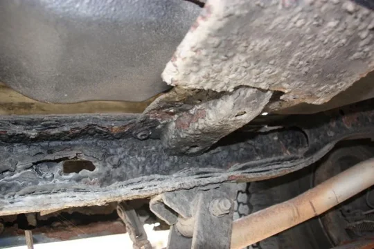

So here's the next challenge I've been avoiding.... cancer...
So the grinder and wire brush still need to come out and get some work but I'm curious as to anyone's thoughts on the extent of the damage from rust. The vast majority of the frame looks fine. Some light surface rust but nothing serious.... until you get to the rear leaf spring shackle.... then it looks like this...
and this....
So yeah... not the best but the question is how bad? There is about 12-18 inches of the nasty, flaky stuff. Seems like the frame is still sound and I'm not planning on taking this rig off a jump anytime soon but I also don't want the shackle to snap off.
2 cents appreciated from anyone.

That rust does not look pretty but I think there's a thread about that area and how to replace.

4. Rust.. rust is the bane of these trucks however yours does not look too bad. I would look into joining your local club and having one of the more knowledgeable guys go over the truck with you. Most will accept payment in beer and pizza so the trade-off for knowledge is perfect!
