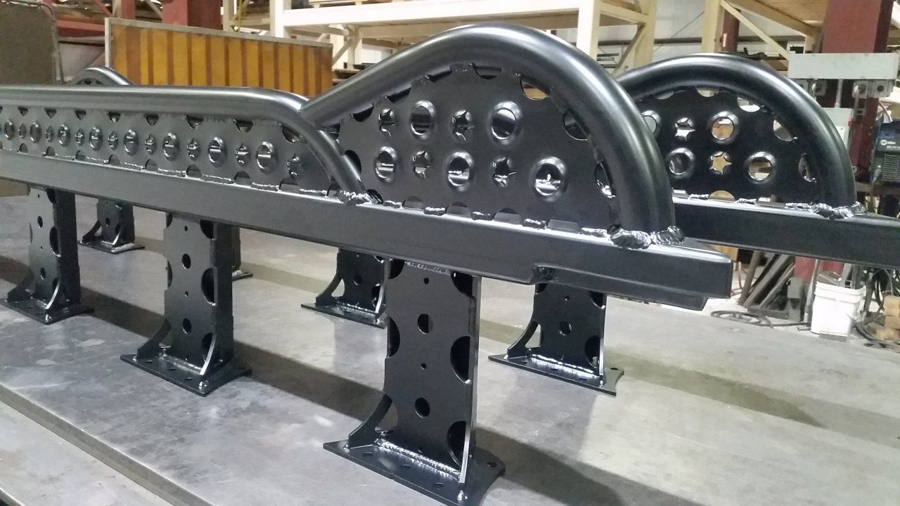

The last two nights iv put in some late hrs so that I can get these sliders finished , powder coated and mounted on the truck by the end of the work week ... so far I'm very please with the results ...
When that welding machine is dialed in just right :)
You'll notice I decided to add a 1"x1"x6" long notch at the front of the slider. .. I'm a stickler for detail and preventing what might could happen in a worst case scenario. .. I notice while fitting the slider, where the body panels come together down the vehicle about 6 inches from the front fender, the panels curve out to the outside of the vehicle ... in the case that I slam down hard on the slider the notch will dodge where those panels come together. .....hopefully
