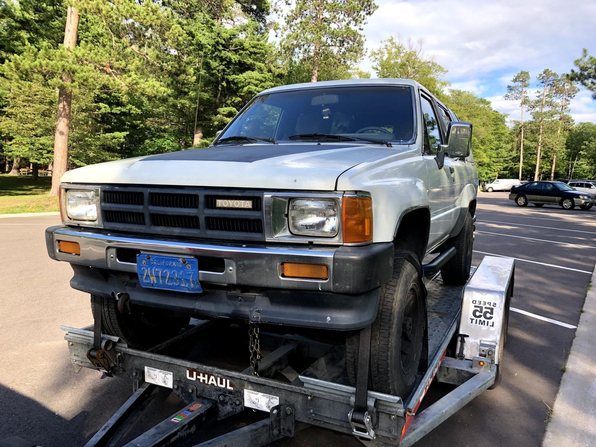

Very excited to have picked up my first novelty vehicle. I've wanted a first gen 4Runner for a few years now, and with us essentially moving down to only using our newer wagon, I had my oppertunity to swap out the old minivan for a "family adventure vehicle". Was expecting to have to ship or fly to find something rust free, but happened to find a recent rust free California import in, of all places, the Upper Peninsula. 472k miles on the clock, but had just had a crate motor dropped in, new CV axles, and the brakes and suspension all feels like they have been serviced in the not too distant past. Made the trip up there and just took it home.

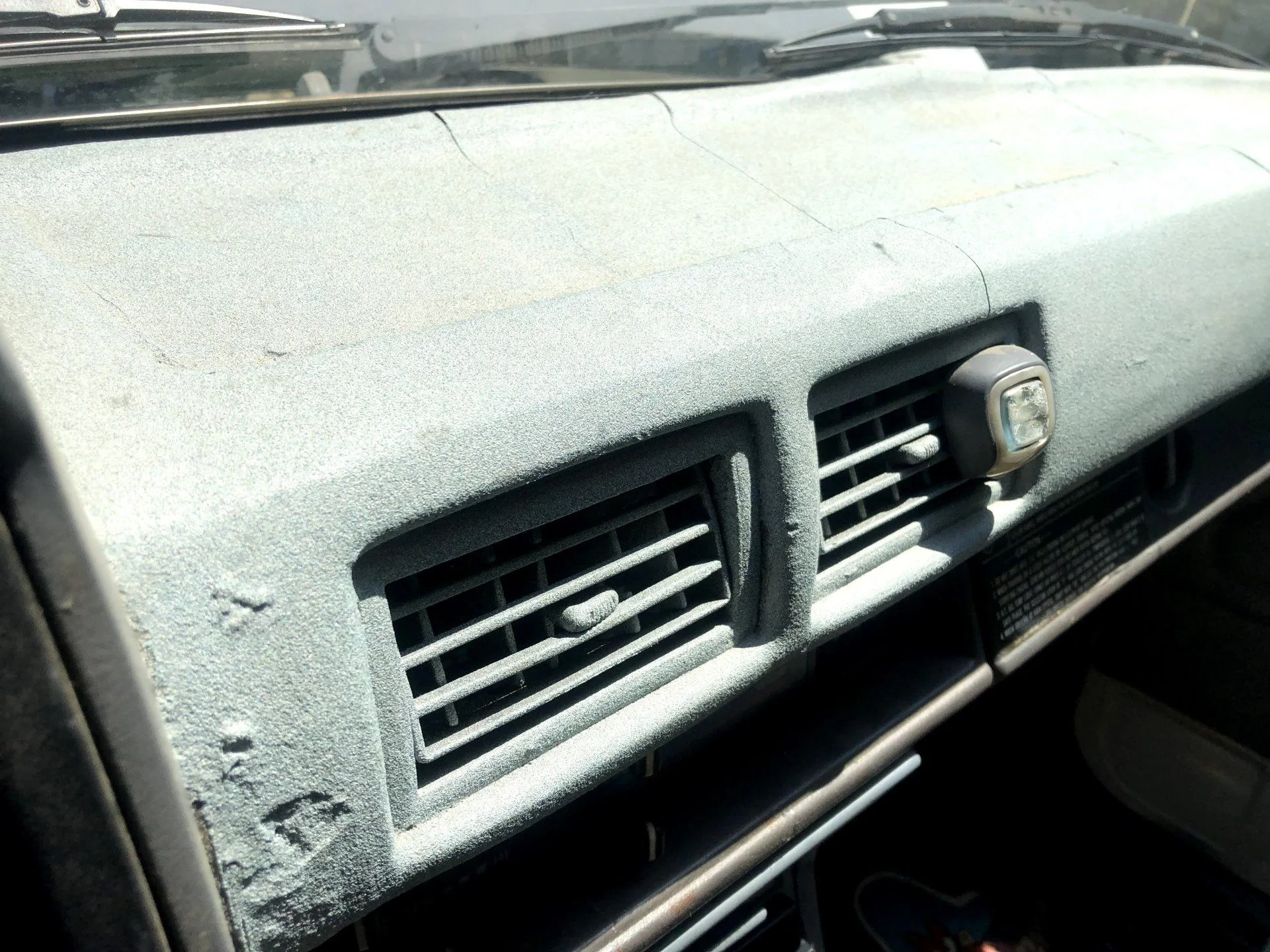

Inside is a little hit. Looking to either replace the front seat or have them reupholstered. Any advice on that front? The dash is the other real problem area. I'm not letting myself worry about/focus on it right now, but it's a real s*** show and I'll have to figure out how to address that.

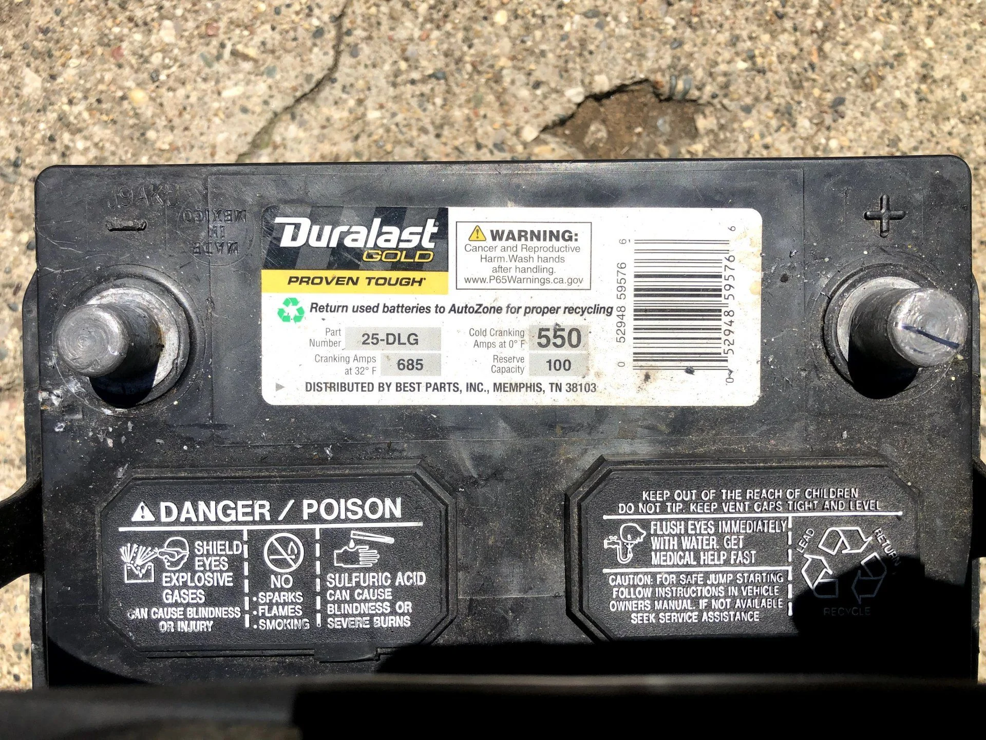

Battery/starter - what should be "enough" CCA on the battery? It has a fairly new and still good 550 CCA battery, but if it sits at all or if you use any electronics in ACC it won't turn over at all. Could this be something with the starter, solenoid or wiring? Want to get that proper before I just drop higher output battery in.

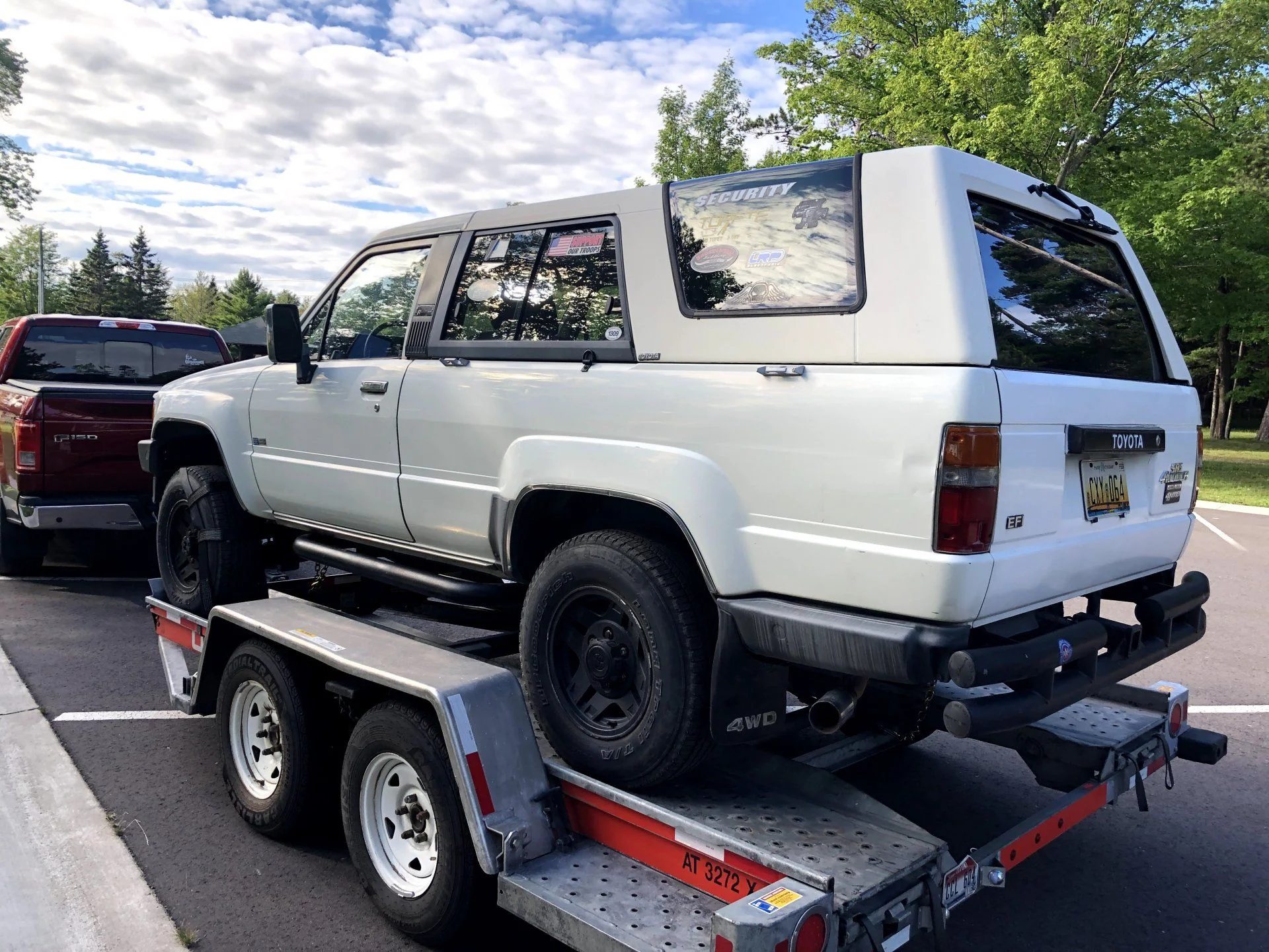

Lift - front end sits higher than the rear. I know the leaf springs can sag, but this seems like someone messed around with the front and didn't do anything to the rear. I'd like to keep this fairly stock, no need to have it really lifted. What is conventional wisdom here for a more "mild" setup and what further info can I provide to help figure this one out?

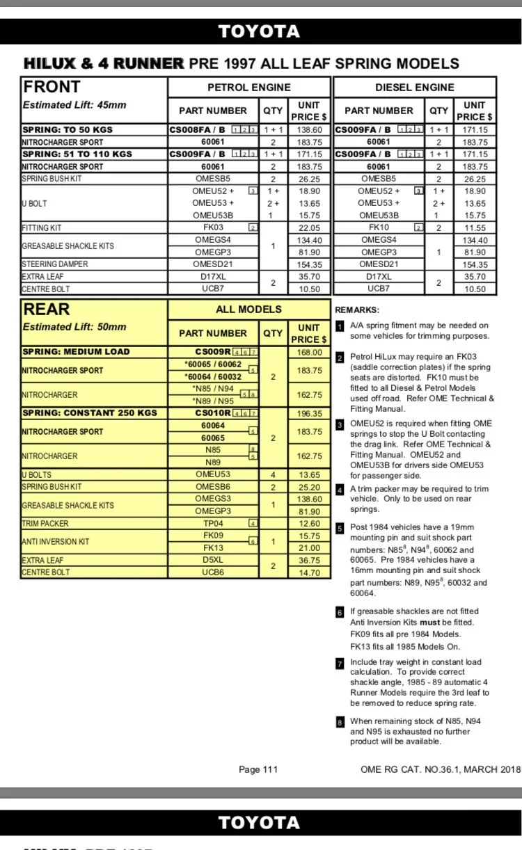

My 86 pickup, with 434k miles, sits like that with original stock rear springs and the original front torsion bars. I got the mildest OME rear springs and am waiting on shackles and U-bolts to show up before I can install them. My plan is also minimal if any lift, but something better than worn out springs.

Great to know it's probably just worn out leaf springs. What specific OME springs did you get? And good tip on the citrus cleaner, I'll give that a shot first. Thanks.
I think the CS009R are the lightest from OME. Someone else may know more.

Far f'ing out man, thanks. Did you find a pair for the price listed there in that table? Even the price I found isn't too bad. And what u-bolts did you go with? Trying to get everything sorted and feel like I saw two different options.
Alternatively, I've also discovered I could just put longer shackles on as a more temporary fix. TBH I'm not quite sure what the ride quality is like yet, so may just have to get a better feel for that first to decide if the OME springs are needed for ride quality, or if I just need some shackles to raise it up.

And thanks for the advice on replacing everything. I took a closer look at the shackles tonight, and they are toast, to the point they are actually sitting more like 45* from the body, which accounts for a good bit of that 3.25” difference in front and rear. I was also talking to my FIL tonight who was a mechanic back in his day, and he gave me the same advice to just replace the springs now and do the labor once. So I’ll be purchasing a set of the OME springs mentioned above.

I found my springs locally from someone who put em on but wanted way more lift. I ordered greasable shackles and OME U-bolts from Low Range over a month ago. They finally shipped this week and their communication was as though they were nihilists. They were the only stock length shackle I could find. I got toyota bushings for the shackle end and poly bushings for the spring eye since I don’t know if the OME spring matches a stock bushing. In general I dislike poly bushings.

As for the shackle angle, this is my 85 4Runner rear shackle, about 3.5" lift springs, I dont remember how long they are. Not very.
