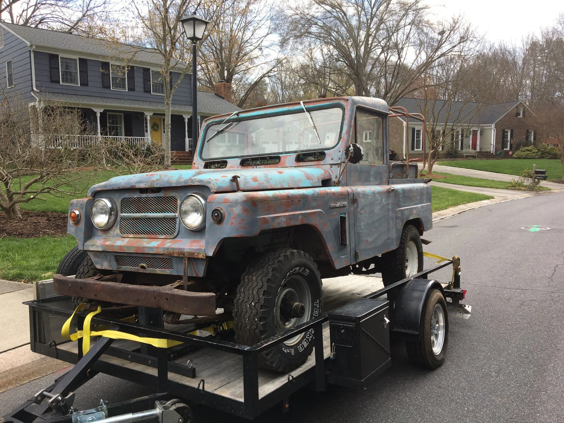

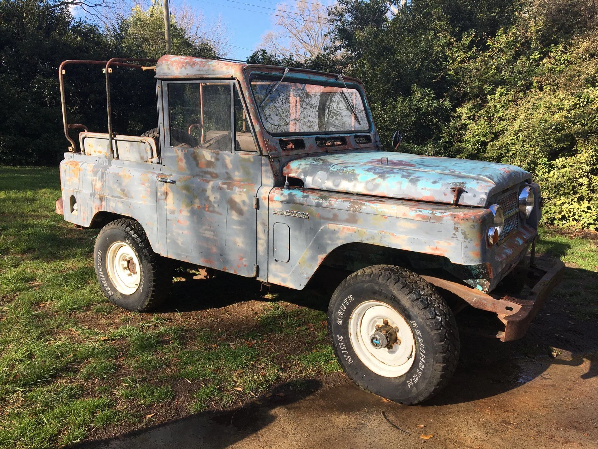

You know the drill - late at night, your spouse is asleep, and you are searching the depths of Craigslist. A single fuzzy jpeg of a 51 year old catches your eye. Next thing you know, you are loading a 1966 Nissan Patrol on your motorcycle trailer and bringing it home. After 6 months of it sitting under a tarp, I decided I better get started on wrenching.
From backyard find, to road worthy is the goal. No restoration. No mods (other than safety). Just a budget "build" to get it driving to the beer store. Maybe, just maybe, a little bit of mud. So, help keep me focused this winter to get this old girl back up. Think more Roadkill, and less Barrett Jackson.

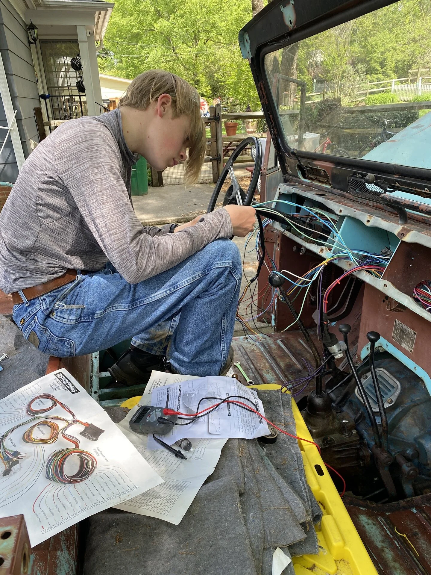

First step is wiring harness - it has none. Well the PO started installing a cheapo aftermarket one.

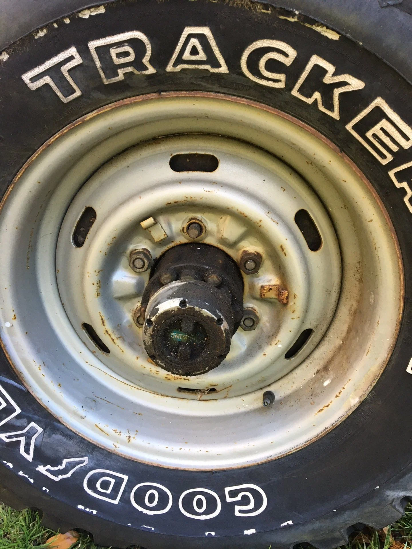

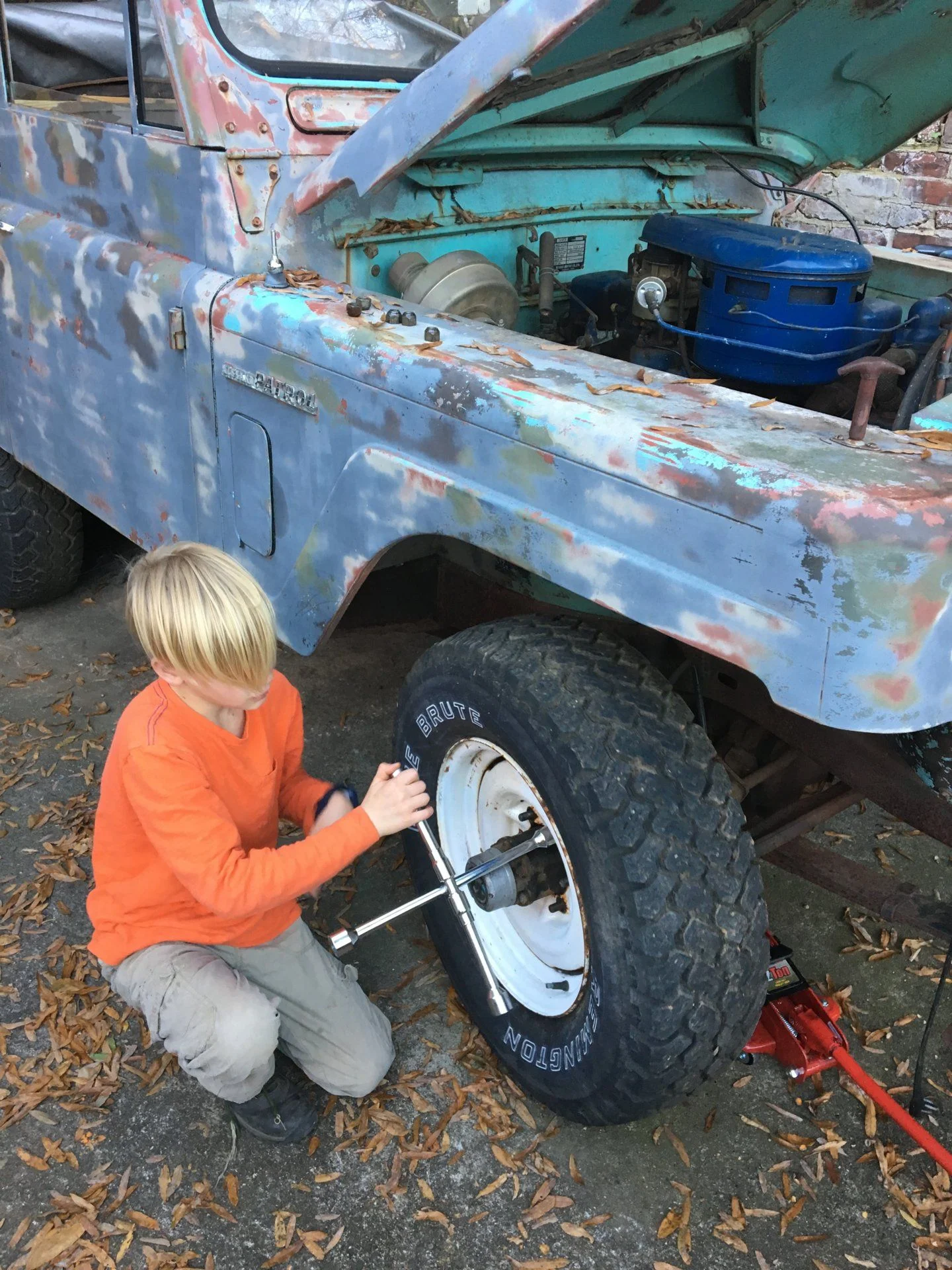

When acquired, the truck had 4 generic wheels that matched with 4 unmatched tires - none that held air. Years of sitting flat had taken its toll. The spare was an oddball wheel. Anyone recognize this style wheel or what it belongs on? It has hub cab clips. Happy to let it go if someone needs it.

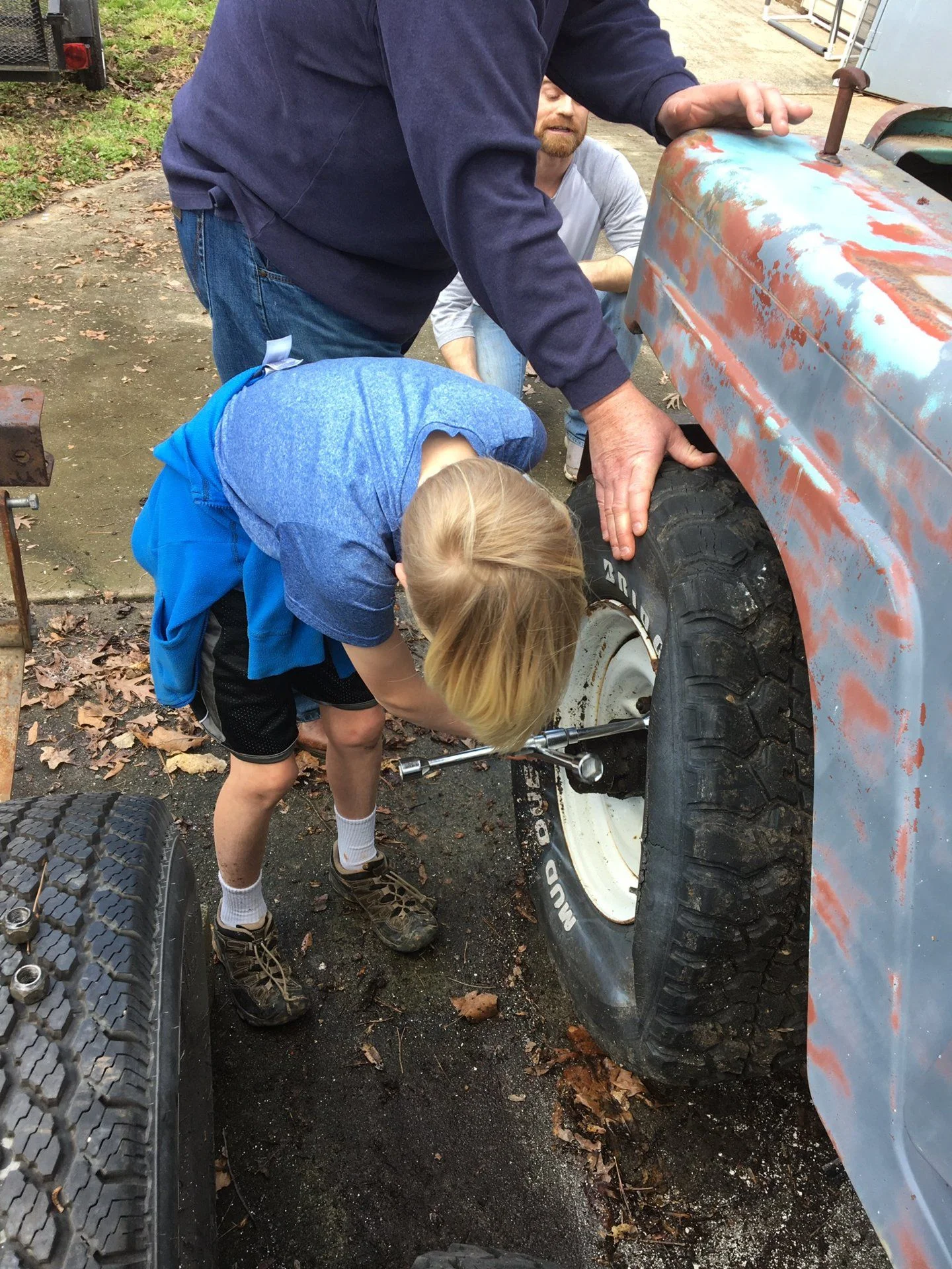

Thanks to @forrest5000 I was able to get four used tires that held air. In a previous life the tires are rumored to have started out on @FJinTegaCay's LV. ONSC comes through again. So, the truck was rolled into the garage for the winter.

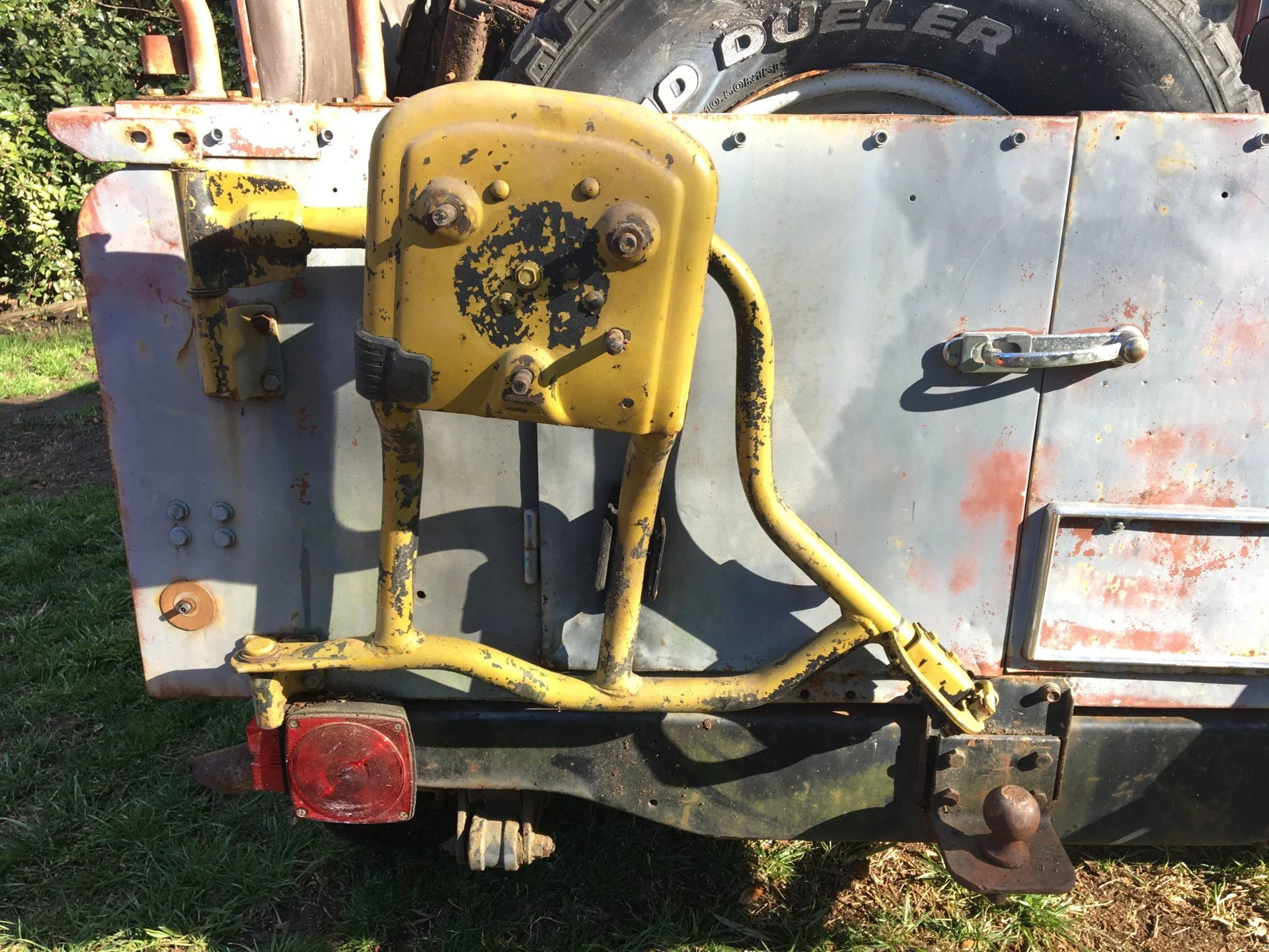

Also, a while back the '40 spare carrier was removed and found a new home on @tgadd '40. So, cruiser parts off. Cruiser parts on. Trying to keep the Toyota & Nissan gods at peace.
My shop assistant got the tires installed in short order (pun intended). No air wrenches at our house.
So, it rolls.

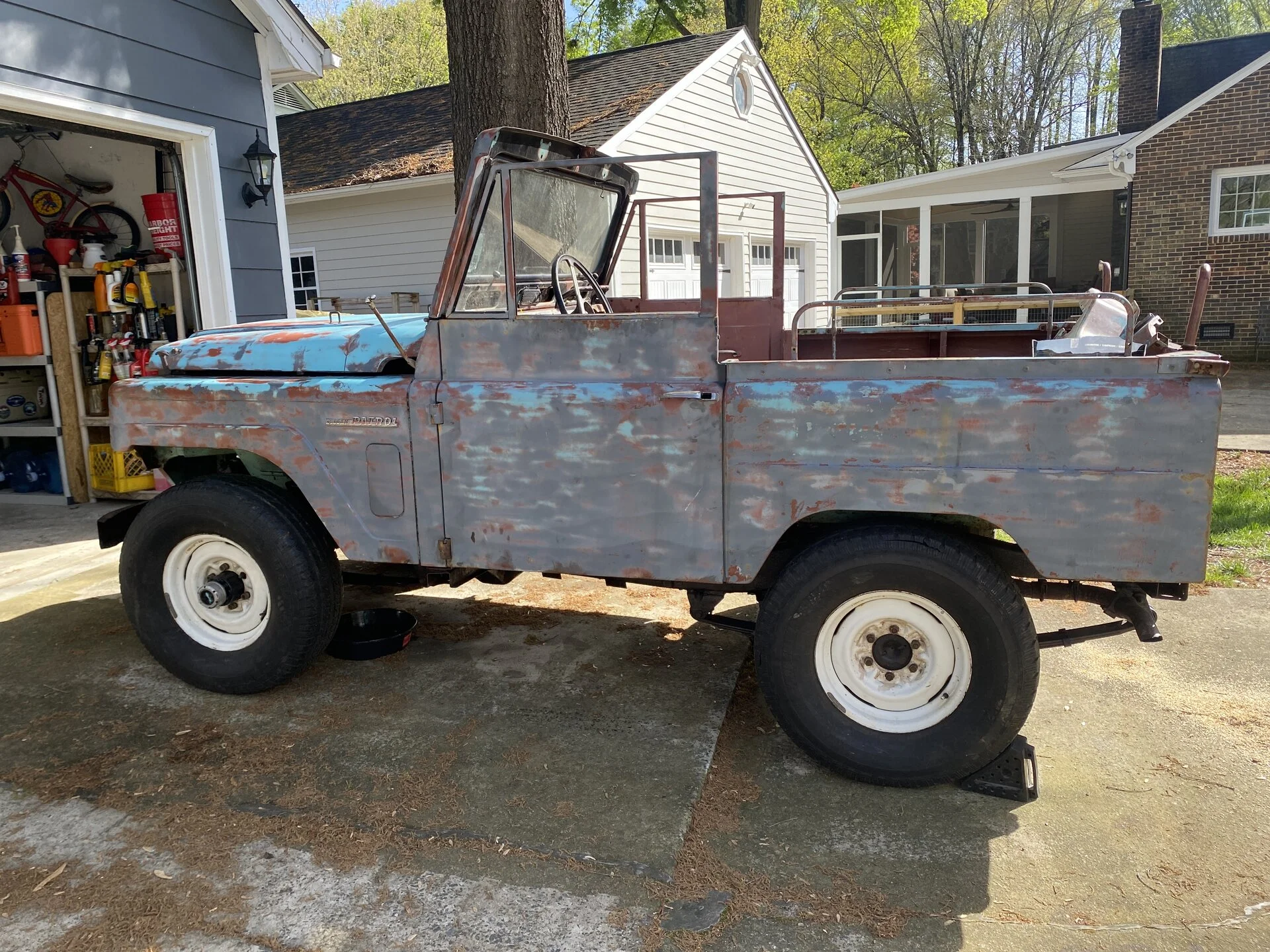

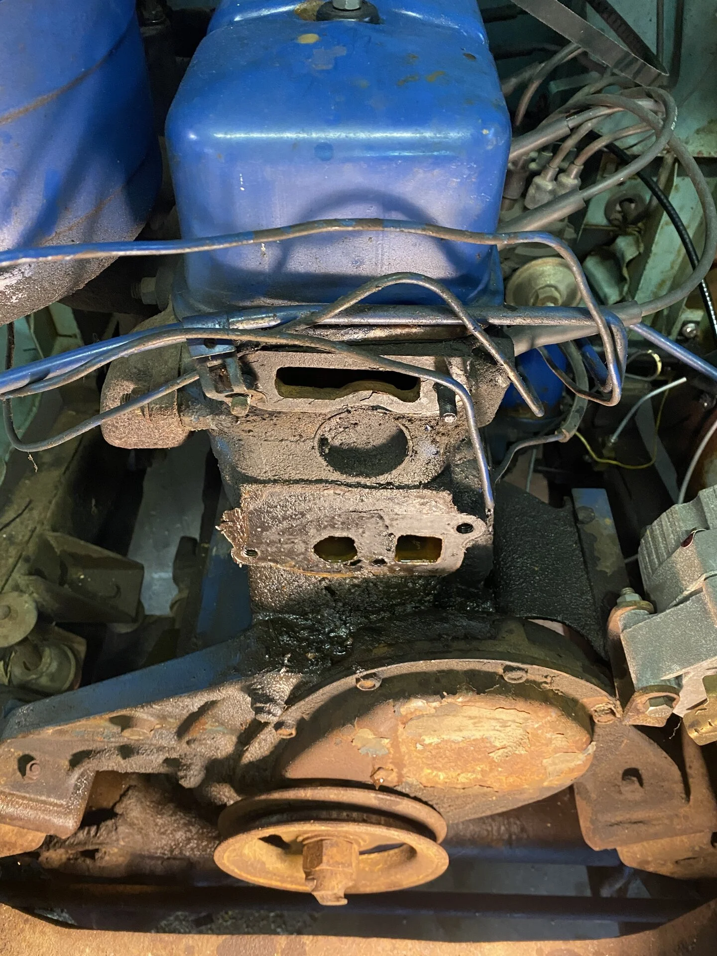

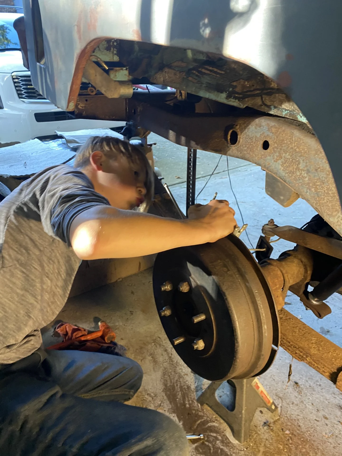

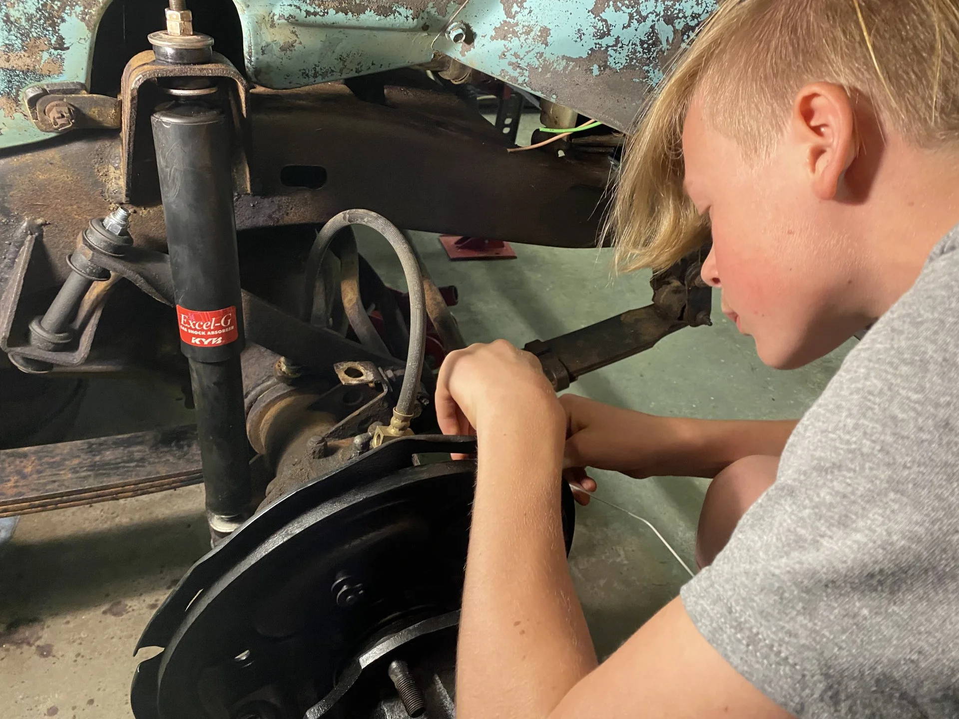

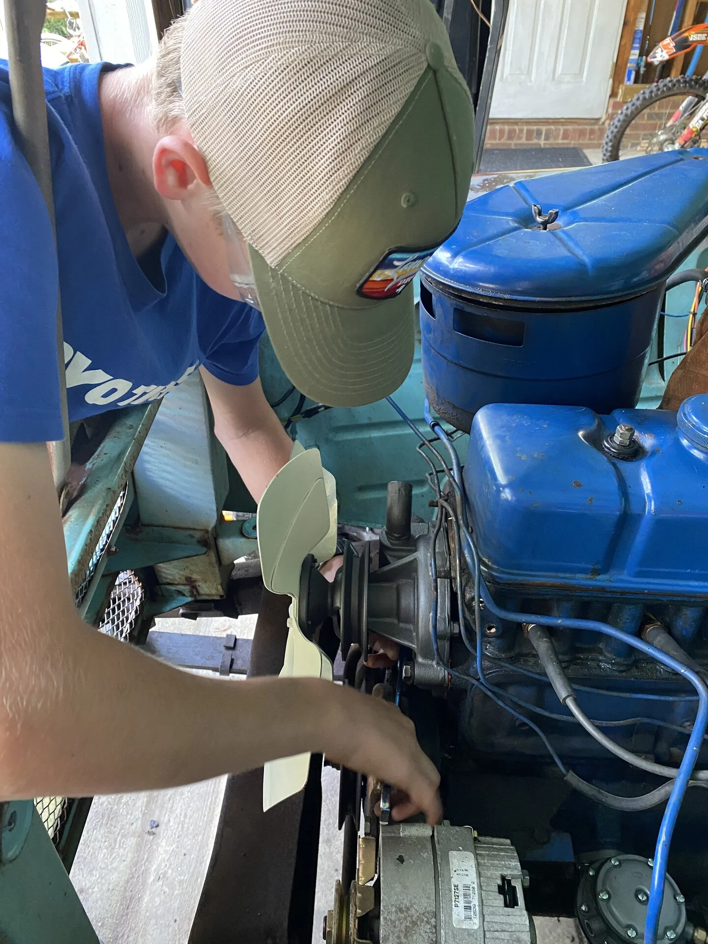

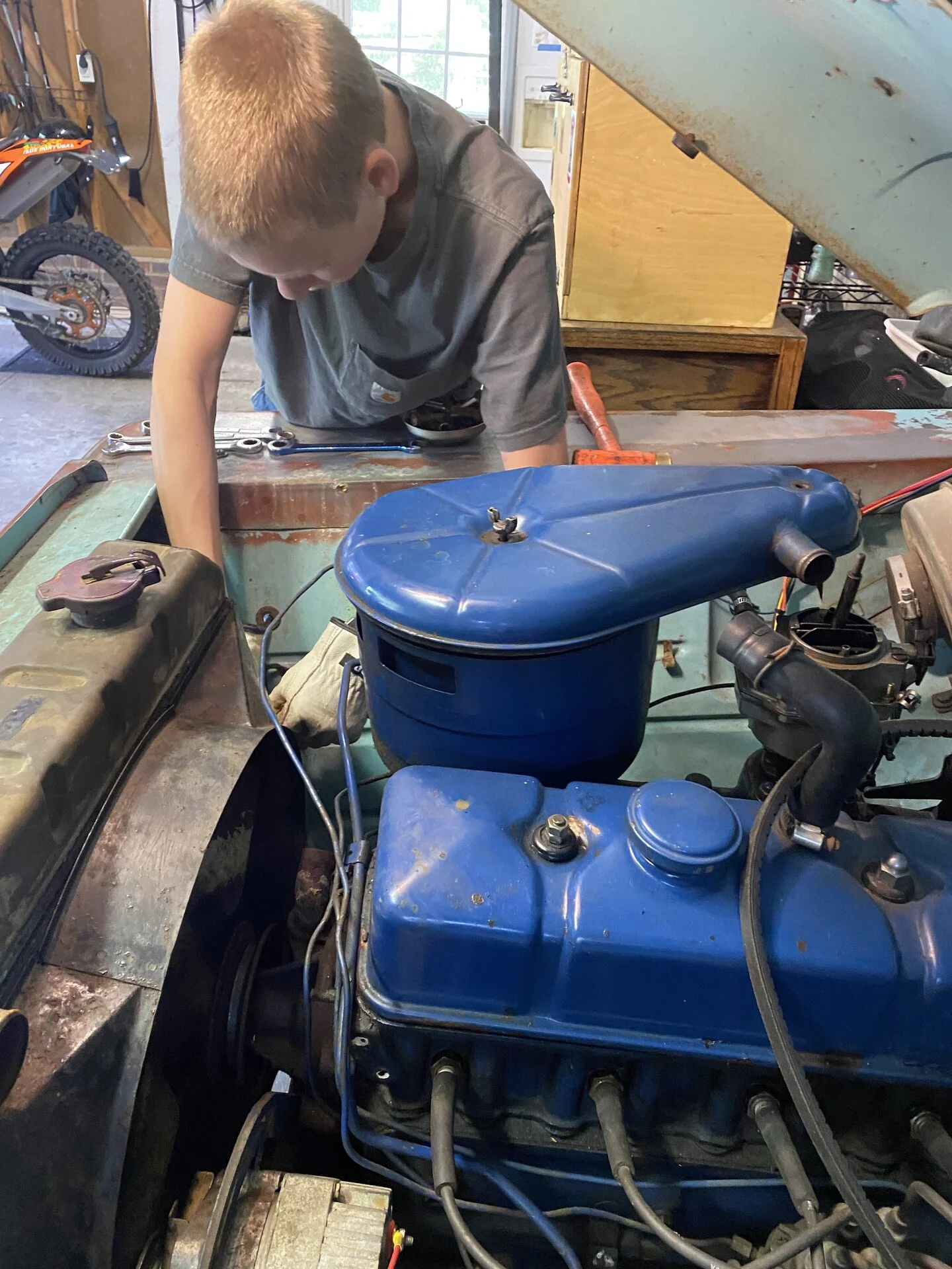

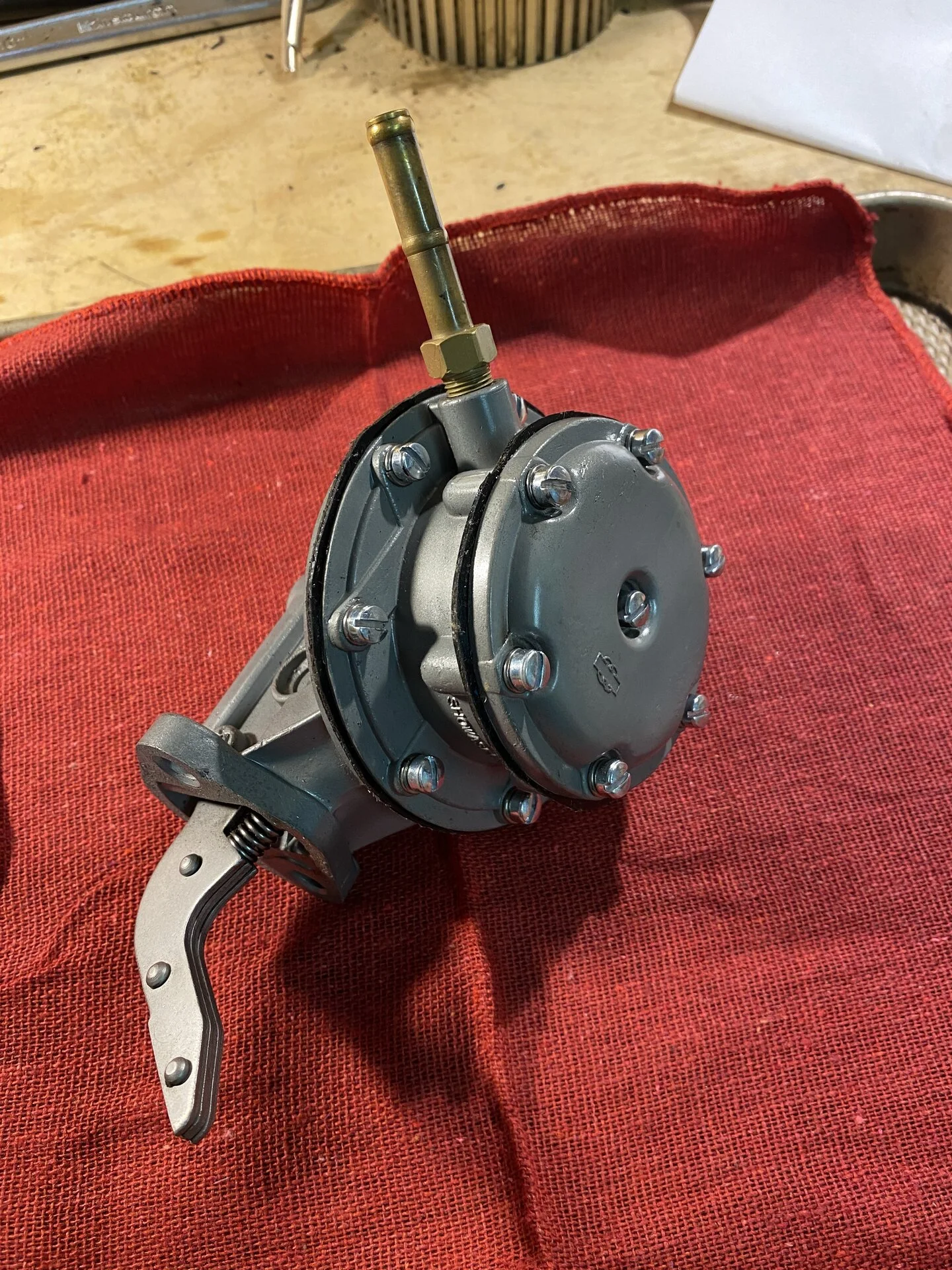

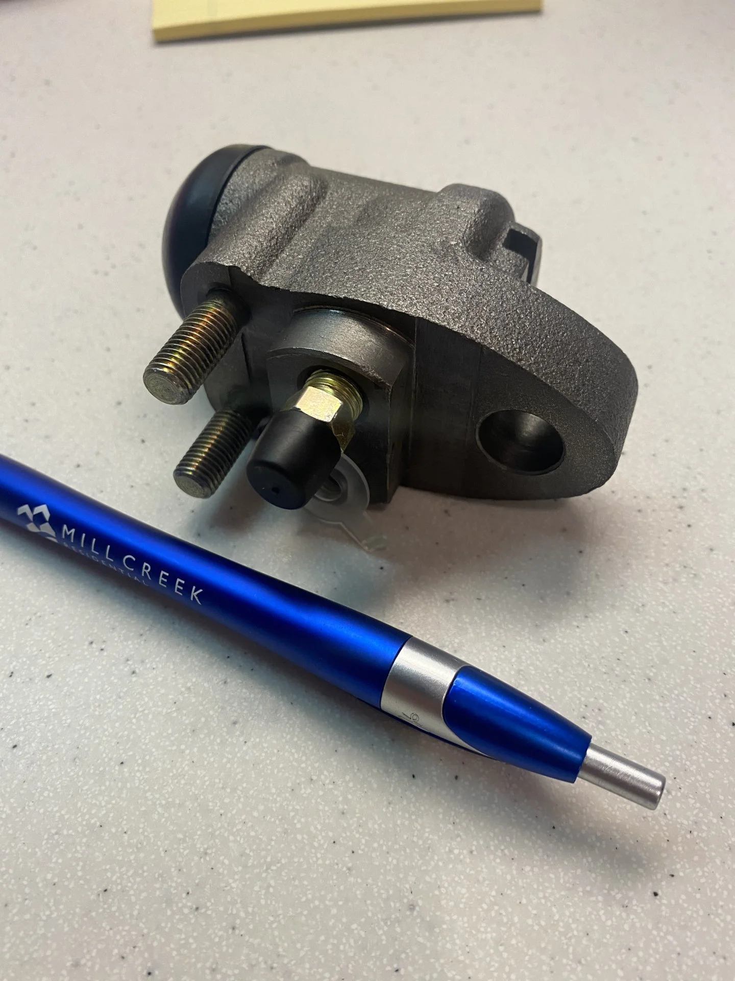

Reviving my 5 year old thread. As Luke counts down to a driver’s license in 14 months, the pleas to get the Patrol running grow exponentially. Made huge leaps last few days. Carb rebuilt (again) & got engine running fairly well. New brake cylinders received from Australia and installed. New Wildwood dual master brake cylinder mounted. New shocks installed. Re-lined brake shoes from another Patrol owner installed. All new metal brake lines made & installed (double faired after advice from an elder). Many seized or rusted parts freed. Tonight we were able to start and drive it down/back up driveway. Much more to do. Would like to thank unofficial sponsor PB Blaster.

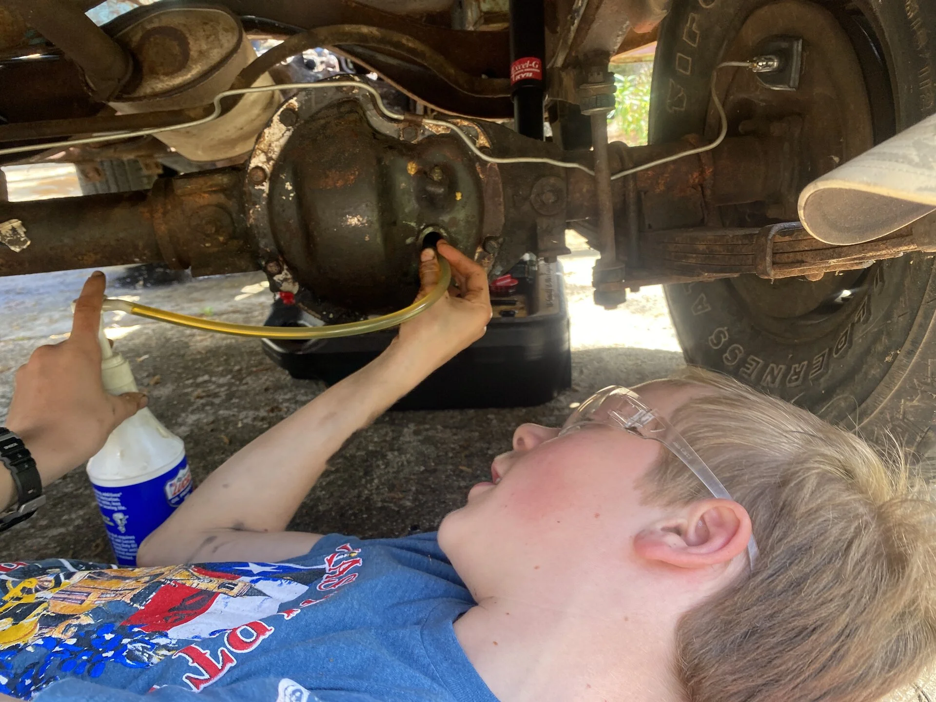

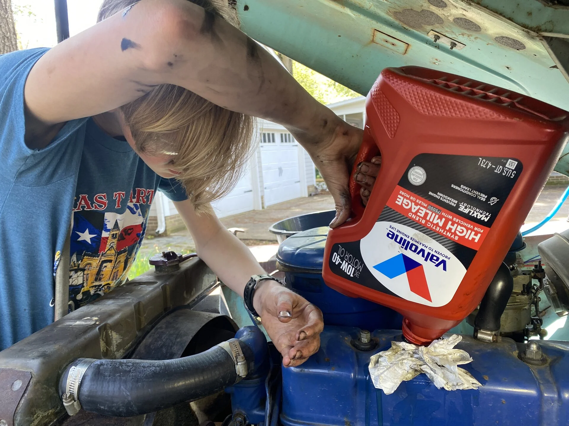

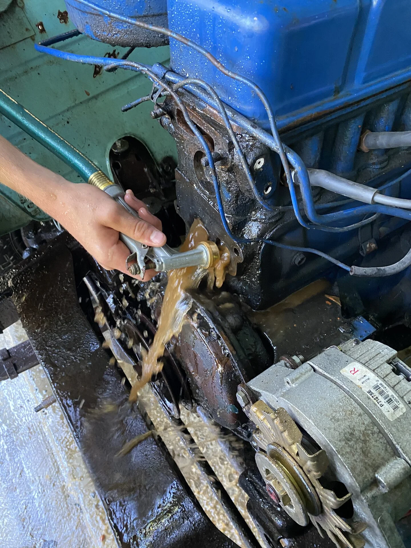

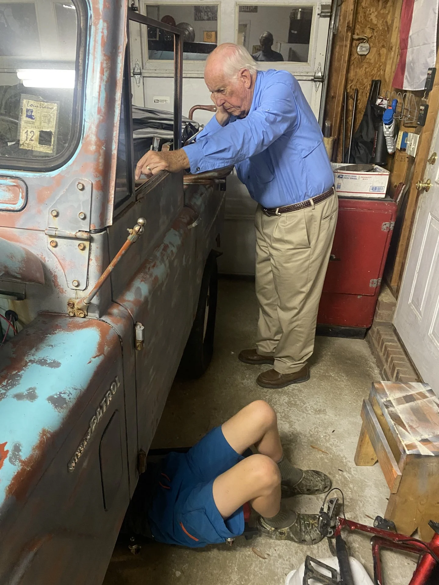

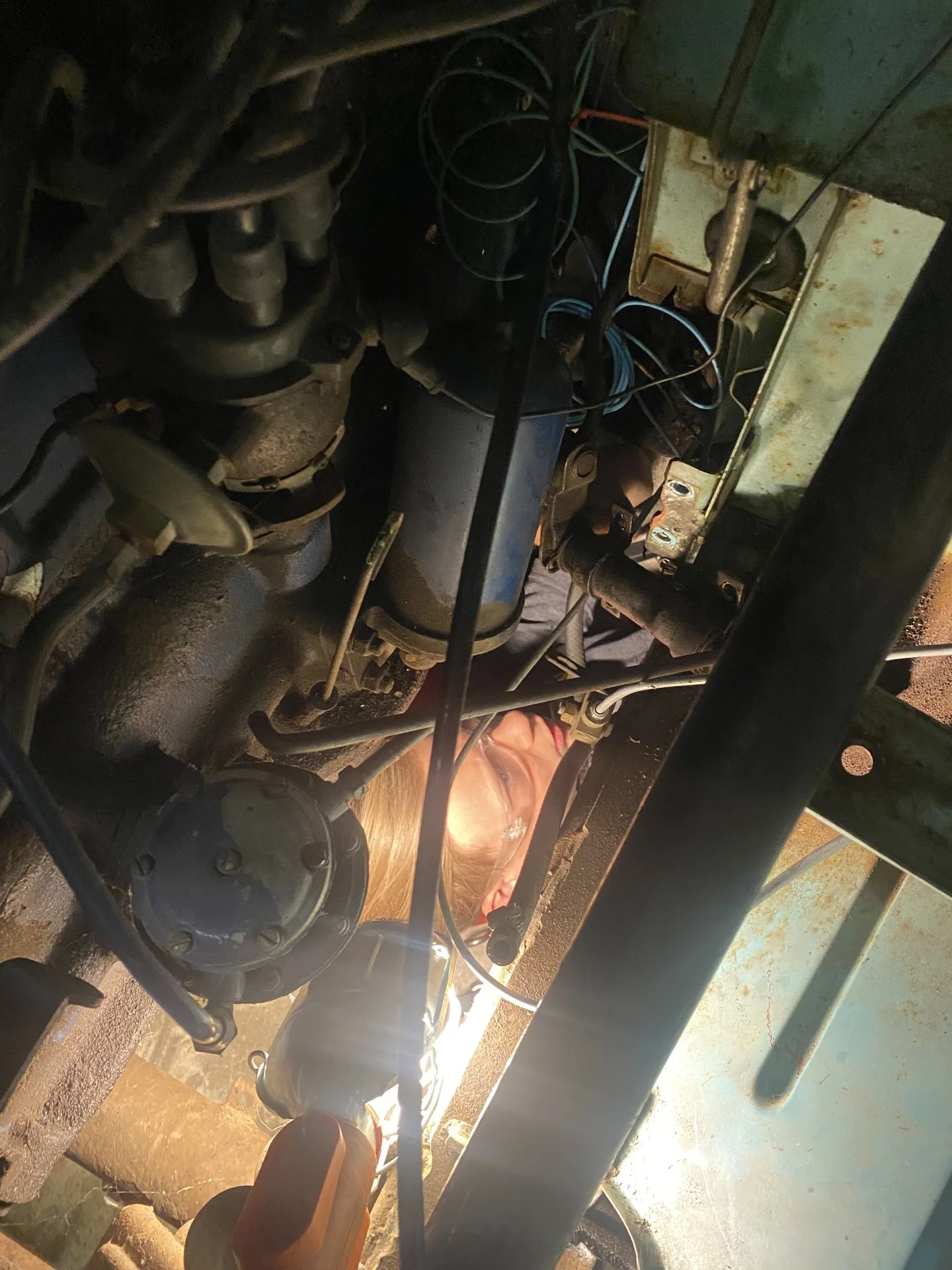

The Patrol is alive! We took it on its first (for us) maiden voyage around the neighborhood. Lots needed to make it safe, reliable, and street legal. But, it starts & stops. Luke squeezed in an oil / diffs / radiator fluid change to make sure we didn’t blow up anything first. Nothing too horrible came out with the old stuff. Tomorrow’s to-do list is to make the missing front brake lines - which will complete the all new brake system.

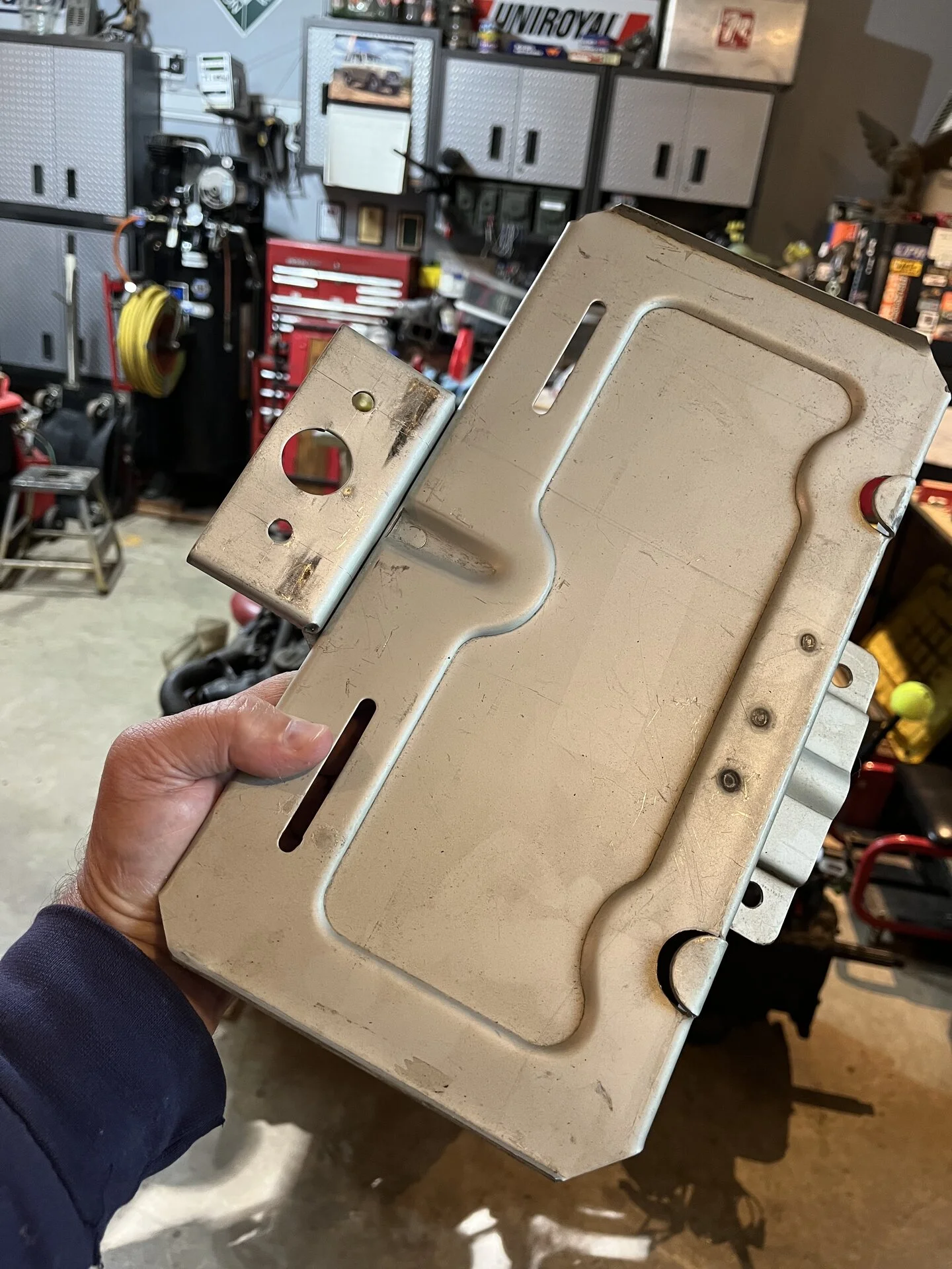

The Patrol needs a rear license plate mount. Luke is mocking up one to 3D print and, if it works, we will have it machined.
I have a brand new steel license plate mount for an early FJ40. I won it in a raffle several years ago. I don't need it. You can have it if you want it.

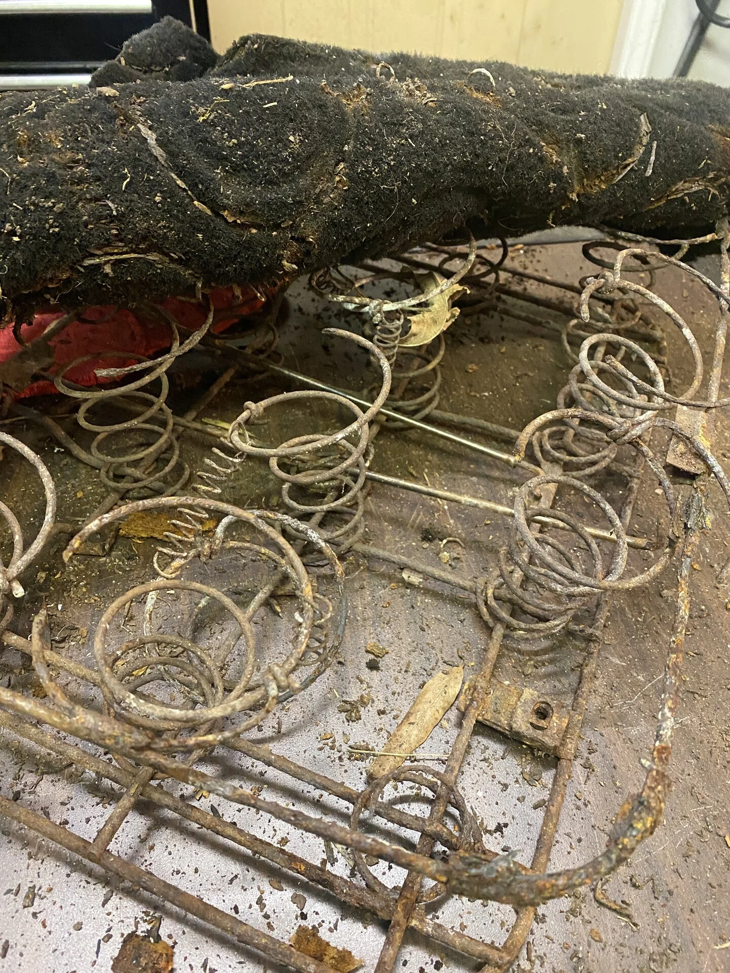

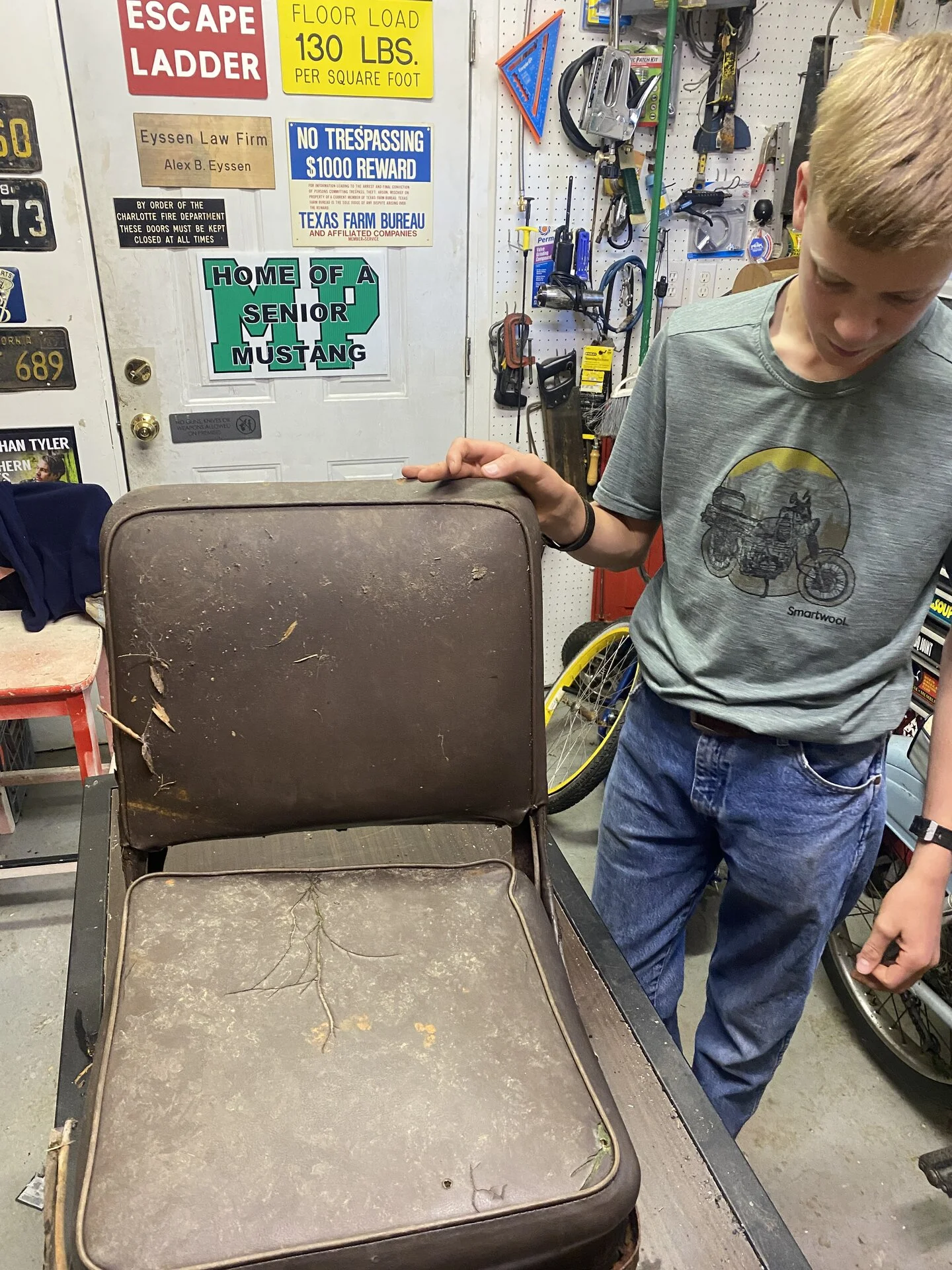

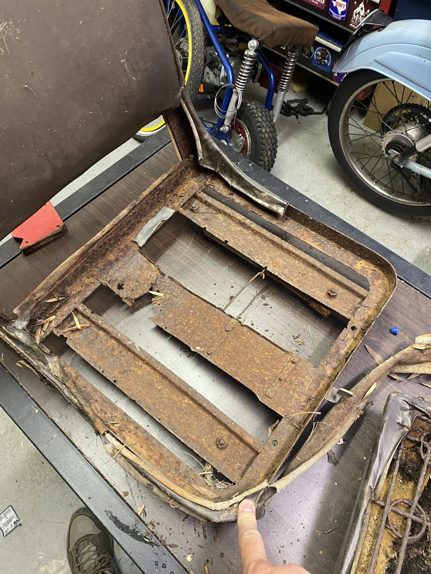

Now to seats. The original 2/3 split bench seats are toast. Frame rusted and springs brittle. Watched a lot of YouTube and decided the cheaper/faster method is to find a pickup bench seat or standard seats that will fit. Something sort of similar vintage looking, low back, and with aftermarket recover options. The Mom says seatbelts needed too.
