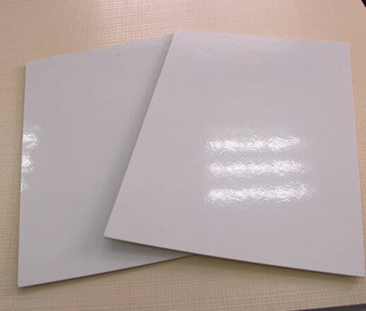

Why are you bothering with AL honeycomb? That's only necessary for high-temp applications. These are cheaper/easier panels to work with (fiberglass skins over plastic honeycomb and it looks like they can fill with insulation now would would really help with road noise), I built a camper out of the non-filled version:
CF is stronger and stiffer than fiberglass, and AL honeycomb core is also stronger than plastic (or even Aramid) cores. So CF/AL sandwich panels offer the highest possible specific strength and specific stiffness. Lightest possible weight is my main design criteria.
Lightest possible weight would be plastic not AL. Finished 1" thick plastic FRP's come in at ~0.8lbs/ft2. Plastic also reduces road noise a lot better than AL. More importantly for most people, it's also ~10% the cost!
How do you plan on the DIY lamination of CF to the panels? That's a non-trivial undertaking.
Sandwich panels made with AL cores will have a higher strength to weight ratio than plastic cores. Plastic core may be a little lighter, but AL is significantly stronger, so the finished panel can be thinner and lighter at the same strength.
These panels will be used in interior only, so road noise is not a factor.
As far as cost, you're right - using CF/AL honeycomb panels for an application like this is pretty ridiculous, and may be hard to justify for most people. However, im not too concerned with the price because it's a pretty small, one off project. Final build cost for me is going to be similar (likely lower) to what people pay for premium "off the shelf" drawer systems that are made from PLYWOOD.
I've done a lot of research on this topic. There is still more to do. Working with advanced composites is an extra skill that i want to add to my "toolbox". So i look at this particular project as an opportunity to learn/practice this craft. This is my main reasoning for choosing these materials.
From the research that i did so far, laminating CF to AL is easily done using resins that are specifically designed for this exact combination. Lay a CF panel on the bench, brush resin on it, position AL core on it, place another CF panel on top (dry), vacuum bag it and pull vacuum to press it down. Wait for it to cure. Then turn over and bond the second CF panel to the other side using the same technique.
