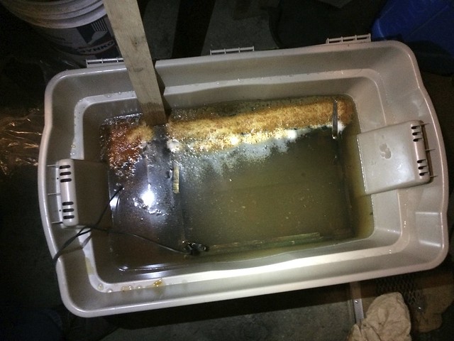

electrolysis vs 411A, round 1...

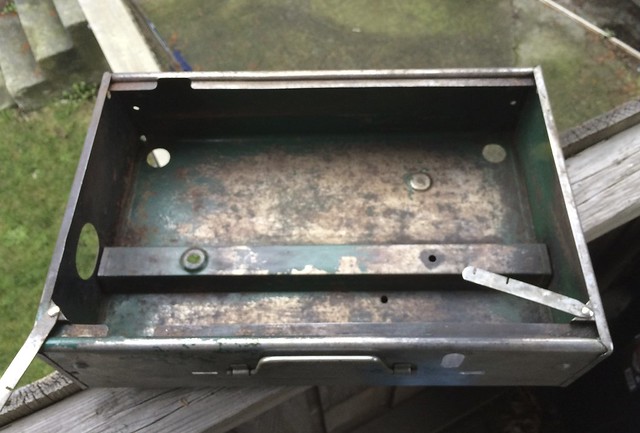

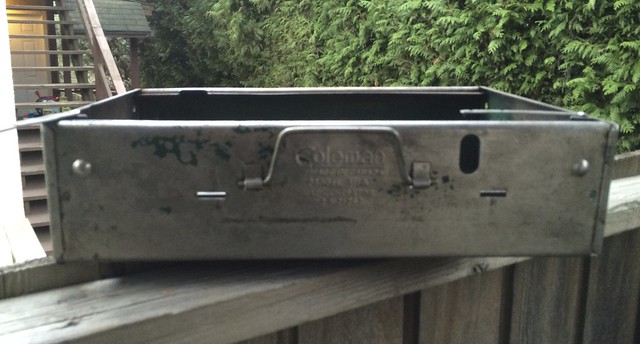

Left it in about 24 hours with the charger set at 2A. A few minutes with a wire brush, and
Outer case was pretty good, inner not quite as good
The lid didn't do as well so it's getting it's own hot tub treatment tonight, then I'll throw the case back in for round 2.
