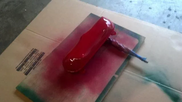

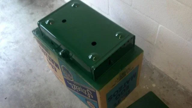

Here is my 425F restore. Thanks Drew for the color suggestion it looks great and original. Letting the paint dry.
That's going to look great.
Just remember the paint stays soft a long time. If your wife will let you, and after it's air dried at least a day, put the stove case and pieces in the oven at 175-200 degrees for about an hour. This really helps make the paint hard and fuel resistant.
