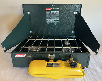

Sears Model 476.74980 - similar to a Coleman 426C, I think generally from the 1960s:

Score!
I think a tank and generator from a 60’s and 70’s 413 or 426 would work on that stove, if’n you wanted a white gas option on top of propane. Great find!
Score!
My 426B one doesn’t fit :(
I think sears changed the dimensions :(
But I will try my 413G too. Need a 426C to “experiment” with...🤔
If it’s the same shape as the yellow one on the sears stove from the terry marsh site it should work.
426B is too old, different size tank and tabs.
Just checked, the 2/68 413G tank fits perfect!
