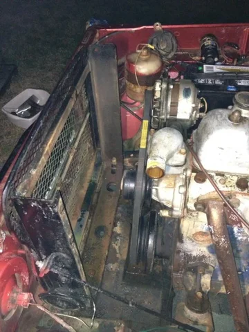

Ok so this is another problem that is really going to irk me until I correct it.
My mesh grill was always sort of "free floating" between the bib and the radiator, not mounted properly. I pulled it this weekend to get a fresh coat of paint on it and mount it, and I learned why.
I appeared that I had a radiator mount on the passenger side that conflicted with the mesh. I cut a hole to accommodate the passenger-side mount. Then I bolted back up, and found that the solid piece around the edge of the mesh hits the radiator on the driver's side, and doesn't allow the bib to close completely. :doh: It looks like if I backed the radiator up about 1/4" I'd be able to get the bib to close.
My guess is, because the V8 is mounted off-center to the driver's side, my radiator was moved over to compensate, thus creating the interference. I can't move the grille over because 1. It would look off-center and ridiculous and 2. the headlight buckets interfere.
So it sounds like my only option is to move my radiator back 1/4" - 1/2."
So, the questions:
1. Is there a distance between the radiator and fan that is considered "too close?" Obviously I don't want the movement of the engine to plow the fan into the radiator.
2. How does the radiator mount to the frame? I've looked around and it looks like there's just two bolts mounted down from the radiator channel into the front crossmember. Would it just be a matter of drilling 2 new holed for the radiator channel 1/4" behind the old ones?
Also - I'm not too familiar, but it looks like I might have a spacer behind that fan. Perhaps I could reduce it slightly to gain some space if I went to back up the radiator a little.

Maybe not what you want to hear, but you may want to resolve what you are doing with that Lakewood bell housing before addressing the radiator:meh:
That said, Plenty of room for a shorter fan spacer
And a shroud would be next on my list.:beer:
Totally agree with you - but I'm also looking at this from a financial perspective. Moving the radiator is something I can do in a weekend or so for a the cost of a fan spacer and my time. I'd probably go to a clutch fan and install a shroud at the same time.
Addressing the bellhousing and replacing all the clutch components is several hundred dollars in parts and a much more time consuming undertaking (I'll be resealing the transmission and rear main seal at the same time as well)
In short, I try to find small projects to keep me busy while I stockpile parts/money for the bigger projects.
For all intents and purposes the grille thing is purely aesthetic - but I need something to keep me busy!
Power steering is definitely up next though - all the parts are ready to go in.
I completely understand. My rig has about 2 decades worth of pay as you, go mod as needed, work around obsolete too big to change stuff on it. Right now it's been under the knife for a big undo button project for over two years. I miss it and am anxious to get it on the trail again.
FYI a fan clutch can use up 3-5 inches of depth from the water pump.
Looking forward to the PS install
Here is how what appears to be a stock radiator is mounted. Two bolts and two rods to hold the radiator frame in place:
Thanks!
Looks like mine is currently held in place by 2 bolts and 1 rod, and they changed the location of the rod :hillbilly:
Moving all this wont happen in the near future most likely, but it would be nice to mount the grille mesh properly.
The joys of conversion projects!
