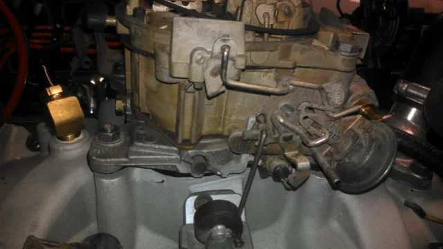

If you don't have something working the choke it could be a problem. Does the weight move out of the way when the throttle comes off idle? (silver thing with writing in front in the picture). The rod going to the air valve not installed right might cause that other issue. Can you check your choke pull off with a vac pump? If it holds its good. Did you get the goofy lever inside attached to the rod for the choke plate?

Yep, I got the annoying lever thing in the choke linkage (after many, many attempts). I, unfortunately , do not have a vacuum pump at my disposal, and I'm not sure about that weight dropping either. That said, everything in the linkages seemed to function properly when I was messing with it before I installed it.
The PO rigged up a manual choke, which is currently disconnected, and, as I said, I backed off the fast idle screw to make sure it wasn't interfering...
Quite an obnoxious little device!
