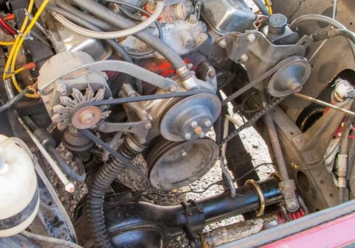

Doing a quick review of your posted photos, it looks like your alternator is mounted above your PS pump. Mine is mounted on the opposite side and my pump is higher. This photo is from about 2-1/2 years ago and much under my hood has changed since then but you can easily see the configuration.
Since this photo was taken, I've moved the PS pump up higher by drilling some new mount holes in the bracket, the low pressure return line was hitting the steering shaft from below. You can see where it was wiping it in the photo. I've also shortened the upper bracket on the alternator as I'm in the process of mounting my battery in the same area as you have yours, but behind the overflow tank. You'd need to rework a bit under the hood, but if your concerned with clearance, it's an alternative.

Remind me, Pixel Wrangler - Is that a 350 in your rig, or a 283? The issue I've run into on the 283 block is there are really no accessory mounting points. Virtually everything is bolted to the manifold or otherwise "rigged" which makes repositioning things a definite challenge.
I THINK the clearance will be OK as-is, but it's good to see an alternative setup. I do like the high-mounted PS pump. Accessing mine where it's currently mounted is tricky. The mount was also cut-through at some point (again, my PO left me all sorts of awesome gifts) so someday I'll have to go in and install something new - seems to still hold everything in place OK for now, though.
Yeah, it is a 383, so there are maybe a few more options. In doing a google search to refresh my memory, I see that the 283 heads didn't have mount points on the end. A few did so maybe they had modified their engines. I didn't do any reading as I'm trying to get out of here to work on my rig today, but I saw several posts on other forums looking at the same issues your having with accessory mounting on 283s. If it becomes an issue for you with the clearance, I'm sure there are many options to get to where you want to be. Just remember anything is doable if you through enough money at it. :D
