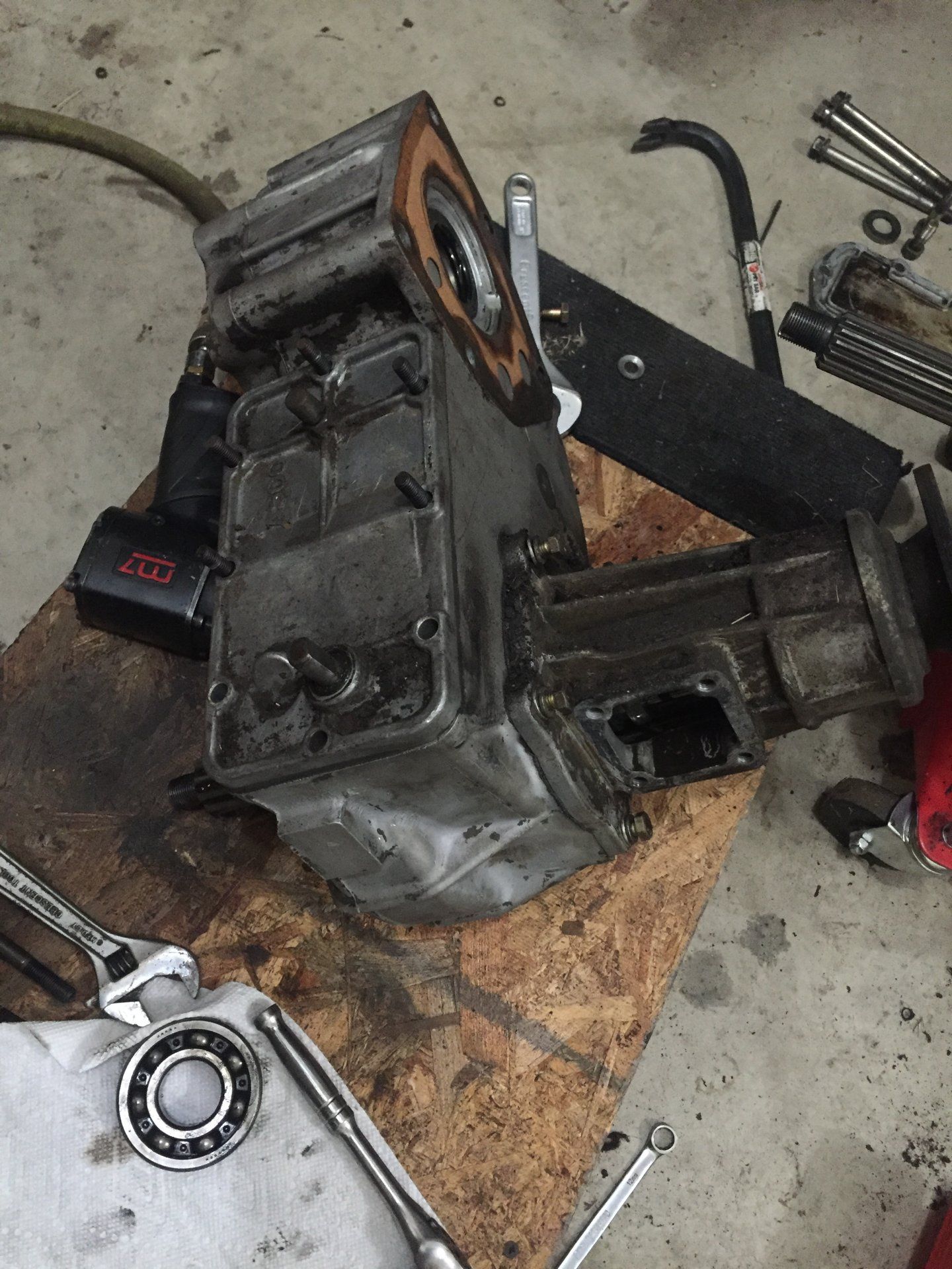

One thing I did notice was that even with the transmission in neutral, the transfercase would still spin slightly when I moved the transmission input shaft. I imagine with no load, there may just be enough drag on the idler shaft to cause them to move slowly. If I grab on of the transfercase shafts and hold it still, the transmission spins freely and the transfercase stays in place.
Next - I put my home-built puller to work:
This worked great, but further "customization" was required as the long bolts I started with became too short as the output shaft retreated. The joy of junkyard remedies!
The end result - separated transfer case. I REALLY hope that bearing was supposed to fall out - it seemed like barely even a press fit...

Digging further into the transfercase, this may likely become a full rebuild by the time I'm done. The main bearings seem ok, but inspection of the nose cone/front output shaft bearing found it feeling a bit "notchy."
Further inspection revealed what appears to be some mild brinelling on the race:
The faint "lines" barely visible in this photo on either side of the ball coincide with the "notchy" feeling felt. This bearing is typically used at pretty low speed, but it seems easy enough to change out, and I'd feel better knowing it won't be an issue when it's back under the truck.

Another setback...Tore down the transfer case completely and, at Georg's request took a look at the idler bearing races inside the bore on the idler gear set.
Found a thin line of pitting:
This is probably why:
In addition, the pressed on gears literally fell off the output shaft, which seems to imply some excess clearance. Either way, the output shaft is pretty sub-par as well with some rough spots by the clutch gear and wear patterns of all types:
In short, this transfercase is pretty shot... It sounds like most of the parts are still available in the aftermarket, but I'll need to track down a used gear set or a better used case.
