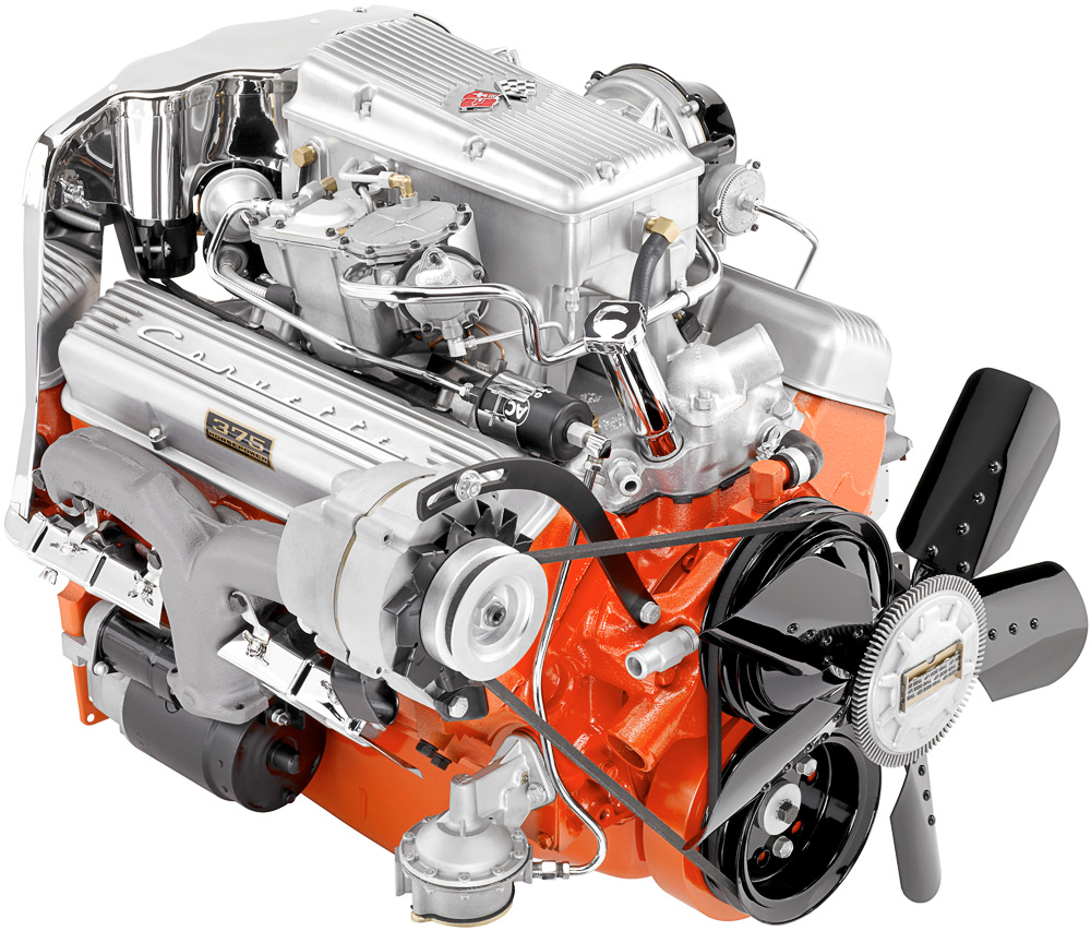

Mechanical fuel pump will be on the engine, so easy to check, follow the fuel line from the carb back to the gas tank. Mechanical Fuel pump location should be similar to this picture (at the 6'clock position):
I'm not familiar with your engine, but mechanical fuel pumps are usually on the front of the block.
Man, I wish my engine looked that good! Actually, I don't, I'd never want to drive it.
