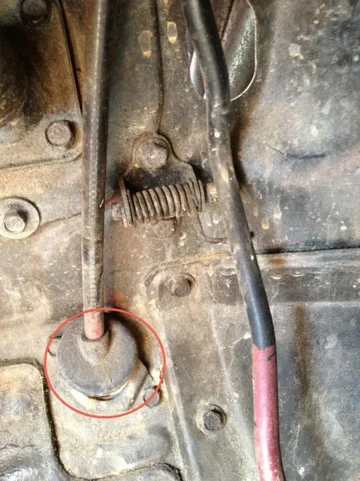

A shot of my throttle cable assembly. Looks like a stock later-model FJ40 throttle cable, attached to the pedal by a welded-on bracket. The return spring/mounting setup at the carb looks...questionable...Mounted to a tab welded to the back of the alternator bracket...
Does anyone have suggestions on how to plug that hole in the firewall that the cable is running through? It looks like there should be a boot of some sort plugging up that hole... I'm thinking some kind of custom-fabbed (redneck-engineered) grommet might be in order...
Can you source some of the firewall grommets?
It looks like there is a grommet that goes there naturally to cover the original carb linkage on older model 40's - the hole I need to fill is oval, and all the grommets I've seen are round...the carb linkage "boot" might work but I haven't been able to find one.

Just weld in a patch and then drill it to fit the cable linkage.
Thought of this - just didn't like the concept of having metal potentially rubbing on metal. I may go "half way" and weld in a patch, then cut a hole to fit a small firewall grommet to run the cable through.
That cable looks like one sold to do V8 conversions (I bought one back in the day). Usually there is a plastic bushing that extends through the firewall side of the drilled hole to keep if from rubbing. I can't see enough of the cable you have to tell if that is still there or not...

Nope, no bushing, just that small tab hanging out in space right in front of the hole in the firewall on the engine bay side.
