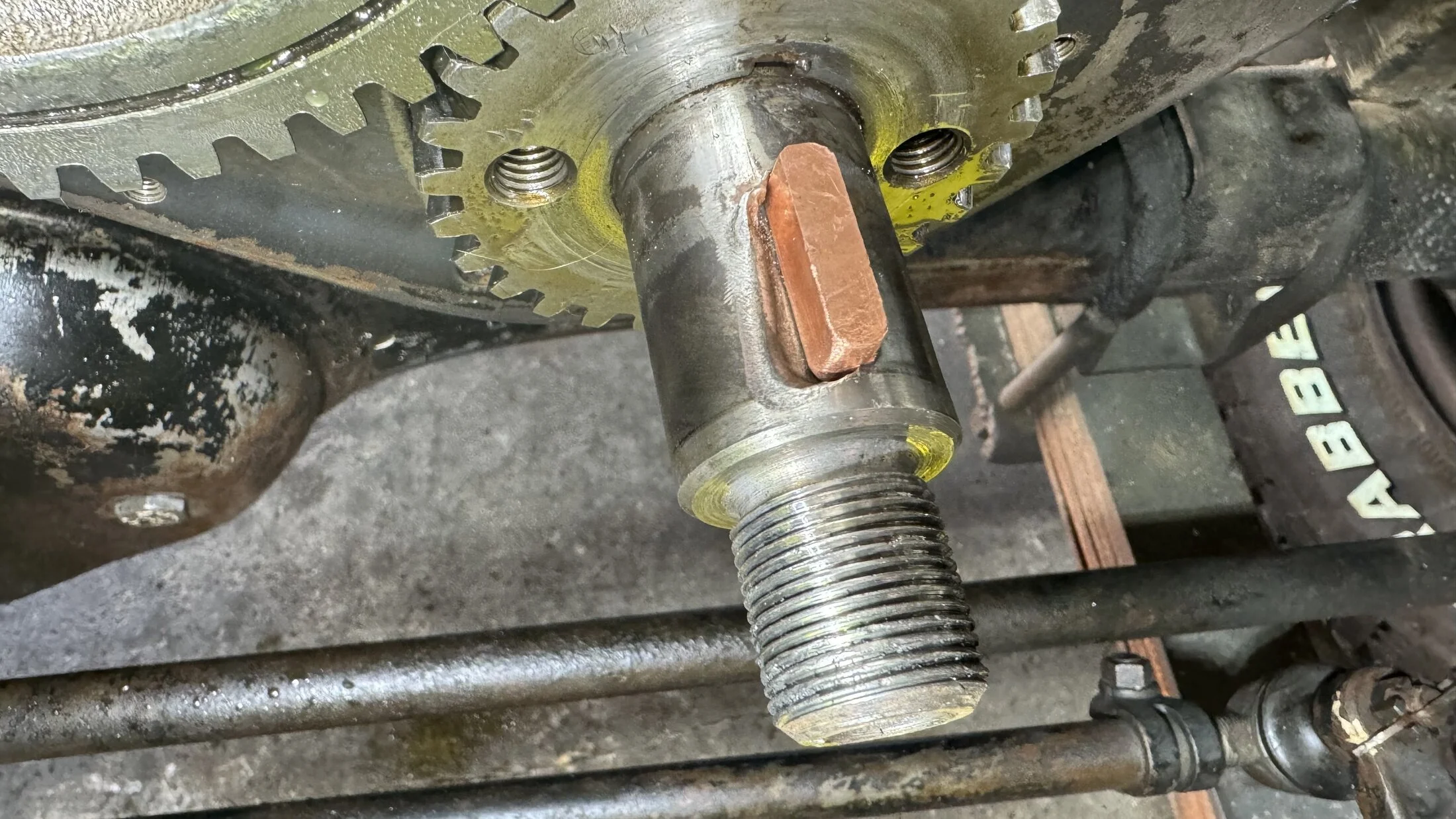

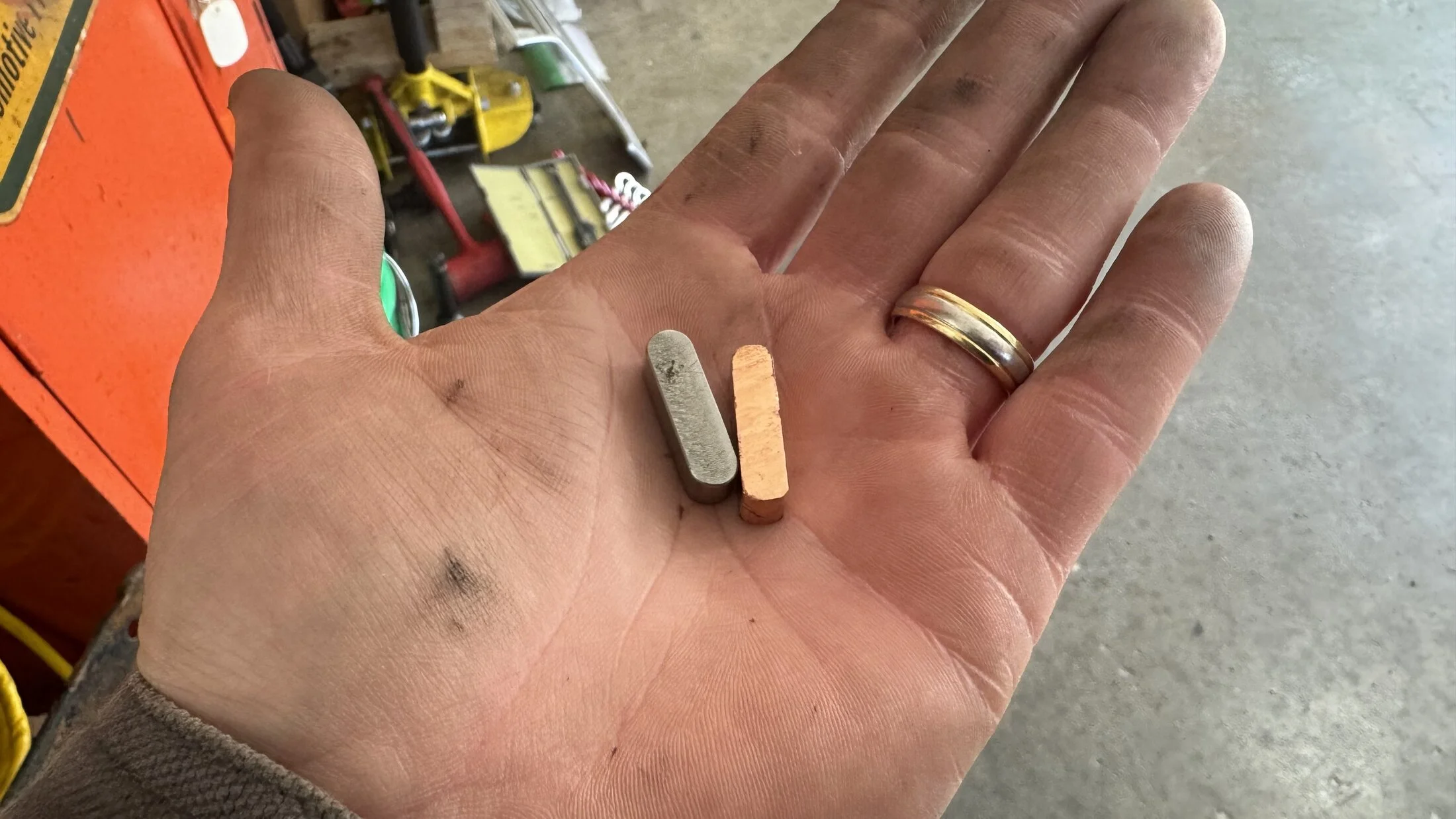

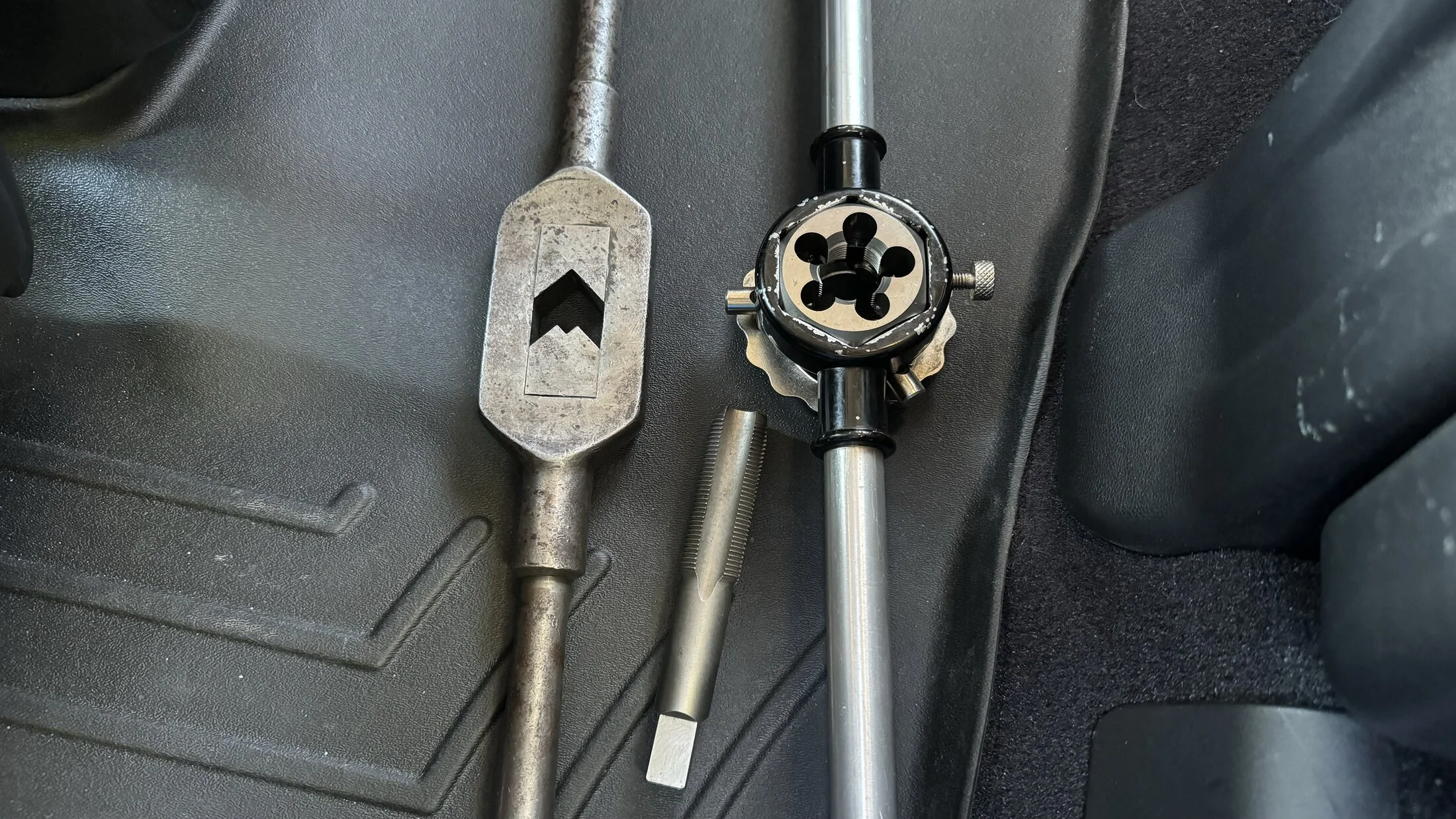

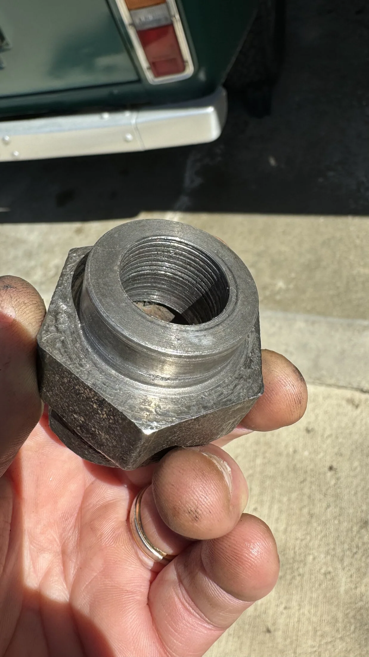

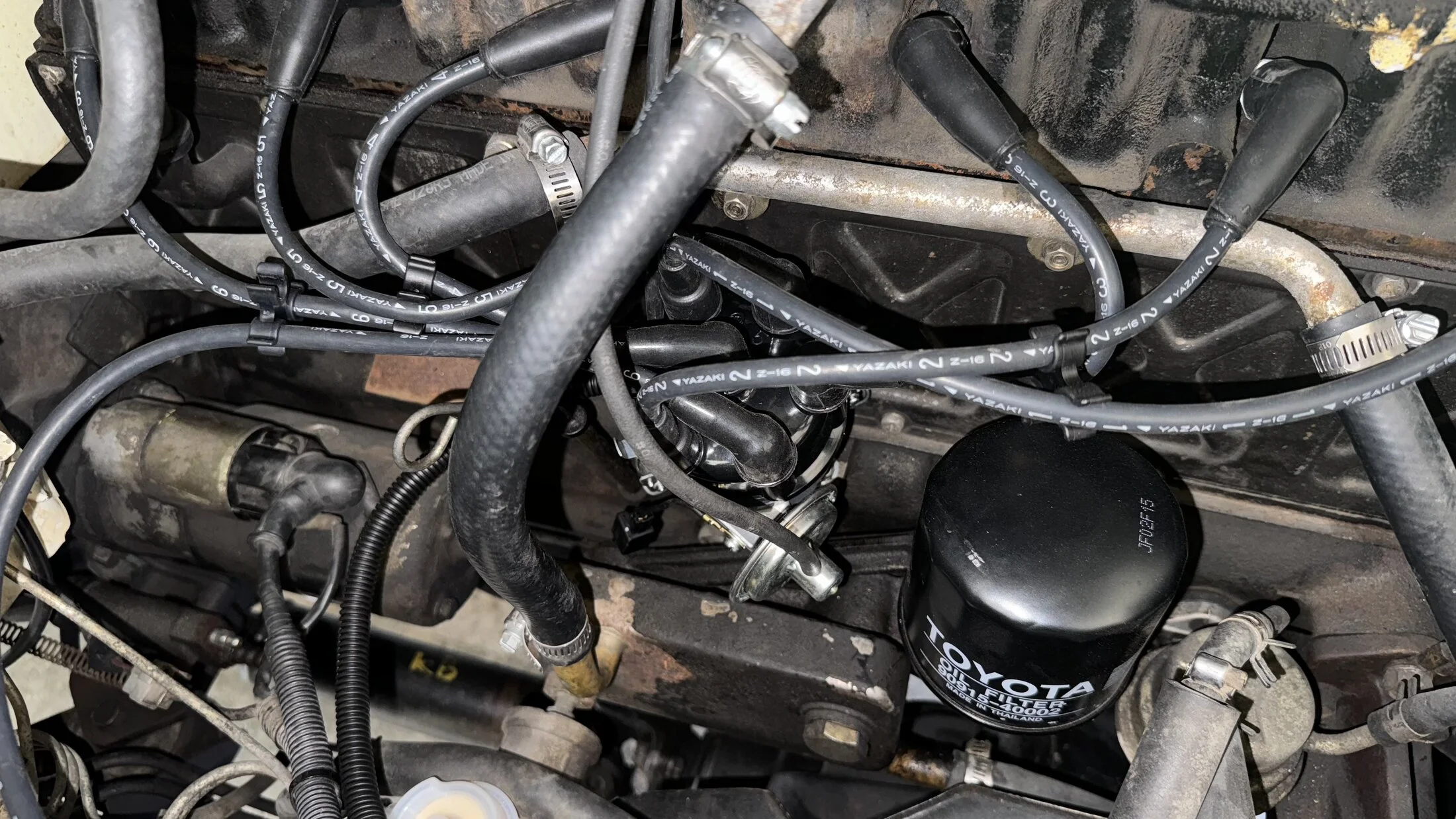

So it’s been a couple months since my last update. I couldn’t get my buddy out here to weld the keyway, so I bought a $150 welder off Amazon and learned enough to do what I had to do. I made a copper key to weld against and then filed the excess into shape. I wound up ordering a Dayco PB1053N harmonic balancer from Rockauto for $315 because mine was too chewed up to speedi-sleeve. Finally put it back together and tightened to about 100ft/lbs on the balancer nut and it spun loose. Found a replacement nut from Mark’s off-road, chased the crank threads with the proper size die, and got it back together. Went for a solid hour drive and it’s all good.

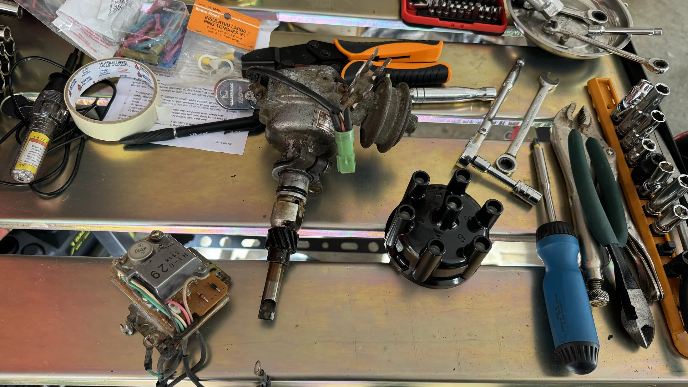

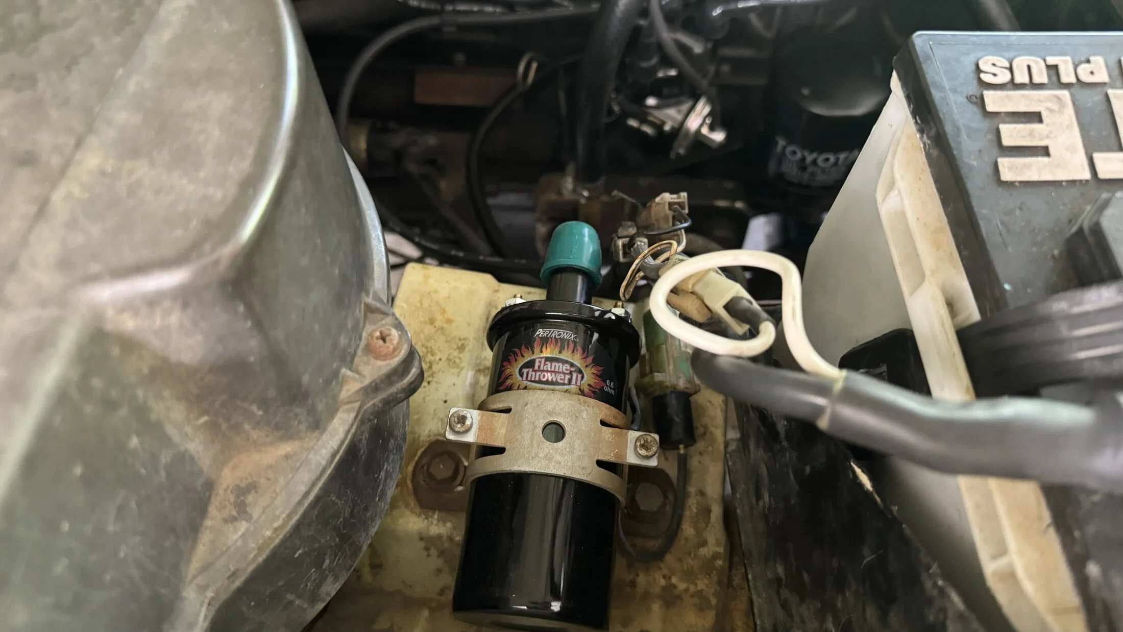

The next week, I went to Home Depot and it died after 10 minutes. Everything looked fine, and after 10 minutes it started fine and I drove back home. I threw an inline spark checker on the #1 cylinder and went for another ride. 10 minutes in, and it died. No spark. Went to a great local place that’s been here for 60 years, picked up a coil, swapped it, went for a ride, died after 10 minutes. At this point I figured it’s the igniter, so I ordered up the Pertronix kit from Redline and installed it yesterday. Went for an hour ride and all good. So I’m back in action, and waiting for the next thing to go to s*** 😂
