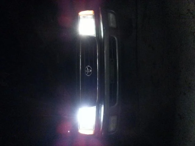

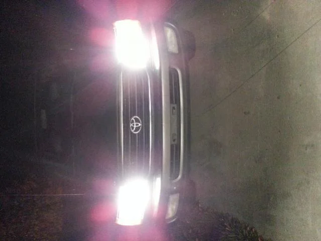

So I was able to install the 9011's in the low and high beam locations last night. Wow, what a difference. I have a couple pictures. The first picture is showing the 9011 in one low beam side and the stock 9005 in the other. The second is the 9011 in both low beam locations and then I forgot to get a pic of the high beams on with the stockI bulb. Sorry. The third pic is the 9011's in all 4 high and low locations. HUGE difference. The numbers recorded by gentleman earlier in the thread don't lie. These babies turn night to day for me.
Wow, wait a minute I've got to get my sun glasses:smokin:
Very nice, just for reference how many hours on stock 9005?
I didn't know we could get these 100's at a 90 degree. .LOL
I find myself wanting to "like" replies like 2001LC's above...
Elijah, all kidding aside I really do appreciate your posting these pictures, just as I have all your posts. I have a fairly decent LCD monitor to view these pic on, and I must say; all four 9011's on for a total of 260 watts is very bright, ergo the sun glasses remark ^^.
Nice comparison pic of low beams, the PS 9011 65w which is obvious brighter than the DS stock 9006 51w Low Beam. Am I correct stock "9005" low beam is a typo or was this a earlier mod?
Thanks for the pictures, and if I may be so presumptive; I can't wait to get your subjective view while driving at night and the DRL's in the daylight with your new illuminations in the 100 TLC.
