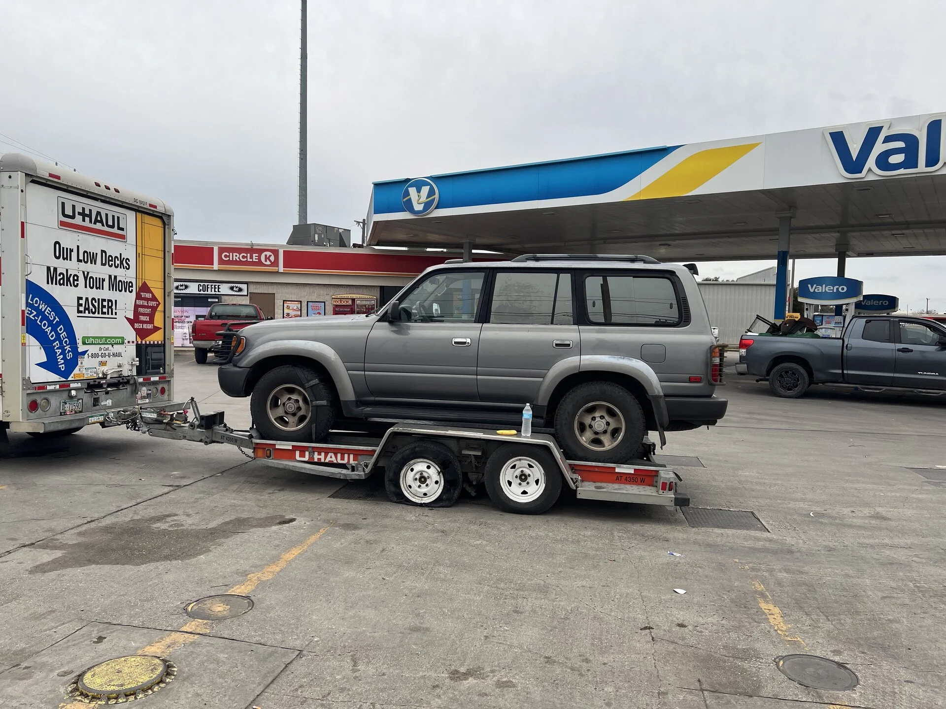

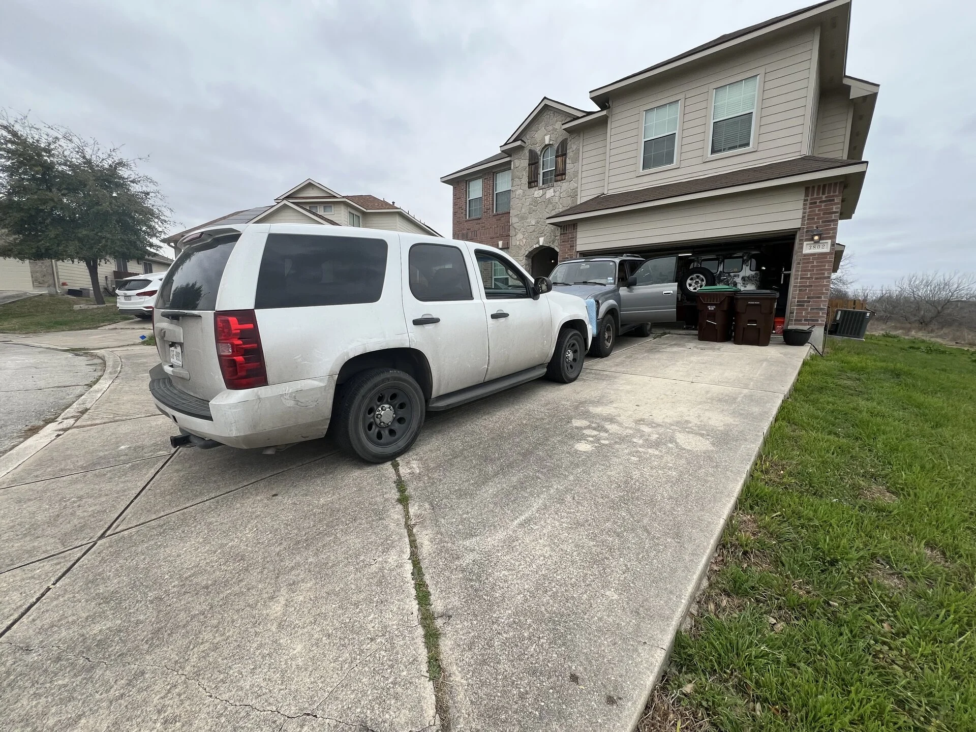

I rented a truck and trailer, conned my brother into helping, stopped at harbor freight for a come along and went on the recovery mission.
Of course no good deed goes unpunished and we had a blowout on our rental trailer, thankfully while we were on a round about Highway exit at relatively low speed.

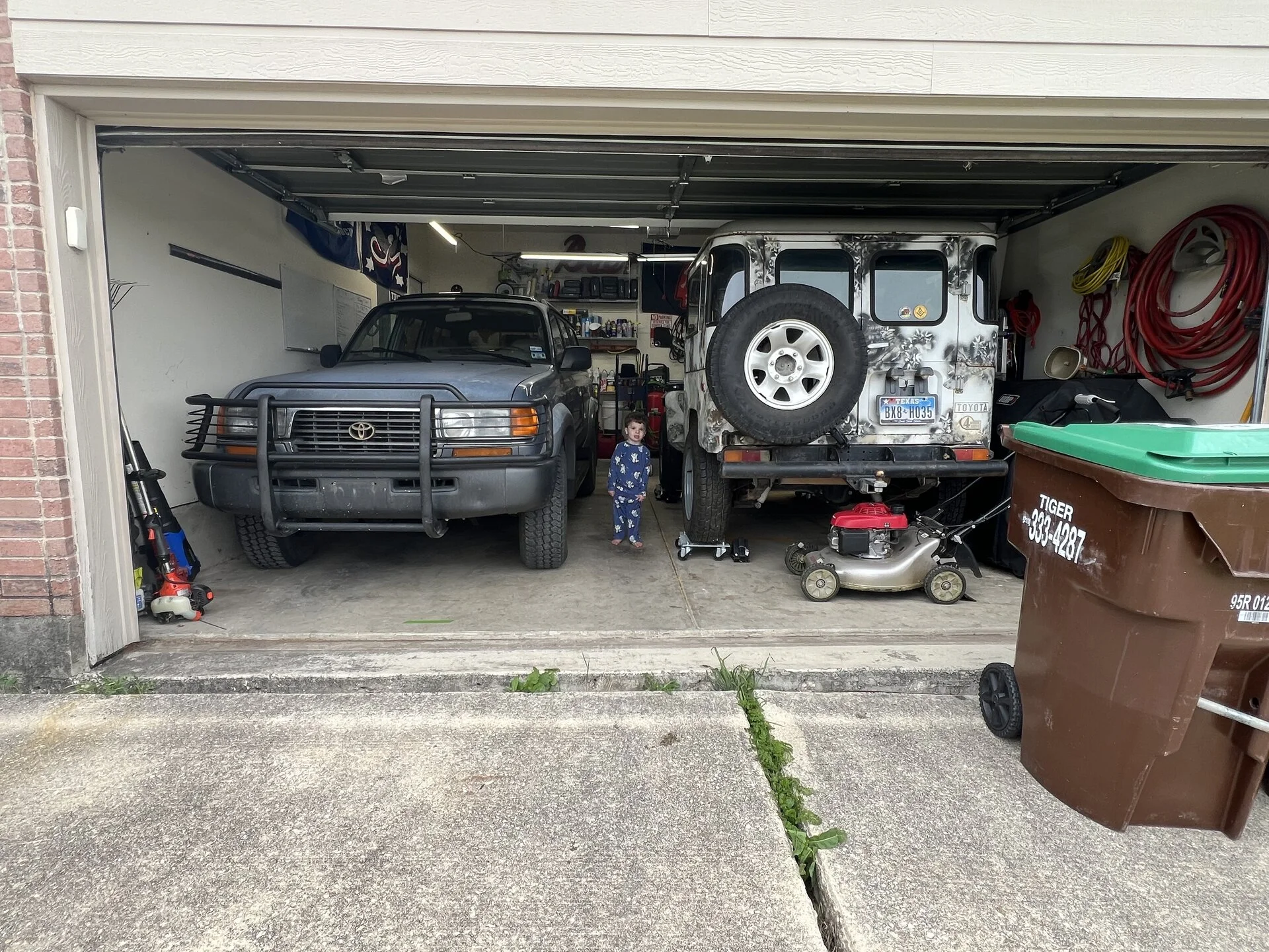

Once unloaded, I used my “daddy-wagon” and a couple shipping blankets to get it pushed up my steep driveway and snuggled in next to the 40 series my wife affectionately calls “the mistress”…
Hey, two major projects are better than one!
Overall the 80 is very rust free, never been in an accident or off road for that matter, it’s bone stock and pretty much all original/OEM serviced.

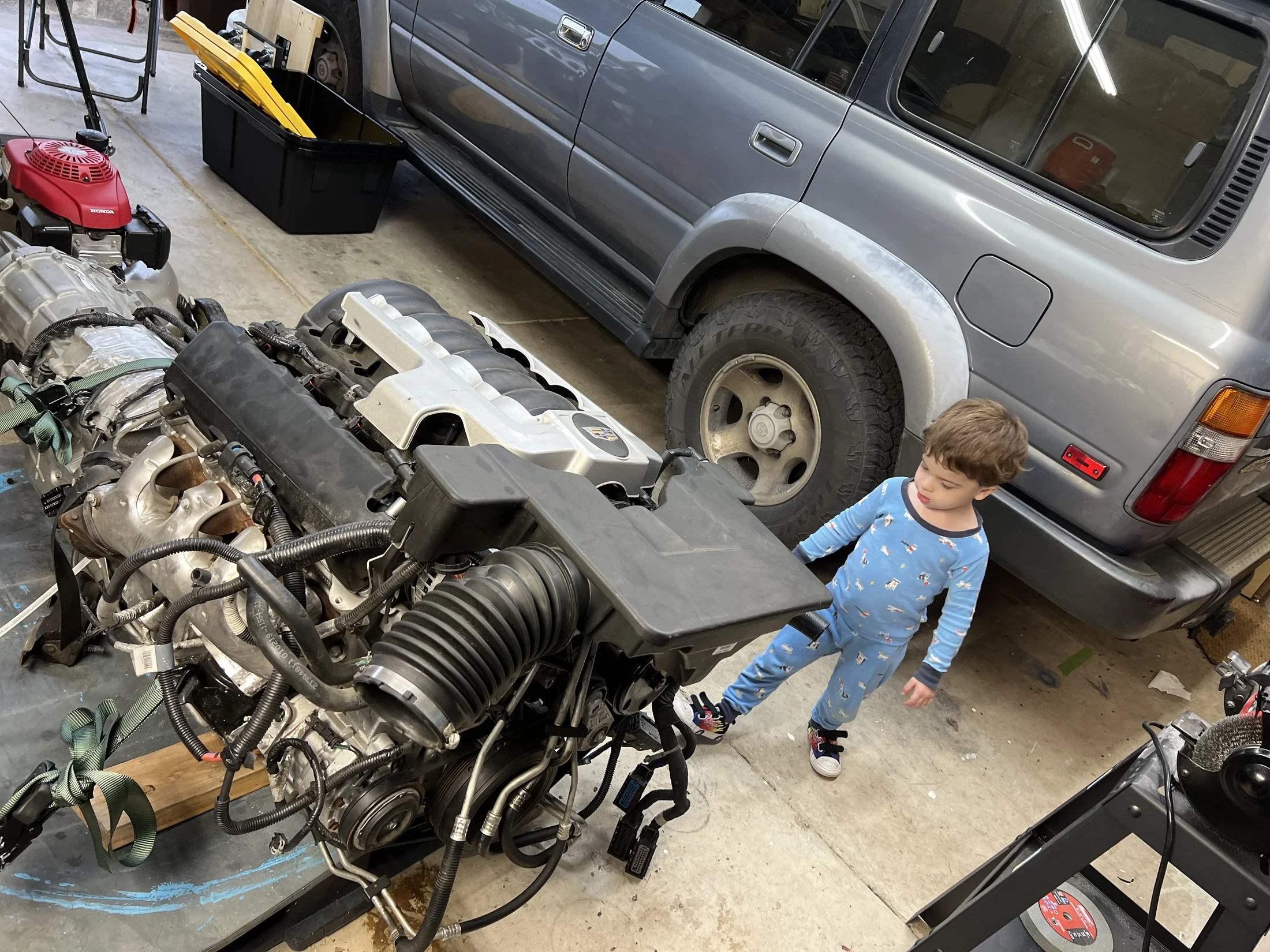

From my last update the cruiser sat pretty much untouched in my garage. Thought it quickly became my kids favorite jungle gym while working out in the garage:

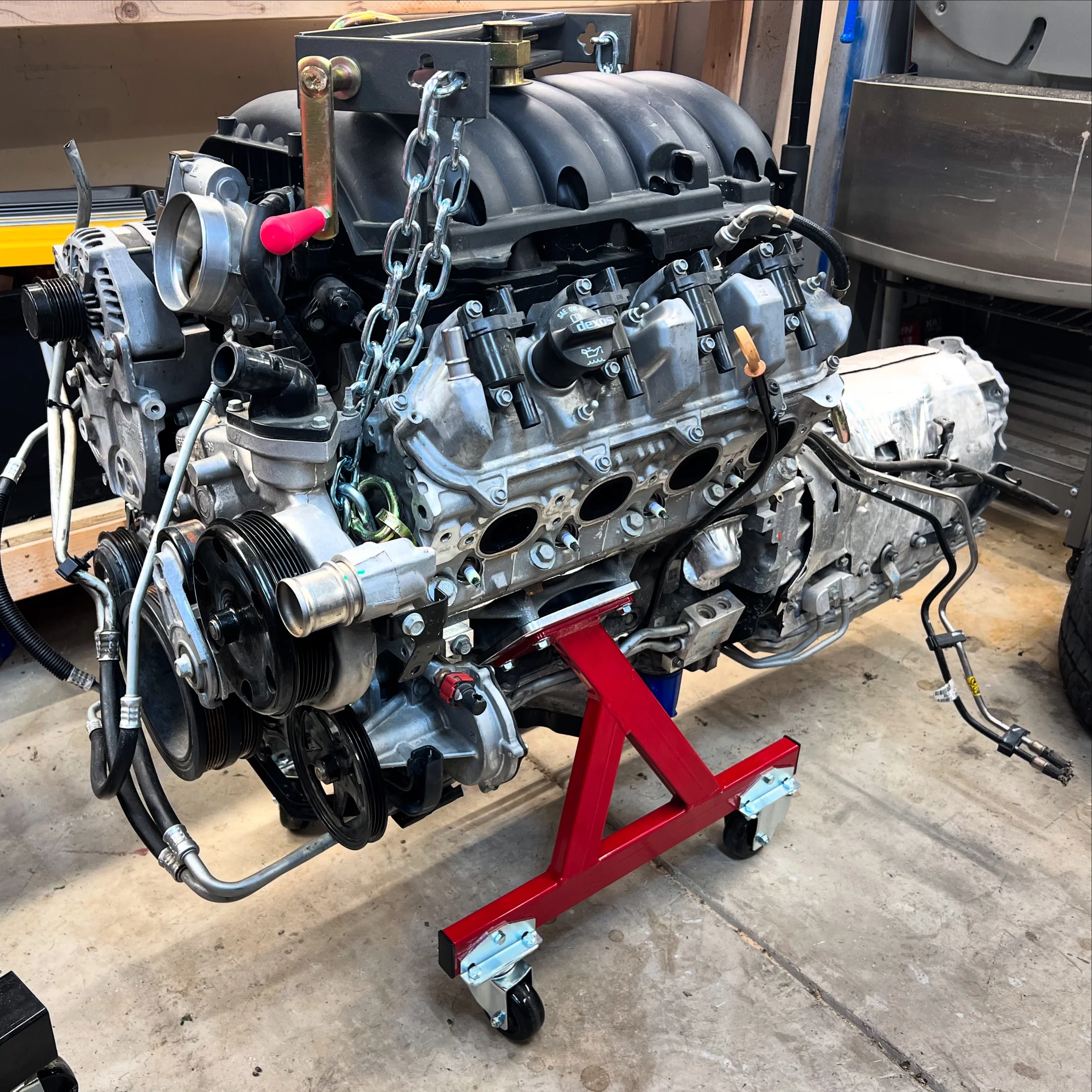

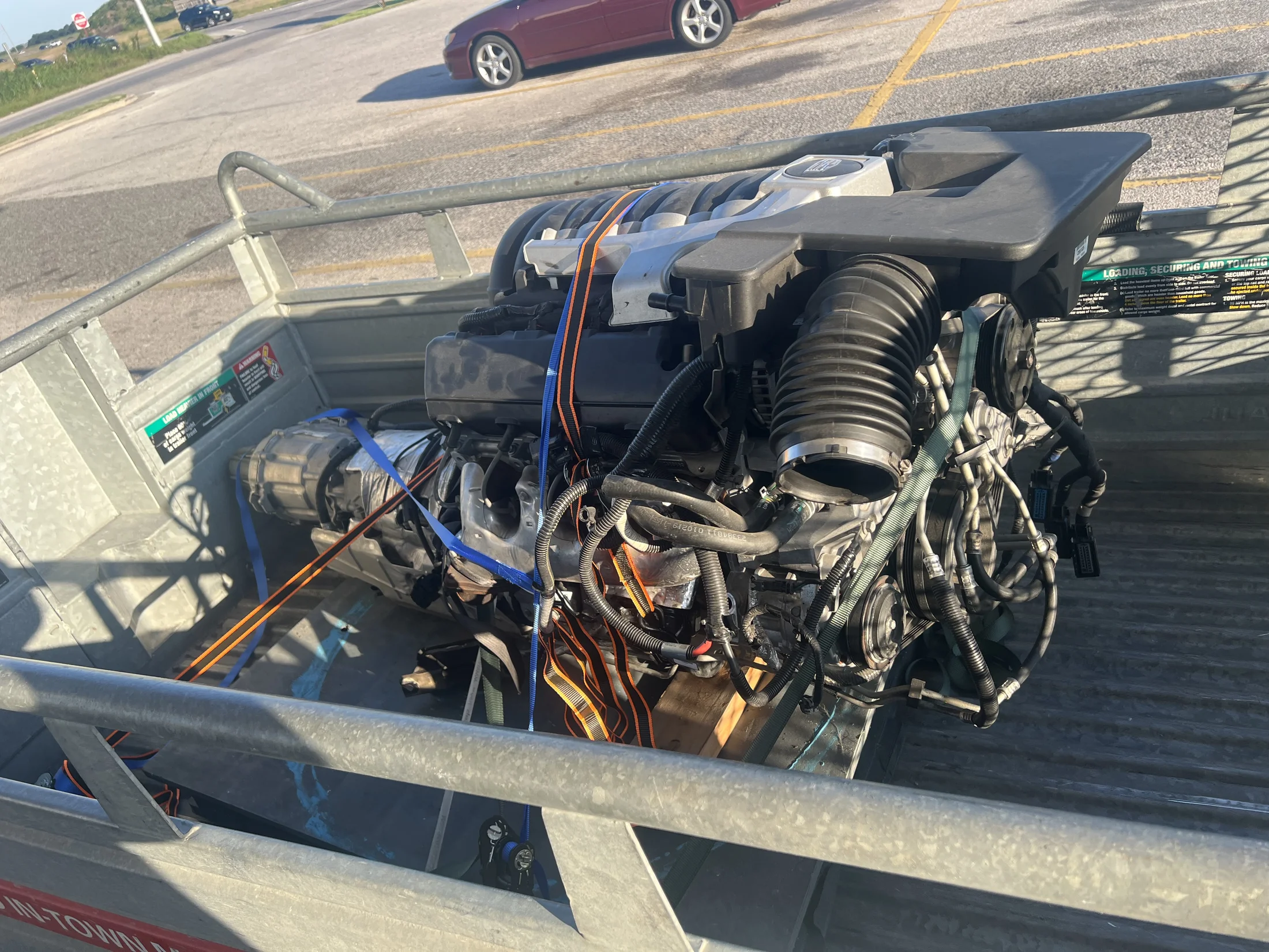

On June 16th 2024, I found a sweet deal on a 2018 L86 and 10L80 take out from an Escalade with 36k miles. I rented a trailer, made the 4 hour trek to Houston and picked up the new heart for the Beast

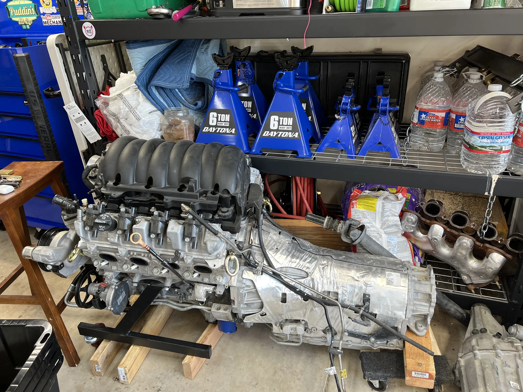

The drivetrain came on a plastic pallet… which collapsed in marvelous fashion. Then I put it on a set of overpriced LT engine stands which were advertised to support an LT engine and transmission… this thing failed the second I put the weight of the engine on it.
So the drivetrain ended up on a tire for a few months… but between the tire and the hoist, I was losing a ton of space in my cramped two car garage.
I bought a much heavier duty LS engine stands which from Speedway and a set of ICT Billet engine conversion plates. This solution has held up much better. It’s easy to move around the shop.

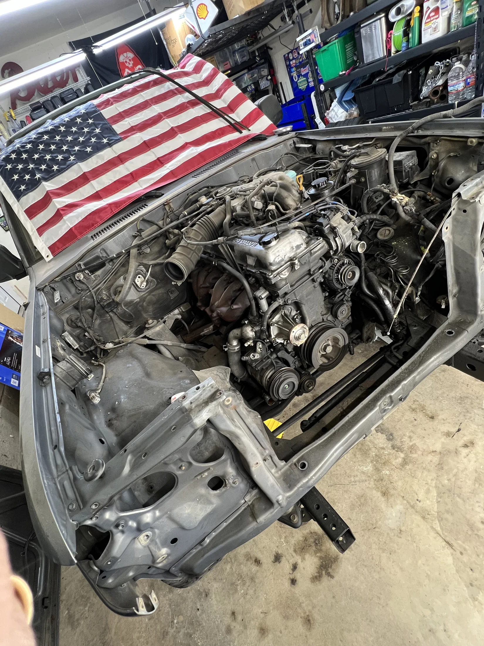

From there. I started stripping the drivetrain from the truck. An hour here, an hour there… it was about this point that the sheer cost of the work to be done started coming clear… I have been meticulously tracking my build plan, including cost, labor hours, and side projects.

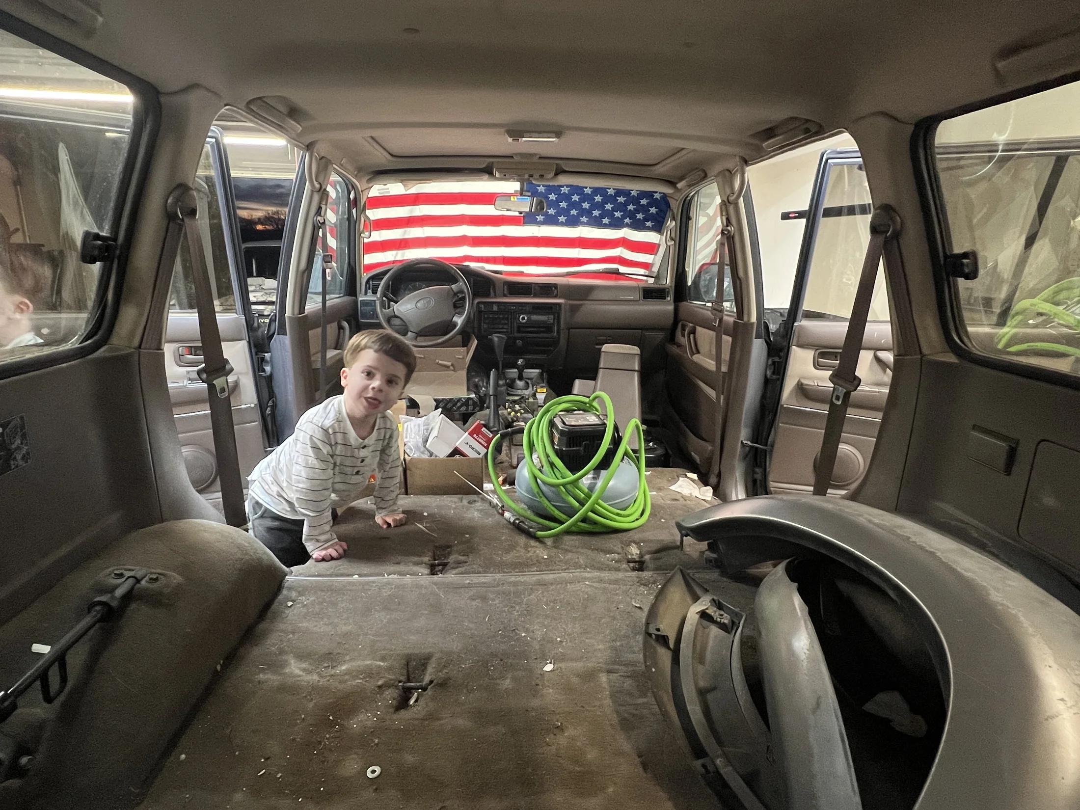

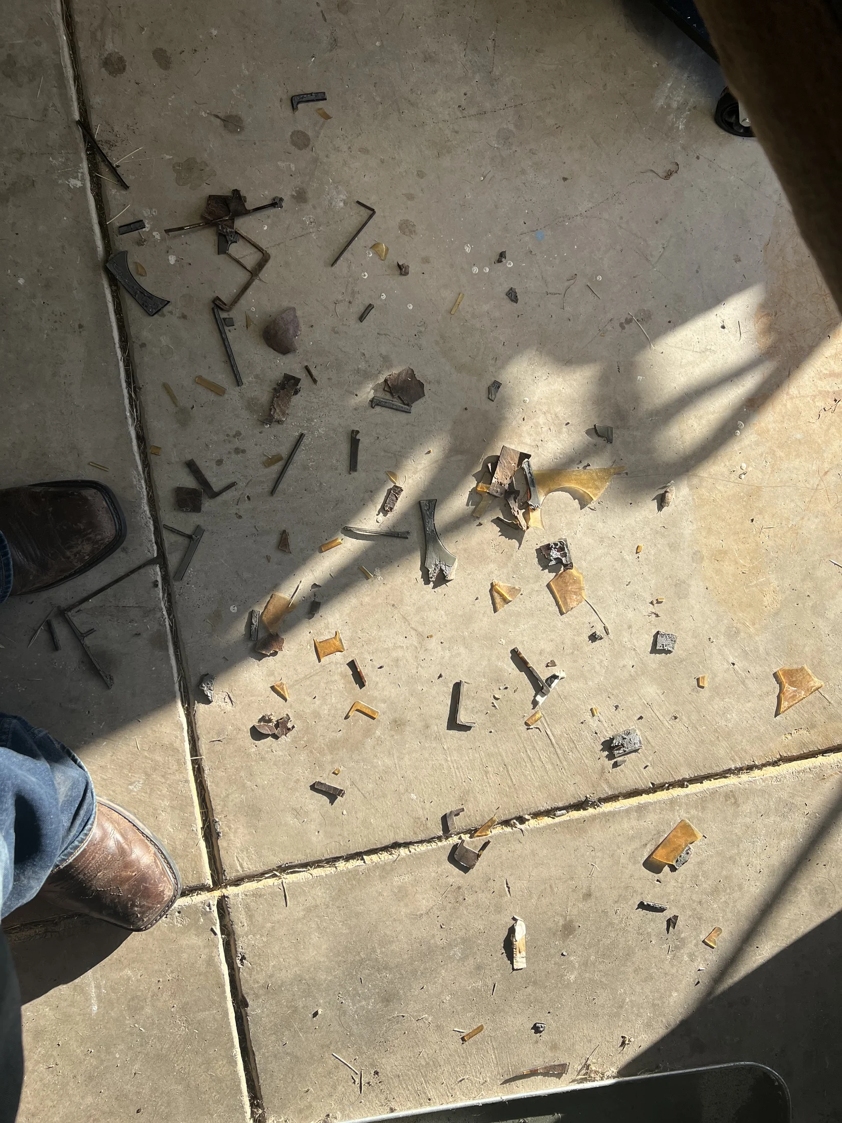

So naturally, I decided to strip the body down and remove the interior. I removed the majority of the interior until I realized I can’t get the headliner out with the 80 in my garage.
I need to recover the headliner. While it’s out, I also want to plug weld the roof rack holes… and (horrors) I plan on welding a patch panel in place Of the Sun roof. I’m hoping this work will result in a more weatherproof future of the rig.
While the interior is out, I’ll redo the window runs and insulate the heck out of it and replace the carpet. I’m still undecided kn the seats. At least for now I may just put covers on the existing seats. Eventually I’d like to do something more comfortable that doesn’t cost Scheel-Mann money…

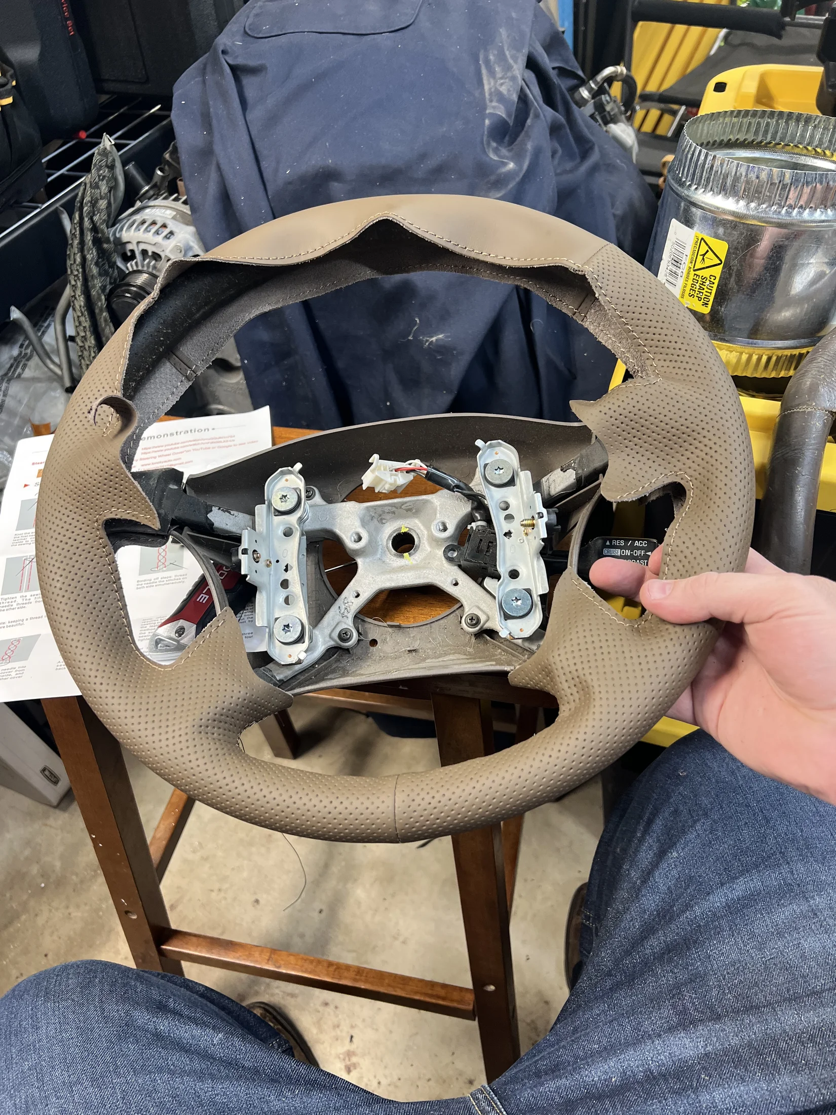

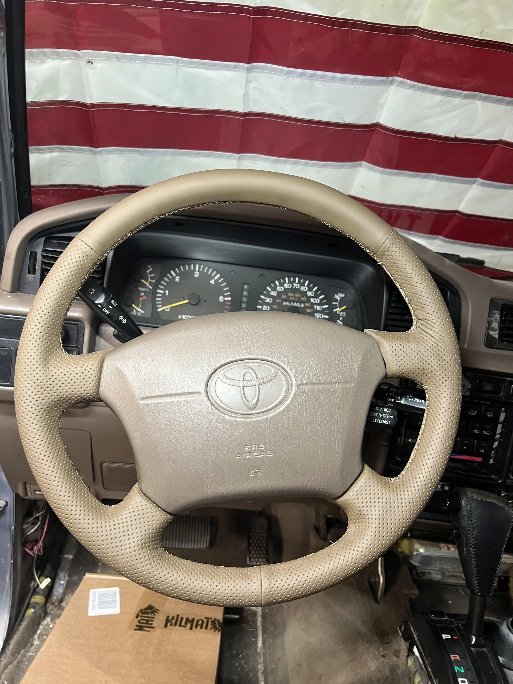

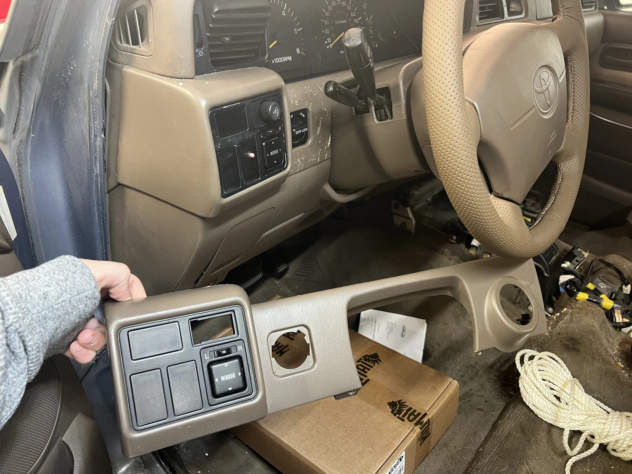

While striping the interior, I managed to remove all the peeling faux wood grain from the interior. Mine had delaminated over the years and colored into some weird yellow tone. I did basically destroy the key panel around the steering wheel. Thankfully I found a $50 replacement in perfect shape:
I removed the steering wheel and installed a Loncky steering wheel cover. All in, I spent about 6 hours labor on this little project. While not perfect (thanks to me learning as I was going) the final result is phenomenal and miles better than the slip on cover hiding the beat up steering wheel. This steering wheel project was the first component I’ve finished and put back on the truck. After months of either staring at the truck, or disassembling things, it felt good to complete something for a change.

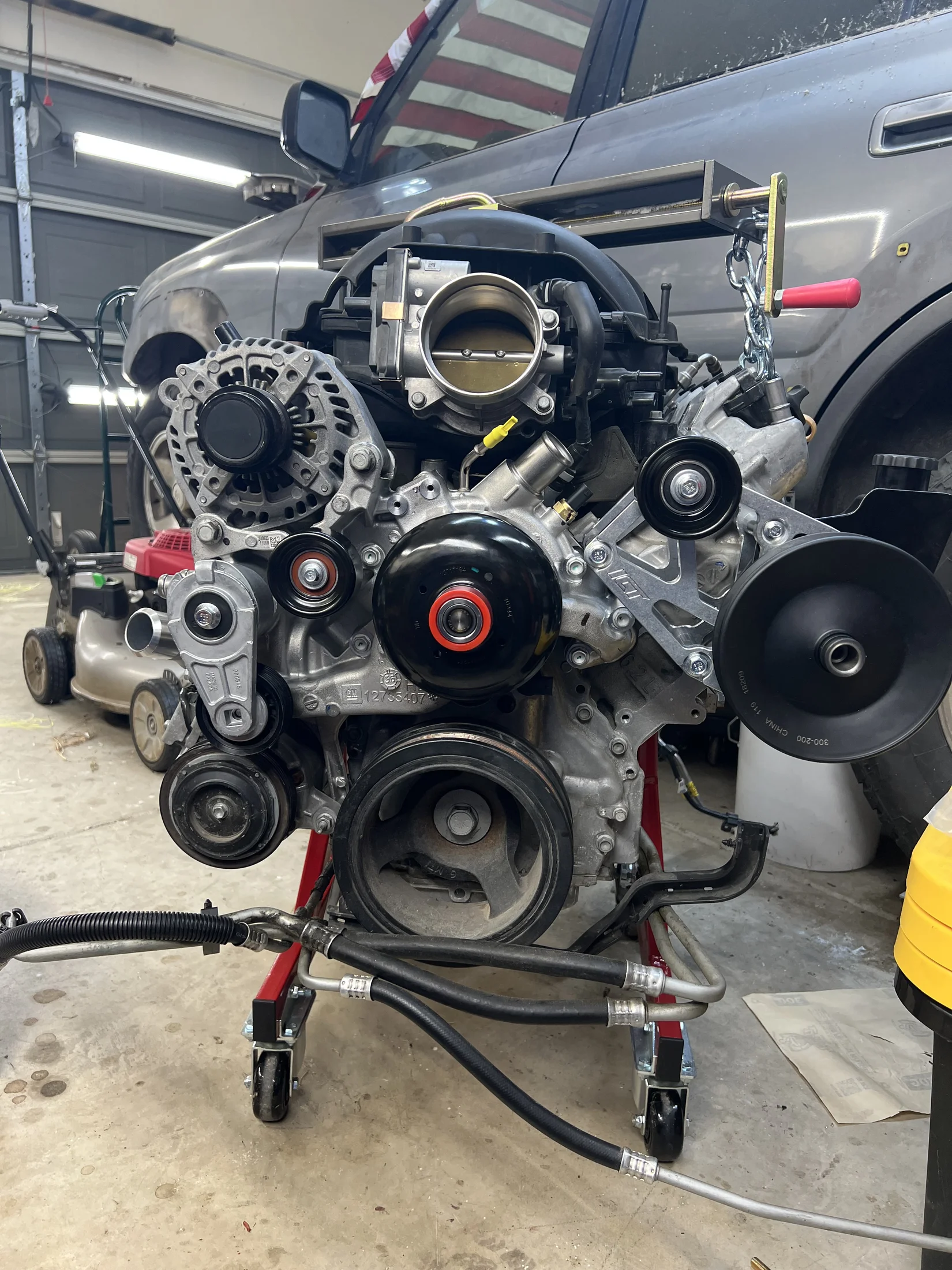

Accessory drive:

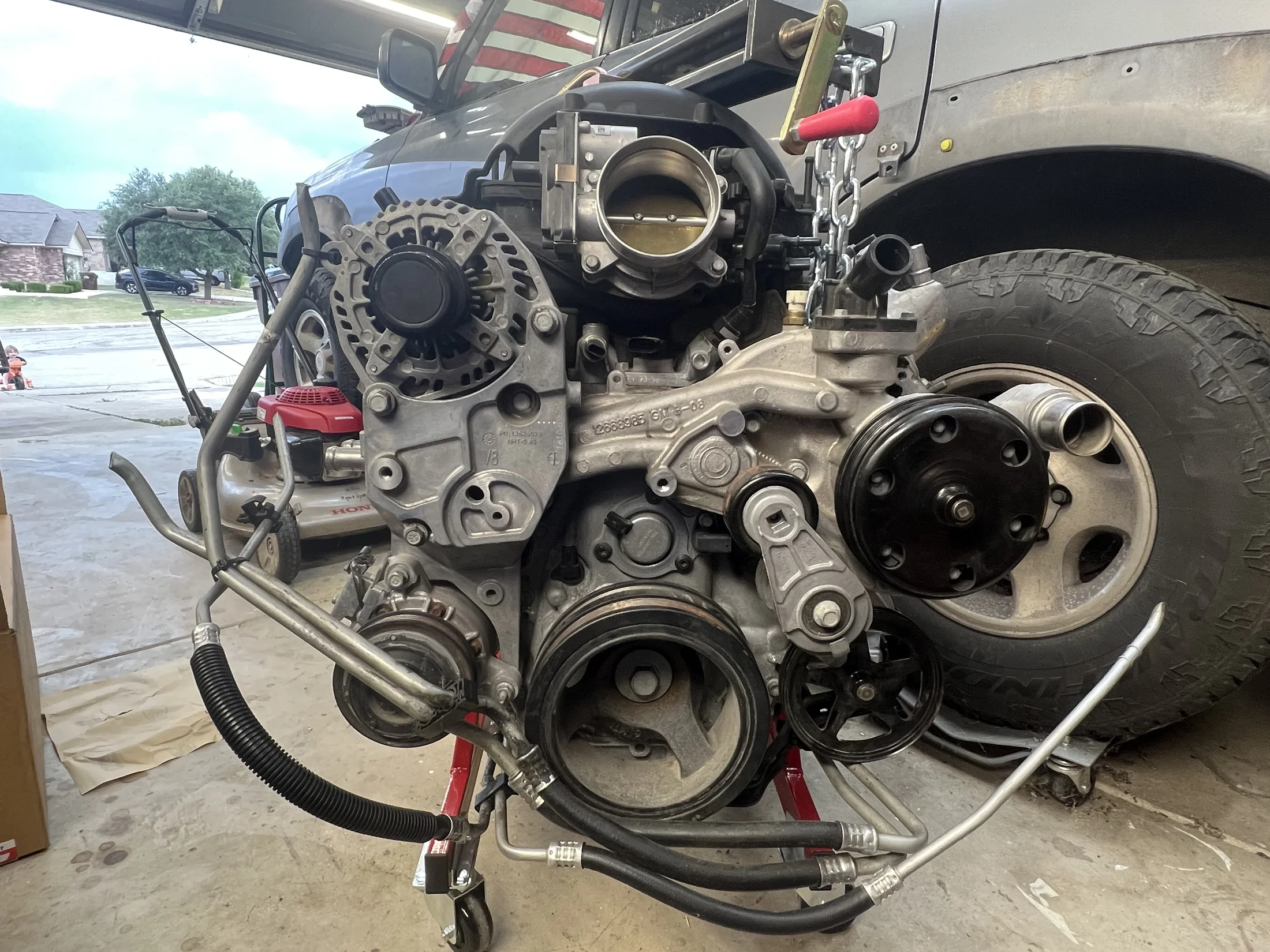

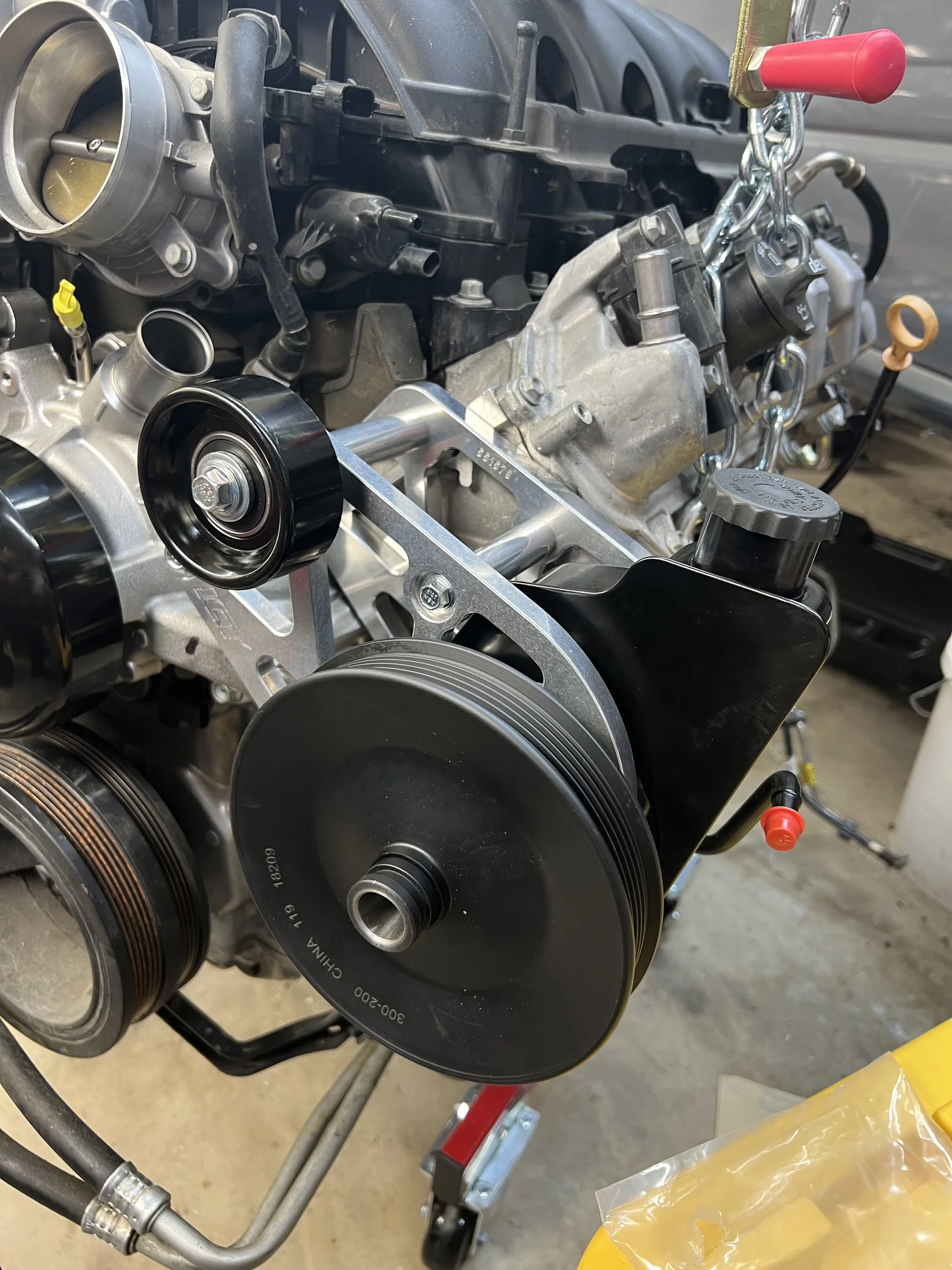

Let it be no secret, I set out on this project closely following Matt’s project Sparkles Build and the Project Wintergreen build threads. These two trucks and installed methods are pretty much directly copied here. One area where both builds have commented needing improvement is the L86 power steering solution. I too ordered the Tejas Steelworks kit, pump, and pulley. And I was pretty much resigned to the reality of a tight fit to the steering gear box and pump/frame.
Then I learned that Mitch at Swaptime Offers a “swaptime drive kit” for the L86 which mounts the pump up high like an oem integration. Being a frugal(ish) guy, I started researching other options.
I learned that you can swap an L87 water pump into your L86 (just swap out the temperature sensor for the l86 temp sensor) and in doing so, you get rid of the weird offset water pump, you can get a high volume HD water pump with threads for a fan clutch (doubt this will fit in the 80 but a nice option) and you get rid of the dumb separate ac compressor/alternator bracket. They both mount directly to the L87 water pump.
Accessory drive Before:
Finally, ICT Billet offers a power steering kit for the L87, this bracket uses the same power steering pump the Tejas Steelworks kit uses, and it puts the power steering pump basically where the L86 water pump pulley was… this swap costs about 1/3 the price of the Swaptime Drive kit, and I think looks a lot more polished. The bracket sandwiches the pump and holds it extremely securely.
L87 water pump TOP
L86 water pump BOTTOM
ICT L87 power steering mock up
Final mock up accessory drive. I’m very happy with how tight it is to the heads.
Note: I spent a ton of time researching this and while it is not installed and working on the truck yet, I do not foresee any issues with it physically sitting in the truck. One item k lost a lot of sleep about, the AC compressor. In all the power steering kits I researched, nobody specifically mentioned compatibility with factory AC… pictures, schematics, etc, all excluded it. I pulled the trigger on the purchase and then realized I was way over complicating the whole swap. The AC compressor runs on a dedicated belt slightly behind the serpentine belt. It’s excluded from all the diagrams because it’s totally separate. Lesson learned, go outside and look at the motor for a bit before losing sleep over it!
One additional concern: there are a couple harness connectors behind the center of the water pump. On the L86, these were very easy to access. With the L87 pump; these will be next to
Impossible to service without removing the water pump.

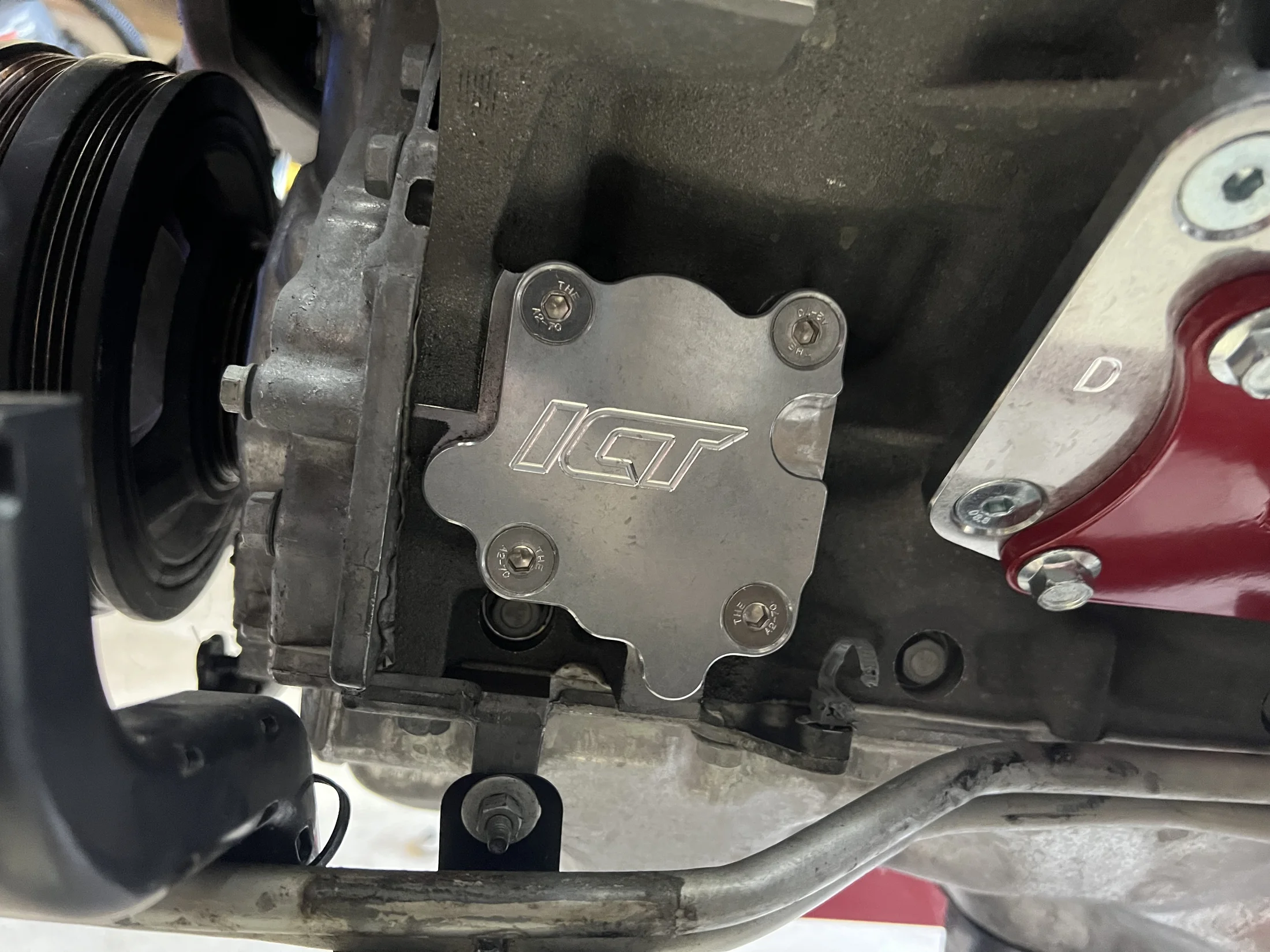

While installing the new accessory drive and tensioner/idler I also removed the vacuum pump and installed plugs and a ICT Billet block off plate.
<ICT Billet vacuum block off plate>

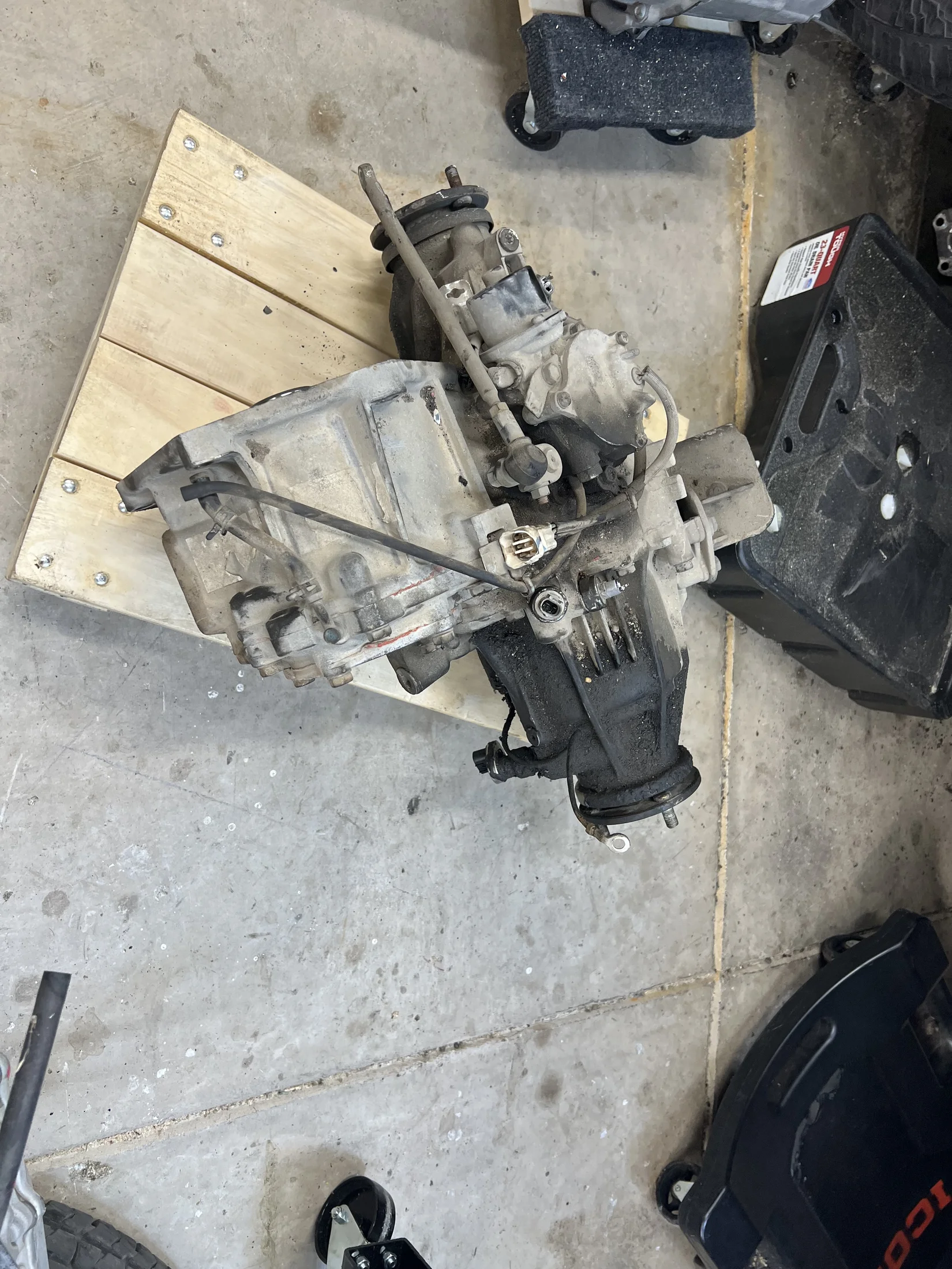

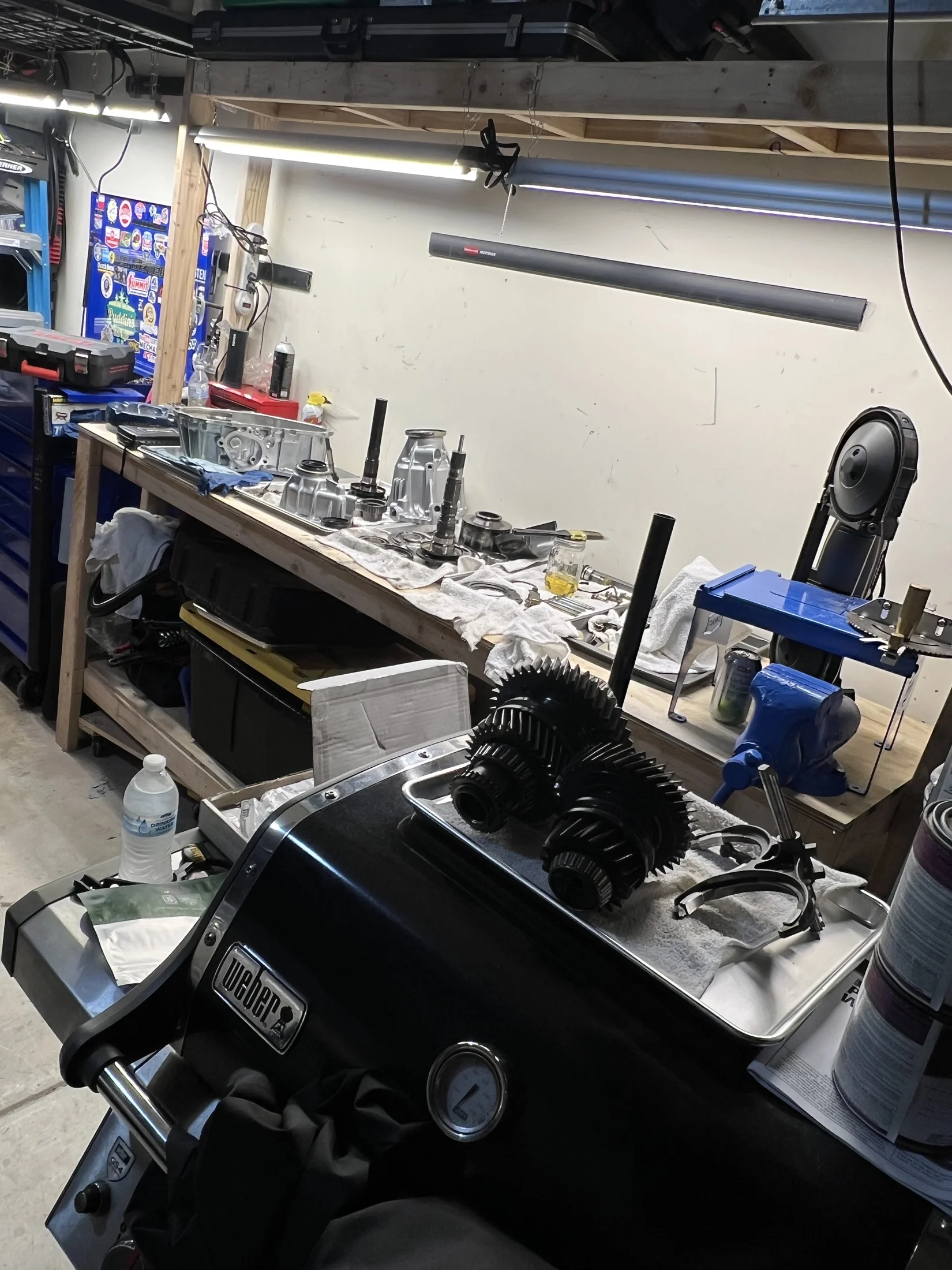

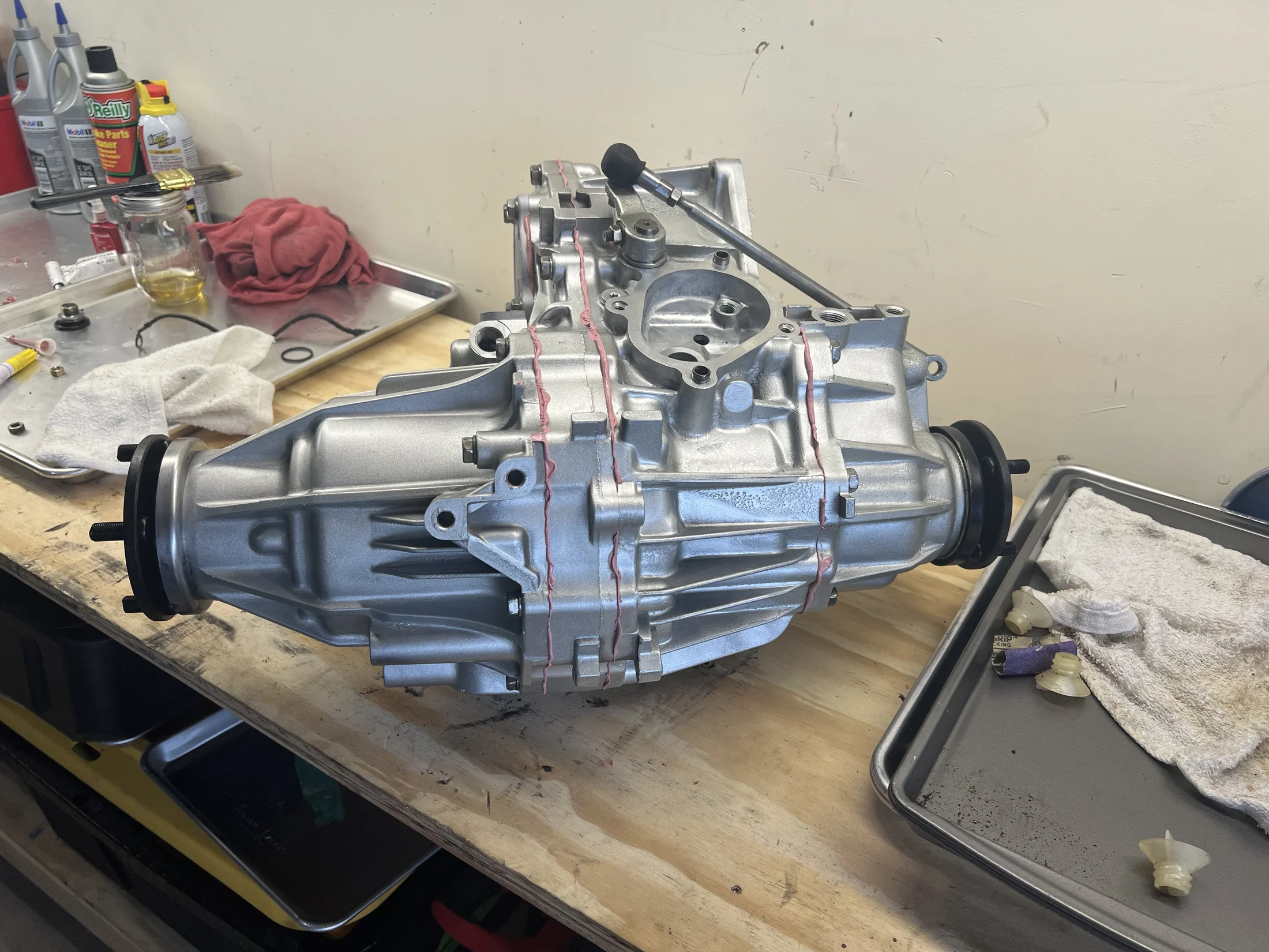

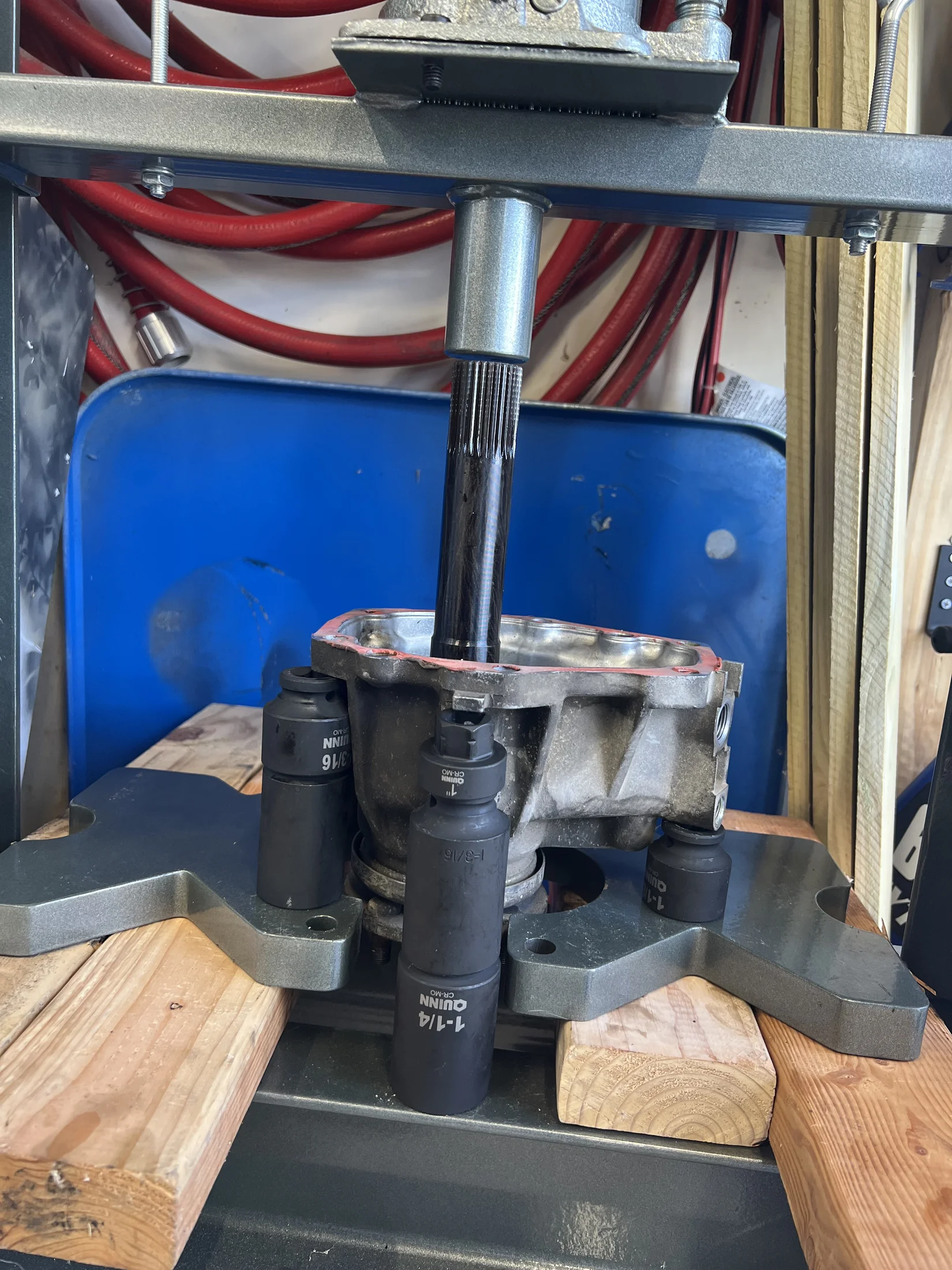

With accessory drive solutions in place… I decided it was time to get eyes on the Transfer-case. Originally I was planning on just removing the Transfer-case then installing it directly on the swap. BUT, at 367k miles, it was leaking… from everywhere. I’m 99% certain it has never been apart based on its condition.
Removing it was a challenge, the whole underside of the truck is coated in just about every fluid you could imagine. And every connector or hose has crumbled when touched. As the truck sits today, I’m going to need to rehab the entire Transfer-case sub-harness.
When I started this project the goal was to do as much of the work myself as possible. For me, this is about developing a real skillset and understanding the hobby. So naturally, I started looking into what it would take for me to rebuild the Transfercase on my own.
That’s when I found Benjamin Draper’s (project wrongway) Transfercase rebuild video with Georg Esterer on YouTube… closely followed by Timmy the Toolman and Georg Esterer’s subsequent HF2AV rebuild video series… I called Georg, he provided some really great advice for my specific build. And I ended up purchasing a complete Transfercase rebuild kit from him. Overall, I was and still am thoroughly impressed by the integrity and speed with which Georg runs Valley Hybrids. I’ll be purchasing a bunch more from him in the future.
A couple things to note if you choose to follow my adventure. The video series installs a lower gear set and part time kit.
80 series transfer case rebuild - Part 1
Part 2
Part 3
Part 4
I did a straight rebuild of my Transfercase. This meant reinstalling my original center diff. There is a bearing inside that component that is not included in the rebuild kit. I’m pretty sure this is because the majority of guys rebuilding these are part time swapping them. The bearing is NSK DB503305, and by chance, was the only bearing in my Transfercase that actually showed wear and was near failure. The bearing proved to be slightly difficult to obtain using the open web. I finally found an eBay listing for it and had it shipped from Australia before the Tariffs took effect
I took my time on this project. Lots of watching the videos, following the steps, cleaning, scrubbing, painting, etc. Georg mentions in the video series that it takes about 15 hours for them to rebuild a case. I did it in 47… and still need to install a couple external bits.

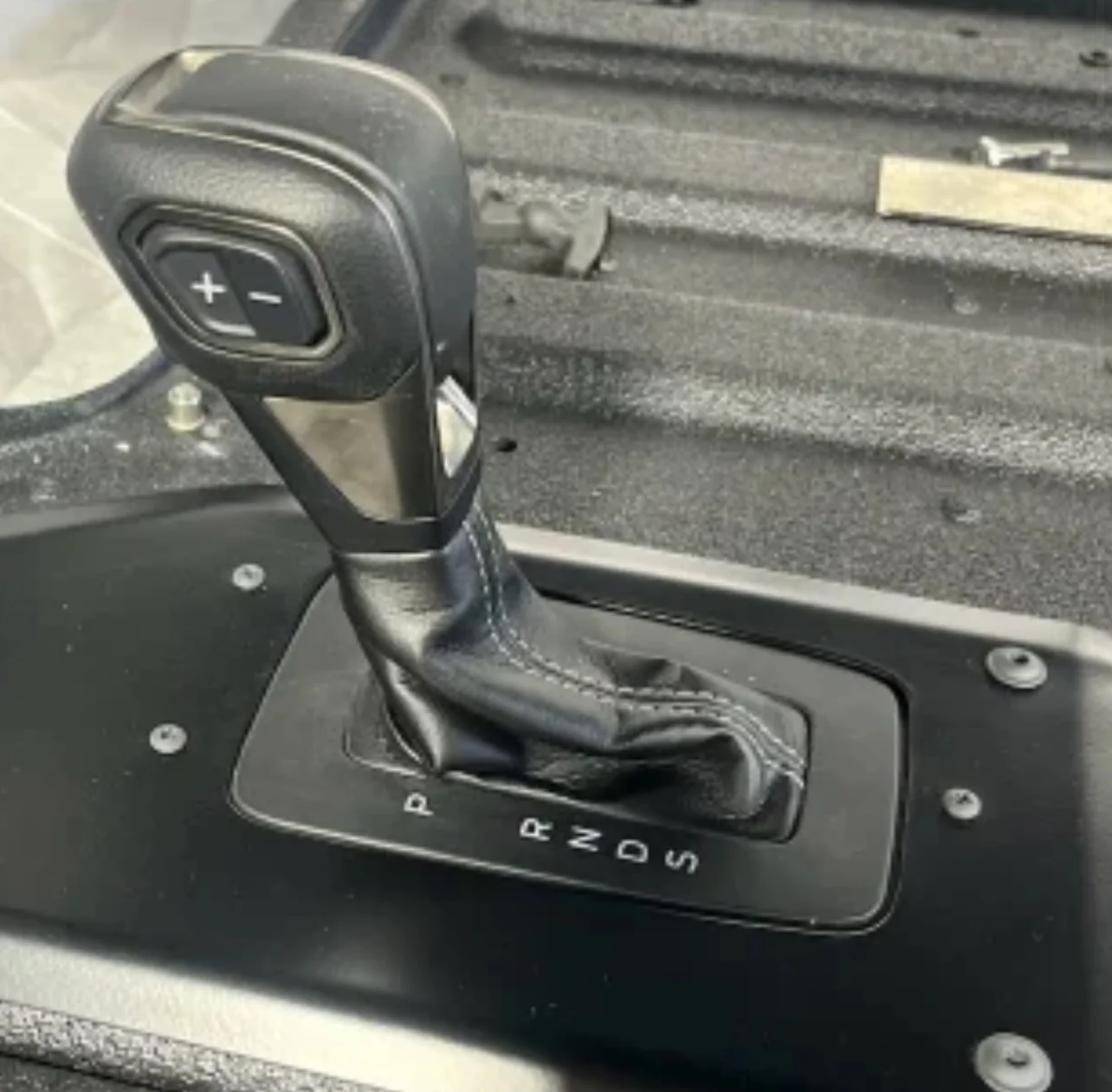

After watching the different solutions everyone has come up with, and the fact I’m not overly committed to keeping the 80 factory appearing… I’m toying with changing the shifter to a modern 10L shifter that has the tap shift buttons built in. They are also cable shifters, making them a lot more adaptable to the 80 series. I haven’t bought anything yet. I may change my mind when it comes time to execute.
