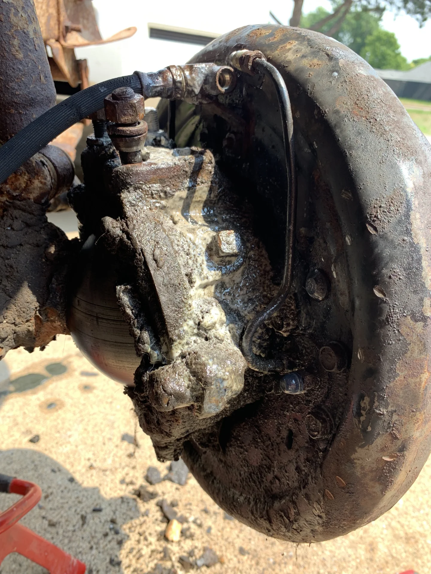

I bet the front pads are rusted / swollen to the drum from wheel cylinders leaking. Replace complete brake system wheel cylinders/pads/ soft lines and master. Might get away with leaving hard lines depending on condition. Great score!! Enjoy the journey!!! Lots of pics!!
Thank you CRZR45!! Your knowledge is much appreciated. We will be doing this one right. 100% mechanically sound, is the only way to do it! Pictures, pictures, pictures, I agree with ya. Thanks again for the reply.

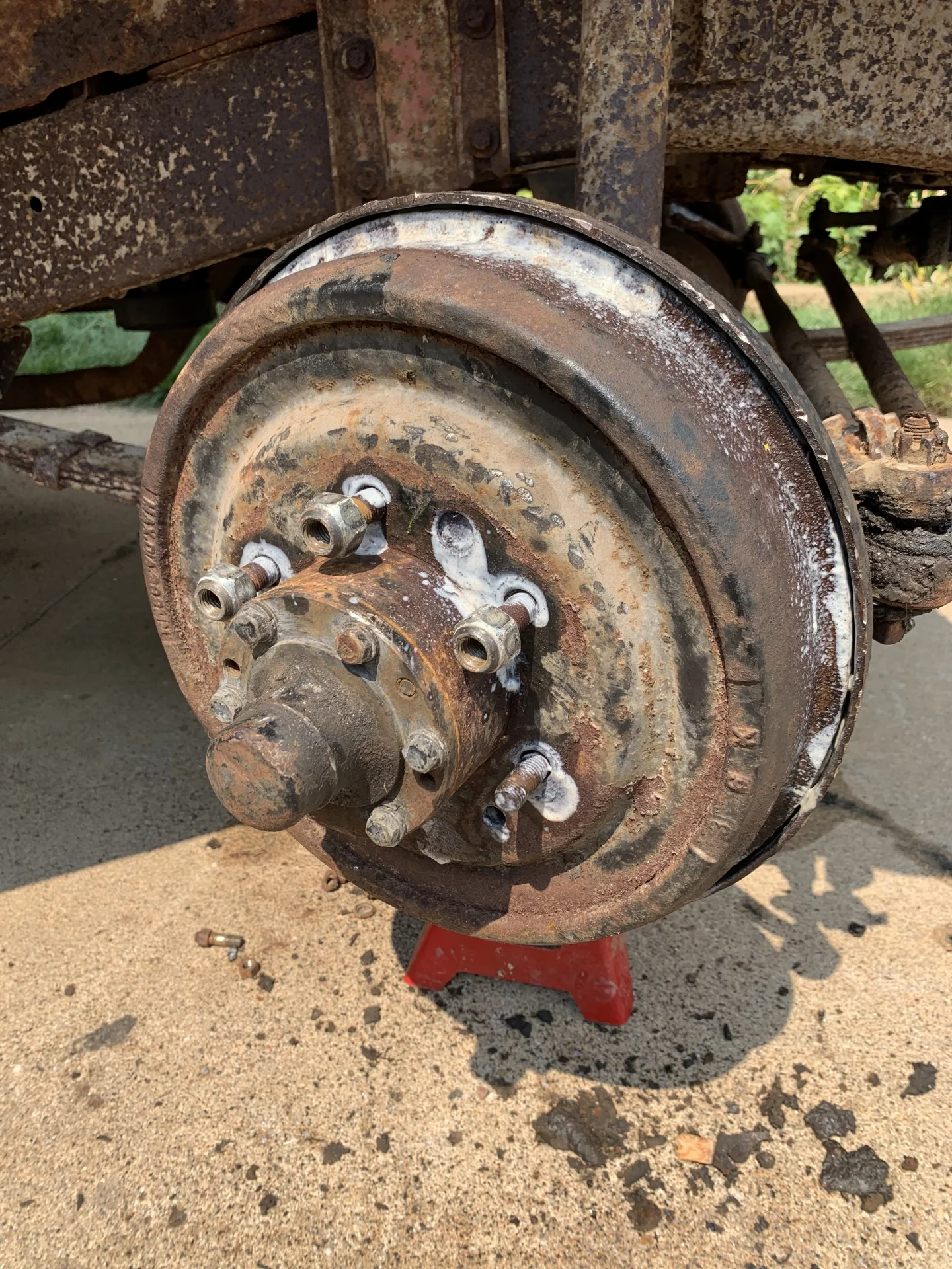

Working on getting the front wheels to roll. I have no mechanical expertise here, trying to research the forums and google. About to get the torch out, they won't budge!!

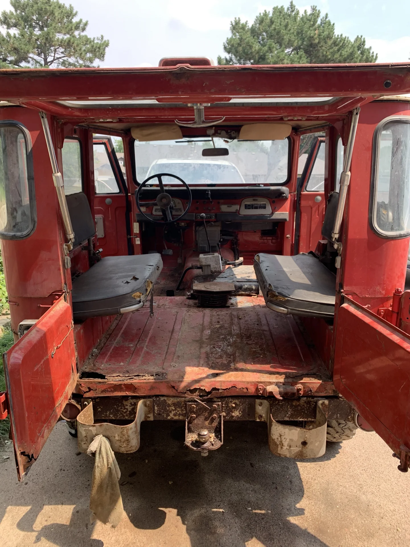

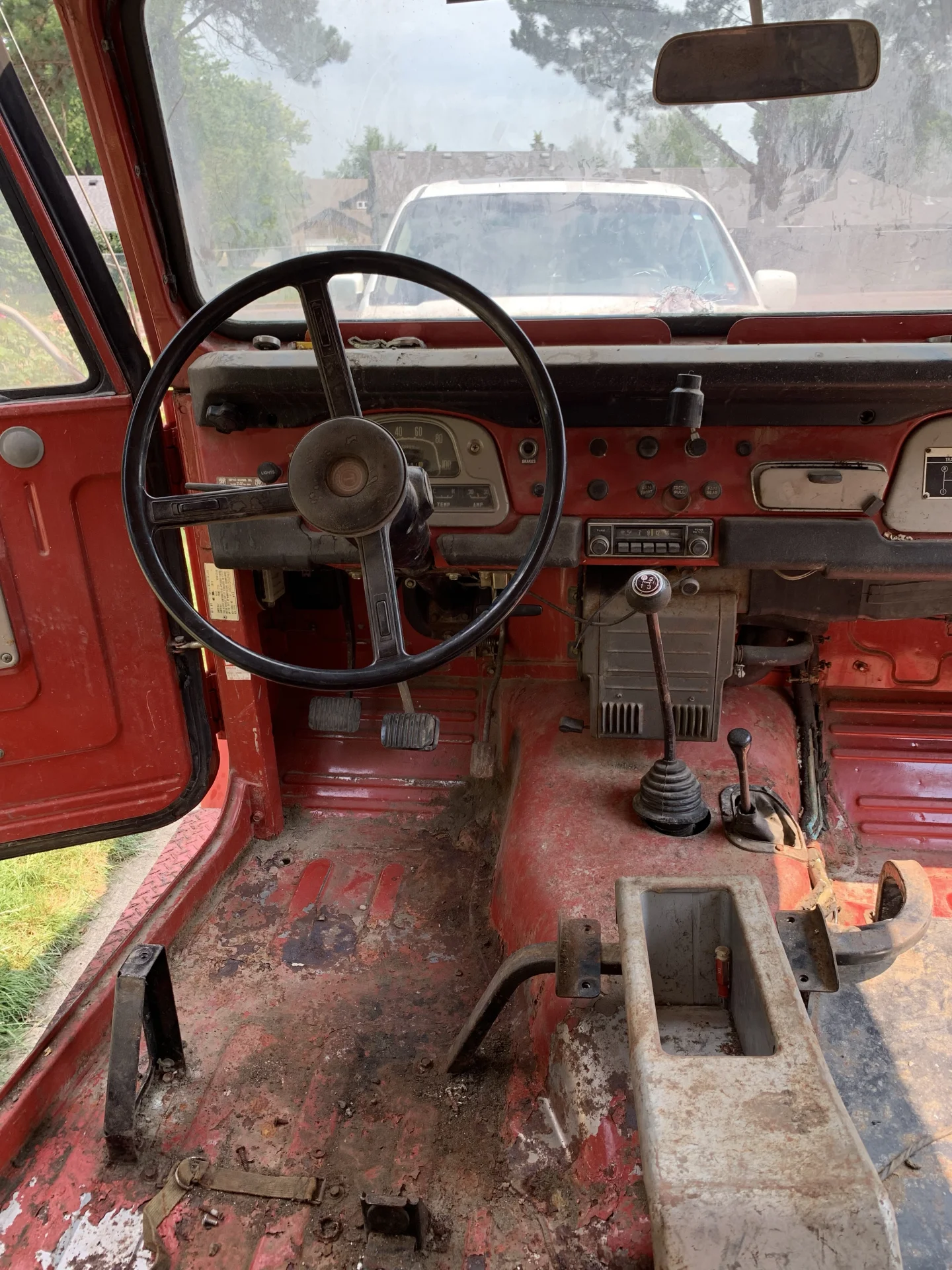

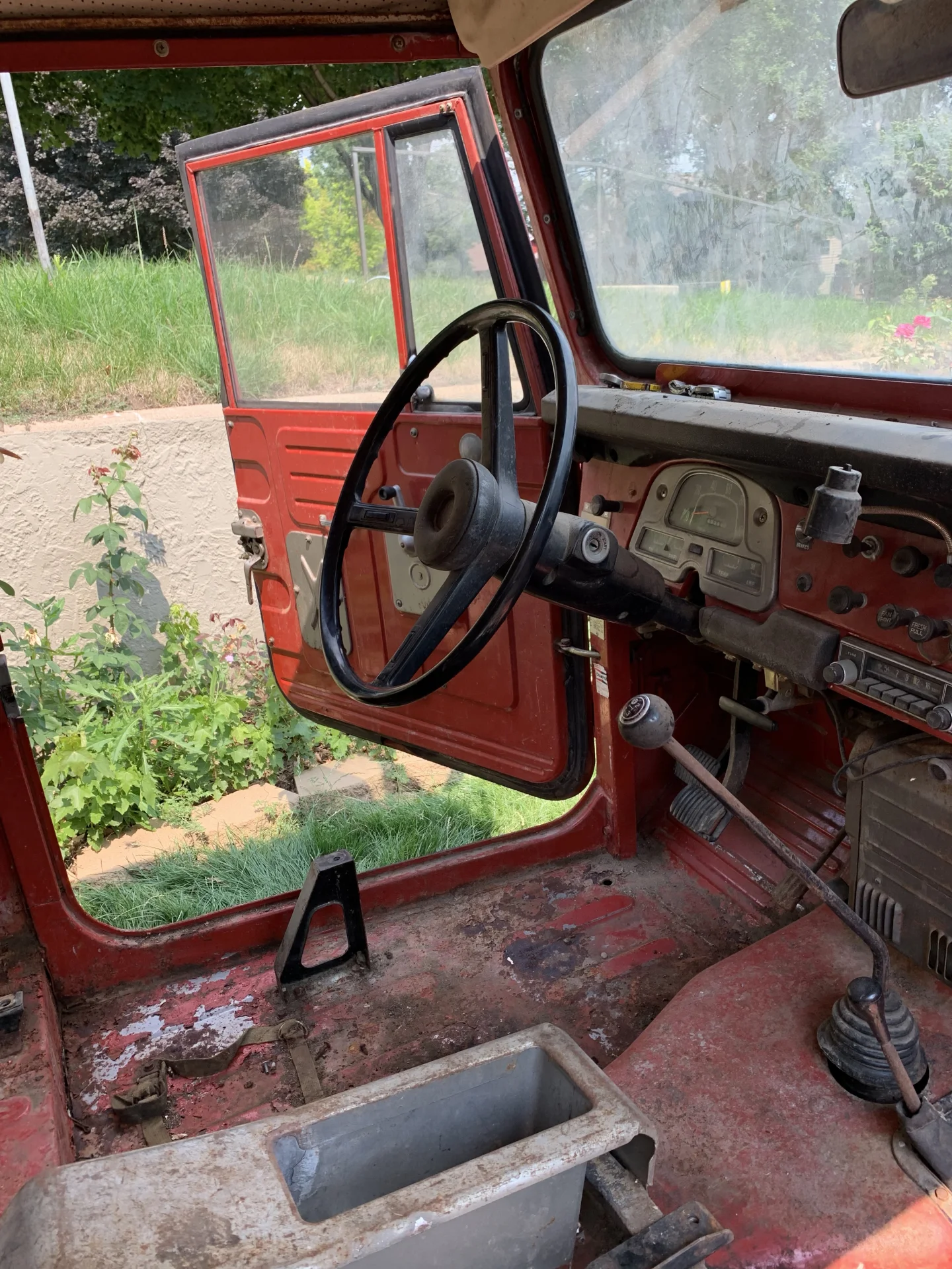

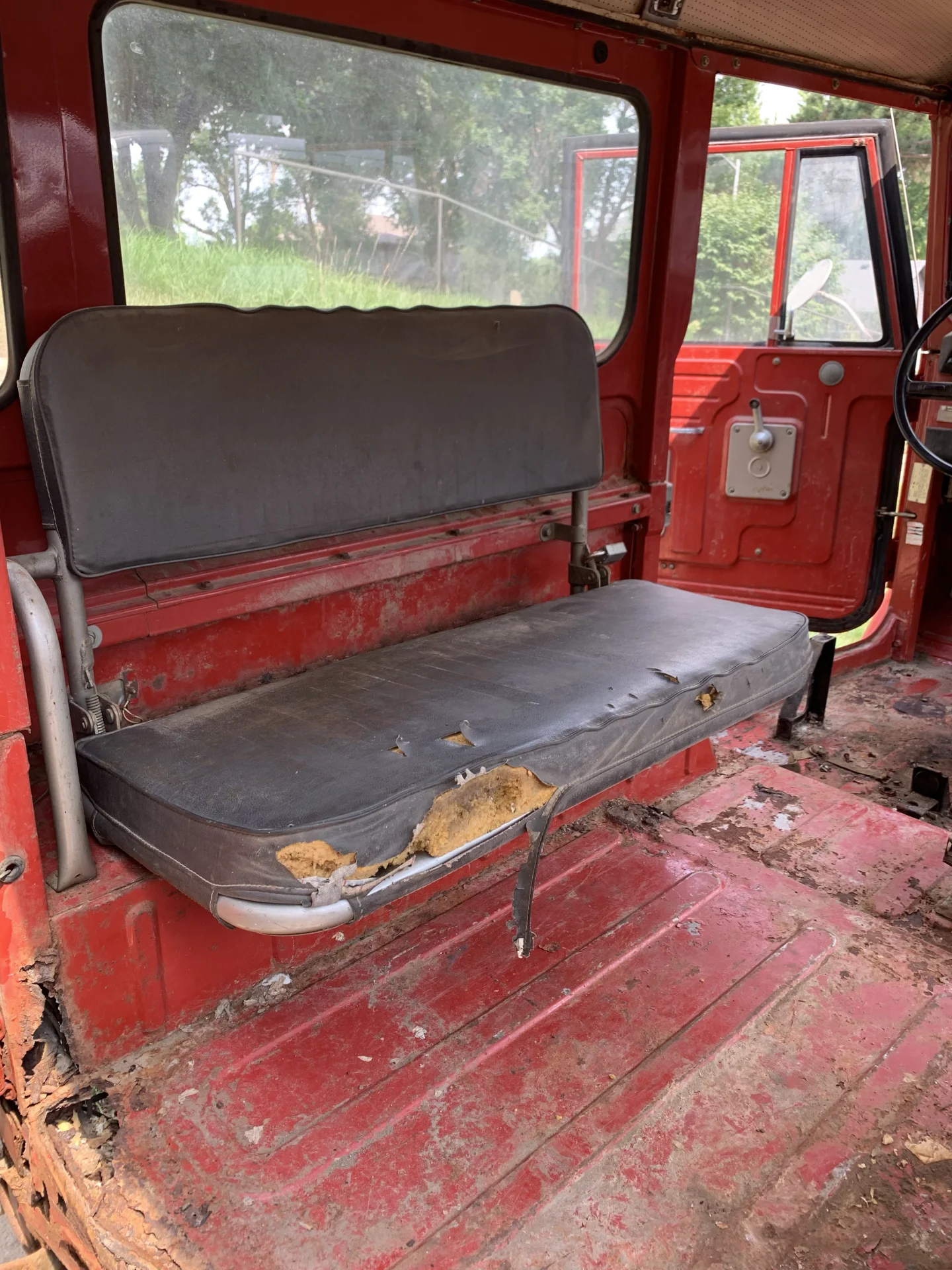

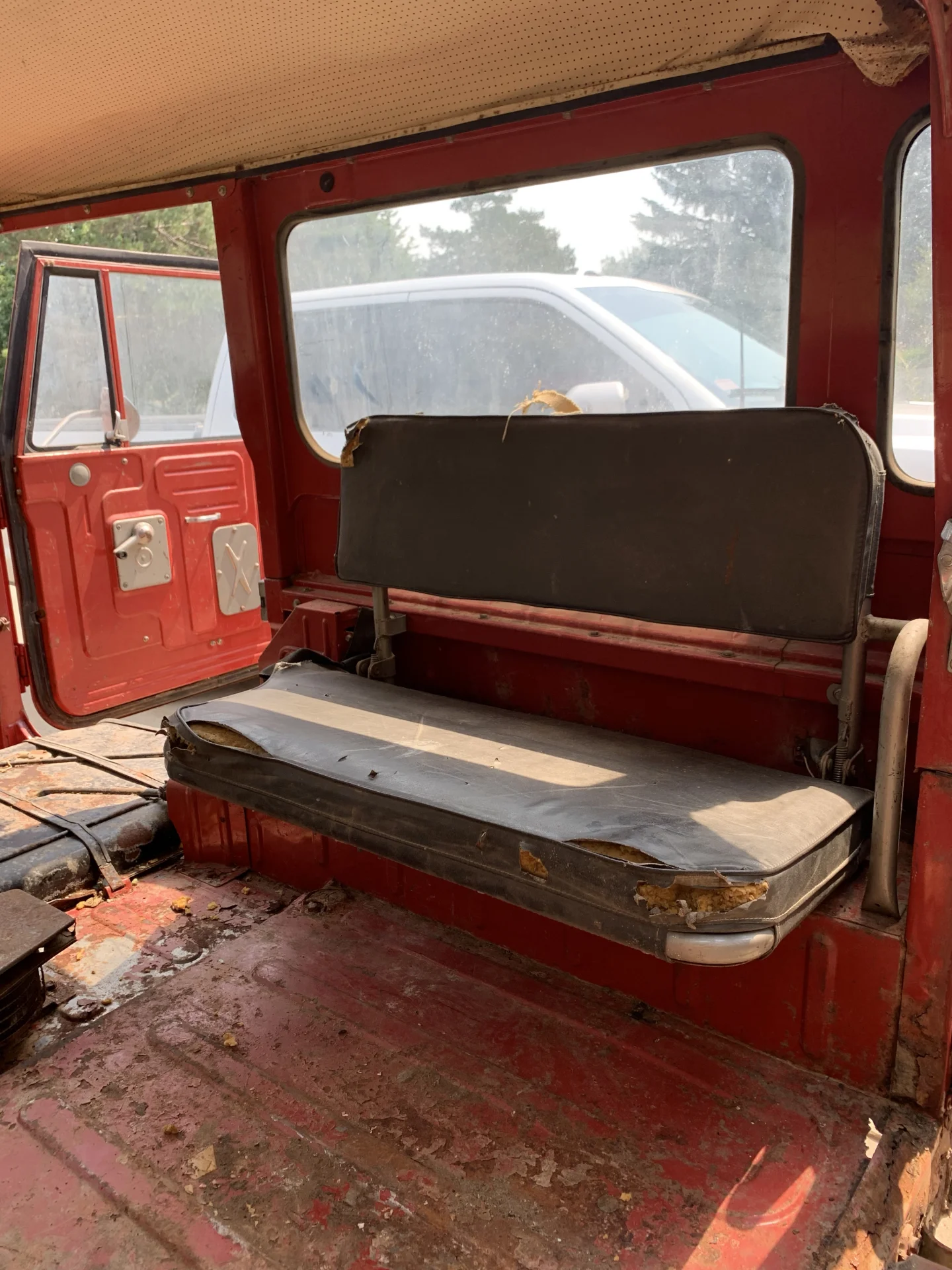

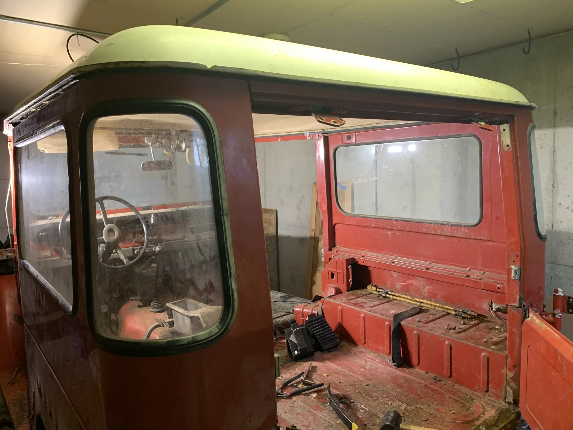

Here are some interior shots! The amount of stuff we cleaned out was off the charts. Found two soft doors, so that was interesting.
I have to be honest, that tub does not look bad at all from the interior. Looks like all you need to do is get the seats reupholstered and weld in the rear body panels that are rusted out and you have yourself a solid interior. I also noticed the drivers side rocker isn’t rusted out which is a good sign. These usually rust holes through the rear and rocker panel area (like the green one but not usually as bad). That’s where the mud and grime goes when driving along.
