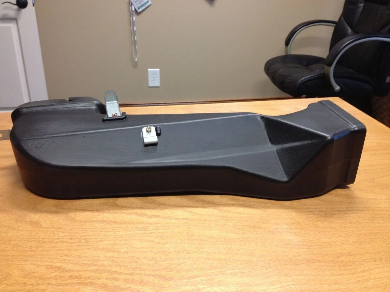

Thanks to @Racer65, "Needle in a Hay Stack found!" Received the L200 duct below to replace that nagging aftermarket heater hose eye-sore!
Below is a Side by Side comparison of what was on my rig vs what is now installed......Really, there is no comparison at all! But, you make do with what you have at the time, till you can source the correct parts and pieces. Bring on Old Man Winter! Now I should be able to move about twice as much air thru my heater box than previous winters. At least in theory that is..... :hillbilly:
Being this is hard plastic, if I had the CAD package for a 3D printer, I'd draft this little jewel up!
