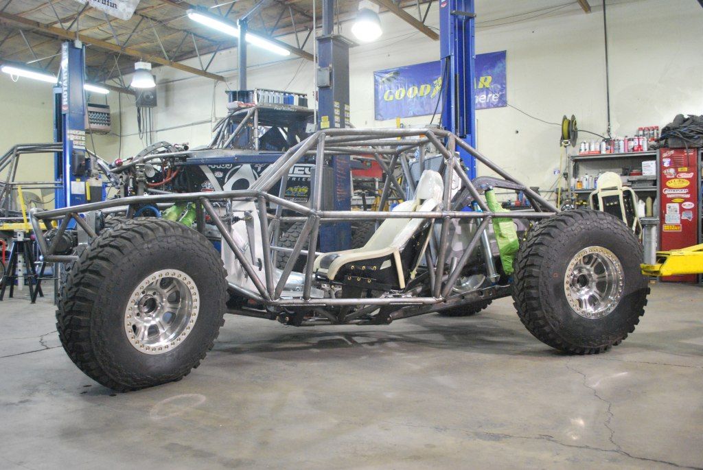

I did manage to get out to the shop and test fit the headers.
Lots of work to get this pig the way I want it but cleaning up the engine compartment will be the start.

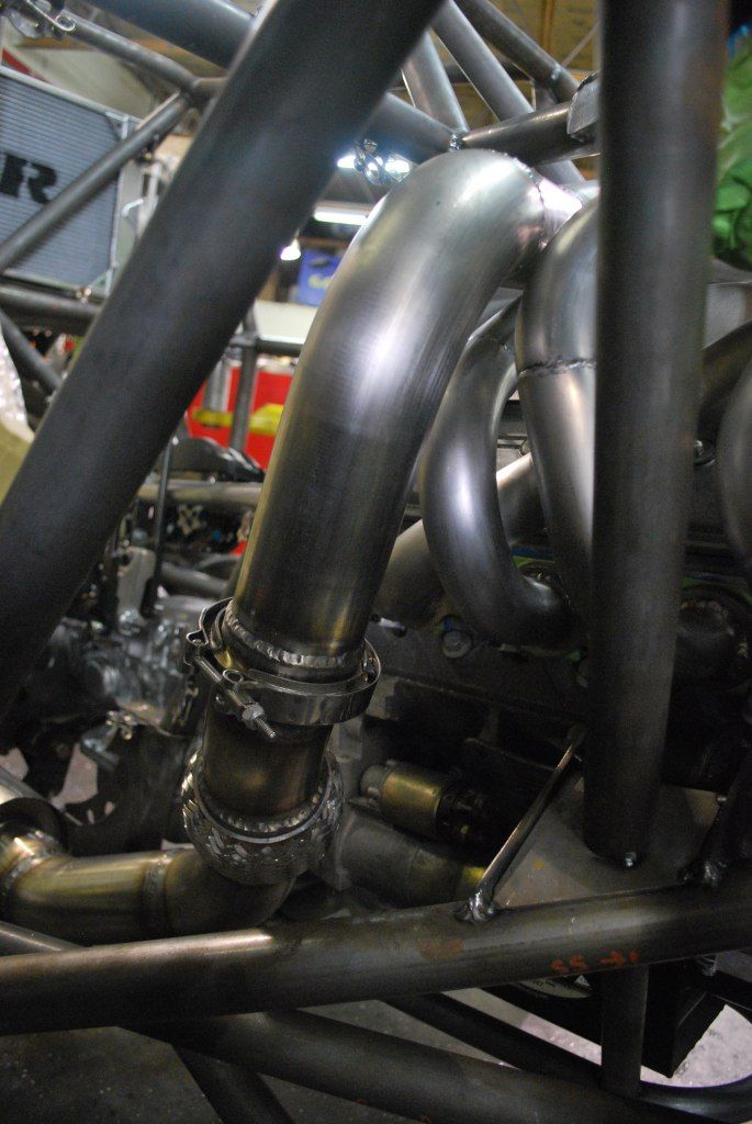

will the exhaust just turn down and run out the back or something else ( I'm all confused! ). I can see you're going to have a lot of fun building this one.
It will go something like this...

The plan is to hack together a steel body from leftover 55 parts I have laying around and attach them with DZUS fasteners to the factory panel locations so I can run the aluminum panels if running trails that damage is imminent and run the 55 skins the rest of the time.

To avoid limiting wheel travel, what about a pig-ish hood and cowl, narrowed and fit low on the chassis, with wheel fenders (for lack of better)?
That’s funny, we were talking about just that to get the impending fixit tickets signed off.

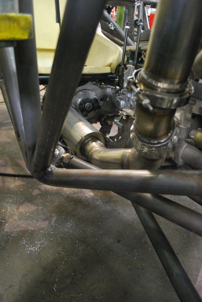

But back to the exhaust:
Was there a reason to run it up/over the intake?
The thing I like most about the Trent Fab cars is they sit extremely low but that presents an issue with packaging and the headers are one of those issues.
These photos show the car @ full bump, and you can see no way to get headers and mufflers out through the bottom between the links and frame.
The other car (Bomber Fab) I was looking at buying had similar setup but ran straight back instead of off to the pass side,
At the end of the day I’m just a poser and a car that looks cool is more important than a car that wins races so I went with the Trent Fab car to save some money to invest in bling..
