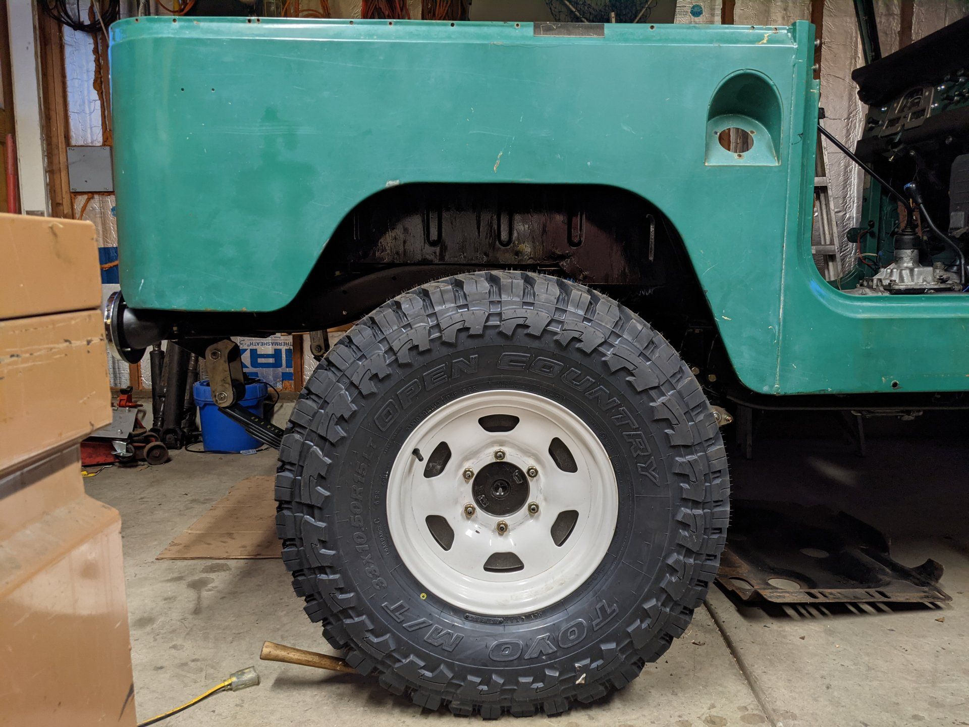

Hung the body from the rafters, rolled the frame under, and sloooooly got it all bolted on!
Wow... tires fit perfectly in the wheel wells!

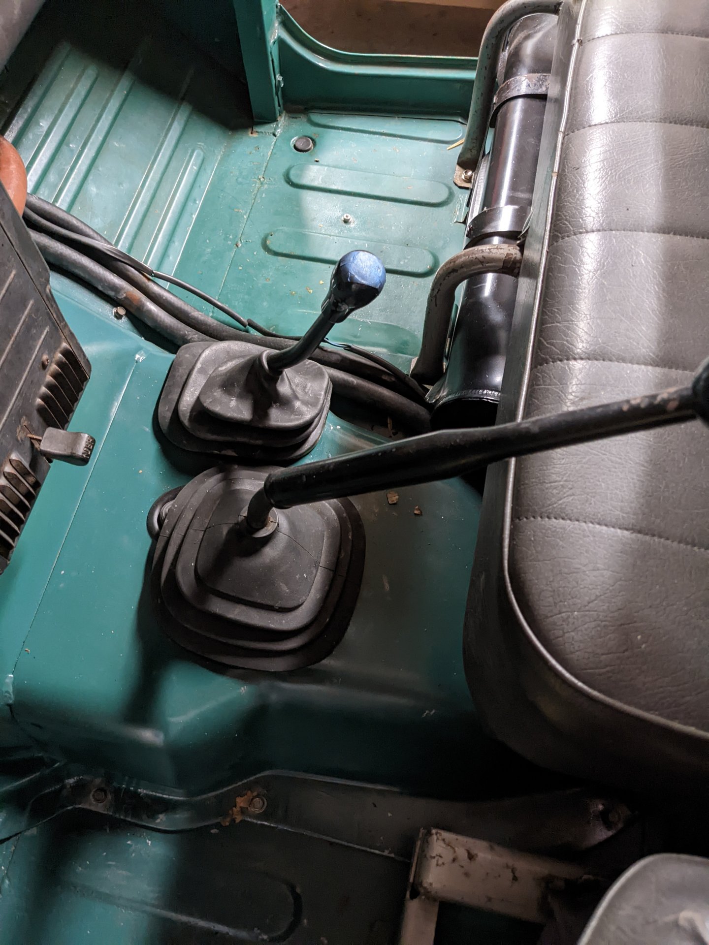

Was hoping I could cut and reuse my transmission tunnel but looks like it will also require a spacer or something to clear the four speed.

Eventually going to need to do tranny hump and skid plate modification unless I can find different ones from other years that will clear the spit case, shifters and transmission from the 60?

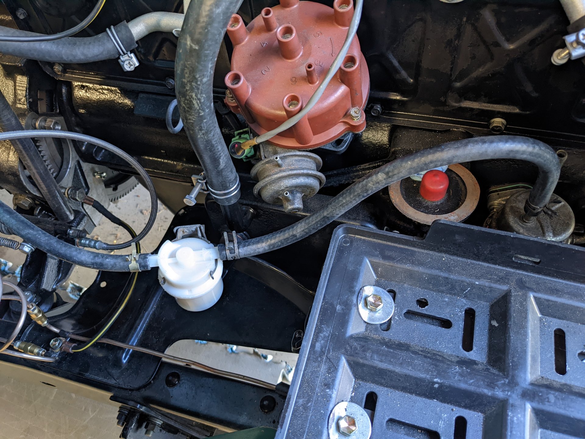

Even started thinking about fuel filter options.....and ran most the fuel line....

Removed the City Racer carb and went back to the 83' 2F carb, plumbed in all the non smog vacuum lines.
Then modified the tranny hump.
