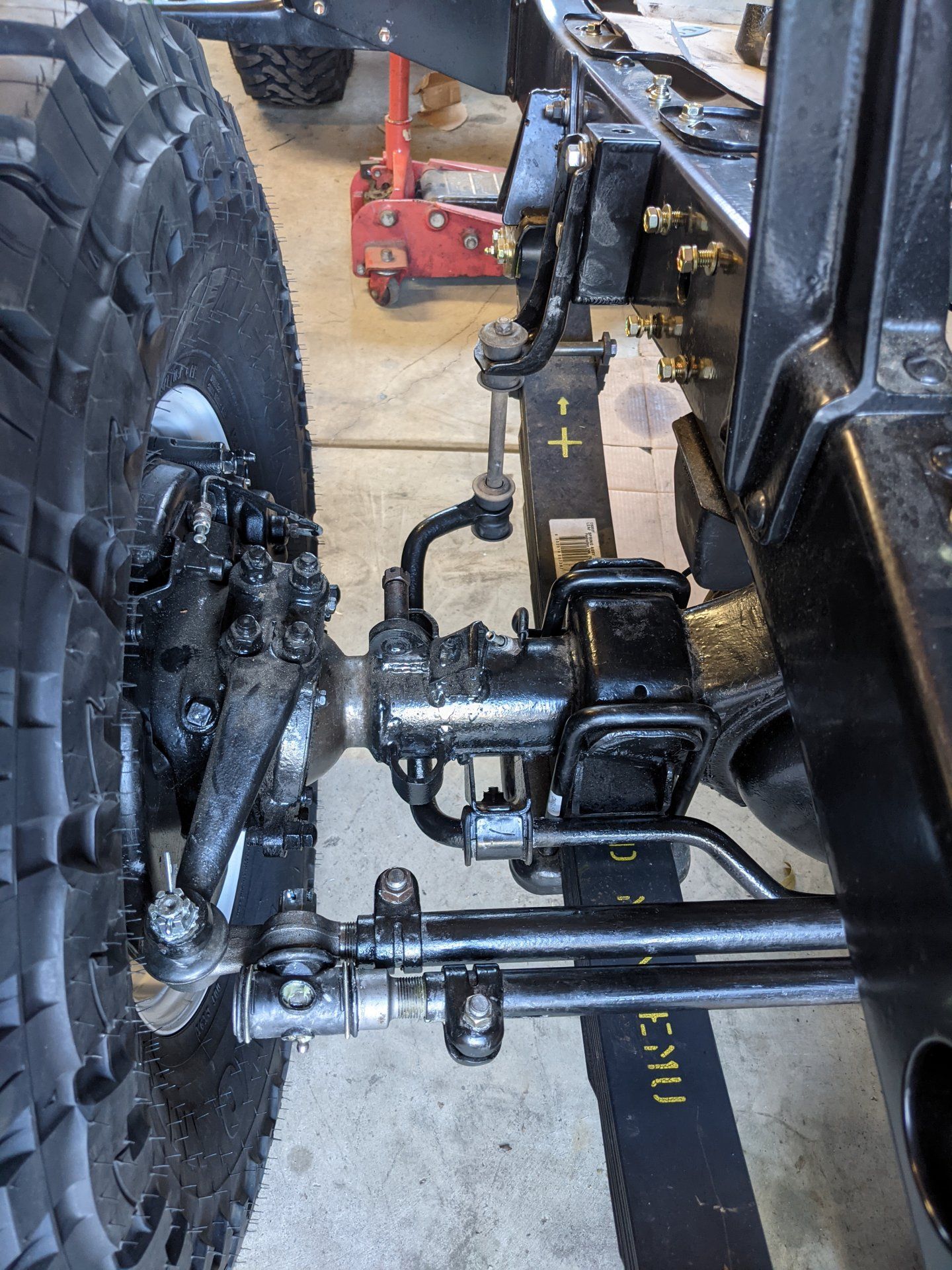

Axels have been reunited and are waiting for the frame and other bits to come back from the powder coater. Got the shock mounts on and bent the break line mount forward to clear where the shock will end up eventually.
Brought the the tub to work for a little rust extermination and paint touch-up. Probably going to paint the firewall the body color green and underbody with the POR 15 chassis black. The black is a little glossy but whatever hope to cover it in mud and dirt anyway.
Finished up with the tub paint.
Moving on with sticking the suspension and axels on the frame. Started with placing the front axle which was a good way to go because it makes the rear seem easy.

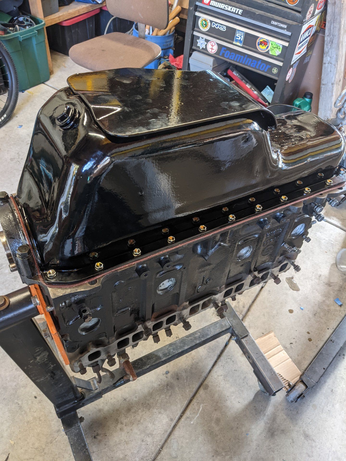

Also degreased sand blasted and painted the rough cast bell housing with POR 15 DTM. In my opinion these rough cast pieces is where their product really works well!
Engine is done for now, moving on to the tranny and split transfer case!
