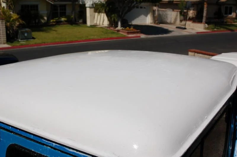

I started on the top of my 40 today. Hit it with the orbital sander to take of all the old wax and scuffed up the old paint. Gave it a quick hose down and wiped it with a towel. Next i gave it a tac-cloth wipe down. Mixed Rustoleum glossy white with 50% mineral spirits. First coat went on with bunch of bubbles. I blew on them and they popped. Second coat after waiting 5 hours. Now to let it sit over night. I'll be wet sanding it in the morning with 800 grit. The two more coats if time allows me. If this works out I'll be doing whole 40 if I can find a ACE that would color match my old paint.

I thought about the photo thing but.....I thought you seen one roll on job you seen them all. Did 2 more coats. Had to paint outside due to construction going on at the house. Paint bubbles didn't pop as easy and i was left with chicken skin. That didn't stop me I painted another coat 5 hours later. I'll let it dry overnight and give it another 800 wet sand.
This time I'll take pics for those who are dieing for paint porn.
This time I'm painting inside.....I had better control of the paint that way. But I think this thing might work! It's going to take some time and effort but the quality of finish depends on how much sanding and painting I want to do.

Here is a pic after 800 grit wet sanding after I washed it and wipped it down. I'll try to post more later. I didnt get anything done today.
