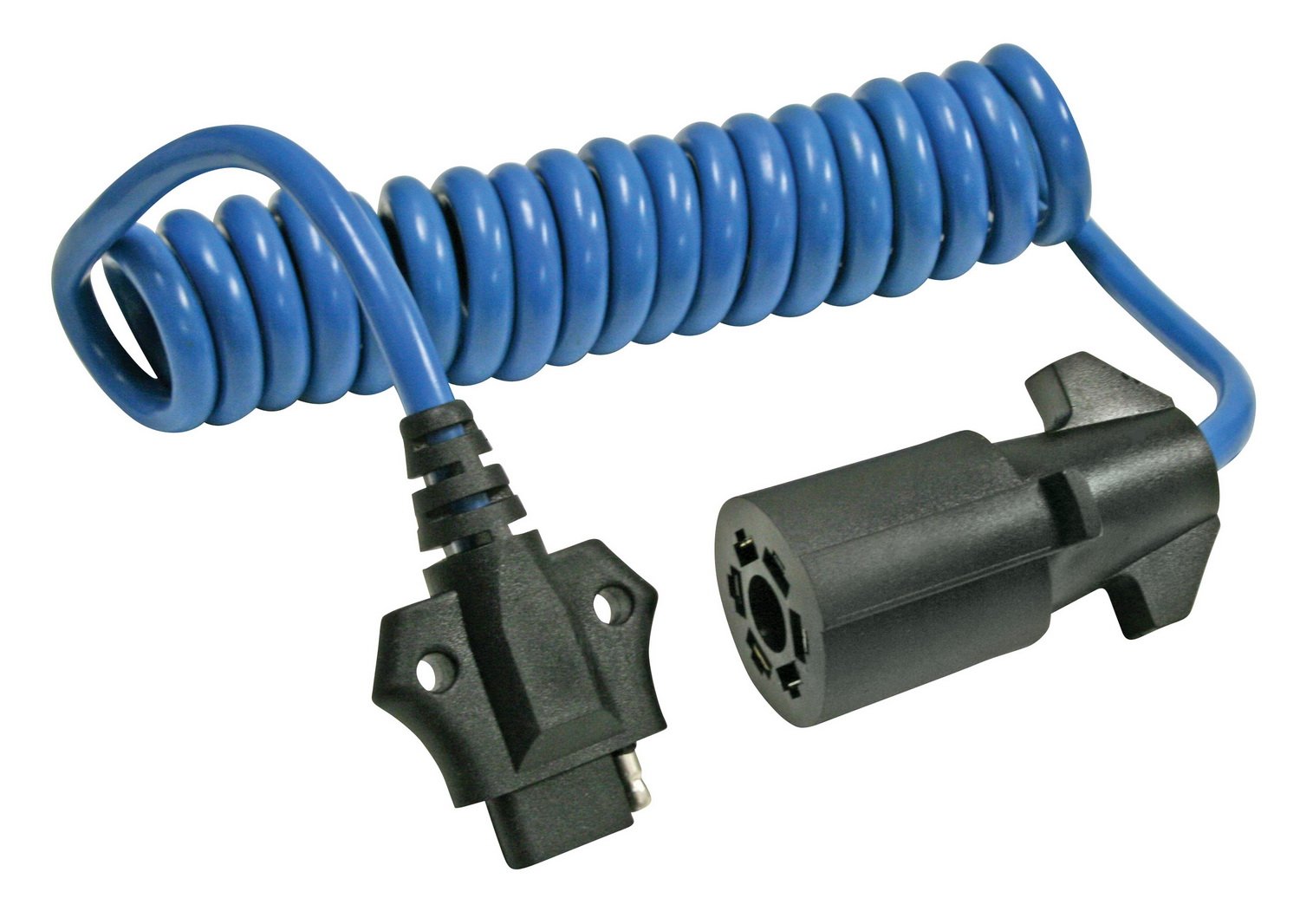

Finally, I wired a 3’ 7 way extension to run the lights. This goes with the 30” tounge extension.
FWIW I bought one of these to try out when flat towing the 4rnnr, extends to a max of 8 feet long:
https://www.amazon.com/gp/product/B0016KABGQ/?tag=ihco-20
Thanks, however I’m 7 pin on both ends and I had to make my own 7 pin extension using a pig tail and a socket.
It’s done and dusted. I’m on to plumbing and powering the water tank. Then brake pads on the land cruiser before a hectic week and packing for a 3 week, 5000k trip.
I believe they're made 7 X 7, but I am more interested in the self-coiling aspect. With the Falcon tow-bar the length of the assembly gets pretty long and I'm having to zip-tie the electrical cord to the tow-bar every time that I use it, and then cut it loose every time I disconnect. Haven't had much need, but when I do start to use the TrailBlazer more often I'll convert it to a replaceable electrical cord as well.
