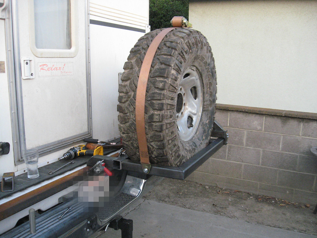

Why angled? Could it be stood up straight and pushed back against the fuel jugs? If it could I'd be inclined to repeat some of what I built here (which is a 315/75R16):
Ah!
Obviously it will increase the tongue weight. That's likely not a bad thing.
Laid down, well no particular reason I guess. I’ll play with straight up and see where a lower cage might mount on the front. I’ve got money in the strap and I would want to keep that. I would make a top support to keep the tire off the tanks.
