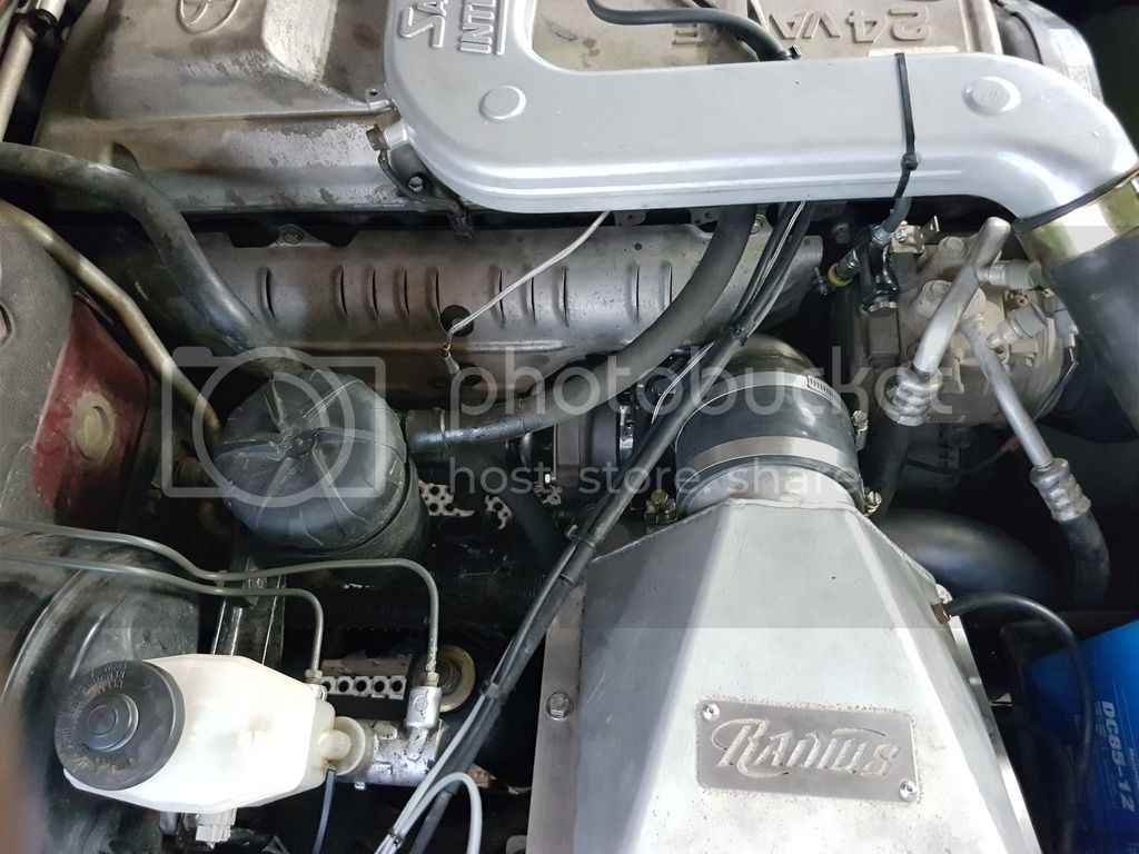

I am currently running a 4" in and out Radius airbox and snorkel, with a 4" elbow from the box down to a 4" to 3" reducing elbow onto the turbo. I then have a partial custom Safari intercooler with the stock cold side pipework and stock intake manifold. I'll see if I can get a pic.
