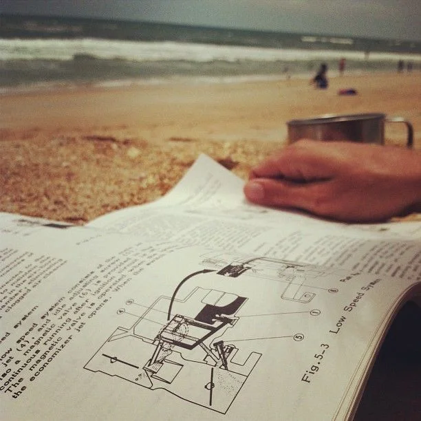

Found the problem:
I pulled the carb back off and found "sand-like" stuff in the float. Pulled and cleaned all jets. Since there was no response from the "idle mixture screw" the idle system must have been faulty. I tore the carb down and found the port going to that screw mostly covered by gasket.
It's running and idling MUCH better. I wasn't able to drive it yet but tomorrow I will scoot around town and see how it runs.
Ill also adjust the valves and timing... and hope it runs even better yet!

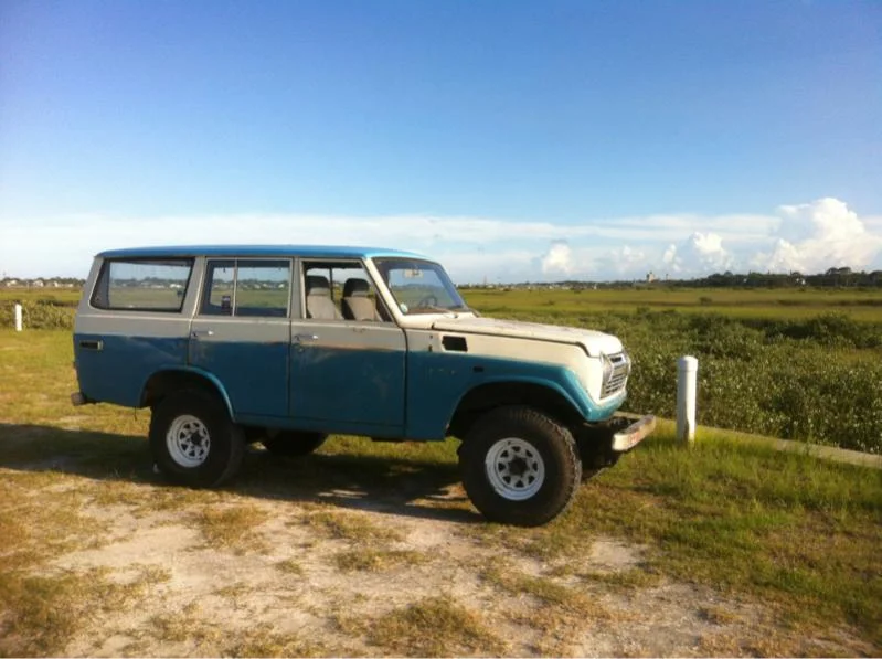

Put 50 miles on the pig today!
Was fun and scary. Felt like I was pushing my luck on dry rotted tires but I had a blast.
