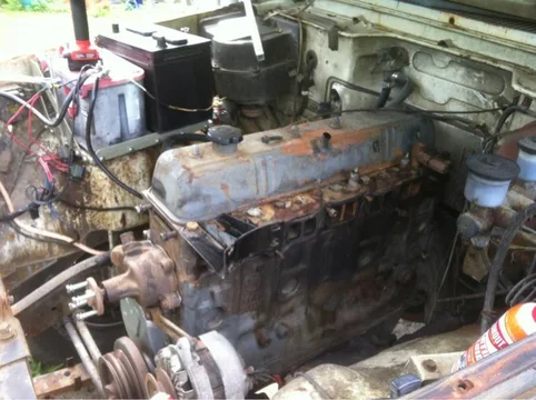

Some of the seals looked pretty bad, thermostat appeared clogged (it was), cleaning up all the gasket surfaces.
Hope to start bolting up the intake/exhaust/carb tomorrow. Maybe work on fixing the suspension from the accident.
Edit: man that cruiser looks rough...
