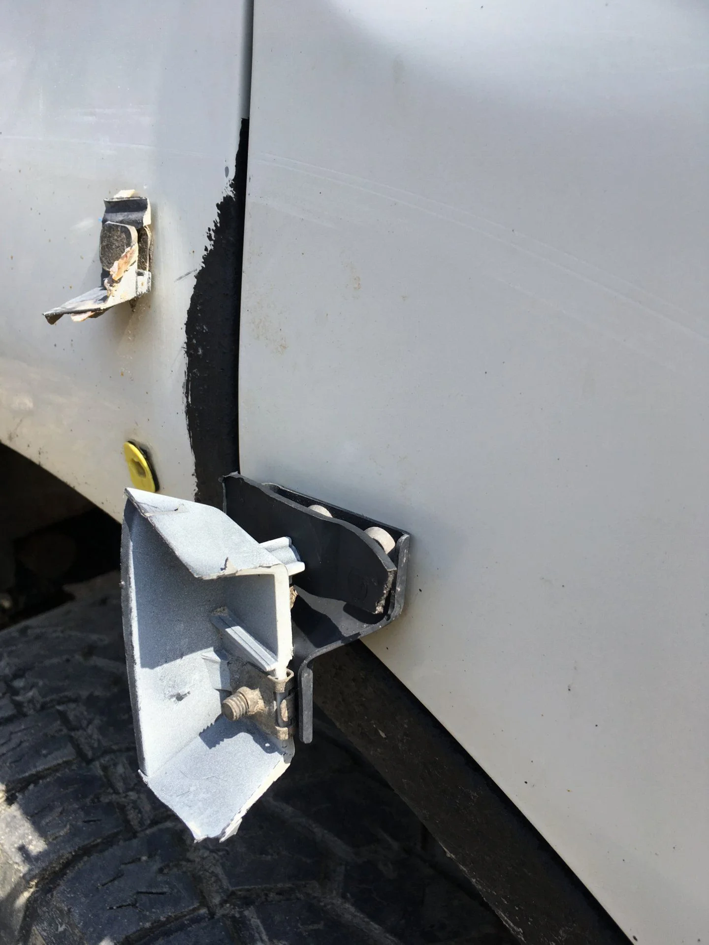

In any case, I will have a ton of questions the first of which is......how do I remove the plastic inserts where my flare used to be? Previous owners folly in the desert. I plan to rip off the other 3! I am also confused on how the part on the rear door comes off. I am guessing that the 2 rivets should be drilled out.
Yes the rivets will have to be drilled out. I filled the holes in the panels with large pop rivets and fender washers. This keeps the water out of the inside of your truck.

View attachment 1442173 In any case, I will have a ton of questions the first of which is......how do I remove the plastic inserts where my flare used to be? Previous owners folly in the desert. I plan to rip off the other 3! I am also confused on how the part on the rear door comes off. I am guessing that the 2 rivets should be drilled out.
Flares are worth money$$$!!! don't rip them off just un bolt. Front corner lenses an put arm down there an there 10 mm bolt heads there's rivet brackets that attach to door just in screw flare an drill 2 rivets a little drill bit is all you need. Olathe Toyota Lagrange Toyota google has on line parts diagrams for view gives you a brake down. An there Toyota tech info .com but u got pay that on line service manuals search web an u wil find a PDF for 80 series I bet. The 80 is the best. A classic cant tel u how to ride it. But don't trash it bro 95% parts are available an demand is high in all stages
