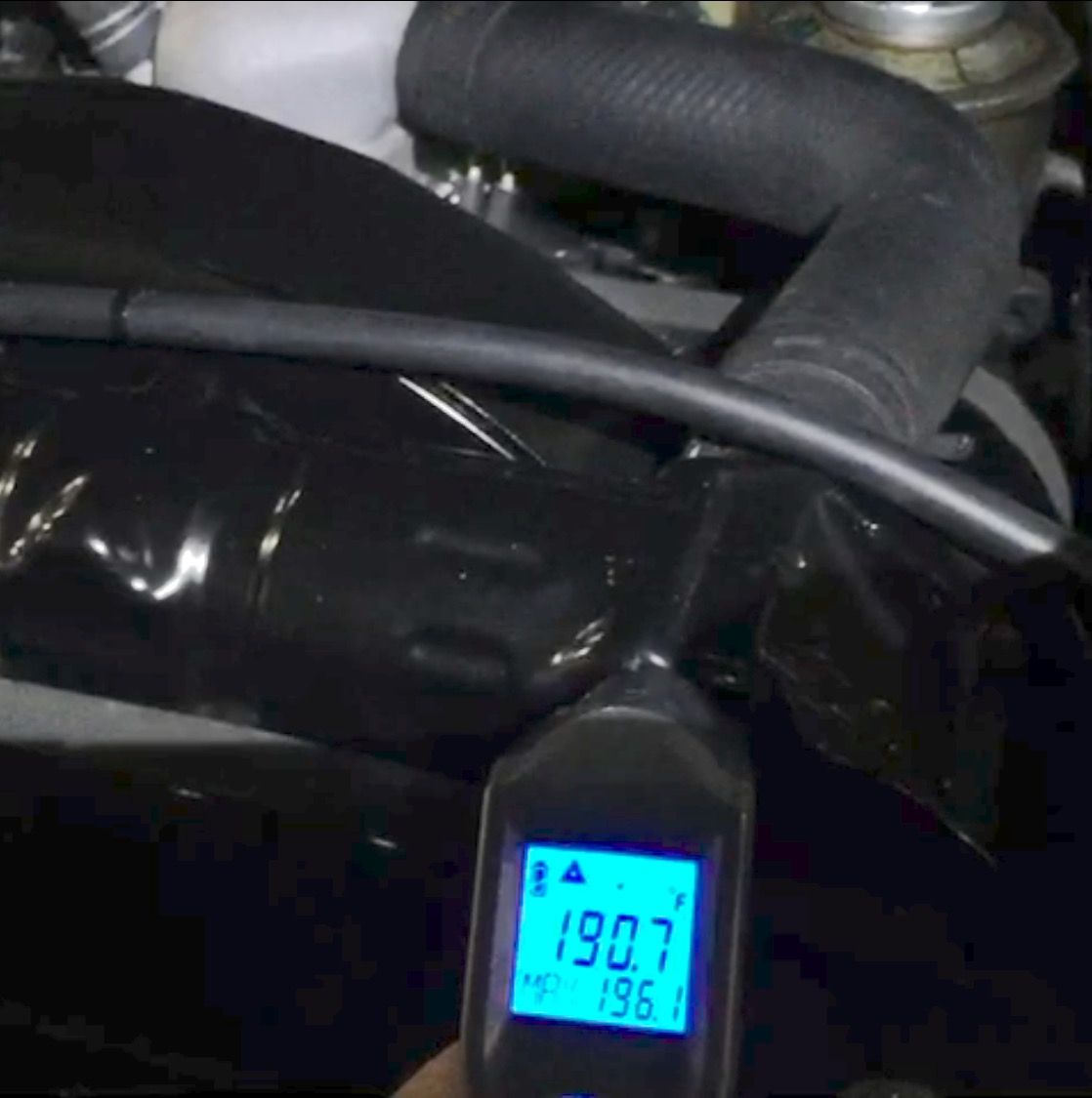

Point the ir temp gun at the outside top driver's side of the radiator, directly across from the inlet hose. As pictured below. The IR temp gun is influenced by reflective surfaces. The ideal surface is flat black in color and flat in shape.

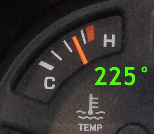

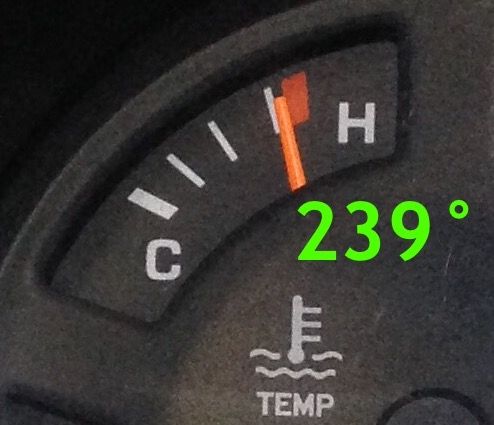

I have a FJ62 gauge installed in my 60. Same gauge as yours. It uses the exact same sender too. I just calibrated it against a new sender and this is what my needle position correlates to.
IR temp gun position:

@Output Shaft awesome, I appreciate your response! I put the IR gun on the radiator a few times as well and it was significantly cooler (180-190*). I'm going to try burping the coolant one more time and put the truck up on some ramps and use a coolant burping funnel and see if that helps out at all. There may be a bubble near the sender that's making it read hot.
