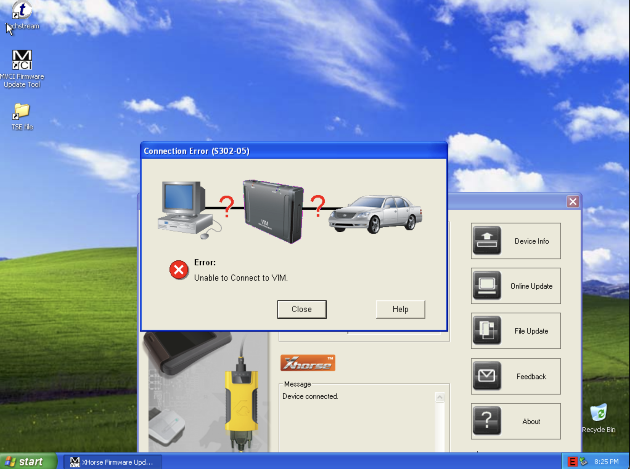

Am able to see the MiniVCI J2534 when running MVCI update tool (see screengrab) but when I try and run TS iI just get "unable to connect to VIM" error.

In your linked post, you mention "Second, I opened up my virtual box, and loaded up Techstream. At the top, select "Setup" > "VIM Select" > XXXX (whatever model cable you have)". How do you do that? When launching the VM, if I launch Techstream, it will only show me the loading screen, and then the VIM error screen (as OP). So no way to go into the settings.

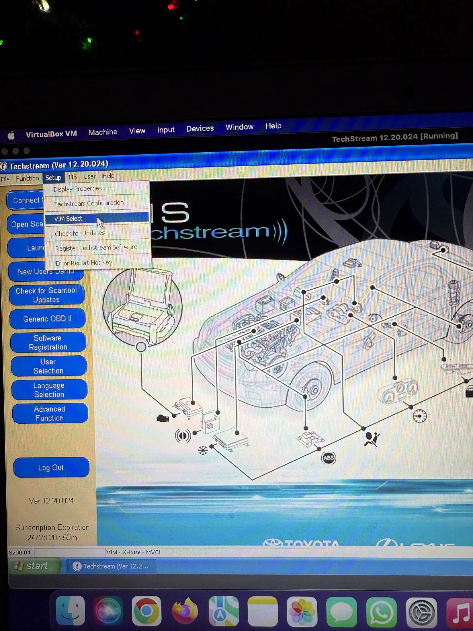

When you launch the virtual box and the Windows OS loads, launch "Techstream" from the dekstop.

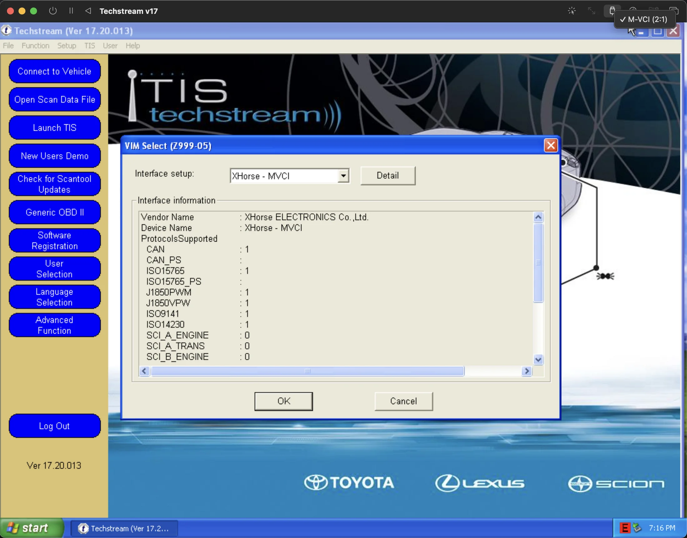

You should see the techstream main menu as shown in the photo below. You would only be getting the "VIM Error" when you try clicking the "Connect to Vehicle" option without configuring properly.
I was able to figure out how to launch Techstream manually from a previous reply (C:\Program Files\Toyota Diagnostics\Toyota Diagnostics\Teachstream\bin > select main menu > fill in required dealer and dealer code (I put random 123) > cancel registration pop up > Setup > select VIM (cable).).
I can only see 2 options. Tried with both but still getting the same VIM issue. You can see that the cable is detected by the VM on the screenshot.

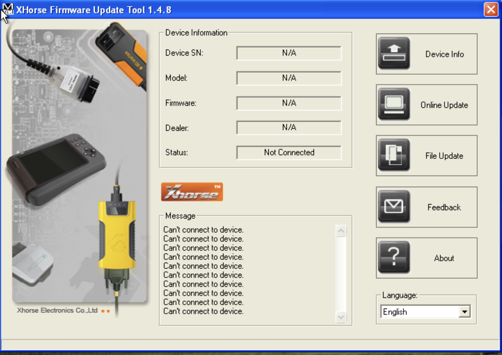

On another note, the XHorse Firmware update tool does not detects anything. Even if my cable is not from XHorse, should it be detected?
I had this same problem using a usb a -> usb c adapter plugged into an M1 air. I never even got a installing new hardware in windows xp when it was plugged in.

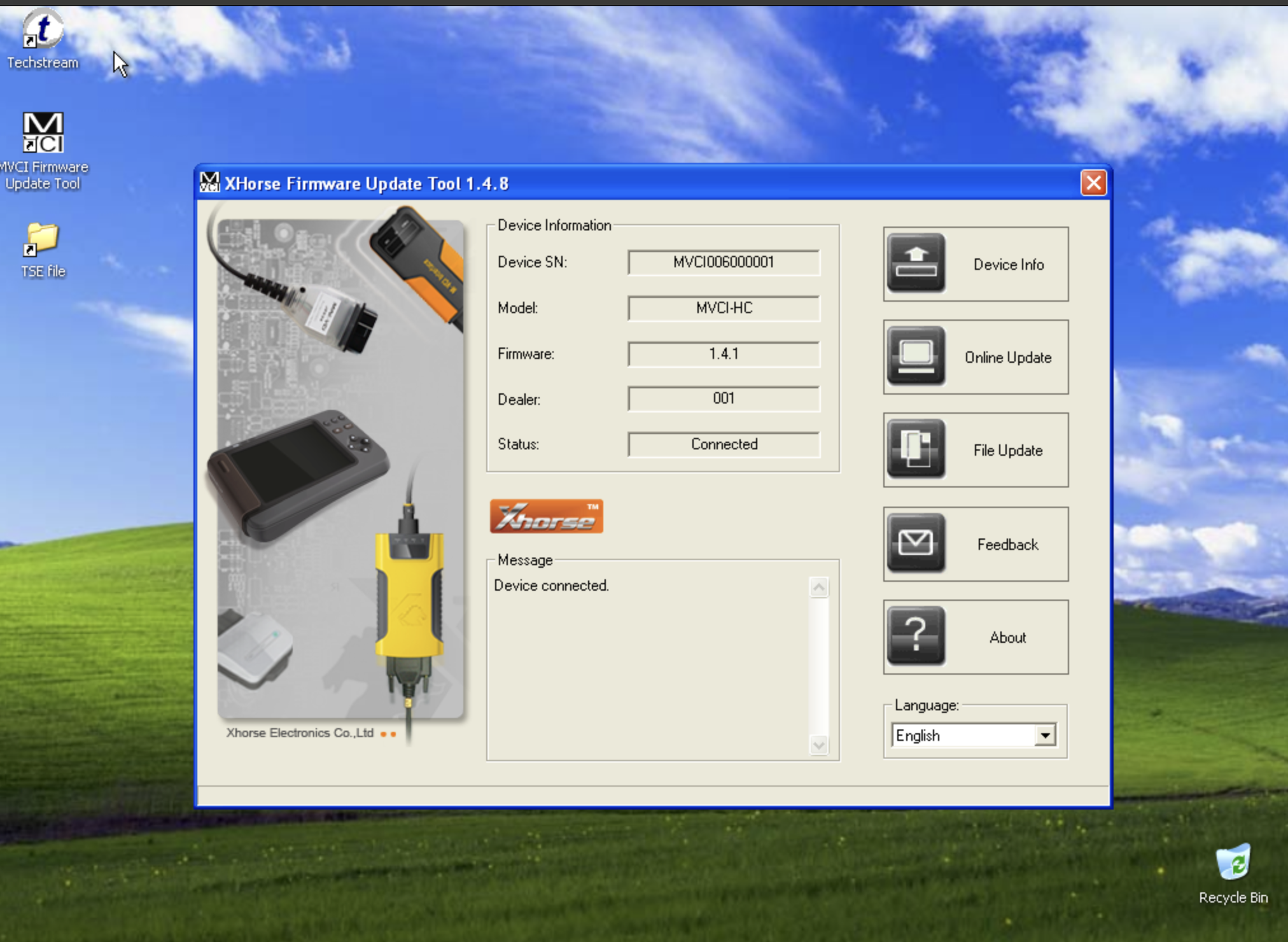

Once I switched to a usbc hub with a few usb a ports and plugged the cable into that, I got a popup in the bottom right of windows xp saying new hardware was found and installed. Then I got the device identified in the firmware update tool "Device Info" results. Then I opened Techstream via Start -> Techstream Diagnostics -> Techstream (selected region, completed fake repairer info, hit cancel when prompted for key) hit the top Setup button, hit VIM Select, changed the first dropdown to XHorse MVCI, closed techstream, opened techstream via desktop shortcut, connected to car.
I think if you have the firmware update utility failing to identify the cable you should stop and work on checking connectivity to the VM (or maybe drivers, but the drivers in the image from the 5min post worked right away for me).

I had the same connecting issue. This is what I tested and found:
  • Tested the OBDII port on my car w/ my scanner to make sure it is working.
  • With VirtualBox and Techstream already installed and running, make sure to plug in your mini-VCI cable to the USB-A port of your Mac. This step will add a new name to the USB logo on the menu bar on the bottom (Win XP desktop).
  • Choose the new usb name added (your new USB hardware). This will prompt your Windows to install new hardware so that your cable is ready to go.
  • Now connect your cable to the OBDII port of your car and it should work.
