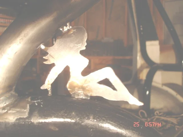

How about some nekkid lady gussets? These are easy to make :grinpimp: I've also seen chubby chick gussets, but that ain't my style.......

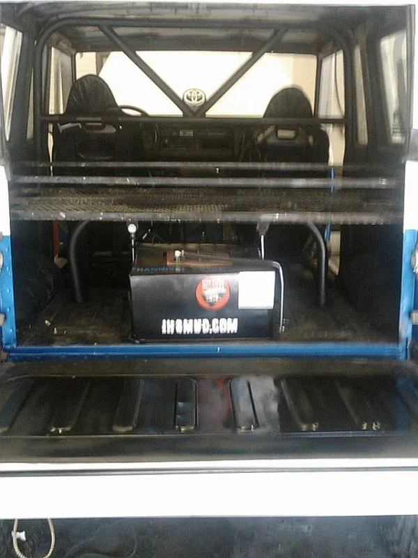

fuel cell is in, plumbed and cover/hold down made, powder coated and stickered.
Inner cage is in. Still have to make supports for it. I'm trying to decide if they are going forward or back.

The inner cage supports went back and support a rack made from a roof rack I got somewhere. The rack will allow me to have flat storage above the shocks and fuel cell and have a shelf that I can reach easily with the tail gate up for stuff like straps, tree saver and shackles. I can also put the spare on it for the few times I might carry one.

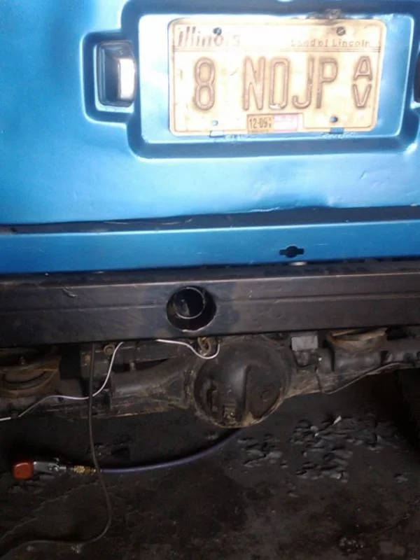

We also finished the exhaust. It took a lot of looking at it before I came up with a compromise solution. I really didn't want a rear exit because the exhaust comes up through the rear window at higher speeds. OTOH this rig never sees higher speed. I have no room in the wheel wells. I was looking at under the bumper on the sides or out the back.
We ended up cutting a hole in the bumper and sleeving it, then running the exhaust not quite to the end. I didn't want the end of the exhaust being thigh high when I lean in to get something.

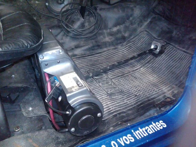

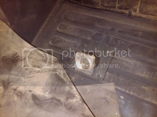

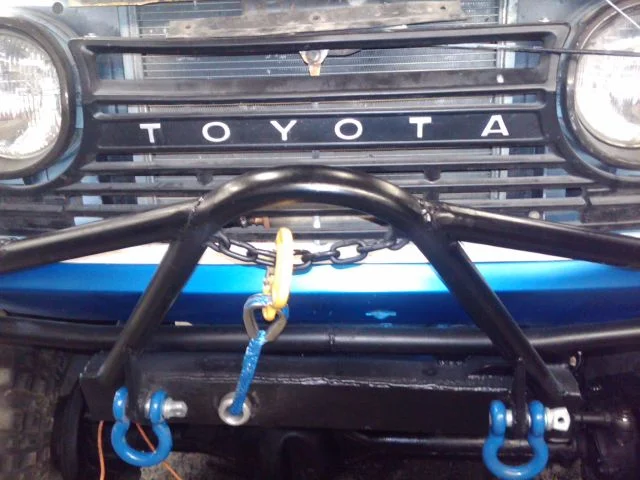

About 100 pages ago i talked about putting the winch inside the truck, under the passenger's knees. It was a bunch more work, but I think it'll be worth it. The winch rope is guided from the passenger footboard to the bumper through a tube. Of course, the rope wouldn't last long without fairleads on both ends. A 2" round fairlead is not something Warn carries so I made a pair out of 2" square stock.
The outer end is almost 2" in diameter. The other end is 1.5" to fit into a 1.75 x.125 tube. I tapped the tube and end for 2 3/8 set screws to hole the end to the tube. I drilled a 1" hole through the center and polished it smooth. The hole is also rounded over at both ends.
I drilled a 1.75 hole through the front bumper (3/8 plate) and through both layers of front crossmember. Then I welded the 1.75 inside and out and to the 1.5" tube that will route the rope to the passenger compartment.
The other end I left the outside edge square thinking I would bolt through it. It is set into a 1.75 tube as well that is welded to a 1/4" plate. Drilling the hole through the plate at that angle was not a lot of fun. There is another plate on the outside as well with (4) 3/8 bolts sandwiching the floor. The pic is before I drilled the holes in the floor and put the bolts in and before I welded the tube to the plate. The 1.75 tube goes through the floor to the 1.5" routing tube.
No pics of the winch yet. tomorrow, I promise. I had some issues with the winch not working when I hooked it up to spool in the rope. I ended up leaving it in a big messy pile on the floor of the truck. I think I've got it fingered out though.
The mount is a class IV receiver welded and gusseted to the frame. A 3/8" plate is welded to a hitch tube to hold the winch.

I spent almost all day chasing parts and fixing the damn winch. I got it all installed, it pulled about three wraps with no load and stopped pulling. I pulled it all apart and found the stage 1 planetary gear set had a gear that was supposed to be attached to the planet carrier and was just spinning. A couple of tack welds and a whole lot of time getting 3 sets of planetary gears lined up right and it's back in the truck.

The winch under the seat worked great. Because of the hubs it needed it a few times. The last time it broke again. Something inside this time.I'll take it apart this week.
