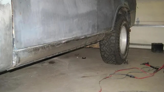

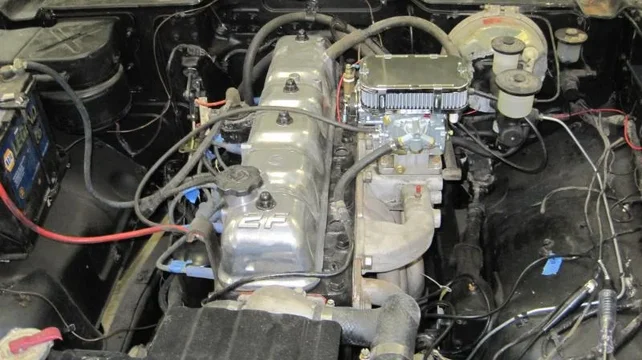

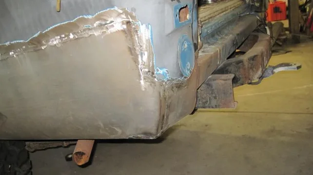

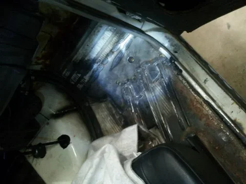

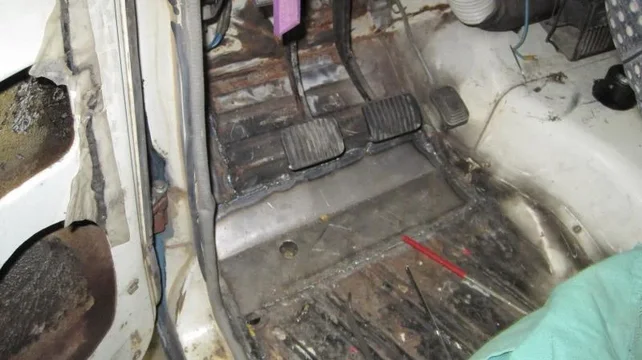

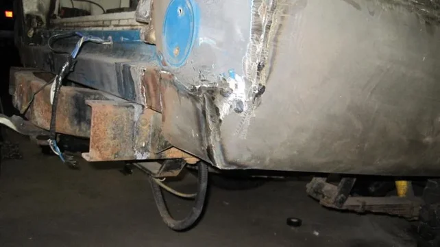

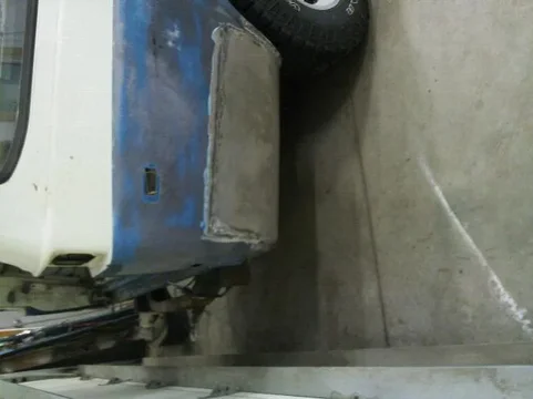

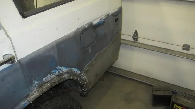

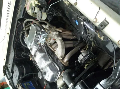

I bought this with a locked up motor. I then purchased a 2f with a 4spd, with the newer style transfer case. I pulled the cam and sent it for a KC delta cam grind and bought a weber 38 for it. Notes on doing that include needing a new ebrake cable, and new drivshafts, longer in front and shorter in rear, use the F waterpump, make sure to relocate the clutch fork and slave to the passenger side before install, it won't clear the floor on the driver side. Then I cut the bad front fenders and made patches, cut the rockers out and made new rockers, cut out the front body mounts and inserted a piece of box tubing and made new mounts and floor, cut open the rear 1/4s and drove a piece of box tubing across the rear from side to side, made new mounts, made new 1/4s and welded in. I went to repin the front door hinges and found the mounting points on both front doors cracked and blown, so I cut those and welded in new mounting points. I beat out the front of the front fenders and am ready to try to coat those. Beat out the roof, still need to do more and reinstall the gate, that spring assist is trouble by yourself. I have a 4' piece of steel welded to the hinge and I still am going to need help. I am a bit discouraged, as everything I touch seems to need a lot of work.

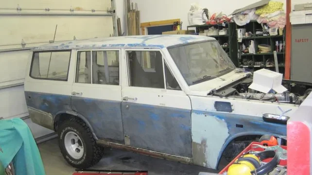

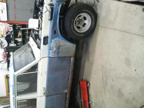

I just wanted to post some more pictures. I know seeing others work and progress is the reason to visit ih8mudd. Thanks for the encouragement!

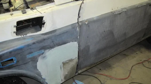

I went up and down the driveway tonight. I have a pretty long and steep driveway and the KC grind seems to make quite a bit of power. I haven't driven a landcruiser in about 15 years when I did a fj40 with 33's, so it is hard to compare. I am going to keep the heat on this project. I am on my 4th coat of filler, hopefully 2 or 3 more and I can prime.
