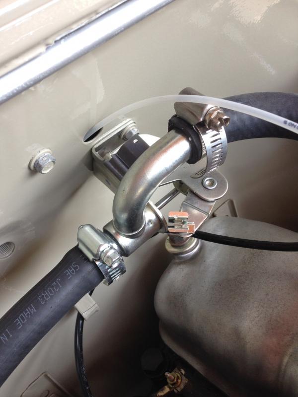

As far as the heater control valve and push/pull cable, I ordered these parts from SOR. Part # 186-10E is the after market control valve which mounts on the fire wall and part #186-08A-A which is the push/pull cable and knob. Today I'll find out if they fit together. The SOR website seems to indicate the cable works with the valve designed for the 40 series and the valve I have is specifically noted as for the HJ47. I'll post up the finished result once I attempt the install. As HJ the 47th states, the end of the cable may not match the valves connection point. At least not without modification.
The pics show how much longer the new cable is compared to the original, but I don't know how much was cut off the original. It is much longer, which is a concern. If the cable is the right length, it looks like I can attach it by drilling small holes in the receiver part and placing a pivot pin of some sort.
Yes, the end of the cable was not meant for the control valve I got. The control valve is correct, but as you well know (Henry James) the correct push/pull cable for the 47 isn't available.
So, I drilled small holes thru the piece that receives the cable on the control valve arm. I shortened the sheath of my new (too long) cable to the correct length. I used 2 cable stops on each side of the new control valve's swivel piece. The cable passes thru this piece and the cable stops are on each side to hold it tight. Then I shortened the cable to the correct length. On pic # 2, you see the cable passes thru the receiver, but not the way it actually goes thru it in the end pic. The receiver actually gets clocked 90 % so that the holes I drilled allow the cable to pass thru it.
It may not be the most elegant solution, but it seems to work. If I had a TIG welder, I would have done something different, but this fix is reversible and if someone comes up with a better solution, I'll modify it. But for now, I'm calling it done.
