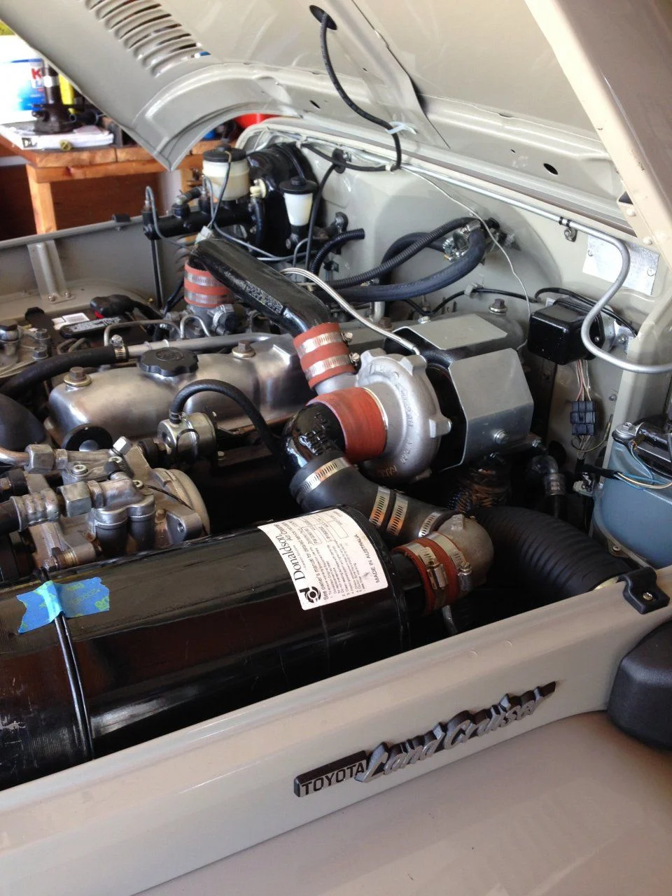

I'll get one from NAPA which is down the street from me here. But, I took the VR off and opened it up for a look see. I saw in the Service manual they mentioned adjusting the voltage regulator adjusting arms. So, I looked at the arms and one was way out of alignment compared to the other. So, I simply made them both make connection at roughly the same point. One was in a position where it was closed at all times. The end result was, no more clicking sound and the fuel warning lamp is not blinking any more. I don't know now if my fuel was bad, but after being stored for three years I'll mix it in with new fuel over several tank fills. I did begin the reinstall of the air cleaner and snorkel. The air cleaner is a Donaldson unit from Australia, which is very industrial like. It fits with about 1/16 inch clearance between the A/C compressor and side wall.
