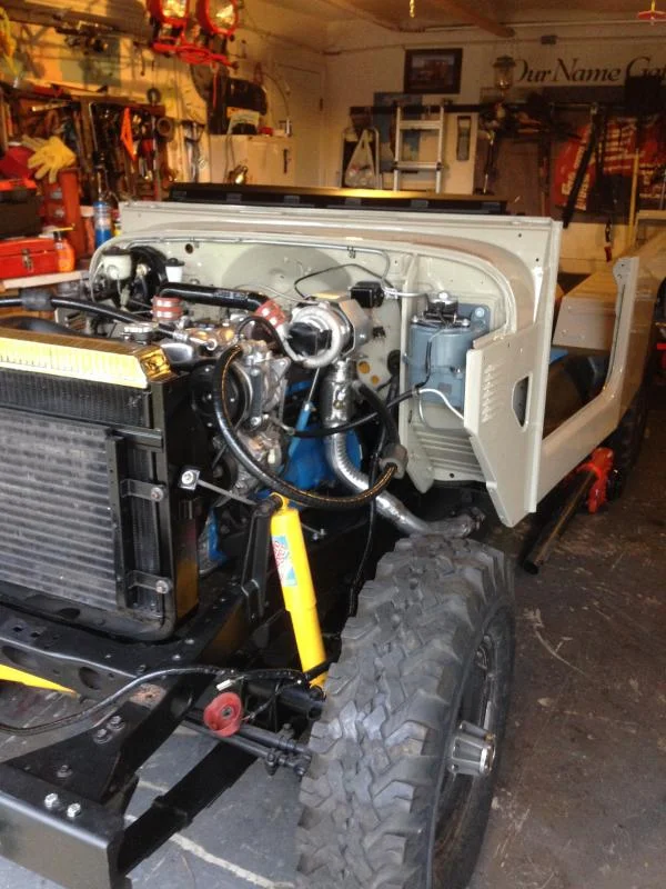

I installed the pyrometer and boost gauges into the dash and am close to wiring everything up. I just need the surround piece for the speedo gauge cluster back from the painter. My rattle can paint job on it got scratched, so the pro's are re-painting it. The stock look on the dash is gone, but I gave up on the idea of keeping it original when I put the turbo in.

I pulled the wiring loom thru the fire wall on both sides and now I'm doing a dry run (so to speak) to see if I actually know where everything goes. 90% of the wires are labeled. I have no idea why 10% aren't, but I think if the wires are routed correctly, the unlabeled ends will find their mates. I've already run the wiring from the rear of the truck, so the front, where all the important stuff is, is all that's left. It looks like all the stuff under the dash will be the more difficult part, but I'm not afraid of asking for some pointers when I get stumped. The challenge will be running all those wires in the engine area and making it look neat and tidy. I Don't have a clue yet how I'll accomplish that, but thanks to this site someone can probably help!
I got the speedo cable in, the wiring to the starter relay, the glow plug relay, the brake sensor, windshield wiper switch...and pretty much everything in the dash except the speedo, ignition, heat and A/C. I'm deleting the cigarette lighter and will put something in it's place yet to be determined. Next up is the steering wheel, A/C and heater box.

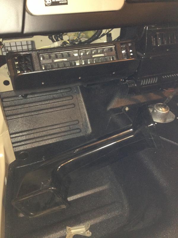

I mounted the A/C controller in the radio's former position. It looked crappy mounted under the dash. Then I got the heater unit, the glove box door (which took me 2 hours to find) and the speedo installed. I'm struggling to get the steering wheel in. After bolting the flange on I now notice that it needs to be clocked 90 degrees. It's five O'clock; time for a beer:cheers:

A/C is installed after several hours of cursing. The heater box had to come out first, and then be re-installed. And yes the steering wheel was re-installed correctly.

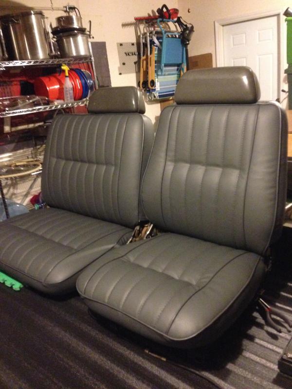

My seats came back from the upholsterer shop. The seat kit I used was ordered from Spector Off Road and the guys at my shop who installed the kit were very impressed with the quality. I'm very happy with the end result and one of the reasons is these kits make the metal seatbacks unnecessary. Maybe the U.S. versions didn't have the metal backs to the front seats, I don't know, but as you can see, these are upholstered in the back. My metal seat backs were dented and scratched, so having them fixed and painted was an issue. It's money saved. The shop that installed this kit said they were very surprised by the quality. I guess people bring seat kits there pretty often and they suck. Cheers to Spector Off Road and my Condolences go out to the Spector family!
Here's a fun fact. You can't install the heater duct if the A/C unit is already in. I'll get some more practice removing and re-installing that air conditioner. Good times!

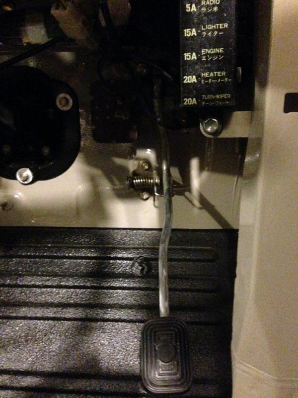

I did manage to get the throttle assembly in and it looks like I'll have to take the speedo back off to get the brake pedal in. That son of a gun has it's pivot point way up in the dash. I can't see how to get it in without taking the speedometer back out. If any body has a trick for that install, I'm all ears.

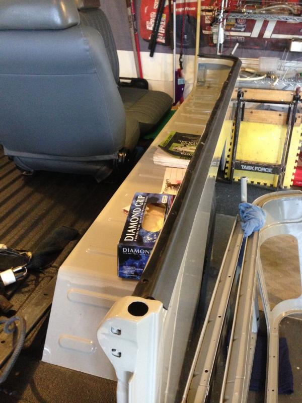

The body side panels came back from the paint shop. The guys at Chromefish customs did a great job, again! I got the new side panel gaskets from SOR today as well, so the side panels went on. The only issue was part of one side of the gasket at the back would not stay in place completely, so after several attempts I just cut the piece off that was showing on the outside.
The brake and clutch pedals are installed as well. The speedo gauge did have to come out to install the brake pedal. I guess looking at the service manual first would have saved me some time and effort.
