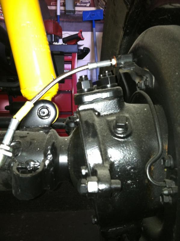

Yes, it's looking like I need another 1/2 inch of length on that line. I may just bend the tab that secures it to give it a little slack. I jacked the front up and moved the tires in both directions and the line doesn't get stretched any more than it shows here, but I'll do something to give it some slack.
I adjusted the brake line mounting tab (with a hammer) and that seems to have been enough to relieve the tension on that flex brake line.

I'm pretty sure that is the petrol return line-not used in the diesel.

Josh, do you perhaps have a pic showing Lexie's OEM setup in this regard ? It seems the setup in Olive has been wrong all along - probably caused by the Aussie Longranger tank setup.Having gone to EFI, I need to change my setup to be non diesel but I am finding it difficult to get reliable info ??

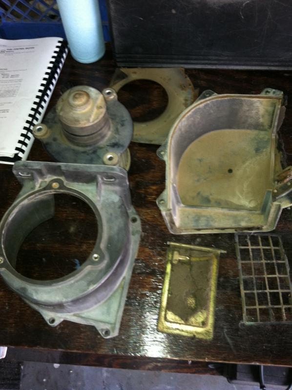

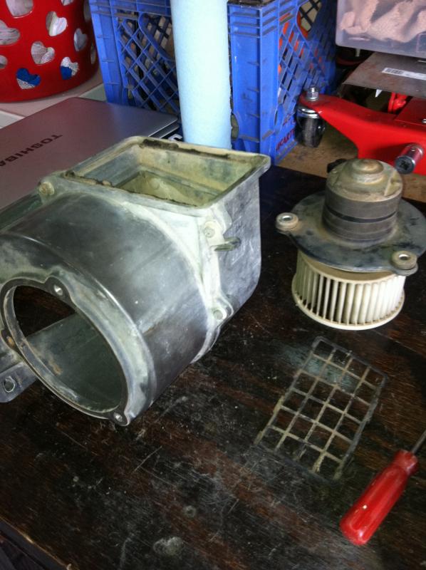

I started cleaning up the blower motor and ordered the restoration kit from SOR. All it is is the foam seals, which are totally gone.
I got some feedback from Dave Stedman (Toyota 4X4) and he's working on the centrifugal oil seal and a few other hard to find Toyota diesel parts for me. So, while I'm waiting for the blower seal kit from SOR, I cleaned and painted the blower assembly. I primed the plastic housing with a plastic primer, then painted it with a high temp grey paint. It looks somewhat like the original plastic grey, but not totally original. I'm OK with the difference. After painting every other metal part of this particular assembly, I think it'll look nice. We can always start over...Not!
Dave Steadman from Japan4X4 is getting me that O-ring for the centrifugal filter and he's getting me a new radiator overflow/washer fluid tank. So thanks Hanry James the 47th for the tip.
I got the foam sealing kit in, so the blower got installed.

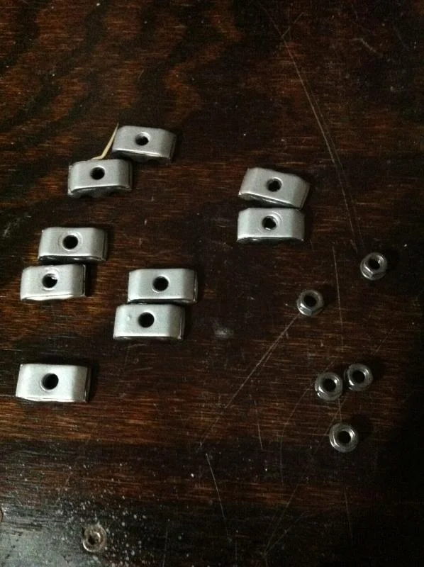

Forgot about these little fuel injection line brackets. You can't get the bottom half on if the lines are already installed, Duh!
Looks like I get to take the lines off,,,,again.
