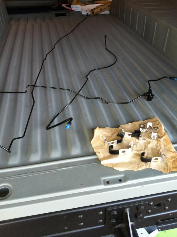

Meanwhile, I got the brake lines cleaned up and painted as well as the hangers.

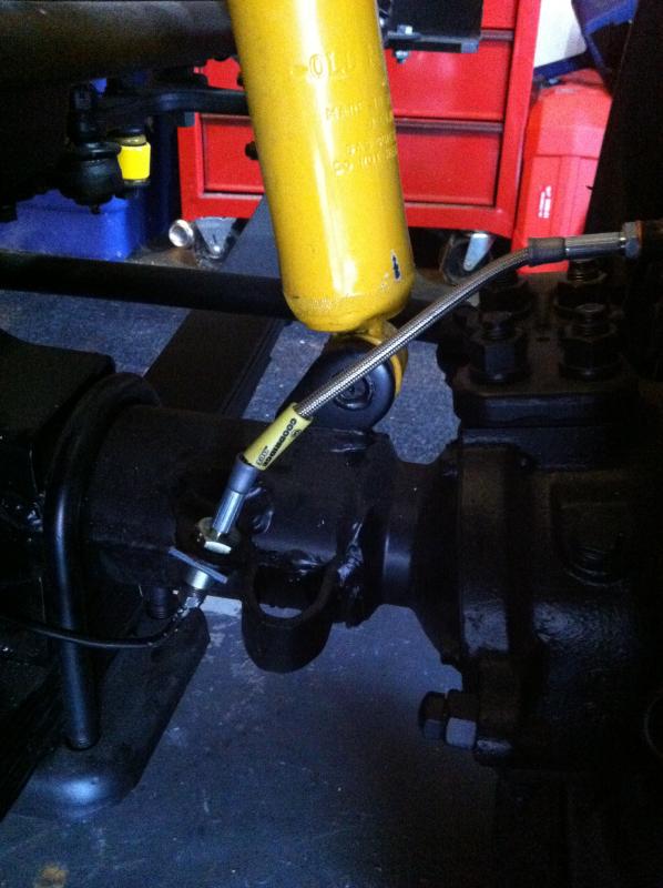

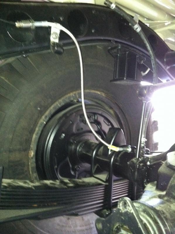

Thanks guys. Moving forward, I'm adding some stainless braided brake lines on the truck since the original soft lines are dry rotted and I also realize I'm missing two sections of the brake line. One piece is the rear short section of soft line, and the other is the front connection piece that was a hard piece. I probably can get the front hard piece from S.O.R., the other rear section I replaced with a stainless braided hose from Spector. The front piece is a male to male section, so I'll see where and if it's available.
Stainless brake lines.... Grrrrr. Be still my heart.
I couldn't find the last piece of hard brake line that connected the front proportioning valve to the front section, so I got a section of brake line from the auto parts store and made this piece by hand.
Good call on the stainless lines. It made a huge difference on my rig. Much less brake pedal travel, a more positive feel and faster brake reaction. I took the old rubber ones off and gave them to a line shop and they made me new stainless lines in a few hours. Make sure to bleed them again after driving as you will likely get a few more air bubbles out and that just makes the brakes awesome.
