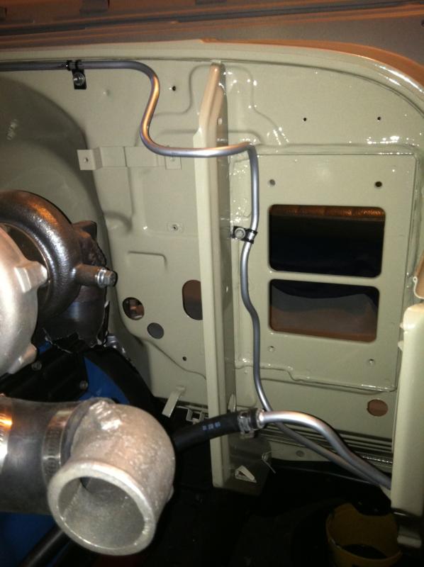

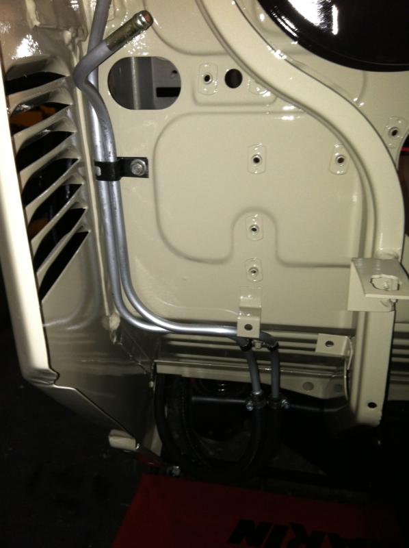

I'm thinking the next install will be the brake booster assembly. I think I have the hard vacuum line routed correctly, but I'm still not sure until I get the brake booster cleaned up and bolted on. Then we'll see if everything connects.

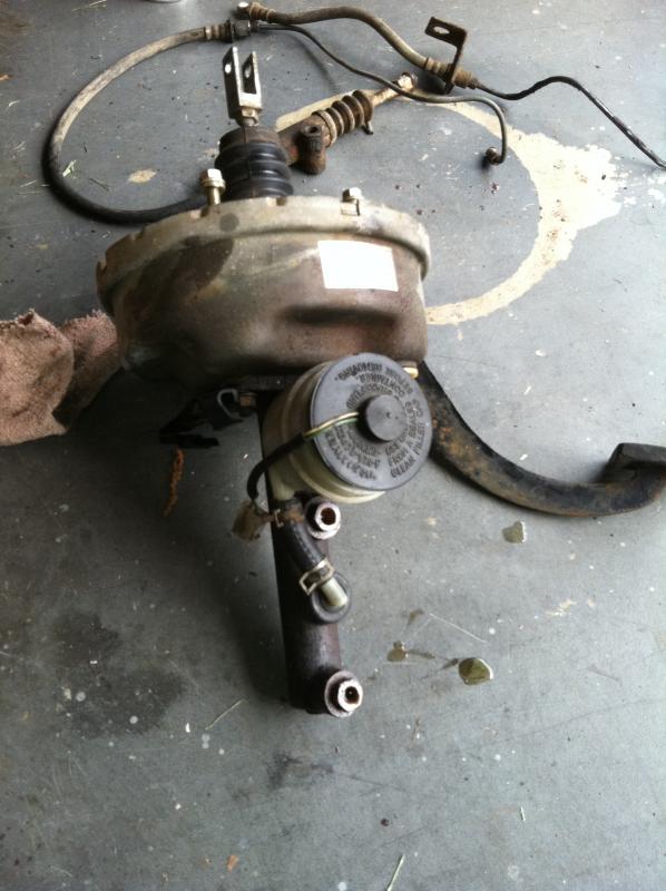

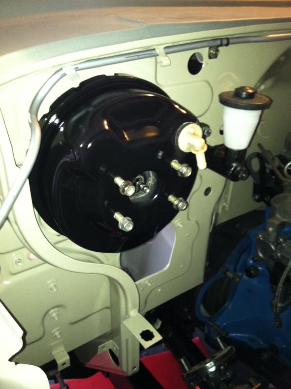

I got the Brake booster and master cylinder apart today. There was an obvious leak there before which corroded the fire wall beyond belief. I didn't notice an active leak when I had it on the road, but I did have to add fluid once, so it may have still leaked, although I did replace a wheel cylinder so I'm not sure if it still leaked or not. So now after the new paint, I definitely don't want any leaks again. The big question is do I get a $130 brake master cylinder rebuild kit from SOR or do I get a new master cylinder (possibly rebuilt)from RooDogs (AU)? The one they show on Ebay is $185 plus shipping. It doesn't look like its OEM, so I don't know if it's worth the $200 + dollars to get it. I've ordered from RooDogs before and have been satisfied with the quality. It takes a while to get here of course. In the meantime I cleaned the booster unit and painted it non-original black; I'm beyond staying original at this point.
You can still get it new from Toyota for about $250 from cruiser Dan. LHD and RHD are the same do not do after market and if my experience holds true for others, only rebuild it if you're happy to do it again in a year or two.
I PM'd Cruiser Dan; he's out of town with a family matter right now, so I'll wait to here from him on the master cylinder and slave cylinder. The guys at RooDogs have emailed me back and will let me know shipping costs from AU. I'm sure Cruiser Dan is the way to go on these parts. Some of this stuff I think you can only get from down under or maybe Canada, but as you guys pointed out, these particular items can be had from Dan. That's why I'm here; for the help.
I mounted the brake booster and clutch master cylinder to the fire wall today. It took longer to find the right bolts than to install the actual parts, but that gave me time to get 9 holes in at my local golf course.:beer:

After looking at some older pics, I realize it was the clutch master cylinder that was leaking. I've already replaced that part, so now I'm thinking I'll just clean up the master cylinder and re-install it. I think the $200 I save can be used on the numerous other parts I still have to buy.

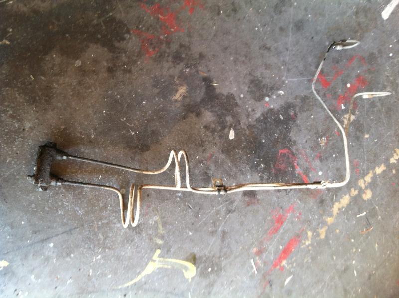

I found the illusive missing second hard pipe for the brake booster, so I cleaned and painted it, now it's mounted (hopefully correctly).
Even better and guaranteed to fit.
Cruiser Dan called me back and was not sure if the brake booster and clutch slave cylinders were the same on RHD vs LHD. He said to get the part numbers and he would let me know. At this point, I cleaned up both parts and will re-install them. If they worked before they should work now. I took the reservoir apart; it was gunked up pretty bad. So it's super clean now and the body is in black engine paint.

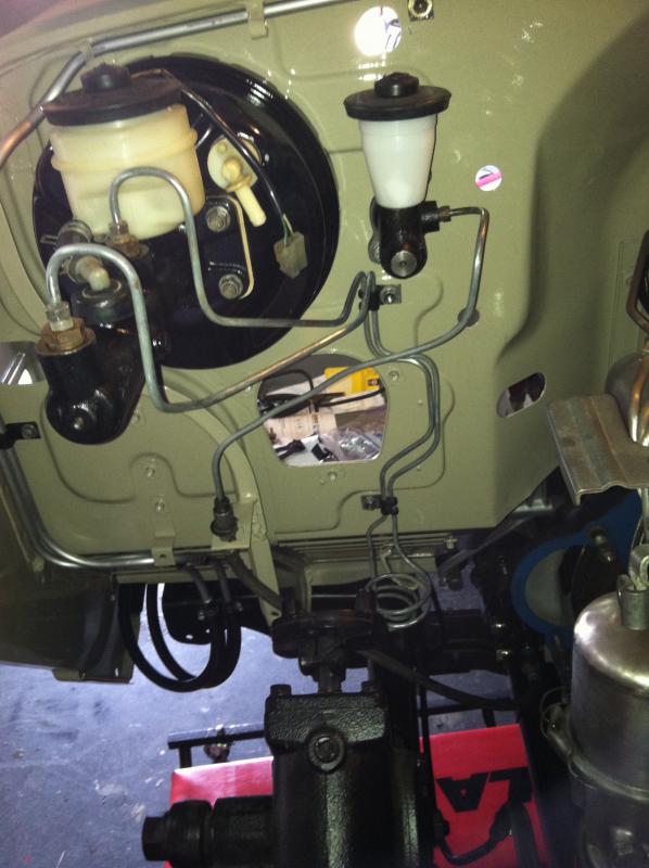

Brake master and first hydraulic lines are in. I'm going to run it and hope she doesn't leak, otherwise it's probably a overseas order to replace. No big deal, just a wait. I cleaned the 32 years of grime off first. I think it'll be fine, but I'll know for sure when I get the rest of the hydraulic lines run and add the fluid and pressure.
She's lookin good
Man she's lookin good! I fantasize about my troopy looking that sweet. I can't say it out loud or my troopy would %#^& me up.
