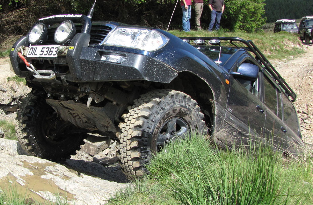

The BL is pretty much needed to run these 36's, 2.5" ish suspension lift, 1.5" BL, 36 x 12.5 x 16 Simex ETII's, no wheel spacers, just don't go full lock unless I really needed it :)

Ya, go up this with that 14-inch lift! See what happens.
What an awesome pic John! Can you tell us more about this obstacle? Where were you, etc?
You're my hero!
:cheers:
there's a non-14" lifted Landcruiser blocking the way!
Just out your huge tires and unfunctioning mega lift to crawl right over the other Cruiser if you've got 14" of "lift" ;p
thanks Peter, that's an old picture, 35's just look so small I thought I'd roll out the 36 pictures :D
