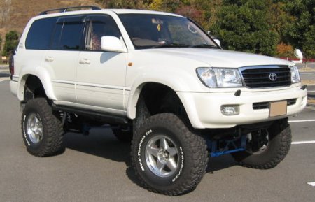

I've seen some IFS 100 that look decently tall online
You can run 35's on stock suspension. You will have a rather full wheel well. They may rub in the back and on the frame in the front.
The 100 is limited to 2.5" of lift and a 12mm body lift with 35's. That is the most extreme you can go with tires and lift

im running 35's with 3" lift in the back and cranked up Tbars to about 2.5" with proper droop, no spacers or body lift.
i picked the thinest 35's MT i could find and ended up going with Hankook because they were considerably thinner than the Toyos and other MT tires. The only time i rub is if i turn the wheel all the way by mistake, other than that they are perfect.

I'm reading a lot or crap on here. I say crap because some present their recommendations as though they are "necessary". They are not necessary.
You do NOT need the below in order to run a 35-inch tall tire properly:
*Body Lift
*Aftermarket Upper Control Arm
There are a bunch of ways to run 35's on the 100 and without rubbing. You can do it with a STOCK suspension and some extra low-cost parts. You can do it with an aftermarket suspension and some extra low-cost parts. You can do it with enough down-travel left over.
It's BASIC and EASY to set up. If some want to add in body lifts and UCA's and whatever else...that's fine as its their truck. They should not however tell folks it it "necessary" in order to fit the tires.

But my 2 cents on topic, if you're main thing is to get the tallest truck you can, stick with the 80, as you can get a couple more inches of lift. But the 100 can still very easily run 35" tires, it just may require a little more than just a lift to get the beefiest 35's. Slim ones will fit no problem (almost bought a set, but went with my 285's instead...they were on sale lol). After driving my friend's 80 for a week, I was relieved to go back to my 100, as it suits me better for every day driving
