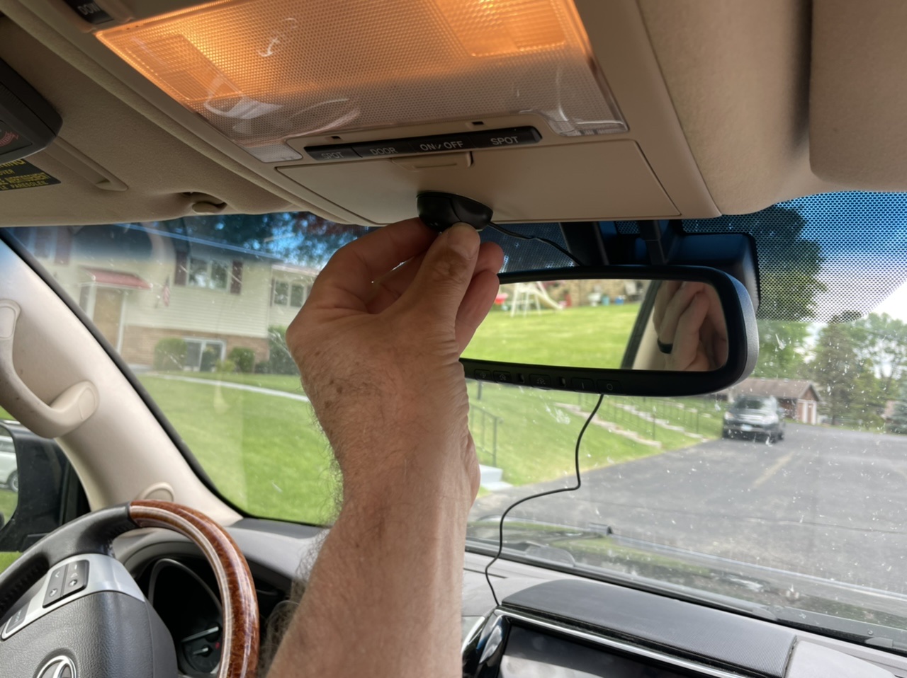

I’m gonna experiment with some locations for the mic and see what seems to work best and then go from there.

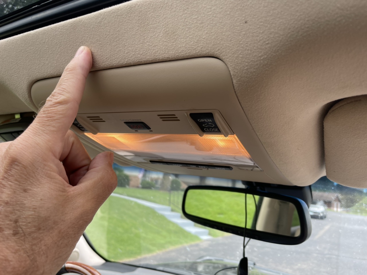

View attachment 3043600View attachment 3043601View attachment 3043602

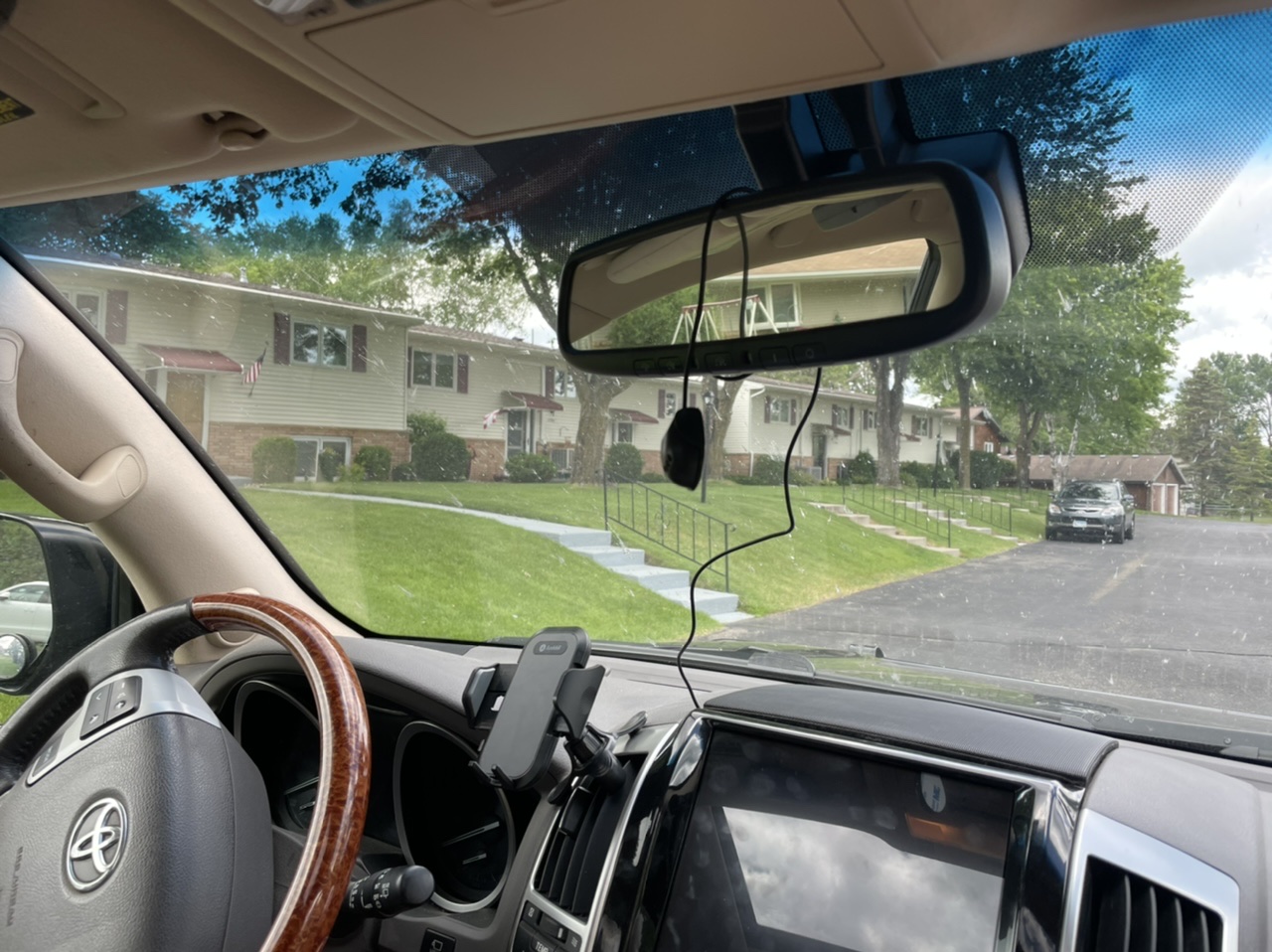

See around the 30 second mark on my video. I placed my GPS antenna and mic both on the surface right in front of the gauge cluster. Out of all the various spots in my 2009 LX that seemed to work best for the external microphone.

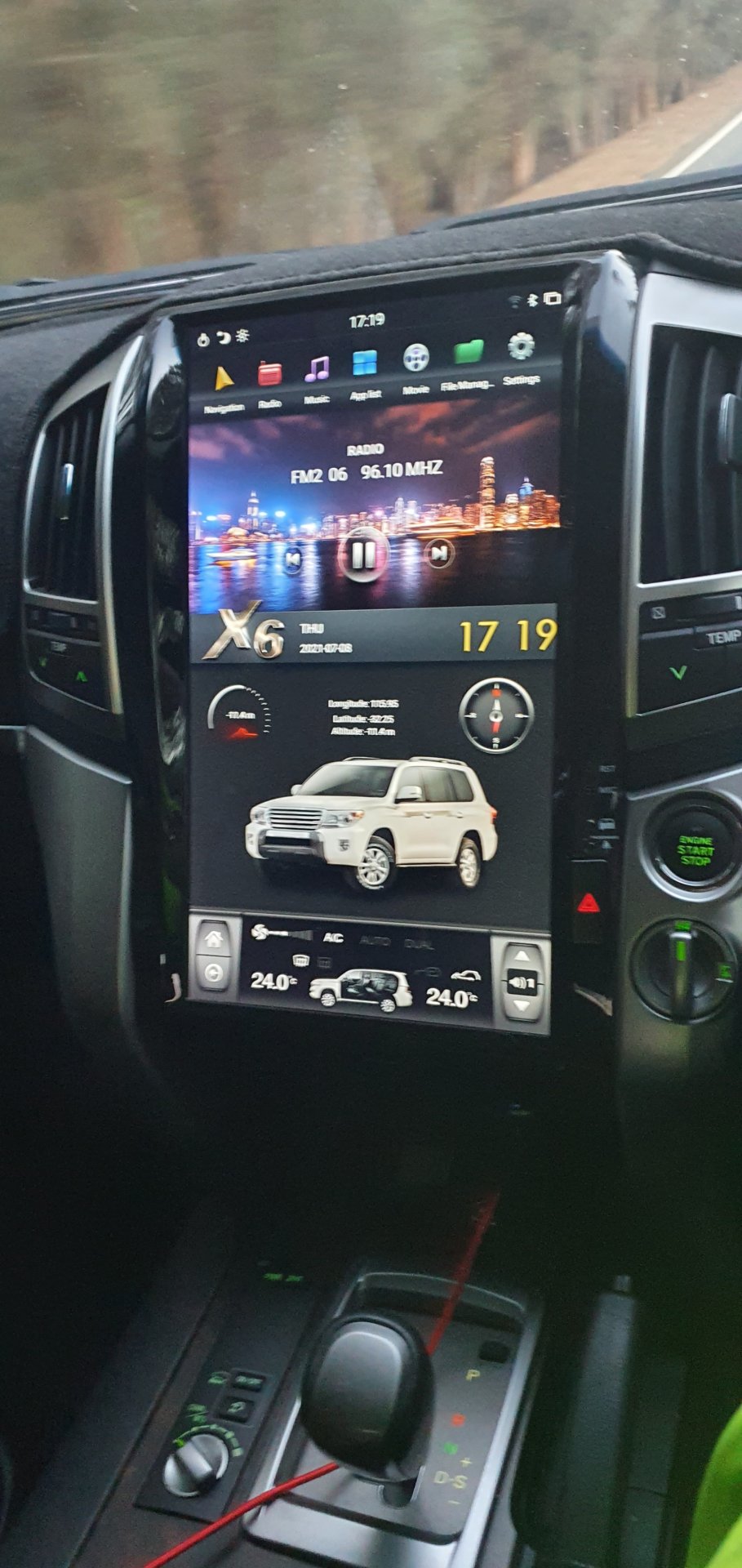

I have a 2013 cruiser with the 16" unit from EC Offroad.
Biggest pile of garbage I've ever owned.
Have to manually connect Bluetooth every single time it's powered on.
Can't use the Torque-it app unless I "pair" it every single time.
The volume resets itself to 0 randomly , so I'm for ever turning the volume up
The radio function skips its self out of tune randomly
The steering wheel buttons are all reversed ( can't be changed )
The Ac temp up and down buttons are on the wrong sides - passenger side has master control....
And the best part of all - 14 months old and the screen display is dead.
All touch functions still work along with the back lighting but no display.
Now I need to find a replacement that actually does as advertised
